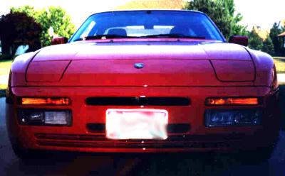

Andrew has been eyeballing my spare set of 944 rear quarter pannels sitting in the backyard. We did some measurements a few times and it is a possibility. Maybe have to put them on backwards due to the length of the pannels.
The 944 flares, go for it. I saw one 914 like 10 years ago with 944 front and rear flares. Looked like they were made for the car! I was too young and dumb to take pic's though. But looked great.
i would love to see it! ive considered the same thing before. ive always been a fan of the 944 s2 front clip. that'd be cool to use it (sectioned??) in conjunction with the 944 fenders.
