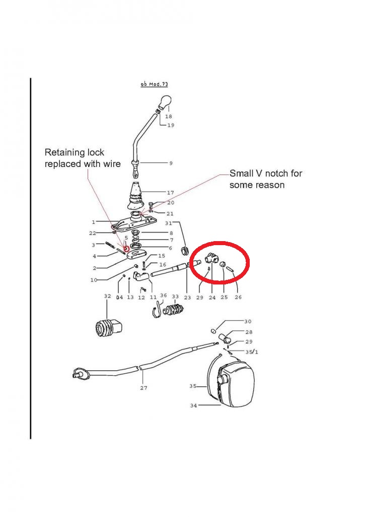

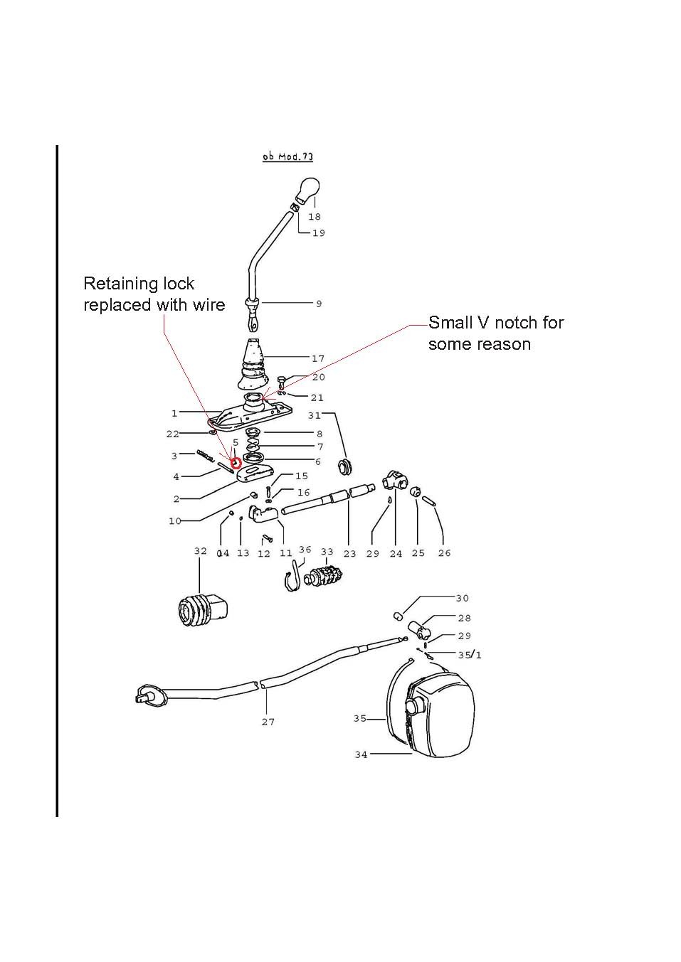

Looking at my shifter, it is questionable at best. It has the lock rings on the compression springs replaced with wire and there is a ā€œVā€ notch in gearshift bracket. I will pull it to get some better pictures tonight (see attached) . Before I get Dr. Evil to rebuild my trans I would like to know if there is any reason to consider rebuilding the shifter and if a shifter rebuild kit is available? Also while I have seen a number of shifters on the board, I am not sure how to determine if a new used one is better than the one I have. If there is a reasonably priced alternative to buying a completely new shifter I might try that before pulling the trans. Any suggestions where to locate would be appreciated.

FWIW, I had similar issues of not grabbing all gears. Ended up being the knuckle being too tight and not moving freely. After taking the knuckle apart, and lubing it to hell, I was able to catch 2nd, 4th and 5th

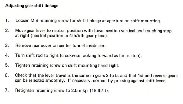

Here is the procedure from the factory manual FWIW

This was somewhat tight but I did lube it well. If you hold the rod out straight it won't flop. But if you shake the rod slightly it bends freely. But because this had new bushings in it I did not replace the. I think I might pull it back out and change them anyway.

I get most of that except for #4. Turn shift rod in tunnel clockwise to right as fa as stop. Is there a mechanical stop or just until it won't rotate?
