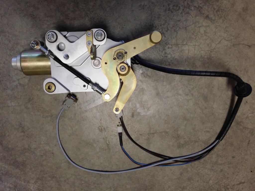

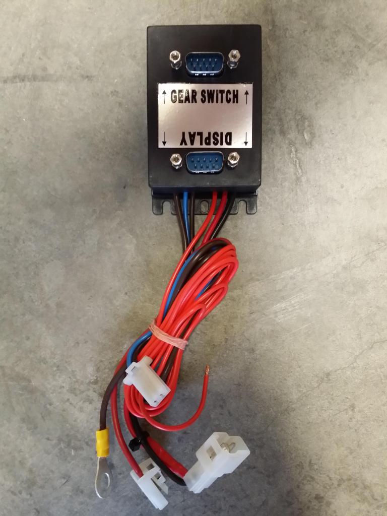

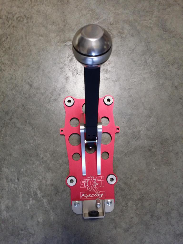

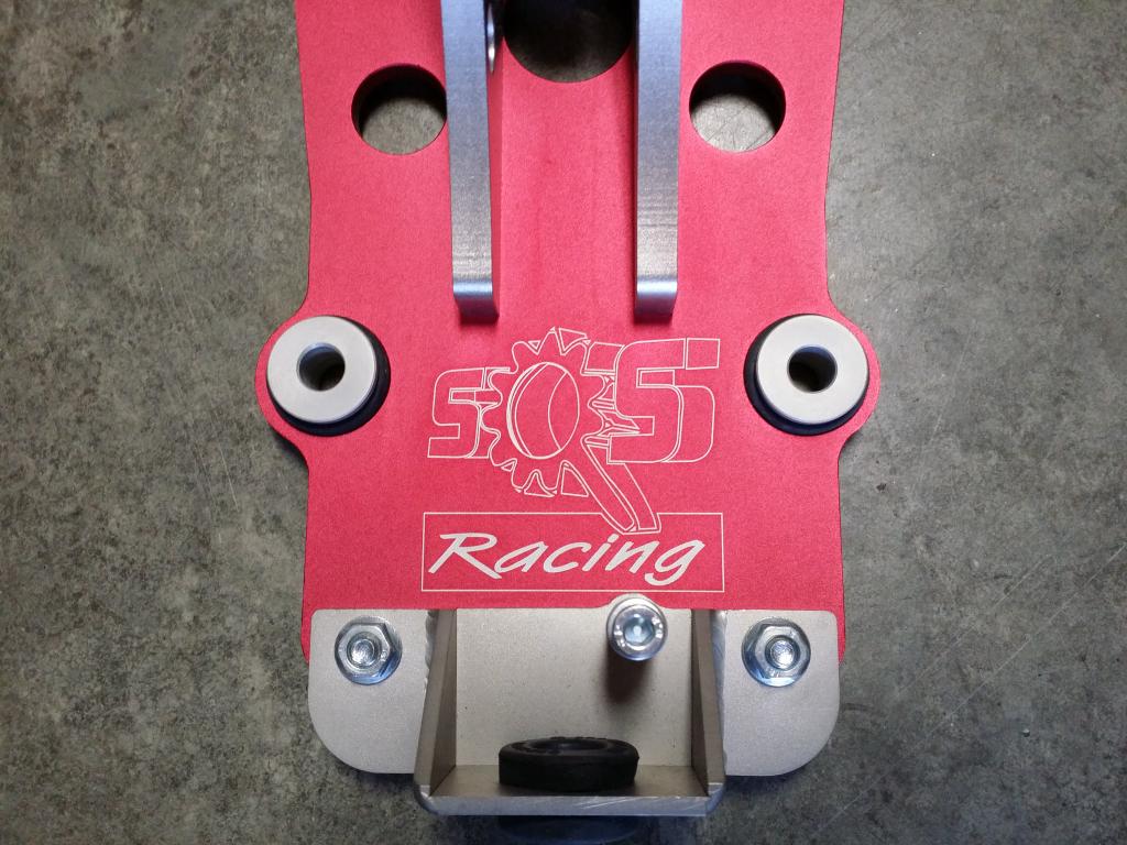

This SQS Sequential Shifter is an adapter kit to the factory 996 GT2 Transmission, meaning it keeps the clutch in between shifting, but instead of throwing the gear lever in an H - pattern, you're shifting back and forth for secure shifting, every time.
More detailed info here:
http://www.sequentialshifters.com/
https://www.youtube.com/watch?v=M216DVI-TgU
https://www.youtube.com/watch?v=iHSkpKJ1nv0

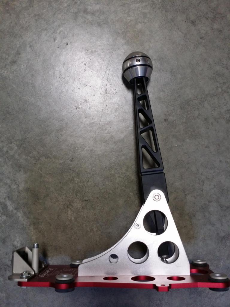

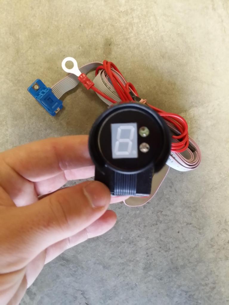

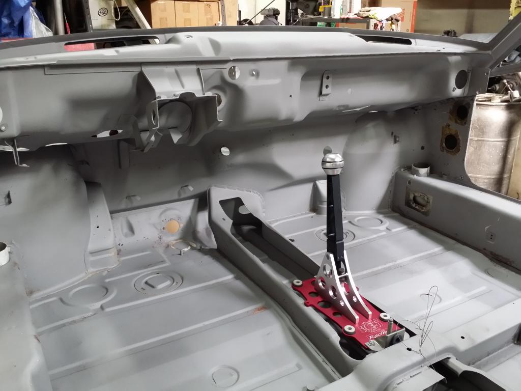

Here are some high - res photos of the Sequential Adapter, and a mock up of how it'll look in the car, eventually...
(IMG:http://www.914world.com/bbs2/uploads_offsite/i771.photobucket.com-14843-1394518187.1.jpg)
(IMG:http://www.914world.com/bbs2/uploads_offsite/i771.photobucket.com-14843-1394518187.2.jpg)
(IMG:http://www.914world.com/bbs2/uploads_offsite/i771.photobucket.com-14843-1394518187.3.jpg)
(IMG:http://www.914world.com/bbs2/uploads_offsite/i771.photobucket.com-14843-1394518187.4.jpg)
(IMG:http://www.914world.com/bbs2/uploads_offsite/i771.photobucket.com-14843-1394518187.5.jpg)
(IMG:http://www.914world.com/bbs2/uploads_offsite/i771.photobucket.com-14843-1394518188.6.jpg)
(IMG:http://www.914world.com/bbs2/uploads_offsite/i771.photobucket.com-14843-1394518188.7.jpg)

Cutting out the tunnel top is a great way for access to add needed controls and such. Are there any plans to fab a cover for the top or just leave it open ??? GR8 build so far !!!! Should be a hoot !!!!!! (IMG:style_emoticons/default/piratenanner.gif) (IMG:style_emoticons/default/piratenanner.gif)

Jack,Doug, sectional plates are being re-attached to the top of the front and rear tunnel areas.
These will be removable , so we can always go back in for running lines or other added cables+ circuits. The new plate that will be the foundation for the shifter is made from .250 cold roll metal plate, which will be welded in place.
If you don't have a way to put a top back onto your tunnel, I would not cut it off. It adds rigidity to the unibody.

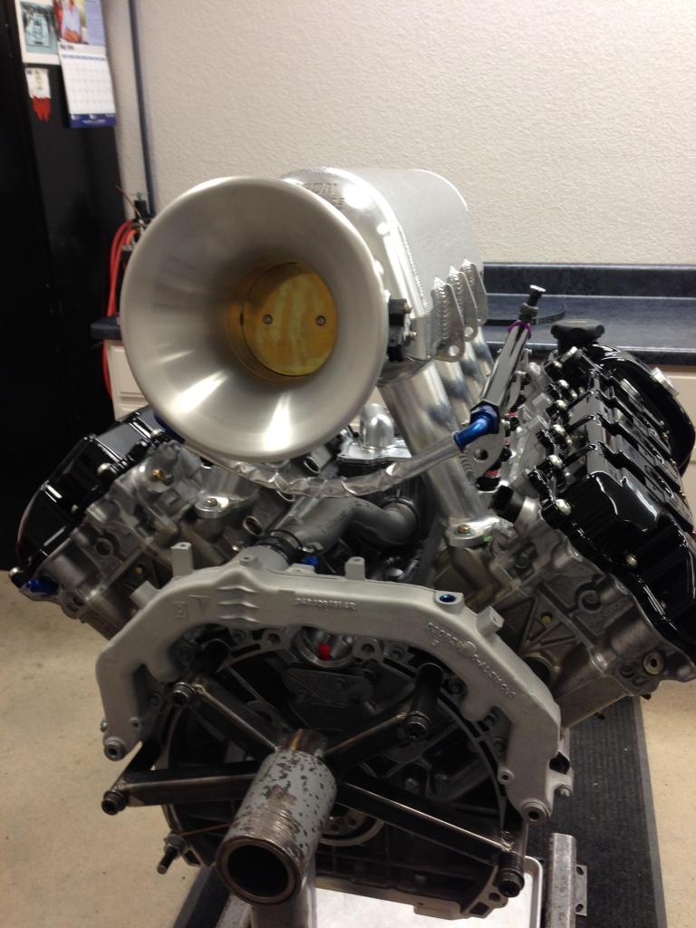

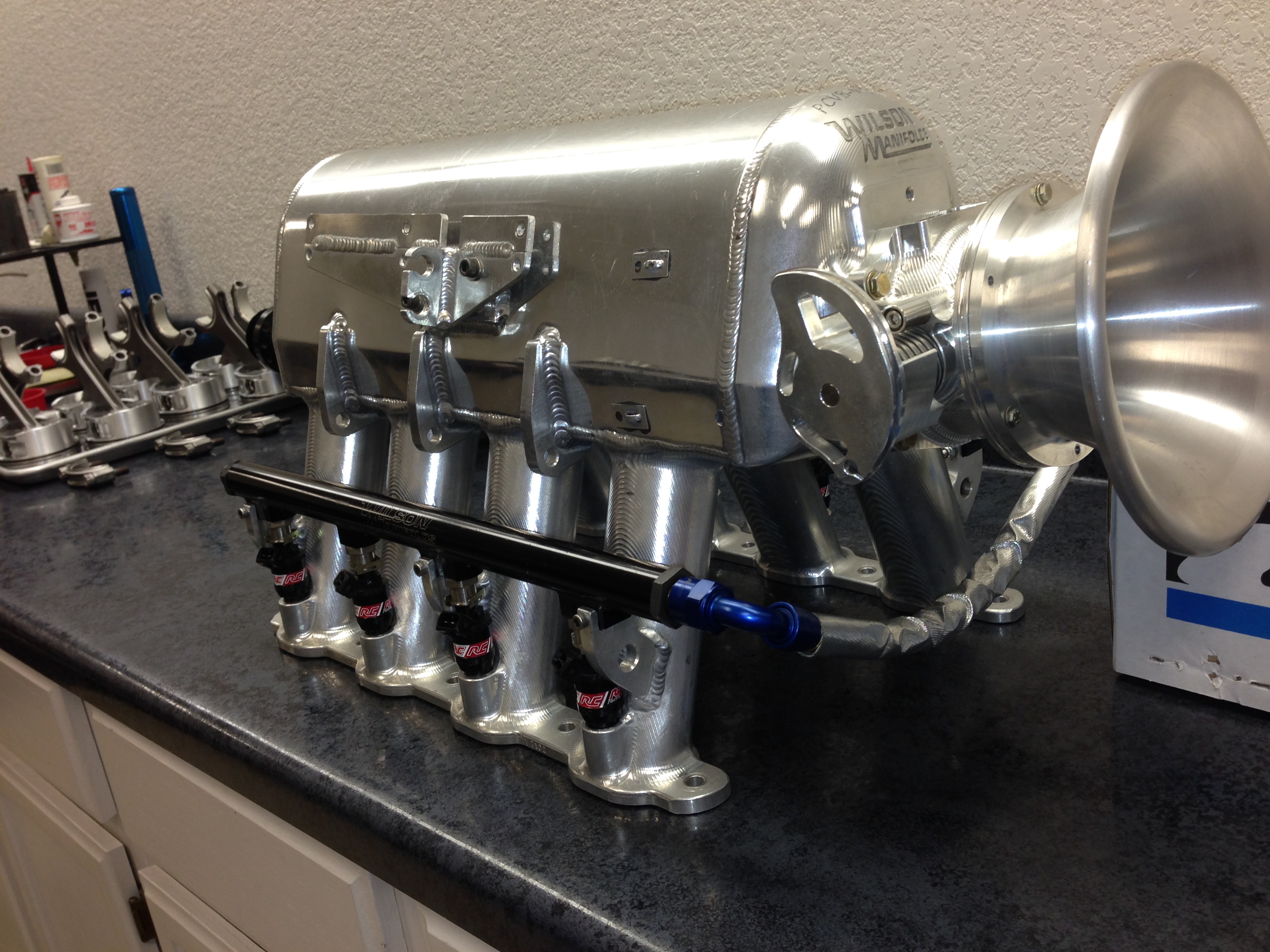

Intake now finished up with RC injectors, rails, throttle body, tps. Aka the "Flying Mailbox" !
The Daytona velocity stack will not be used in our forced induction engine.Attached Image

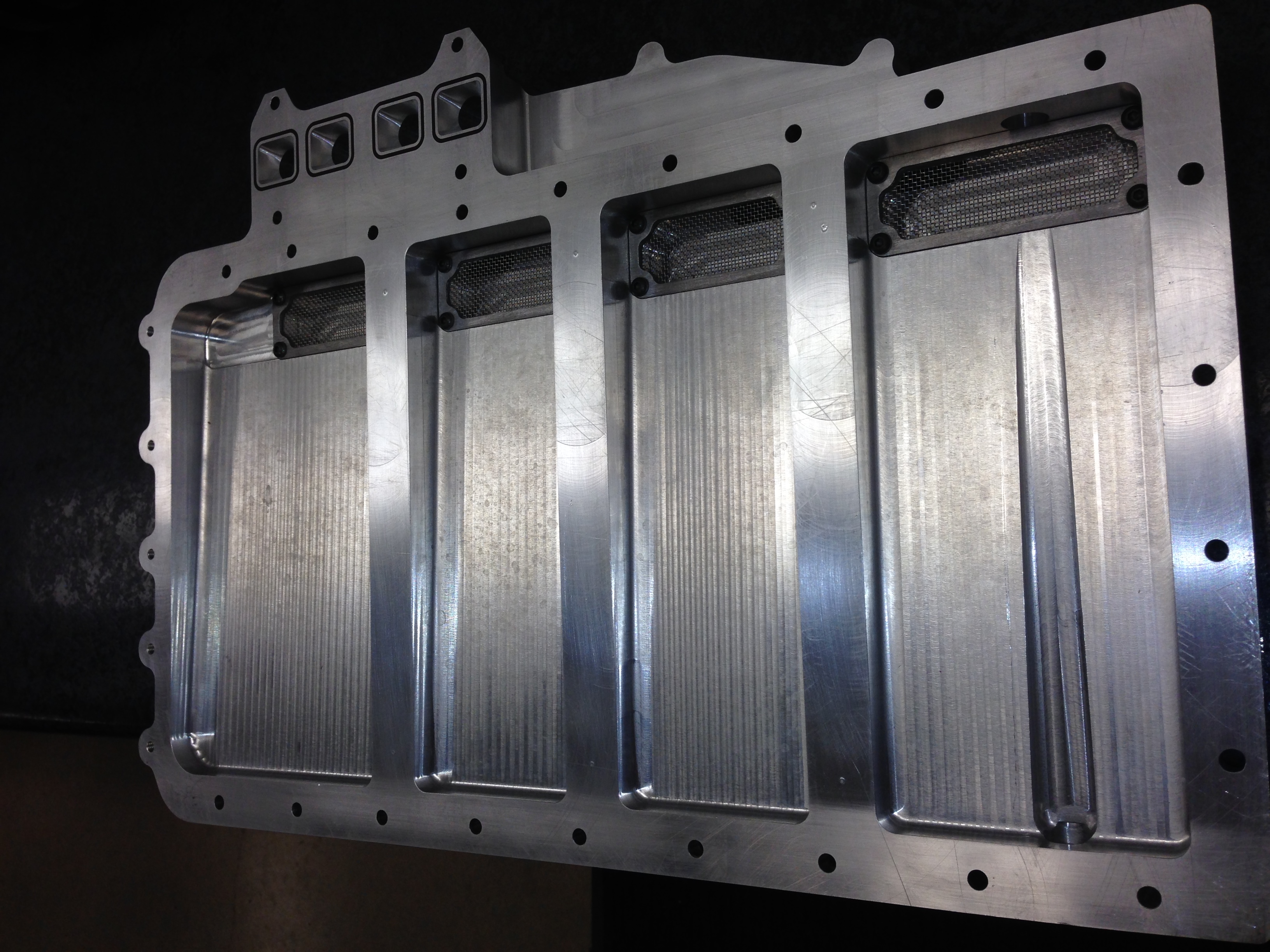

Windage screens installed in the cnc dry sump oil pan...Attached Image

QUOTE(Maltese Falcon @ Apr 26 2014, 01:06 AM) *
A work of art! (IMG:style_emoticons/default/smilie_pokal.gif)

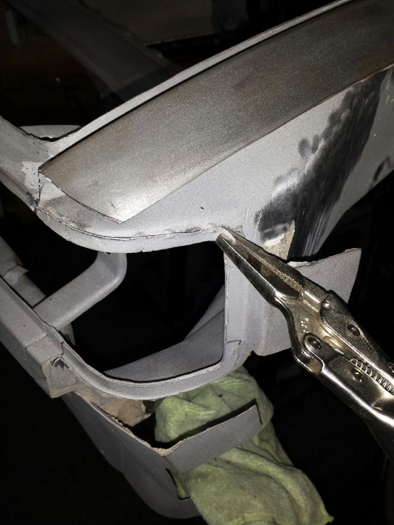

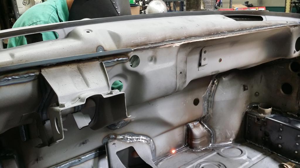

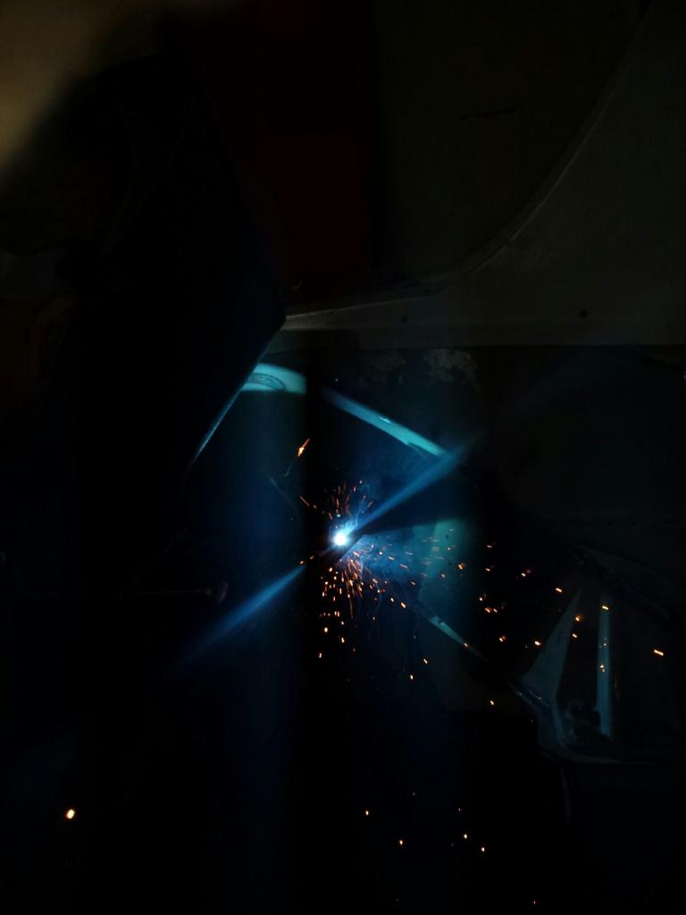

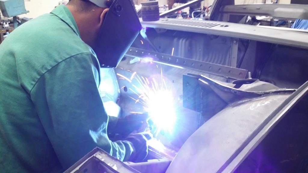

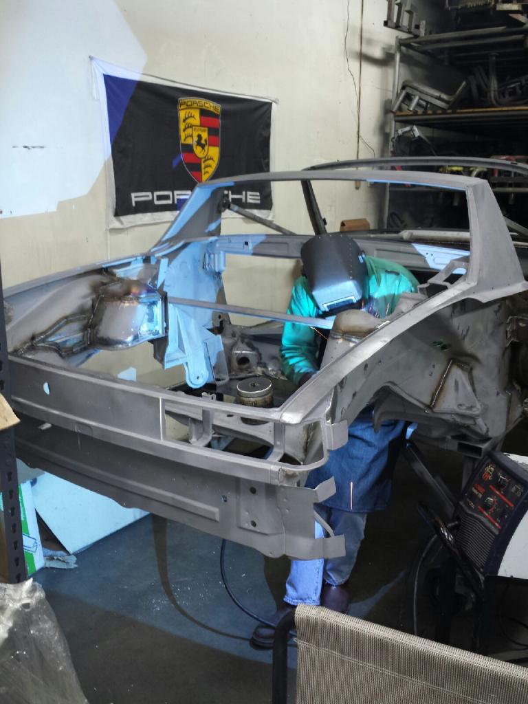

Seam welding every part of the car:
(IMG:http://www.914world.com/bbs2/uploads_offsite/i771.photobucket.com-14843-1398567167.1.jpeg)
(IMG:http://www.914world.com/bbs2/uploads_offsite/i771.photobucket.com-14843-1398567167.2.jpeg)
As you can see in the background in the car, every seam has been welded:
(IMG:http://www.914world.com/bbs2/uploads_offsite/i771.photobucket.com-14843-1398567167.3.jpeg)

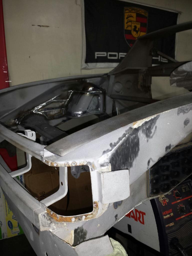

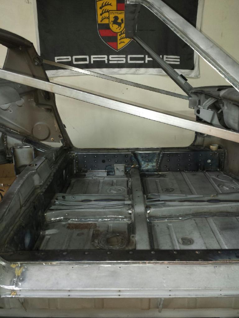

Inner long / Cabin stiffening kit welded in:
(IMG:http://www.914world.com/bbs2/uploads_offsite/i771.photobucket.com-14843-1398567167.4.jpeg)
(IMG:http://www.914world.com/bbs2/uploads_offsite/i771.photobucket.com-14843-1398567167.5.jpeg)

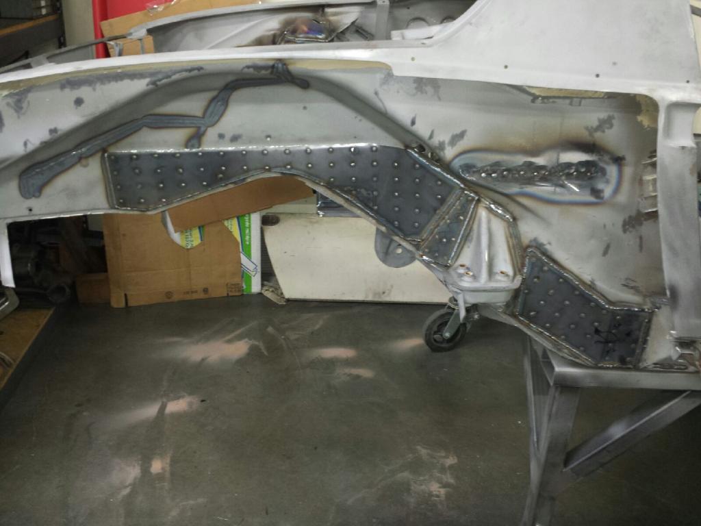

Here is the rear quarter panel almost ready to fit some monstrous wide fender flares:
(IMG:http://www.914world.com/bbs2/uploads_offsite/i771.photobucket.com-14843-1398567167.6.jpeg)

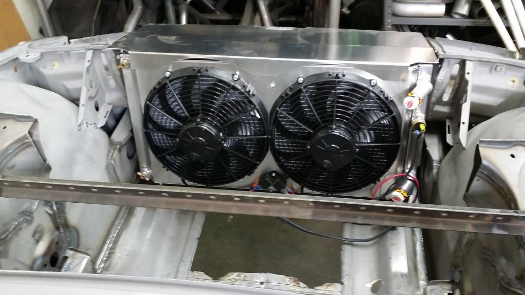

Radiator came in:

Finally, after several weeks of welding, all the seams are now fully welded:
(IMG:http://www.914world.com/bbs2/uploads_offsite/i771.photobucket.com-14843-1401645824.3.jpg)
(IMG:http://www.914world.com/bbs2/uploads_offsite/i771.photobucket.com-14843-1401645824.4.jpg)

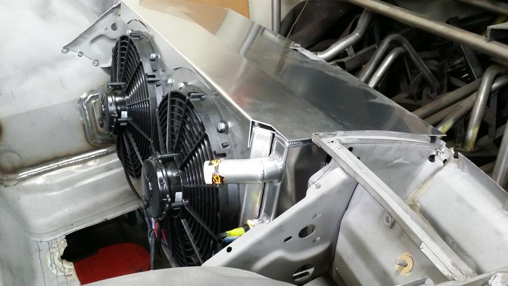

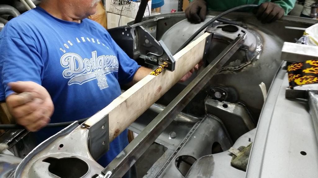

Here is the mock up of the strut bar braces that were welded in. And yes the wood is only a temporary holder for alignment. The actual strut bar that connects to these braces will be cnc'd from an aluminum block:
(IMG:http://www.914world.com/bbs2/uploads_offsite/i771.photobucket.com-14843-1401645824.5.jpg)

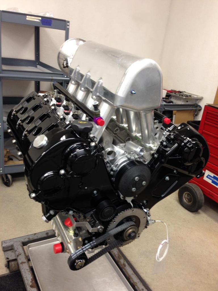

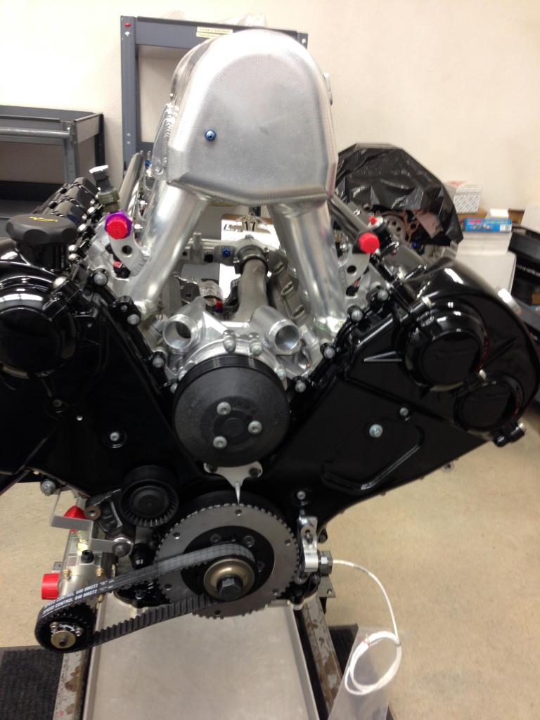

AND THE GRAND FINALLY!! WHAT YOU'VE ALL BEEN WAITING FOR... (well at least 14 months for me):
The engine in its completion!
Quick specs:
2005 Cayenne Twin Turbo motor, bored out from 4.5 to 5.0 Litre.
All new / upgraded everything internally.
Wilson Intake Manifold (yes the same intake manifold used on the 2010 Winning 24 Hour of Daytona, Prototype Cayenne V8 N/A powered car!)
(IMG:http://www.914world.com/bbs2/uploads_offsite/i771.photobucket.com-14843-1401645824.6.jpeg)
(IMG:http://www.914world.com/bbs2/uploads_offsite/i771.photobucket.com-14843-1401645824.7.jpg)
(IMG:http://www.914world.com/bbs2/uploads_offsite/i771.photobucket.com-14843-1401645825.8.jpeg)

After leaving Texas, it was time to get back to work. Here we cut out some of the metal in the body to feed the radiator lines through the front into the inner longs and out the rear into the engine compartment.
(IMG:http://www.914world.com/bbs2/uploads_offsite/i771.photobucket.com-14843-1416053214.22.jpg)
(IMG:http://www.914world.com/bbs2/uploads_offsite/i771.photobucket.com-14843-1416053214.23.jpg)
Removing all of the caulking in the vehicle. At least 8 – 10lbs of caulking removed in total.
(IMG:http://www.914world.com/bbs2/uploads_offsite/i771.photobucket.com-14843-1416053215.24.jpg)
Oil Cooler mock – up: There will be 2, one on each side.
(IMG:http://www.914world.com/bbs2/uploads_offsite/i771.photobucket.com-14843-1416053215.25.jpg)
(IMG:http://www.914world.com/bbs2/uploads_offsite/i771.photobucket.com-14843-1416053215.26.jpg)
Once the engine arrived back at our headquarters in California, we immediately shipped it to our long time associates over at AASCO Motorsports for the necessary mating hardware.
Tilton Triple Carbon / Carbon Clutch:
(IMG:http://www.914world.com/bbs2/uploads_offsite/i771.photobucket.com-14843-1416053215.27.jpg)
(IMG:http://www.914world.com/bbs2/uploads_offsite/i771.photobucket.com-14843-1416053215.28.jpg)
(IMG:http://www.914world.com/bbs2/uploads_offsite/i771.photobucket.com-14843-1416053215.29.jpg)
And the mating plate itself:
(IMG:http://www.914world.com/bbs2/uploads_offsite/i771.photobucket.com-14843-1416053215.30.jpg)
Just over an inch in width:
(IMG:http://www.914world.com/bbs2/uploads_offsite/i771.photobucket.com-14843-1416053215.31.jpg)
And Voila! A World’s first. Cayenne V8 TT mated to an inverted 996 GT2 Transaxle. A moment we’ve waited for, for so long, that we stayed way after closing time for the guys at AASCO. Sorry Vince, hope you can understand!

More cage work progress in the rear:
(IMG:http://www.914world.com/bbs2/uploads_offsite/i771.photobucket.com-14843-1416053215.33.jpg)
(IMG:http://www.914world.com/bbs2/uploads_offsite/i771.photobucket.com-14843-1416053215.34.jpg)
(IMG:http://www.914world.com/bbs2/uploads_offsite/i771.photobucket.com-14843-1416053215.35.jpg)
(IMG:http://www.914world.com/bbs2/uploads_offsite/i771.photobucket.com-14843-1416053216.36.jpg)
(IMG:http://www.914world.com/bbs2/uploads_offsite/i771.photobucket.com-14843-1416053216.37.jpg)
(IMG:http://www.914world.com/bbs2/uploads_offsite/i771.photobucket.com-14843-1416053216.38.jpg)
(IMG:http://www.914world.com/bbs2/uploads_offsite/i771.photobucket.com-14843-1416053216.39.jpg)
