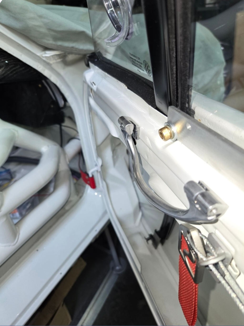

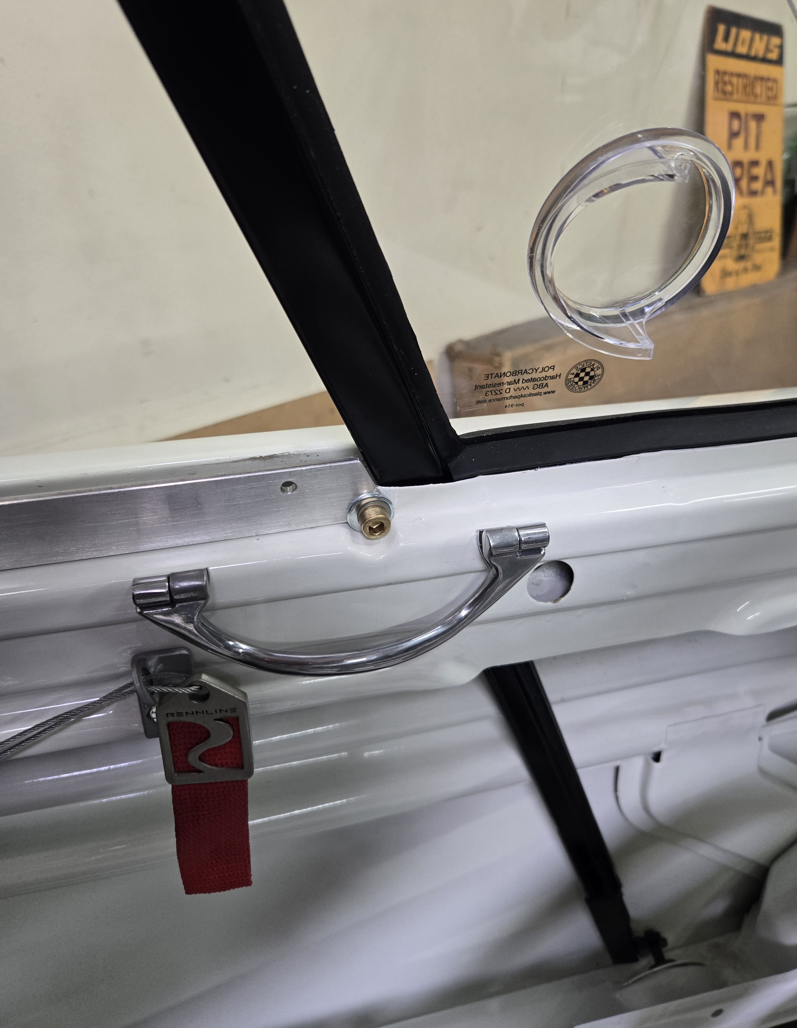

Door pull in the rest position : these sit firm in place in either position, and can be easily be lubed on the small axle shafts.

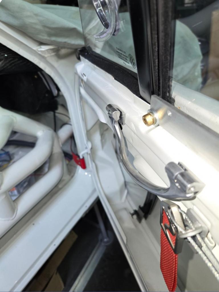

Left side Fiat-Cinquecento door pull in place>> moving around the car + working on various things ...

Those door pull feel right at home! (IMG:style_emoticons/default/smile.gif)
From a small car to a small car (ok, maybe bigger (IMG:style_emoticons/default/biggrin.gif))

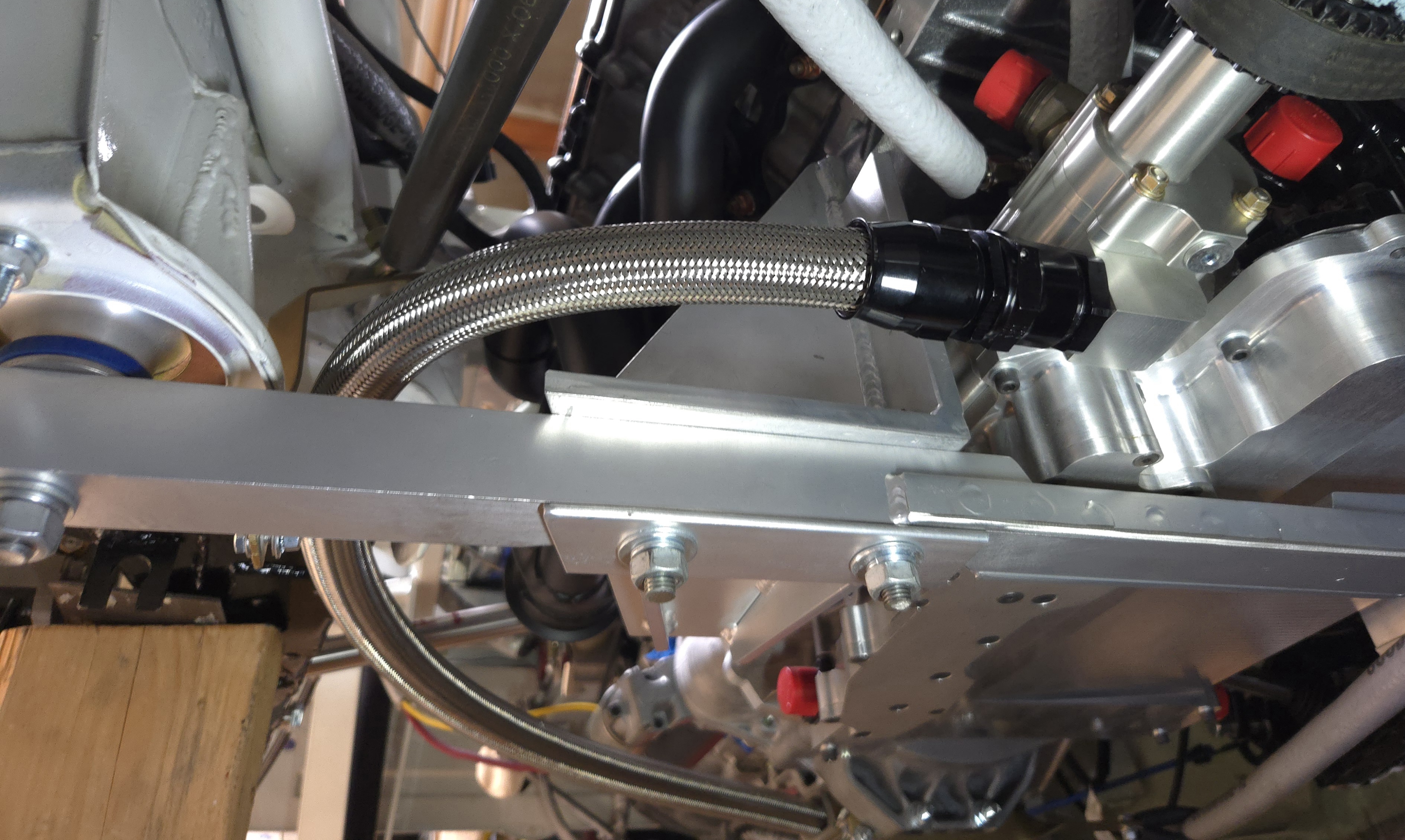

A/N #16 main oil line from Aviaid oil tank into the dry sump pump.

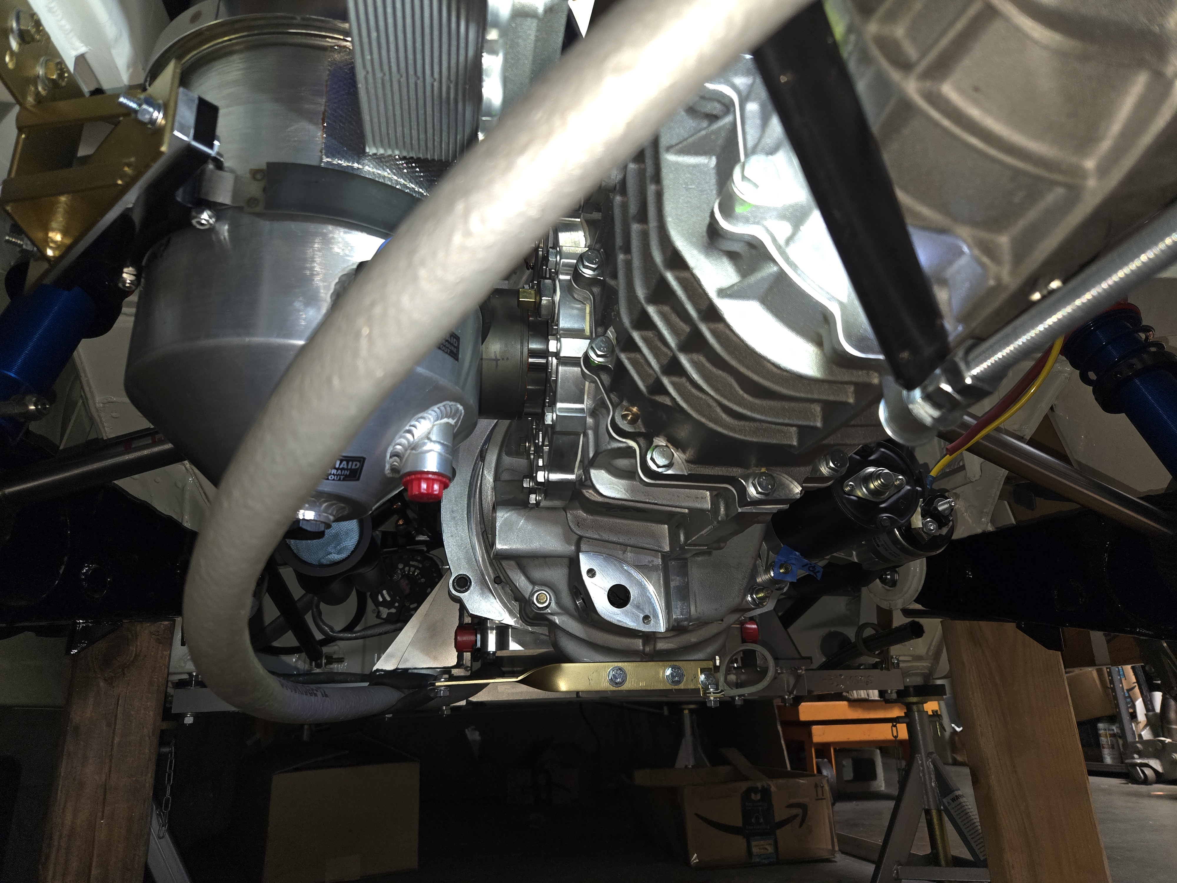

Rear under-car pic, installed the support bracket for the SQS shift cable, and the A/N #16 oil line for pump supply.

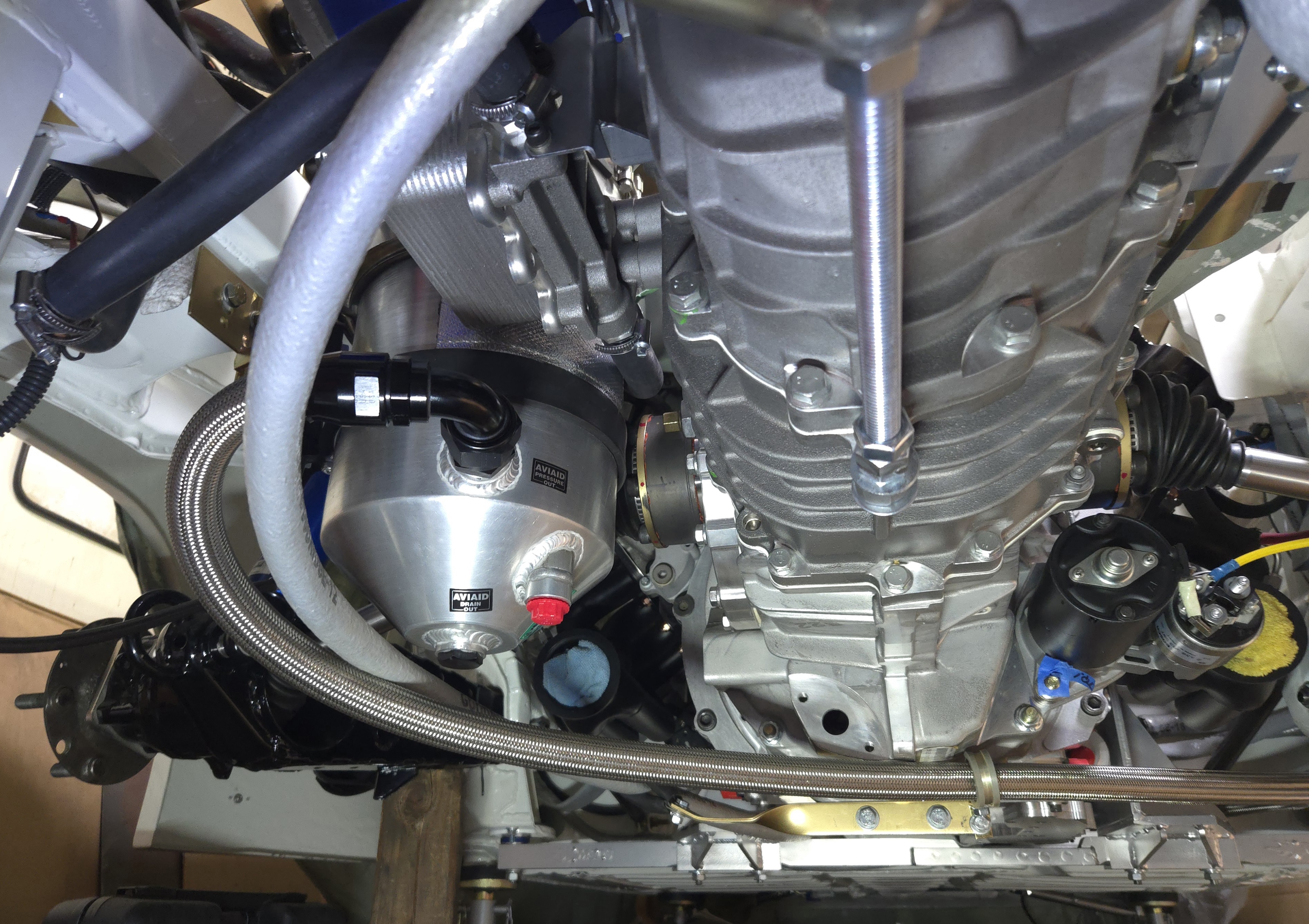

A/N#16 (supply to pump) oil line all set + gravity is good on its way to the entry point (suction side of pump), which is (tooth belt) driven off of the crankshaft pulley mounted forward and down low.
Blue tape on starter motor fasteners are 'Reminders to torque 'em down ¡
The Red 'Cap-Plug near the bottom of oil tank is for the oil pre-heater (install coming up) , always nice to have warmed up engine oil prior to that 1st lap on time trial day.

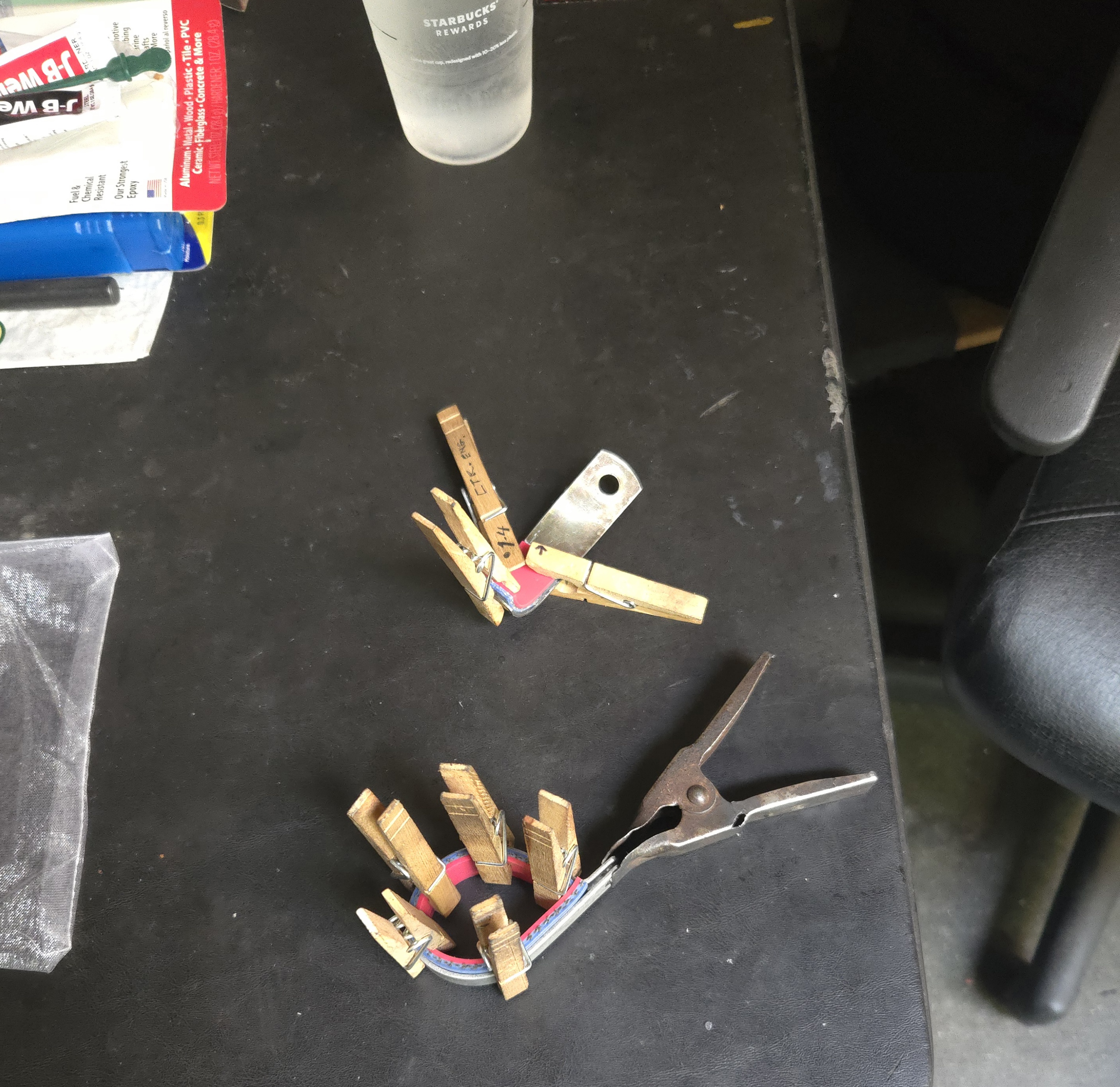

Some plumbing headed back and forth to the v8 from the oil tank; keeping the runs as close as possible on top of trasnsaxle, as there will more components to stack there. Clearance to cv's, axles, starter motor, headers, easy loops and no kinks. I reworked some Adel clamps with soft silicon buffers, to hold lines in place preventing abrasion.

Setting up clamps with small sections of Purosil turbo hose, 24 hours set-up time with JB >of course !

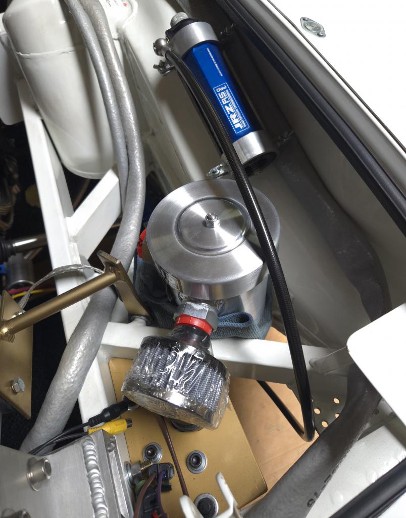

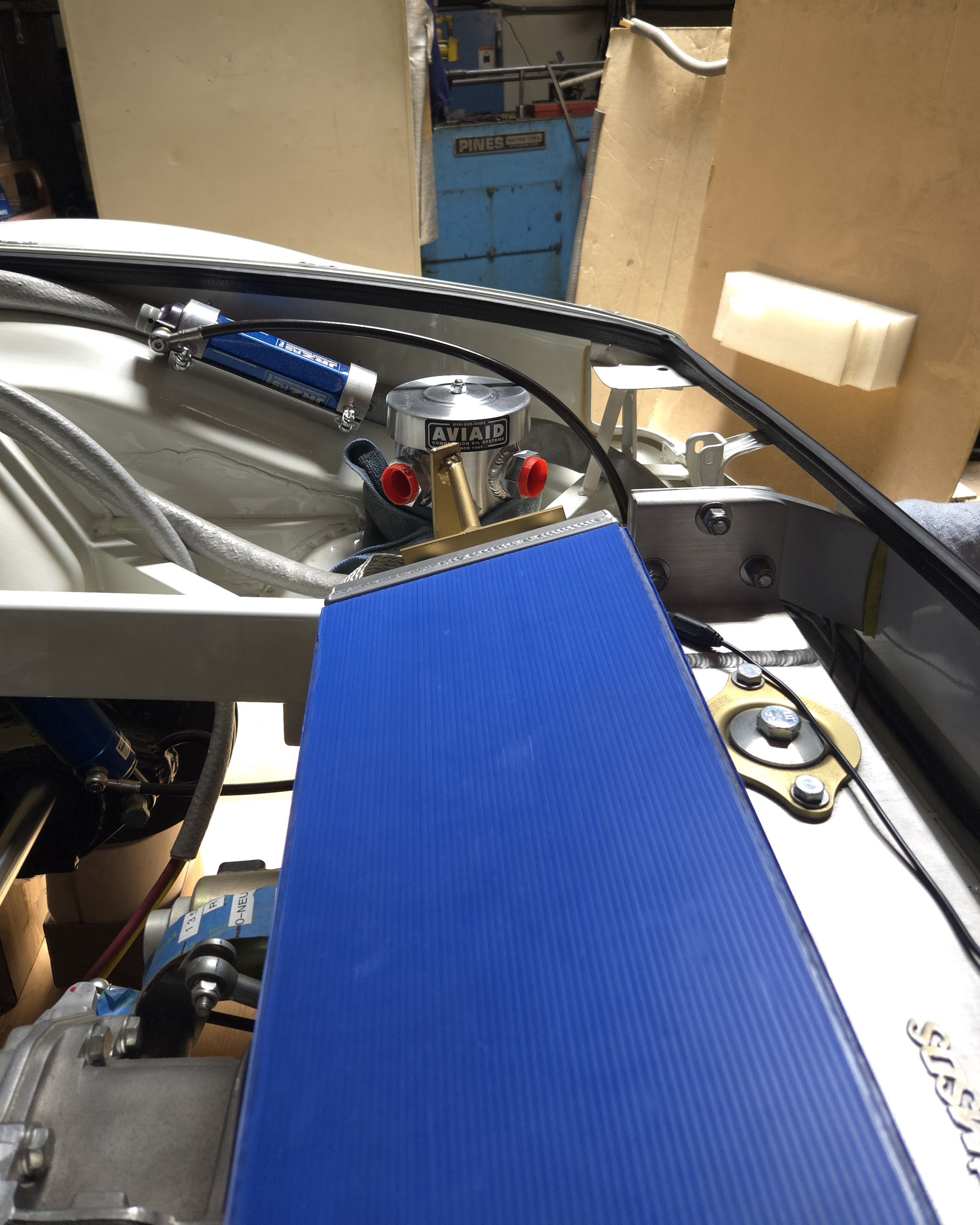

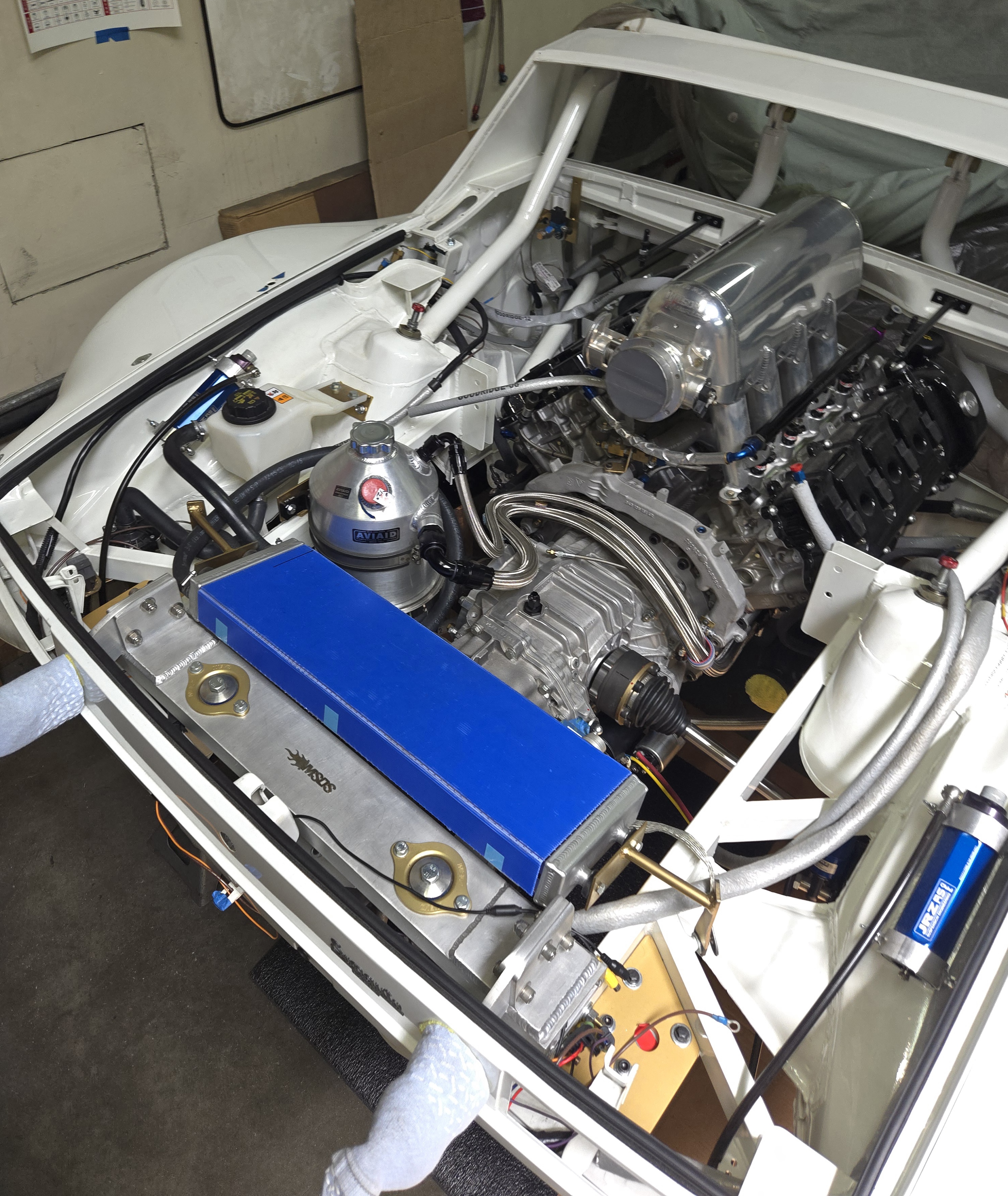

Breather/catch can will mount in the right rear corner of the engine bay.
Maltese Falcon
post Jun 10 2026, 10:17 PM
Post #1038
Posts: 5,451
Joined: 14-September 04
From: Mulholland SoCal
Member No.: 2,755

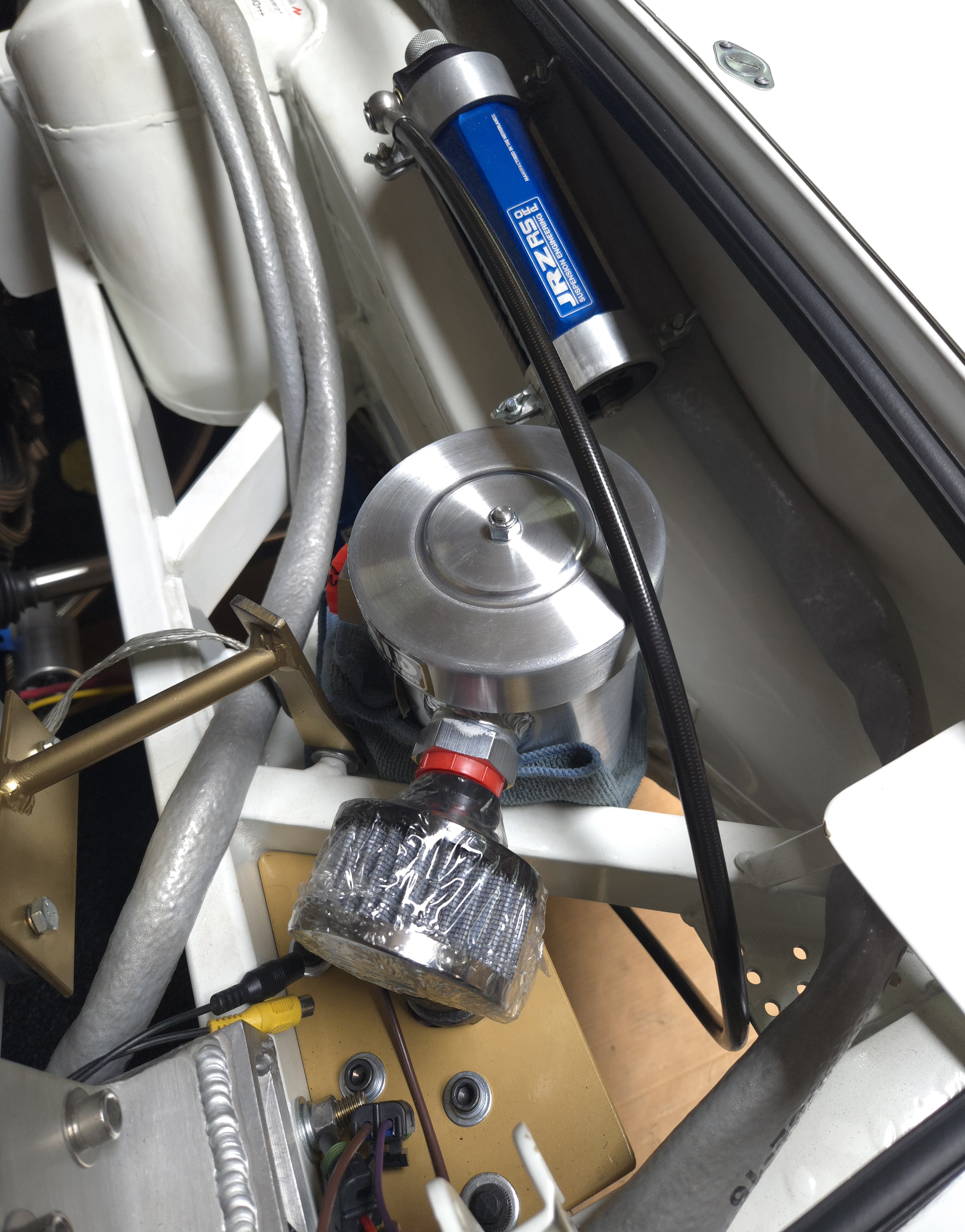

Small cotton-gauze/ S+B mfg filter goes on one of the #12 ports: and bottom of breather can has a drain port.
Dave_Darling
post Jun 11 2026, 01:51 AM
Post #1039
914 Idiot
Posts: 15,365
Joined: 9-January 03
Member No.: 121
Hopefully the hose routing in that last pic is just temporary. Looks like it could suffer some abrasion, at least from the angle of this pic!

QUOTE(Dave_Darling @ Jun 11 2026, 12:51 AM) *
--DD
Thx Dave, several areas of plumbing along the route will have abrasion buffers attached, you're basically watching the build as in 'Live time, so still details to be added (IMG:style_emoticons/default/smile.gif)
That light-gray tubing is Goodridge firesleeve, and contains several insulated current lines internally...and it is primarily an anti heat + chaffe conduit.
Marty
