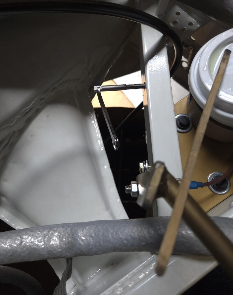

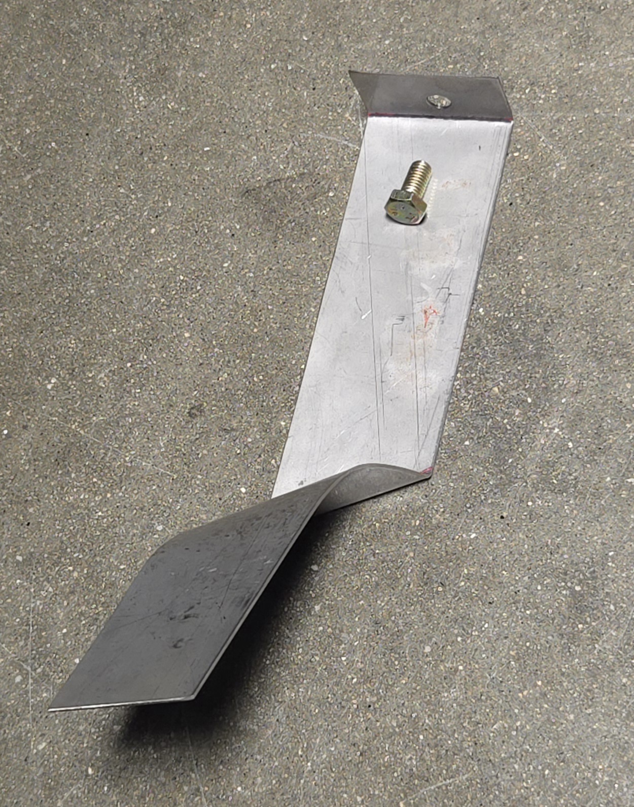

One breather-can bracket coming right up

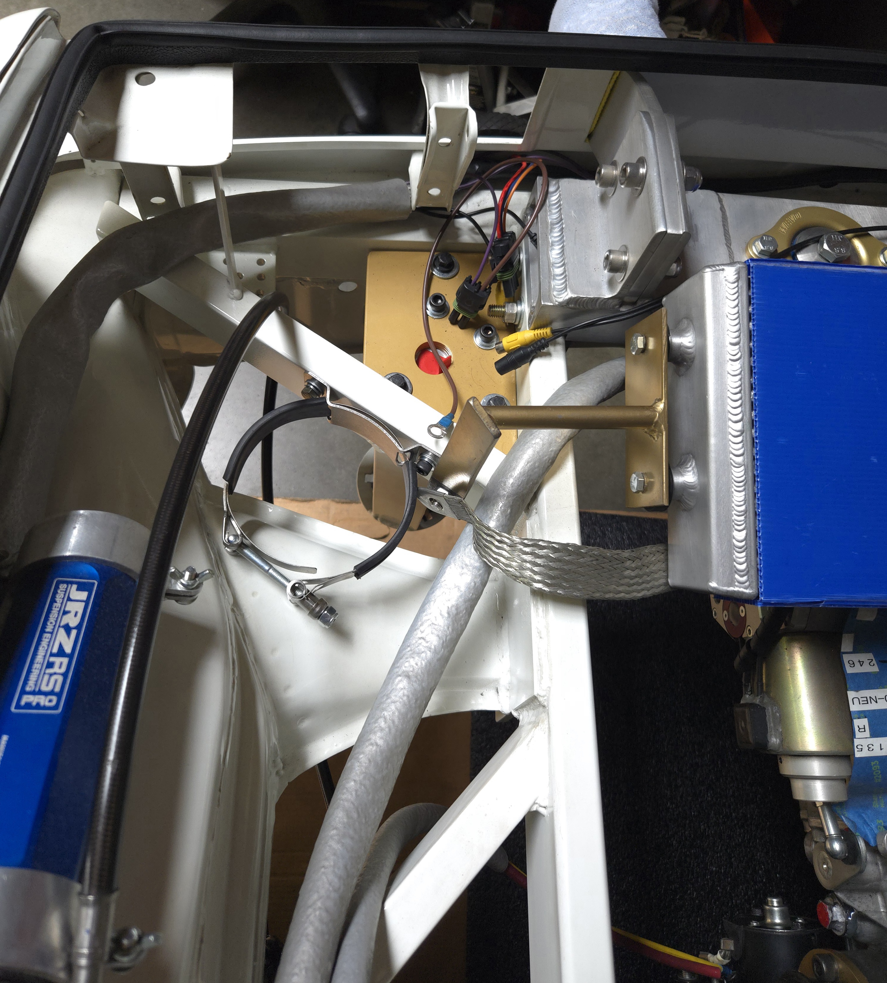

Maltese Falcon
post Jun 17 2026, 09:35 AM
Post #1042
Posts: 5,451
Joined: 14-September 04
From: Mulholland SoCal
Member No.: 2,755
Ready

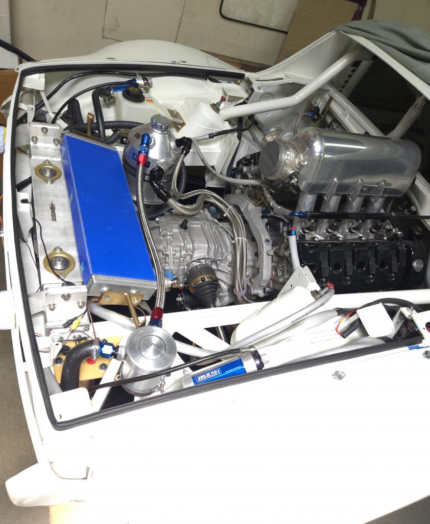

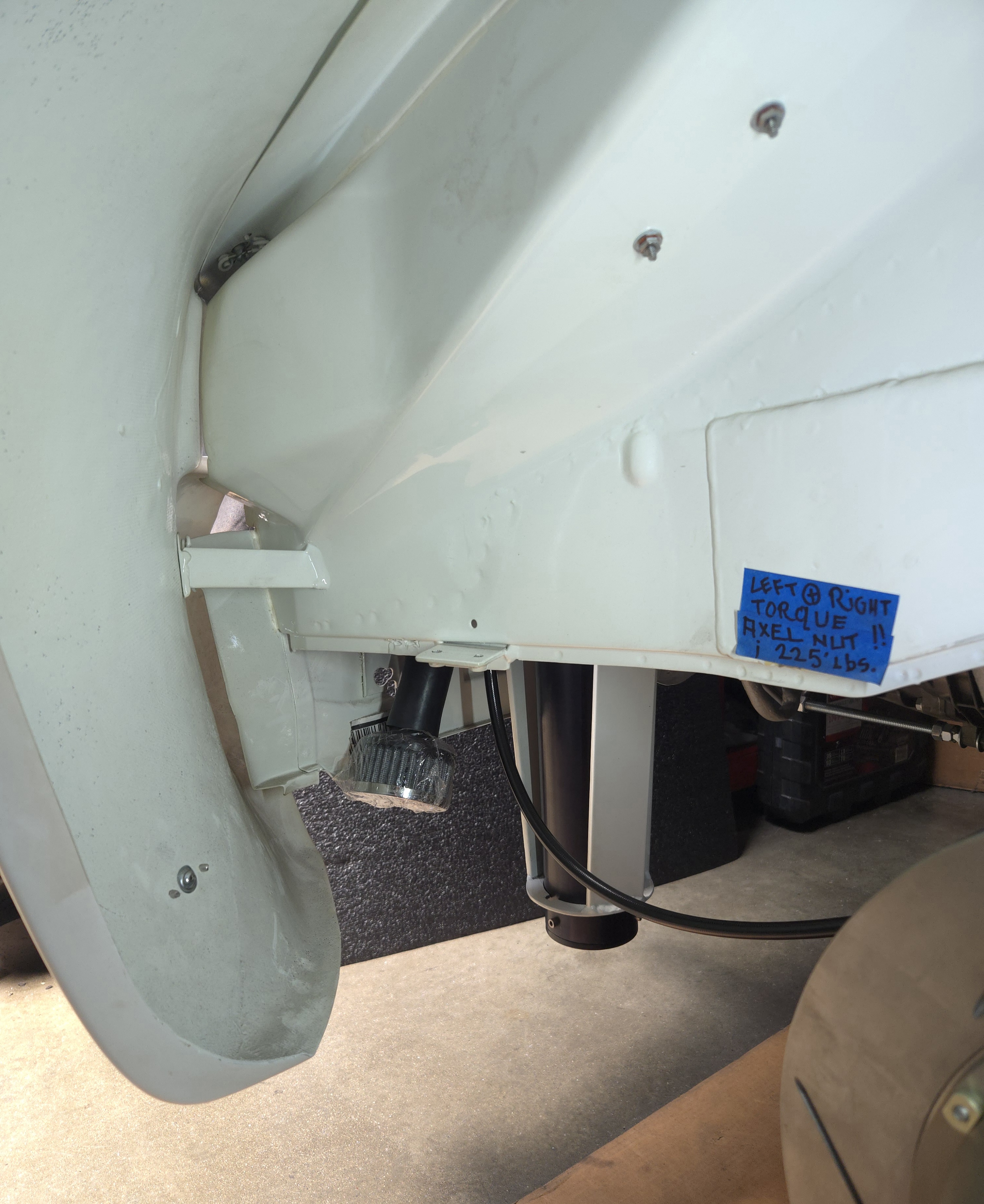

QUOTE(Maltese Falcon @ Jun 8 2026, 11:10 PM) *
Some plumbing headed back and forth to the v8 from the oil tank; keeping the runs as close as possible on top of trasnsaxle, as there will more components to stack there. Clearance to cv's, axles, starter motor, headers, easy loops and no kinks. I reworked some Adel clamps with soft silicon buffers, to hold lines in place preventing abrasion.
I'm curious why you didn't mount the oil tank on the right side to help offset the driver's weight. (no offense lol)
Maltese Falcon
post Jun 17 2026, 01:24 PM
Post #1044
Posts: 5,451
Member No.: 2,755
QUOTE(NorCalScott @ Jun 17 2026, 08:53 AM) *
Hi Scott, n/p on weight bias L to R back there:
The 12 Qt tank is approx 7.7 lbs oil/ 3 lbs aluminum tank -- L side.
Starter motor is approx 8 lbs/ SQS sequential shift / 3 lbs -- R side.
Business office @MATTYLITE or me approx 190 lbs -- L side.
Navigators ride-along side: Cool suit tank+ pump / fire suppression tank/ ECU / oddesy battery 75 lbs R-- side (IMG:style_emoticons/default/marty914.jpg)

Oh, ok. I figured I must be missing something.

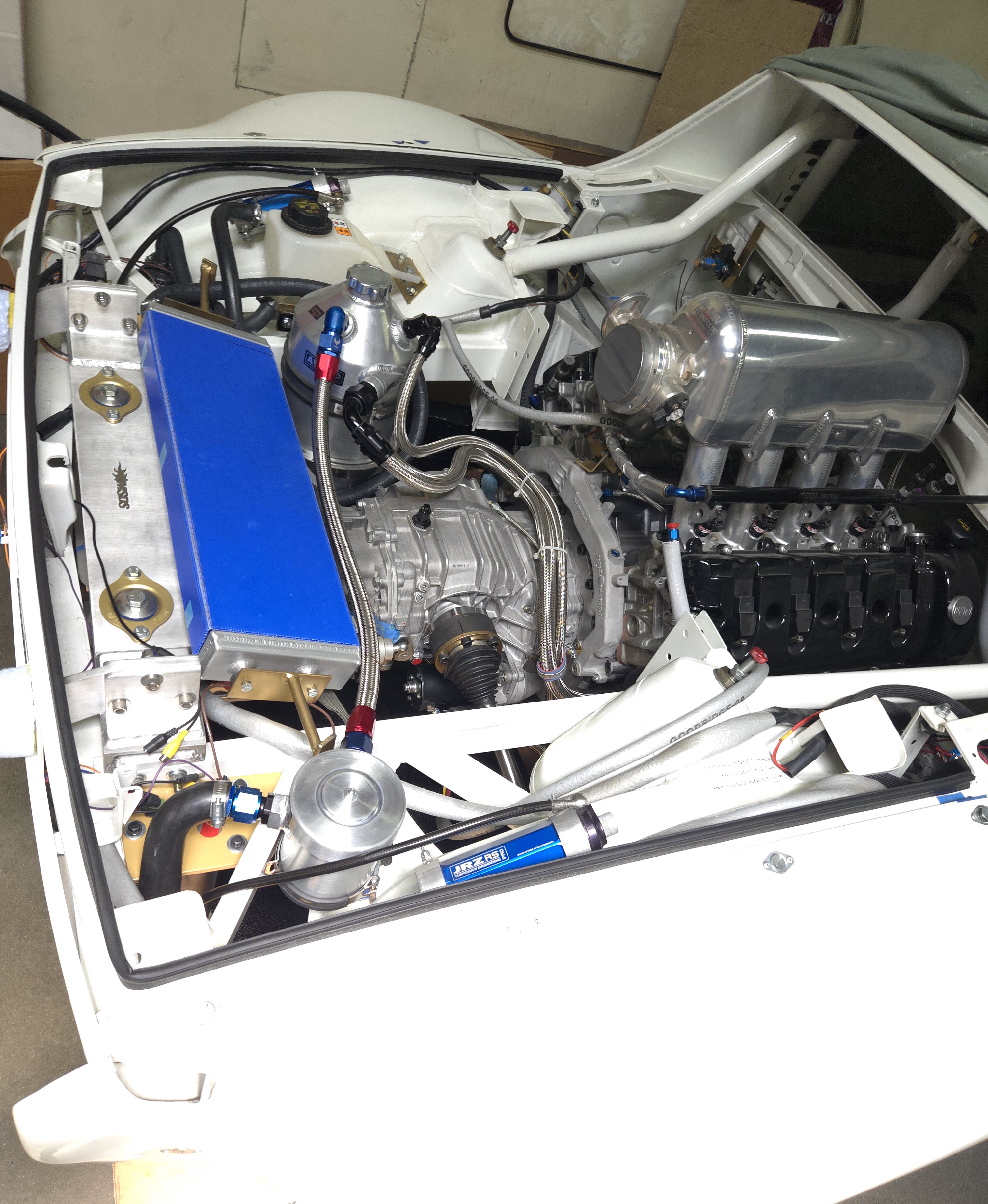

All oil tank/ breather tank lines installed + buttoned up

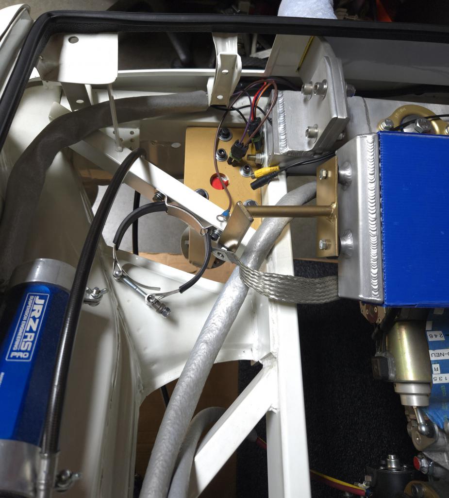

Small S+B breather on the catch-can vent line. I can always switch out this breather for an old school plastic catch tank, if required by race tech.

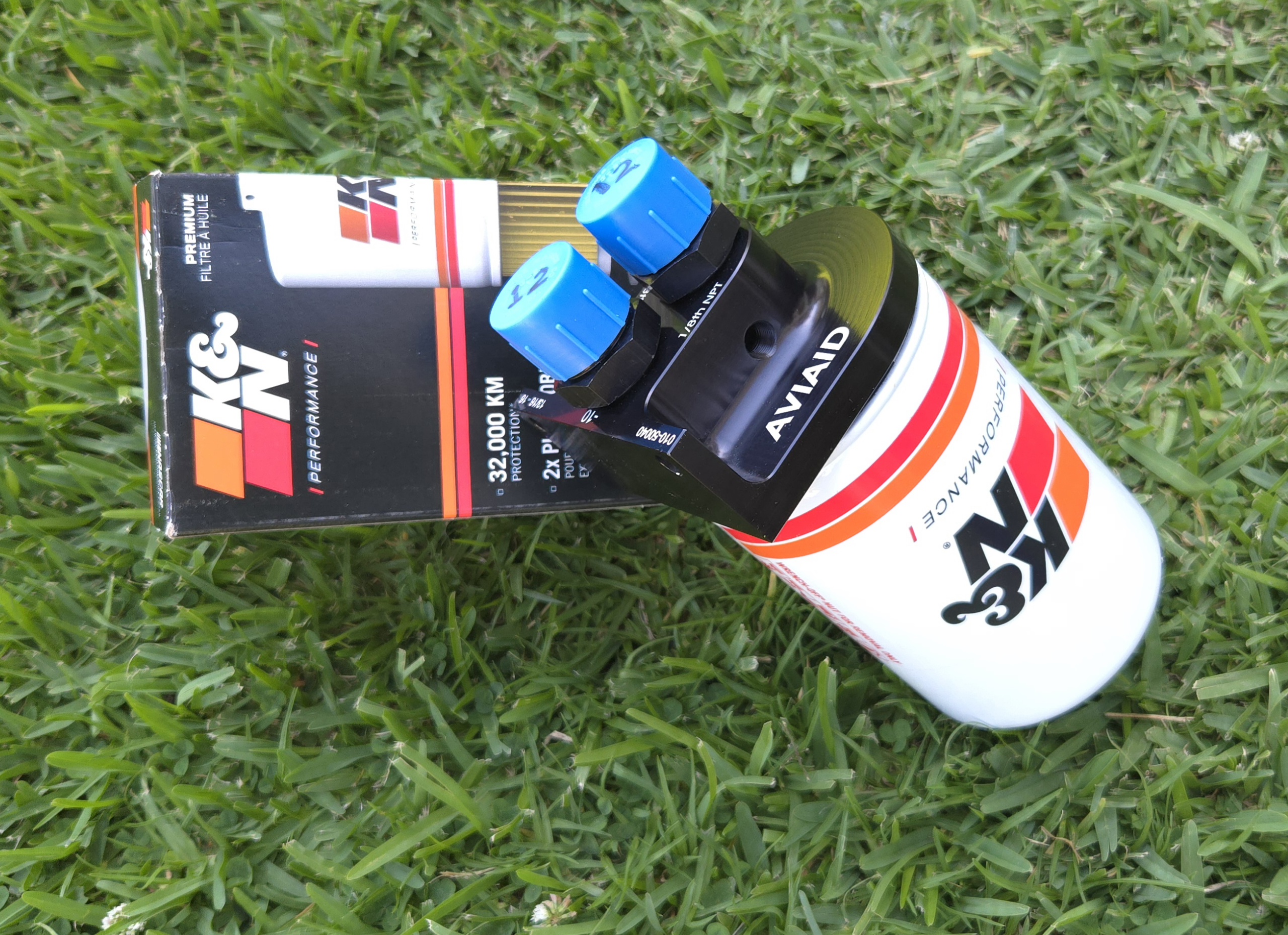

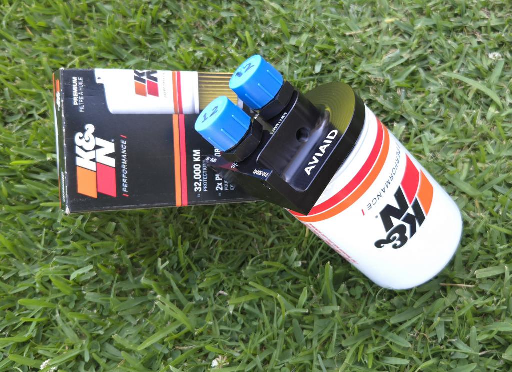

All oil tank lines in have been fastened in place , and Next up we will proceed to all of #12 lines in the engine bay.
Aviaid oil filter stand shown with K+N filter.
Thermostat we use is a Mocal unit with #12's.

QUOTE(Maltese Falcon @ Jun 27 2026, 01:34 PM) *
I know the Mocal thermostat is a popular choice, but I was wondering if you had checked out Improved Racing's thermostat. Looks like a nice product.
Maltese Falcon

QUOTE(NorCalScott @ Jun 30 2026, 11:00 AM) *
Hi Scott I have the old school Troutmans , and MoCal T-Statts in use on several Porsches...and going strong through the years. Can't find new Troutmans anymore >> and those use the oe Porsche T-Statt internals inside of the cast aluminum Troutman housing, and are awesome. MoCal has a foolproof bypass system which is great in the event of T-Statt failure. I love the 'Billet look of Improved Racing's product, but not clear on their failsafe feature.
So just staying with what I'm experienced with.

Thanks for the response as always. The car is looking amazing.

QUOTE(Maltese Falcon @ Jun 27 2026, 11:34 AM) *

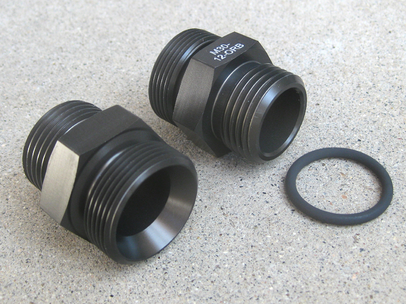

If you wanted to go metric fittings like I did check out Jimmy over on the bird site. He made me some custom -12 orb to 30 mm male fittings.

@LukeM Does Jimmy on Pelican go by that name in 914 Technical Forums / or a screenname ¿
The v8 engine in this project does have some metric-to-AN fittings that were installed by the engine building shop, so I'm simply using all SAE -AN standard plumbing from there. I'm also well stocked up on fittings , hose, and assembly tools to make these lines as well.
Here is a great online source for Metric- to- AN, SAE pipe, etc. Saved me lots of machining time on certain custom fittings encountered on this project;
www.dynapex.net 775.323.1822 in Reno NV.
Thank you Luke >> received your Pm with Jimmy's contact info, enjoy your July 4 '250 Holiday ¡¡

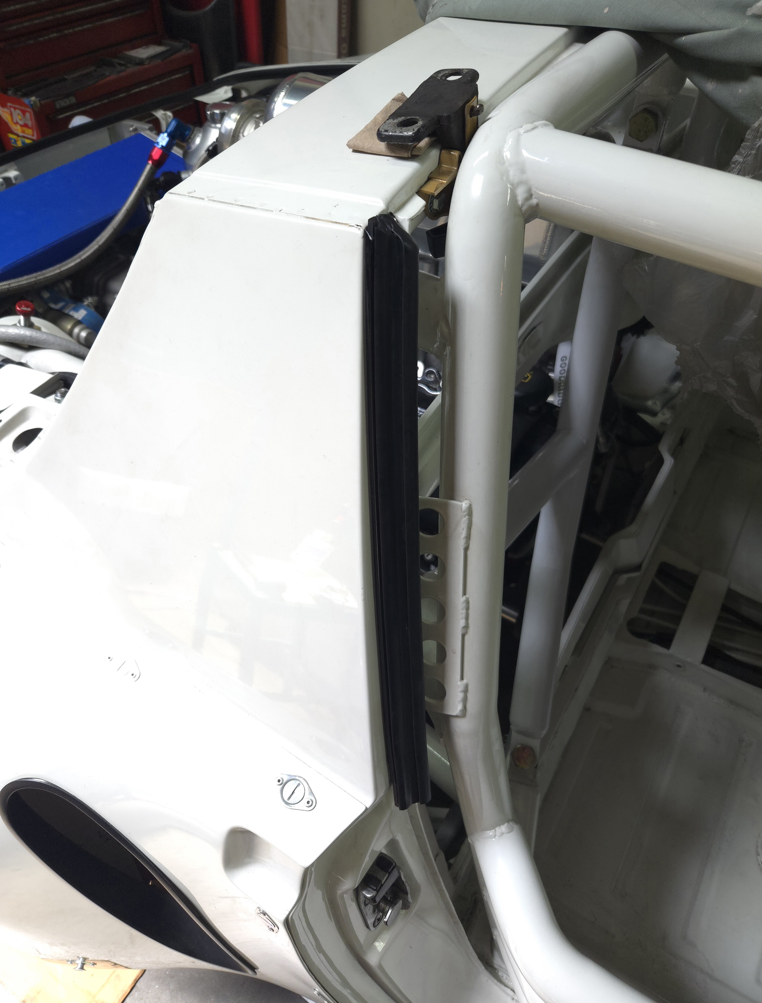

post Jul 19 2026, 12:33 PM
Post #1060
Posts: 5,451
Member No.: 2,755

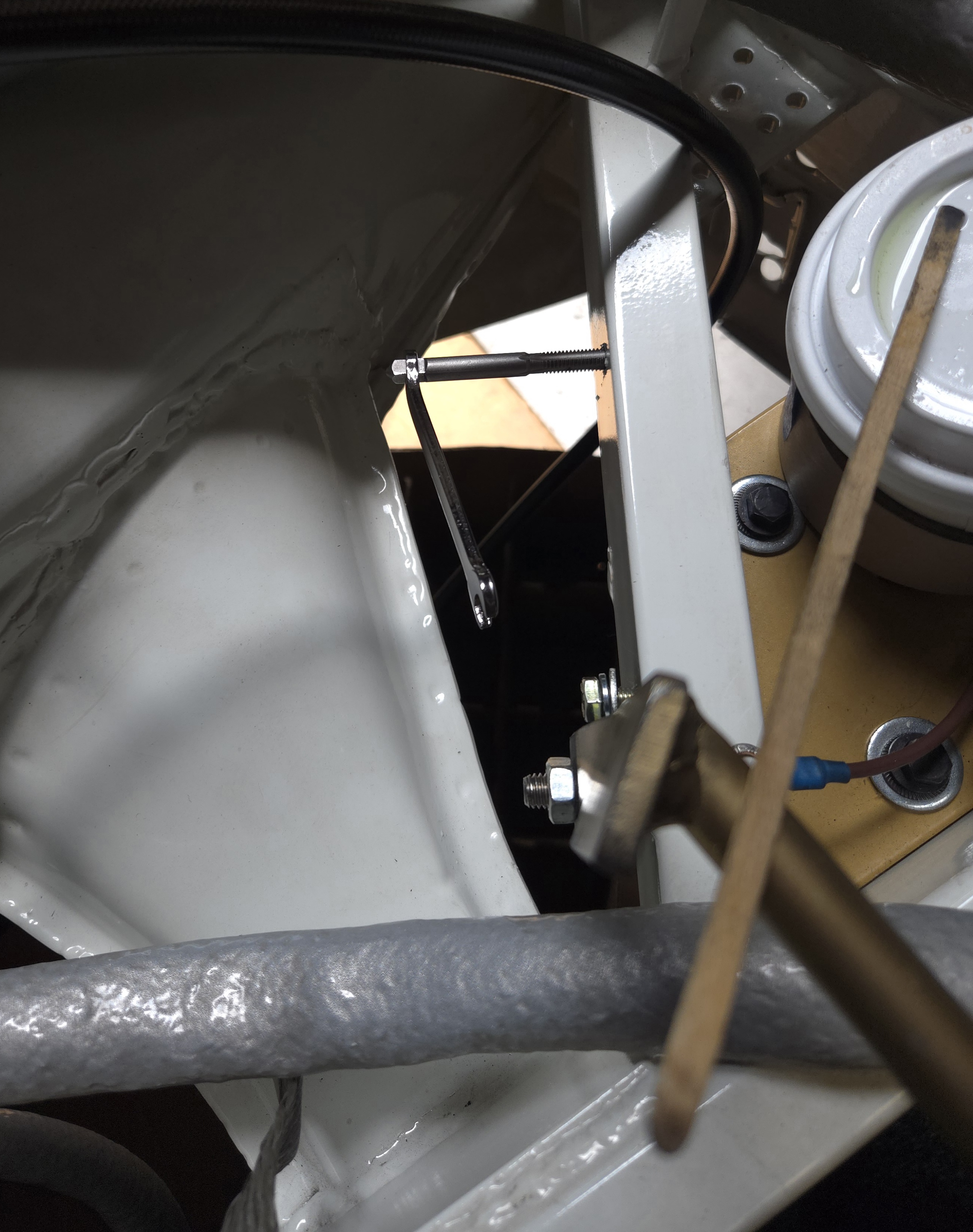

914Rubber ! those little things...
and a custom fit 'Snorkle hold-down bracket taking shape.
