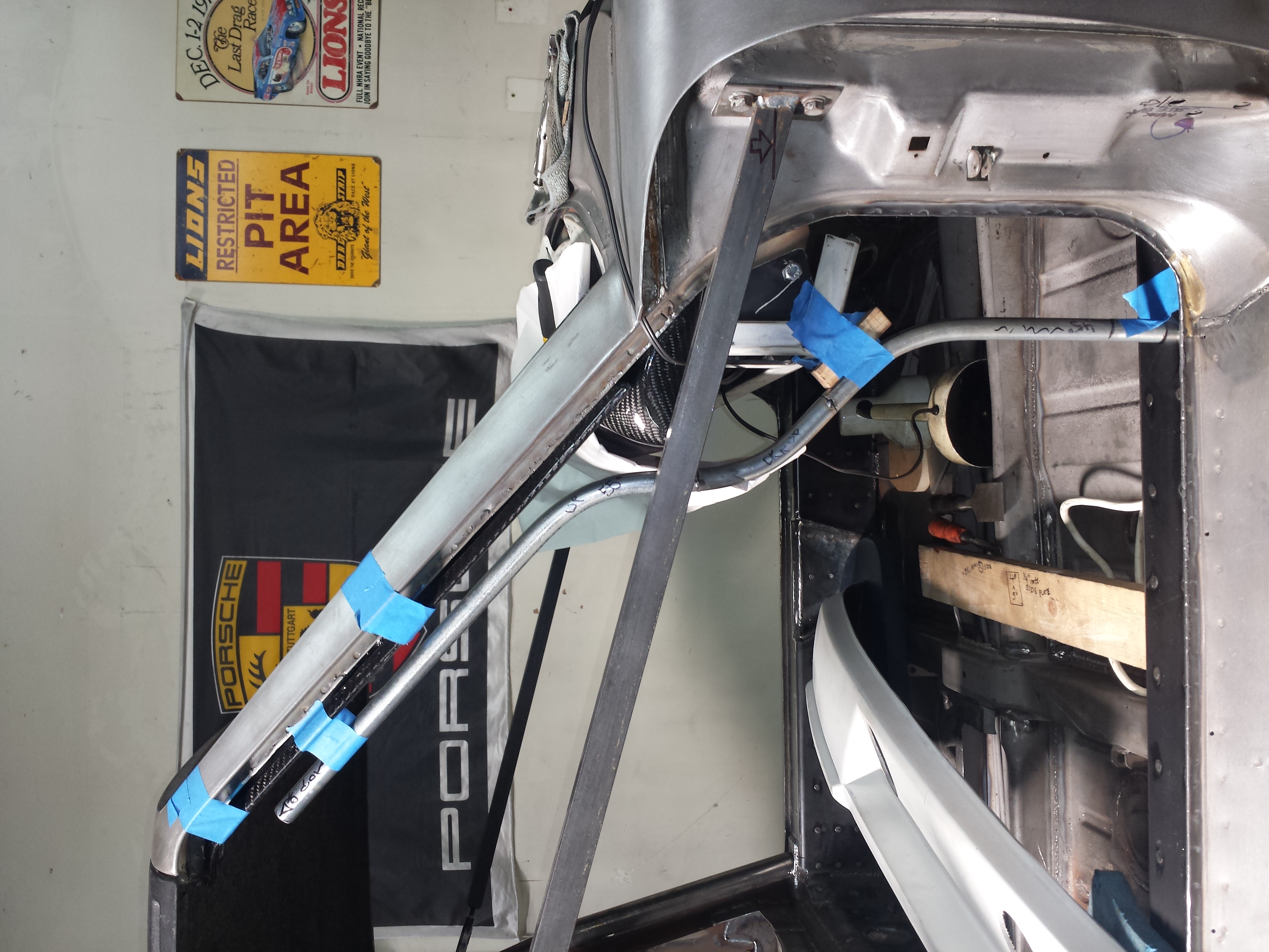

Here's a look at the progress so far.
We've cut the doors for the roll cage / "NASCAR" style door bars. Please excuse the 40 year old paint and surface rust. This will all be taken care of in the painting process soon to follow.
(IMG:http://www.914world.com/bbs2/uploads_offsite/i771.photobucket.com-14843-1423556972.1.jpg)
(IMG:http://www.914world.com/bbs2/uploads_offsite/i771.photobucket.com-14843-1423556972.2.jpg)
Here you can see the wooden mock up for the rear support bars. This was then cut to fit in metal and welded in.
(IMG:http://www.914world.com/bbs2/uploads_offsite/i771.photobucket.com-14843-1423556972.3.jpg)
(IMG:http://www.914world.com/bbs2/uploads_offsite/i771.photobucket.com-14843-1423556972.4.jpg)
The Tangerine Racing Heim Rod Braces have been welded in.

Beautiful build! What size rectangular tubing is your rear chassis supports? They look strong enough to handle what you're doing to it! (IMG:style_emoticons/default/popcorn[1].gif)
Thank you for your comment...the left +right longitude are
1×4 , the smaller side pieces are 1x3; both are .120" ga.
The mating back piece that is welded along the rear trunk section is 2x2 angle @ .250" ga.

I use a contractors EMT bender and tubing to create the sample bends for the cage work. Then the samples are used for the real bends which are mandrel formed in 1.750 x .120" wall.Attached Image

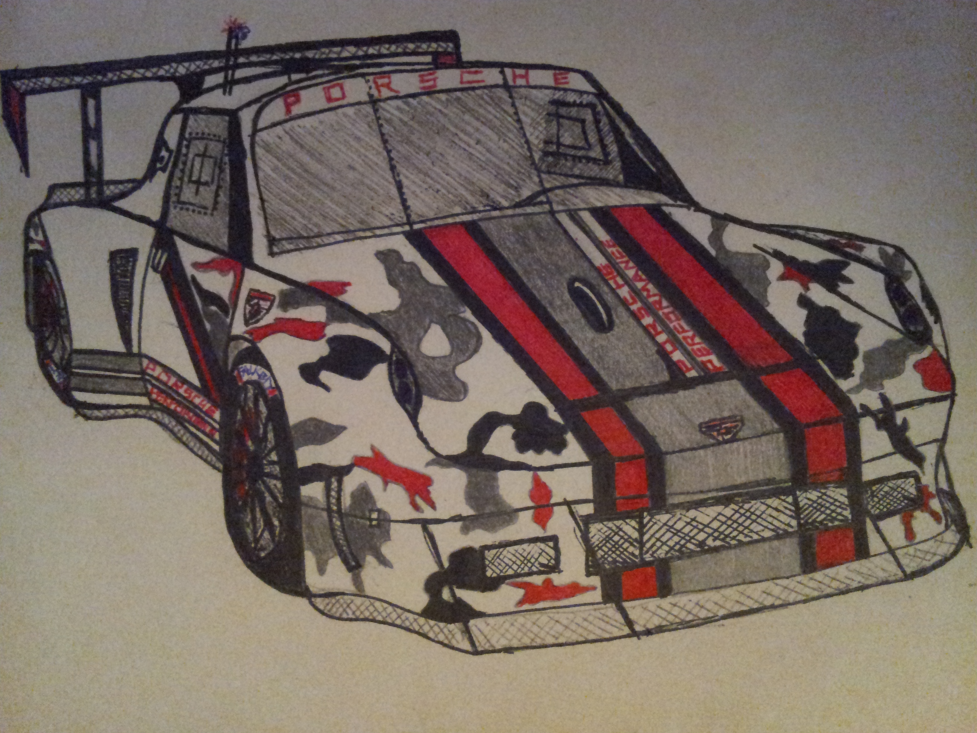

When the Cayenne was introduced, Matt sketched this concept on a paper napkin at Big Sur campgrounds. The final livery will be penned in a few months.

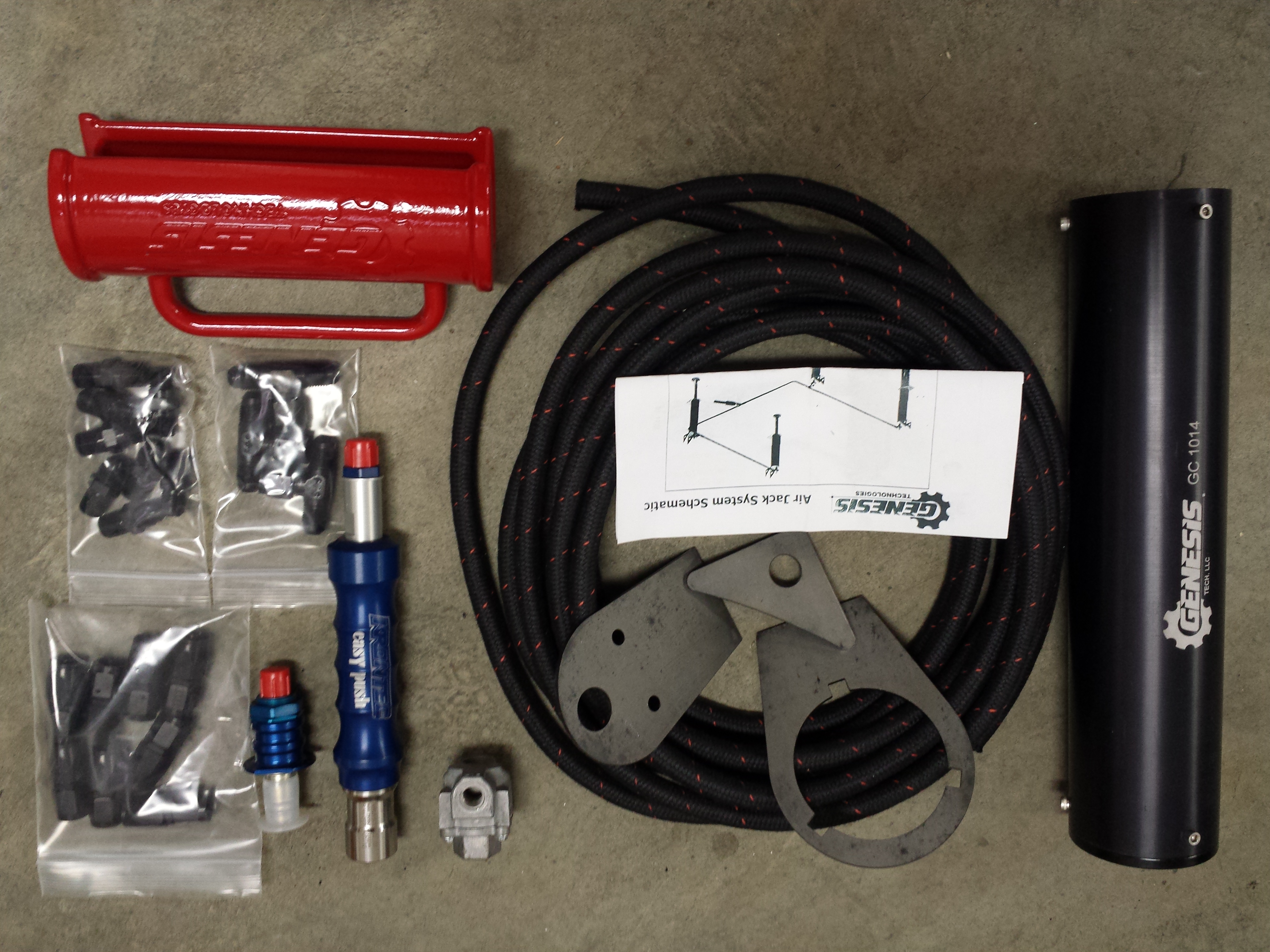

More welding chores this weekend:
On board air jack system, our car uses 3 total. The red looking "Beer stein" is a pit jack-stand that adds extra security during longer pitting. The air jack piston travels downwards approx.9" . With the car at 5" ride clearence, we should get another 4" ground clearence for tire changing. (IMG:style_emoticons/default/welder.gif) Attached Image
