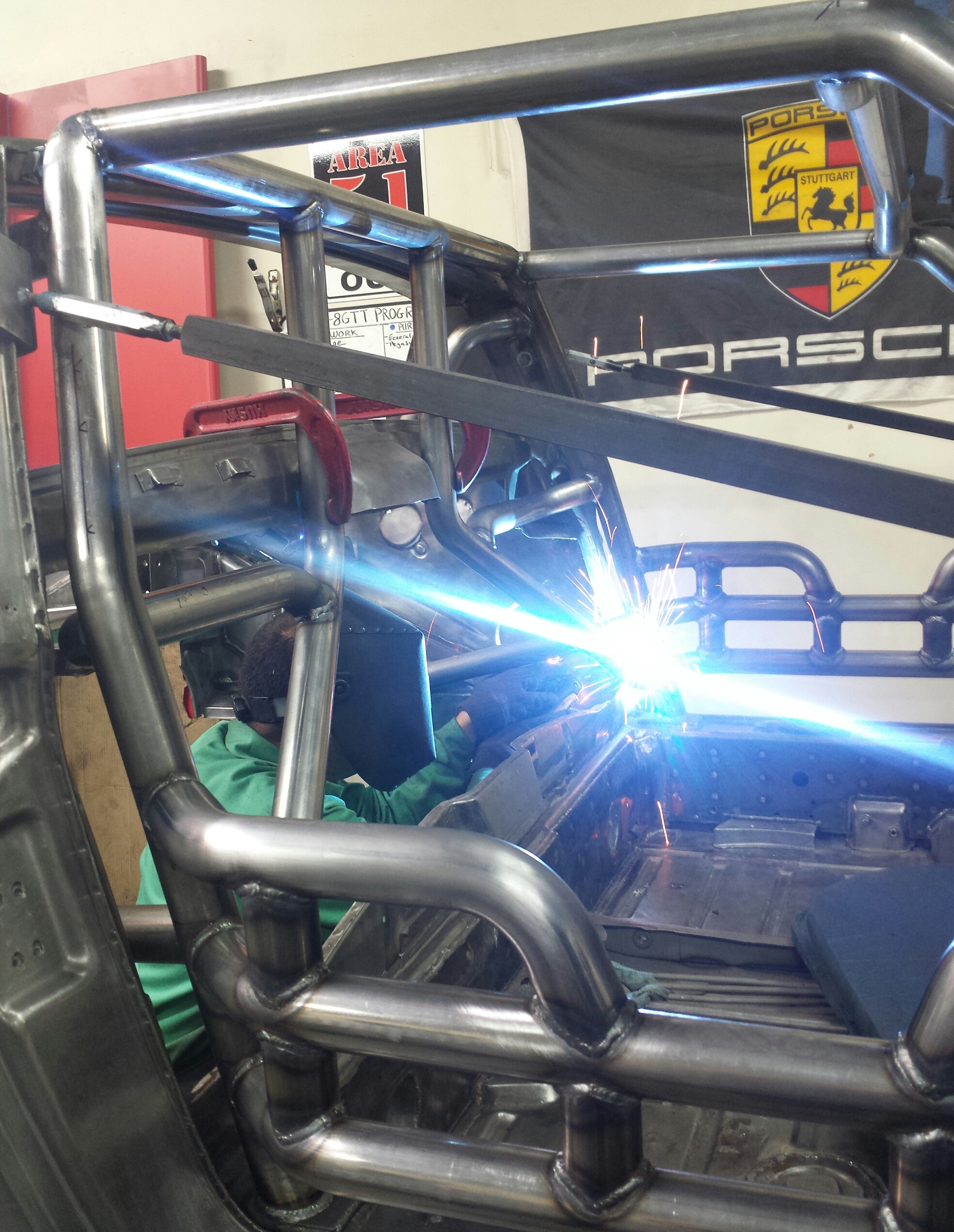

Not posting much on the build right now...but here's one Attached Image

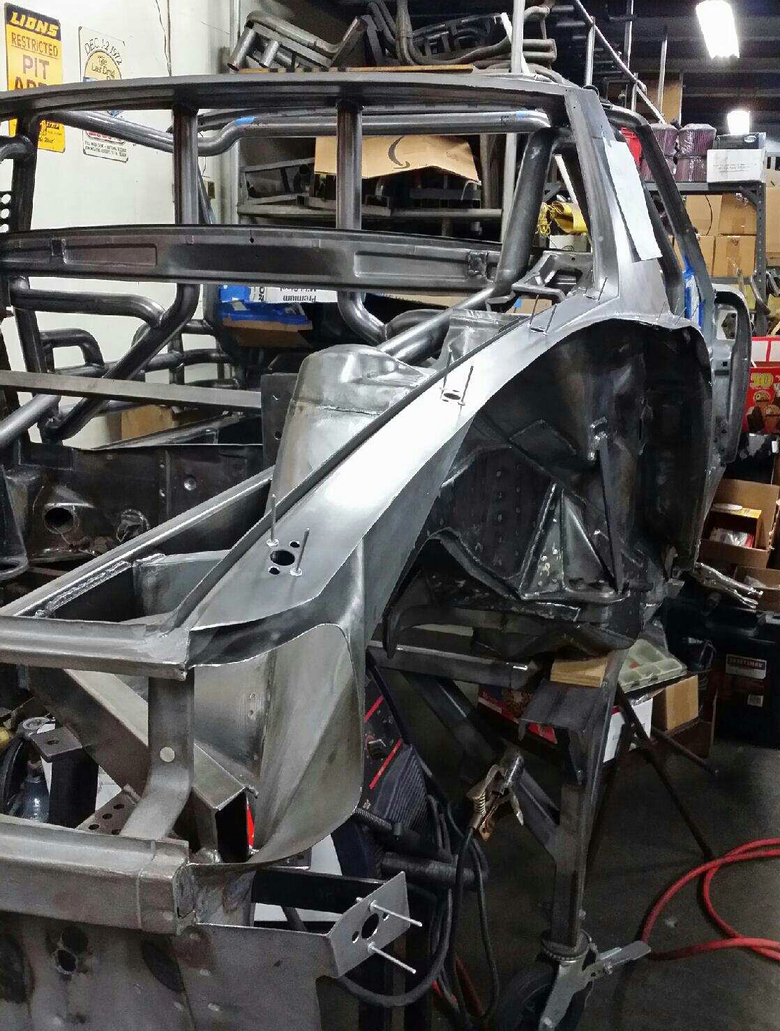

...one moreAttached Image

wow...that is one-helluva cage...the tubing is bigger than my exhaust!
Sweet!

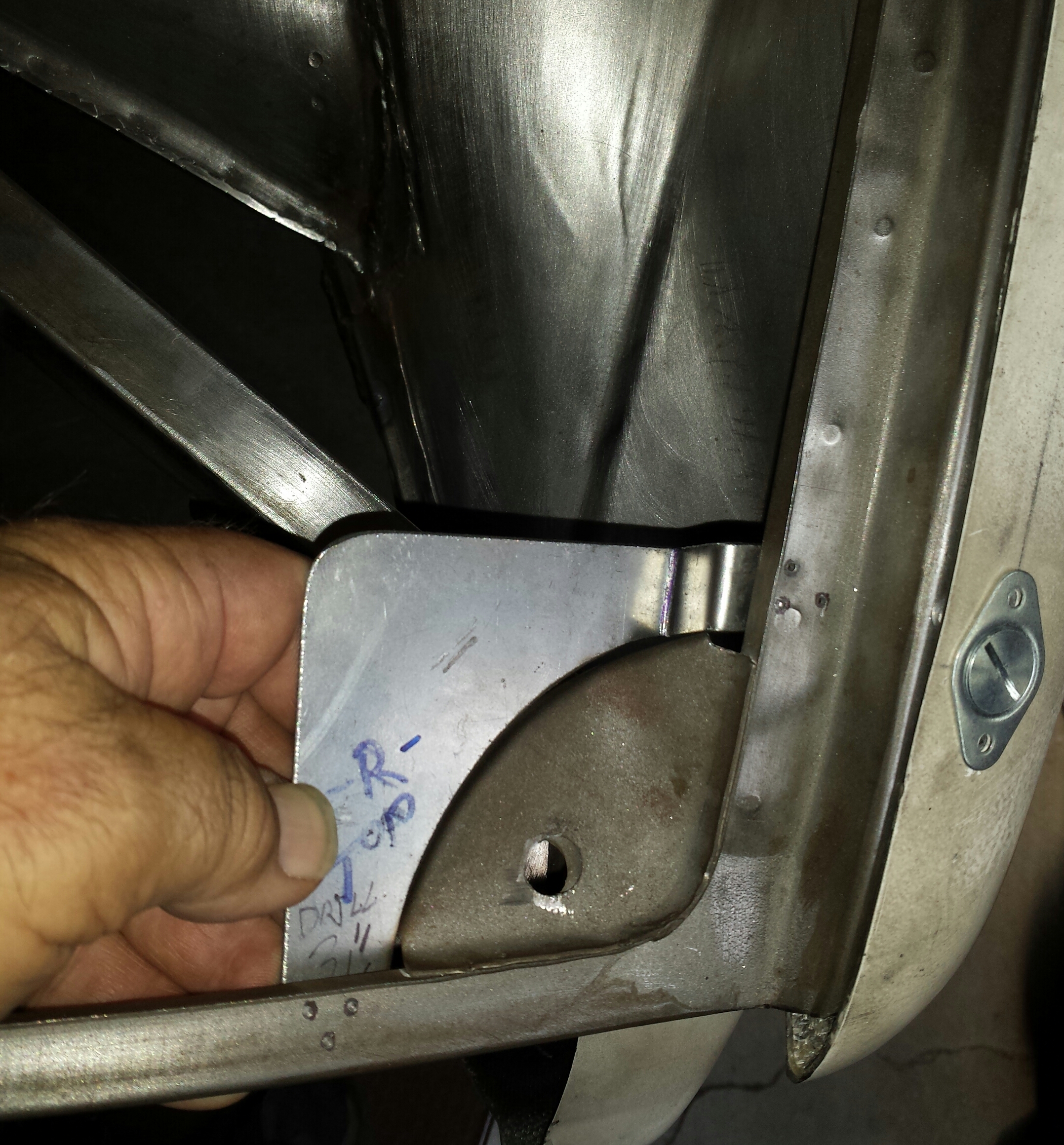

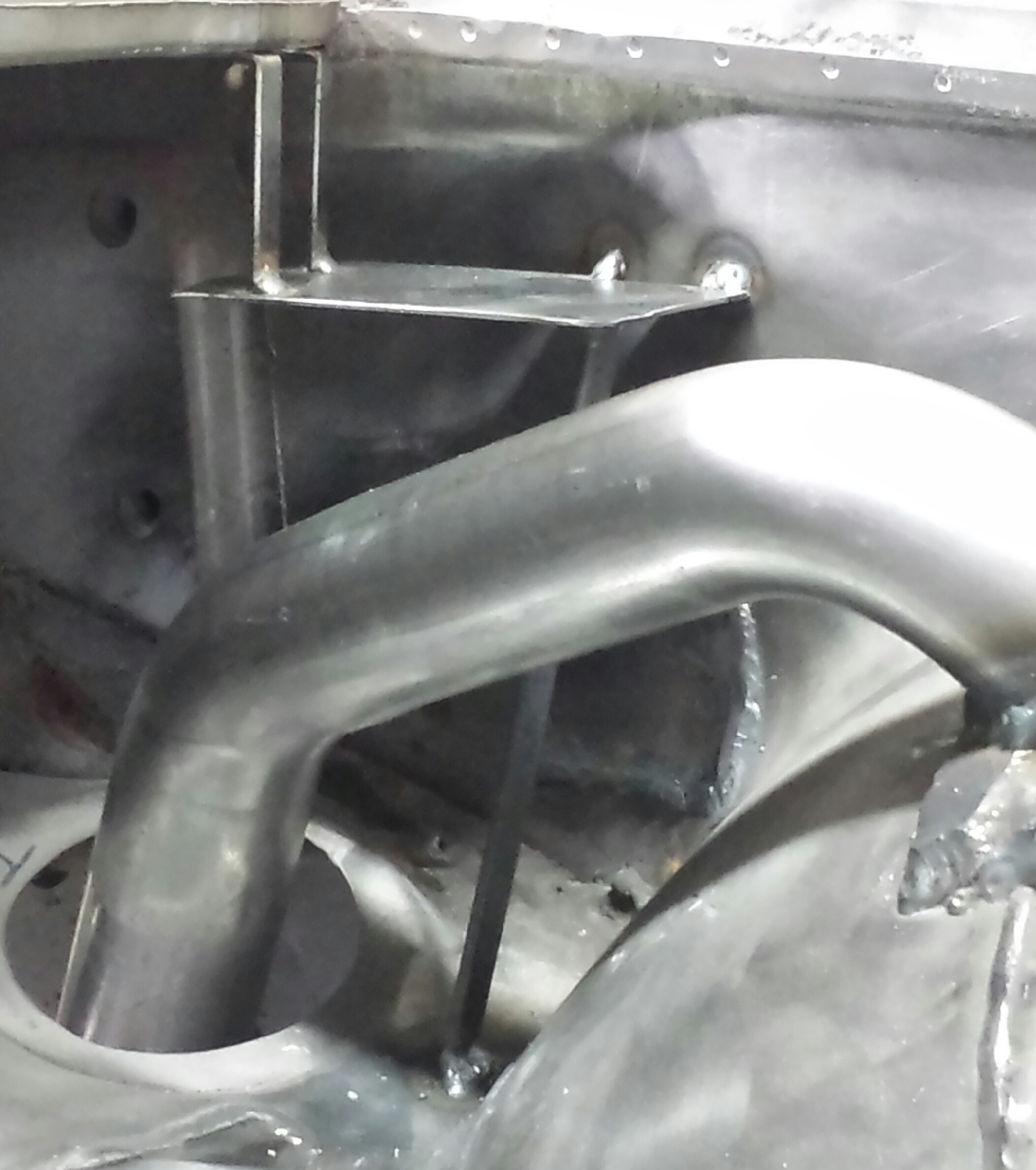

Work going on in the front trunk area, for the AeroLatch brackets Attached Image

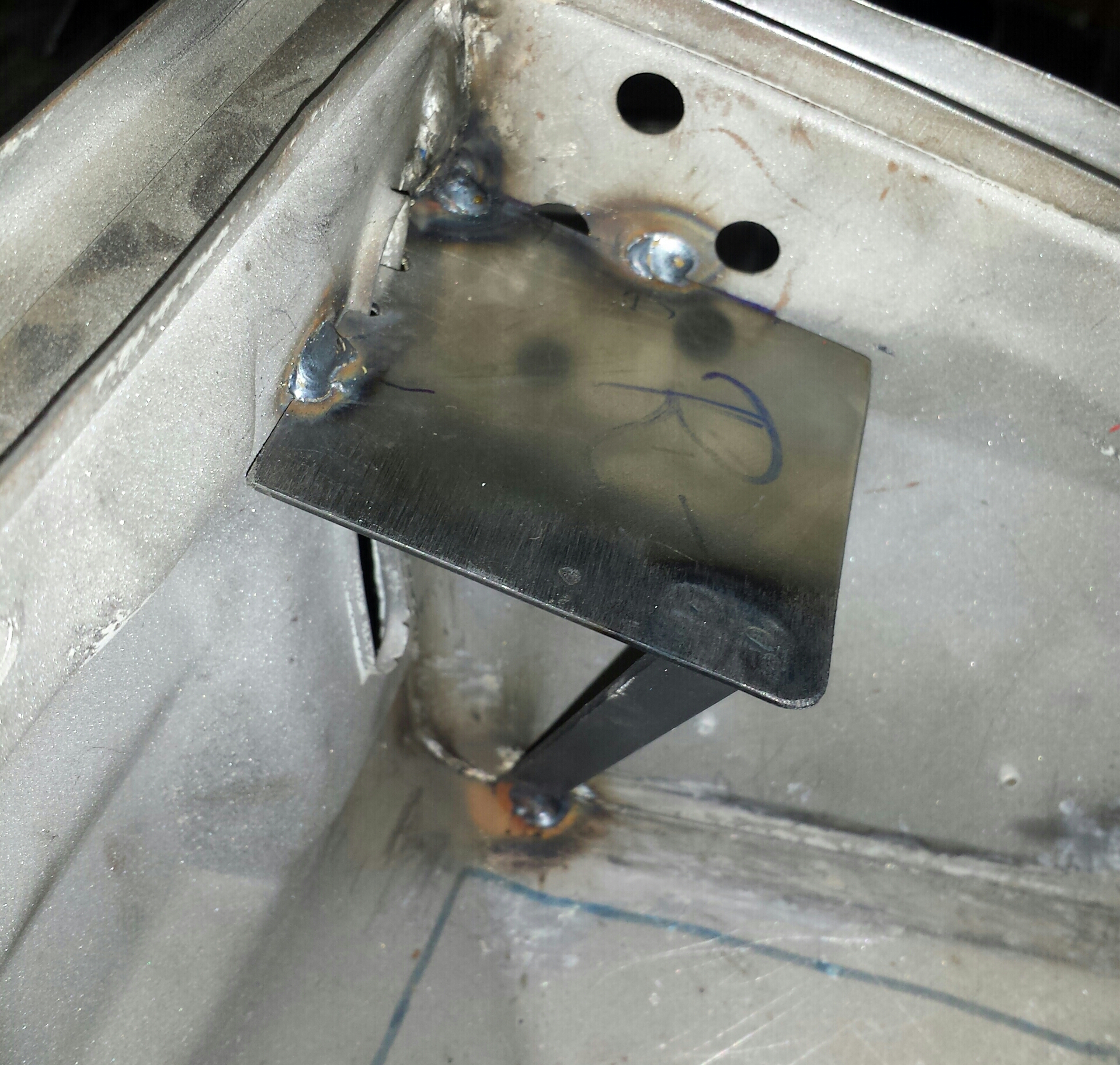

Forward area of the trunk, in the headlight bay. ..also for the AeroLatch.
Four in total to hold down the front trunk.Attached Image

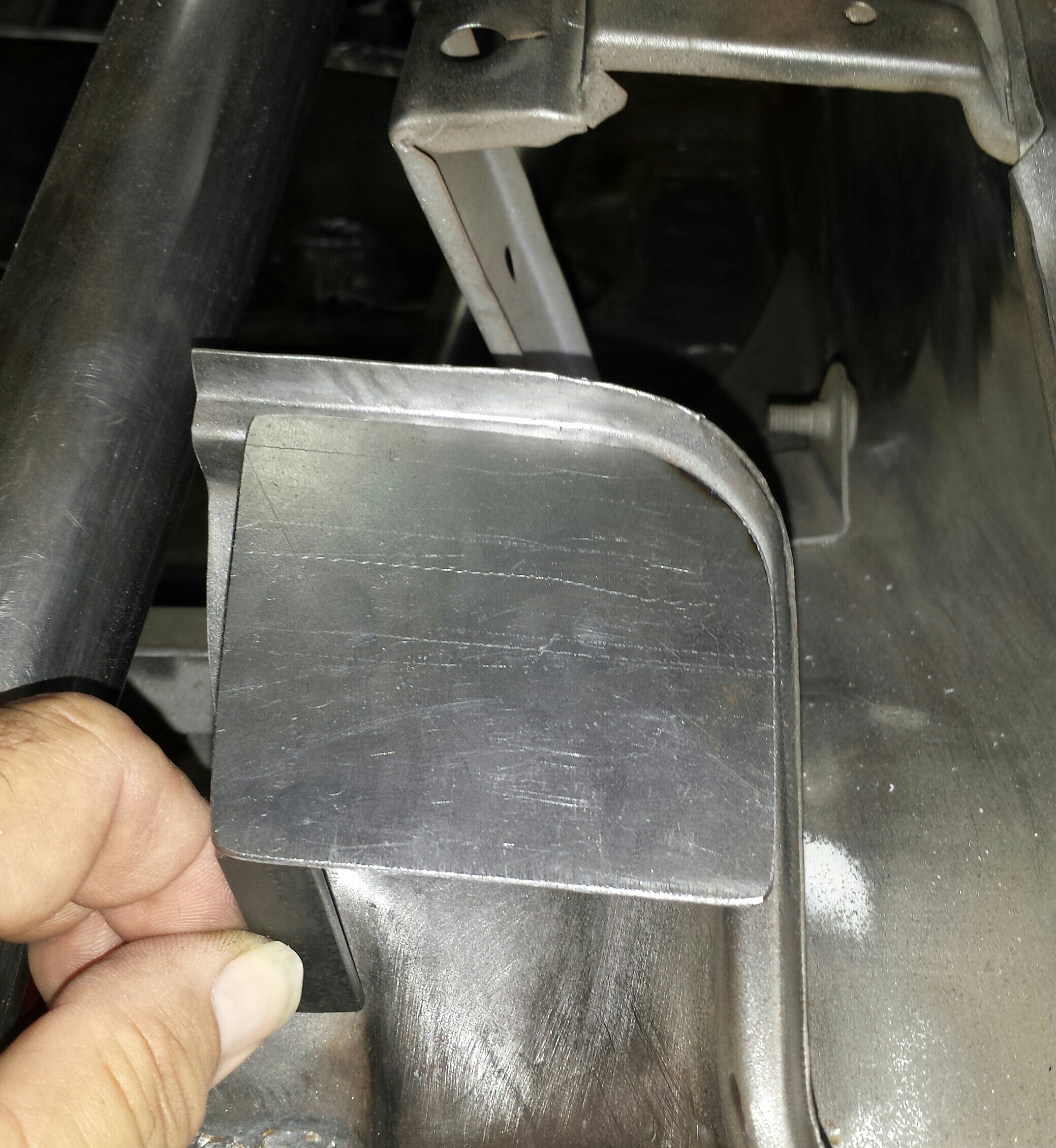

Rear trunk AeroLatch bracket layoutAttached Image

Total of 4 AeroLatch brackets in the rear trunk.
These small attachments are welded to the existing "Bumper stop adjuster" trunk lid plates....makes for a decent landing area for the latches.Attached Image

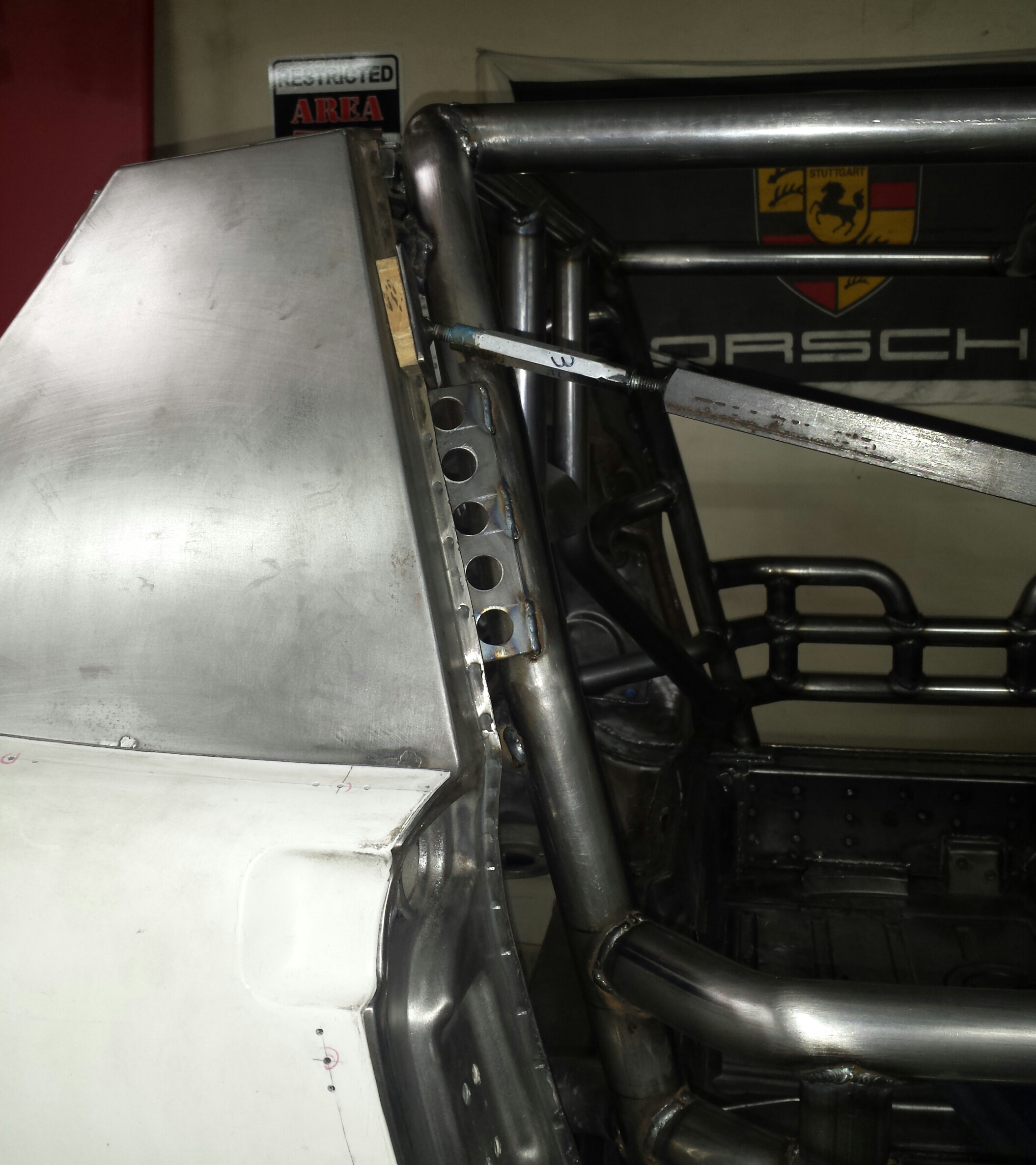

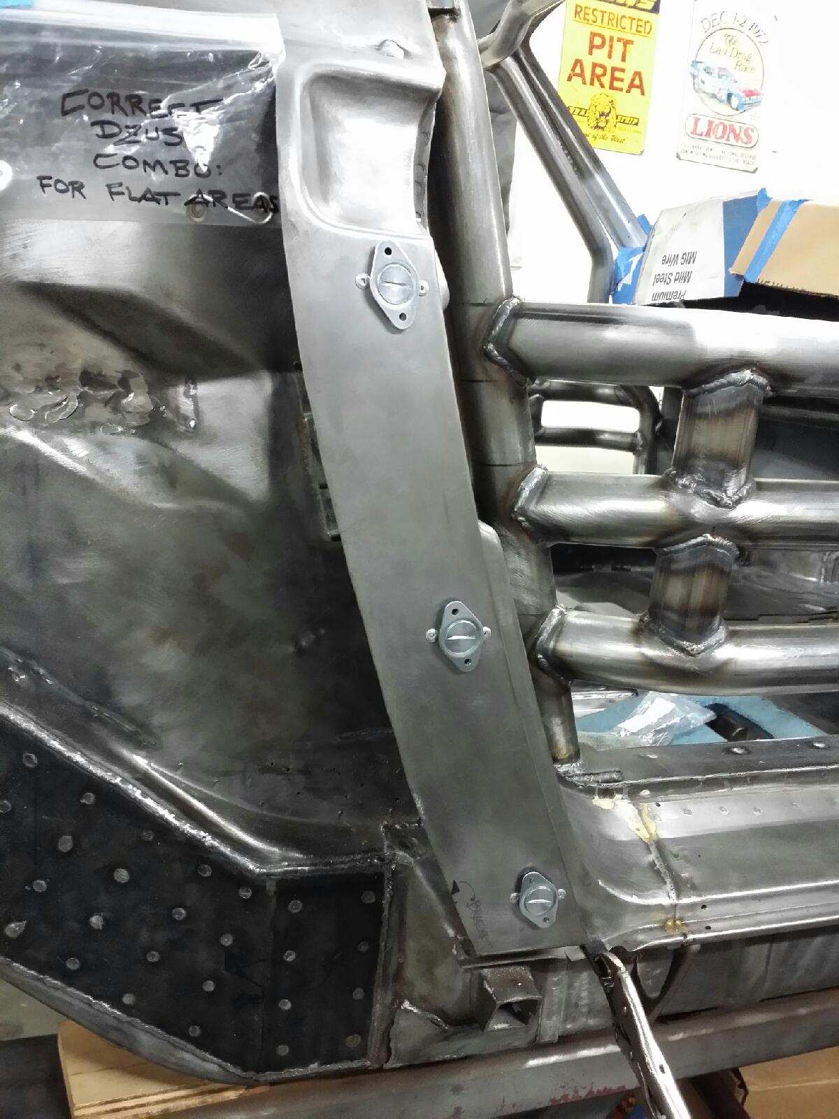

Dzus fastener 101. This was my first experience with these fasteners.
Pegasus Racing supplied the parts, some racing buddies and the Internet gave me the education. So the rear quarter panels provided the learning curve. I should be A+ by the time I reach the fiberglass front end !Attached Image

Leading edge test fit, Right quarter.Attached Image

post Sep 3 2015, 01:49 AM
Post #160
Posts: 5,473
Joined: 14-September 04
From: Mulholland SoCal
Member No.: 2,755
Right quarter taking shape on the 914 unibody.Attached Image
