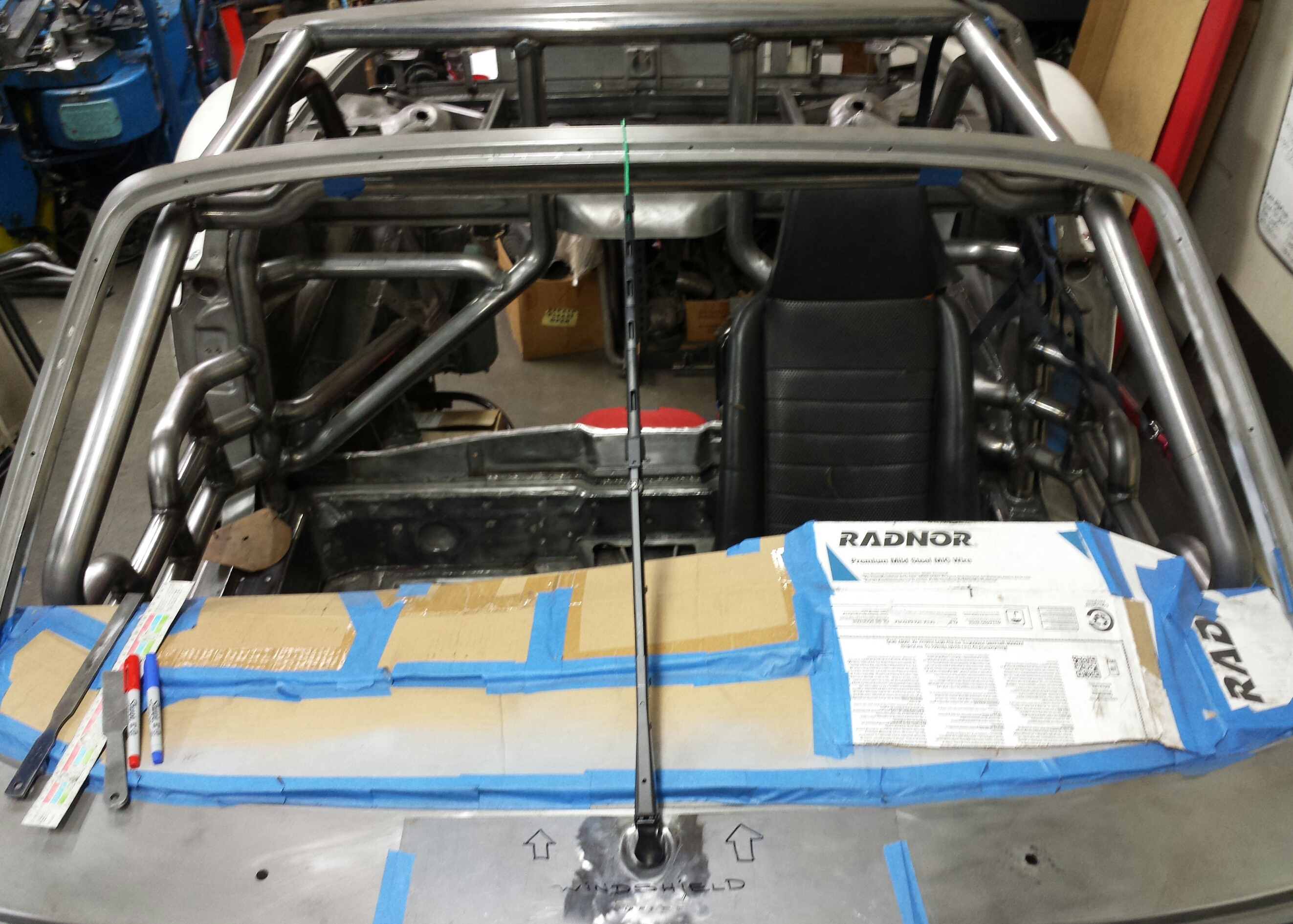

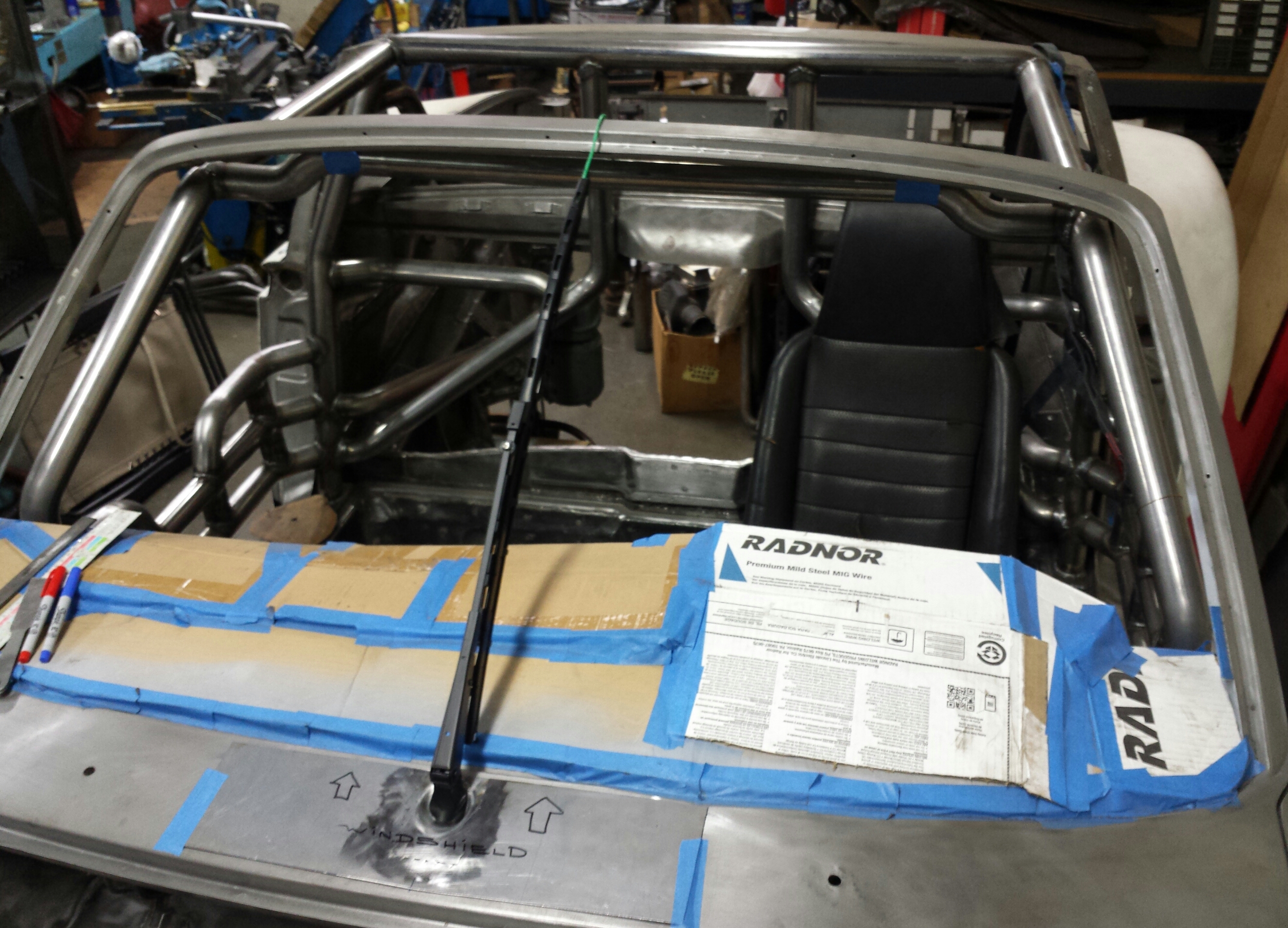

Setting up the sheet metal for the new mono-wiper on the cowl. Attached Image

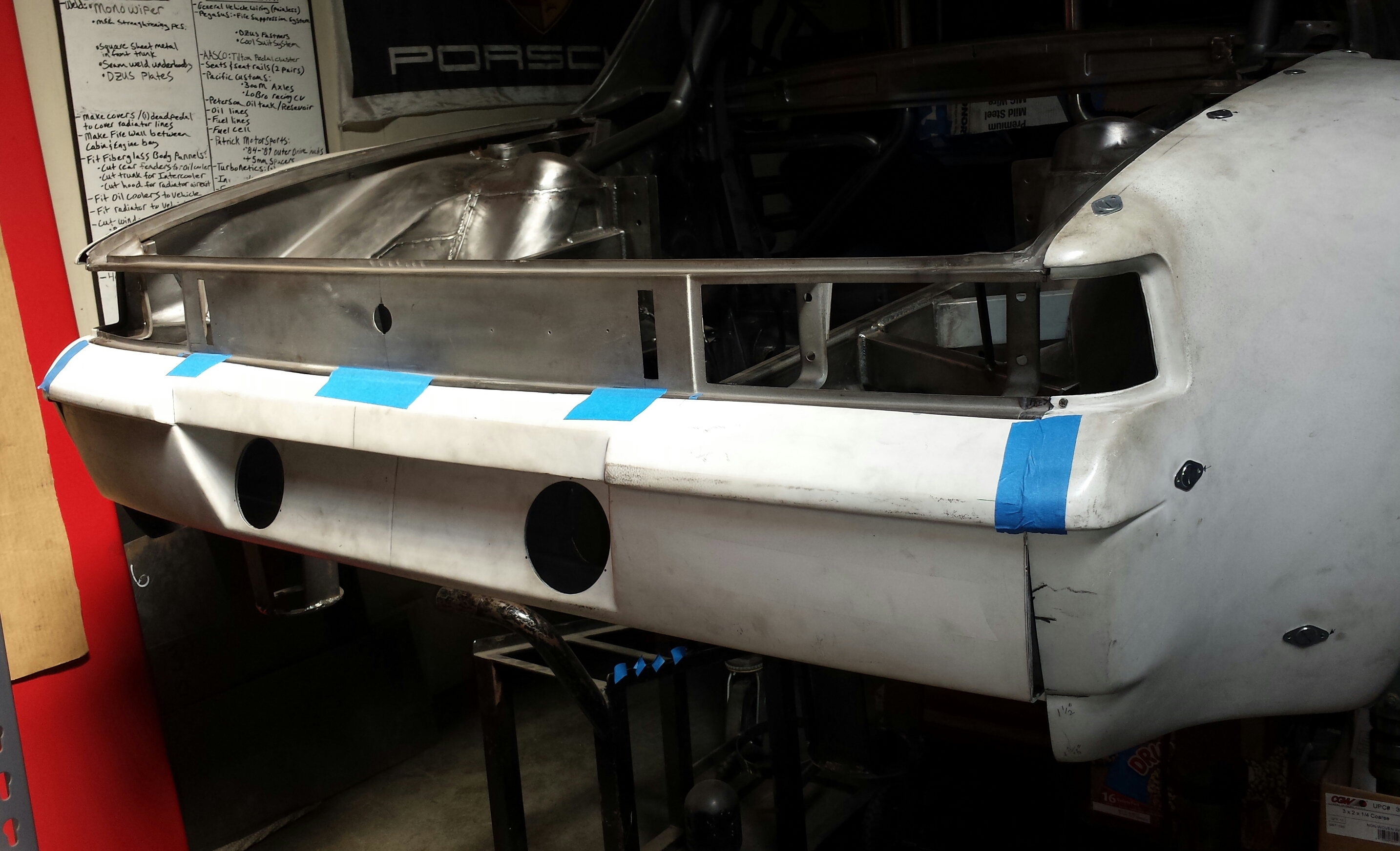

Placement and final trimming for rear bumper fitment.
With this brand (A.I.R.) fiberglass bumper, you can't use the factory dog bones...so I will shape my own custom spacers.Attached Image

QUOTE(Maltese Falcon @ Oct 10 2015, 10:22 PM) *
Please so more details on your mono wiper :web:
Guess my real question ones down to motor setup. Hope your modifying something lite in weight. Later Model 911 motor is 4 pounds liter than my 914 motor, as I have modified a rack for that all ready, but, I would prefer to go mono. Which I did on my 914-4 with a Jetta Wiper Arm and Blade. IT was from the pass side location, did a great job, for what little rain the car sees. That and Rain-X. My plan includes filling the center vent, so I might as well do the cowl, and make it a true mono wiper.

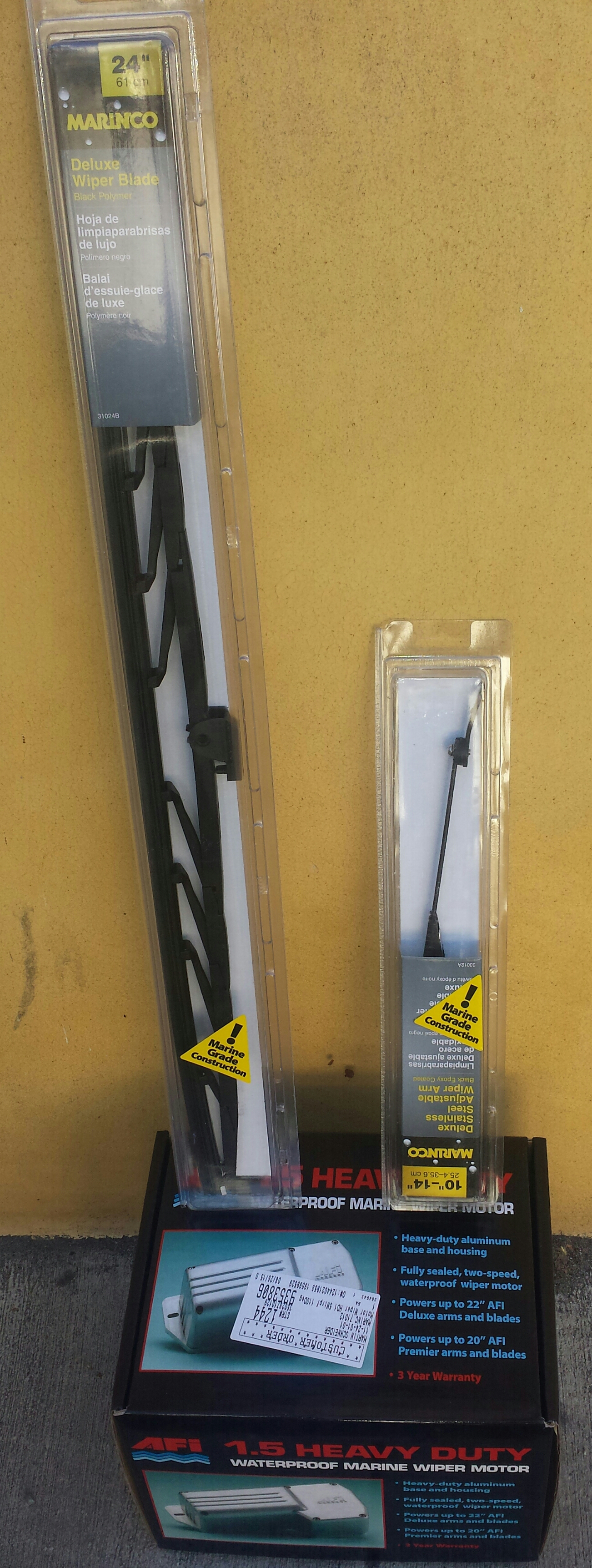

The mono wiper is a combination of AFI and Marinco watercraft items.
The blade is 24", arm is adjustable from 10"-14". I chose this method as there are no rods or mechanisms involved. The sweep, park of the blade is adjusted by a cam inside the motor unit. It is also has 2 speeds. A simple bracket system to hold it, and a 5/8" shaft adapter bushing is all that's needed. (IMG:style_emoticons/default/smile.gif) Attached Image

Thats cool and probably period correct for racers. However the mono on my wifes old E320...well...it works good on sunny days (IMG:style_emoticons/default/lol-2.gif)

monoemono (IMG:style_emoticons/default/beerchug.gif) Great choice of motor (IMG:style_emoticons/default/first.gif)
dont forget to get a chiwawa to ride shotgun (IMG:style_emoticons/default/driving.gif)a
that blade may be to long ,,unless you have a pantograph style arm ??

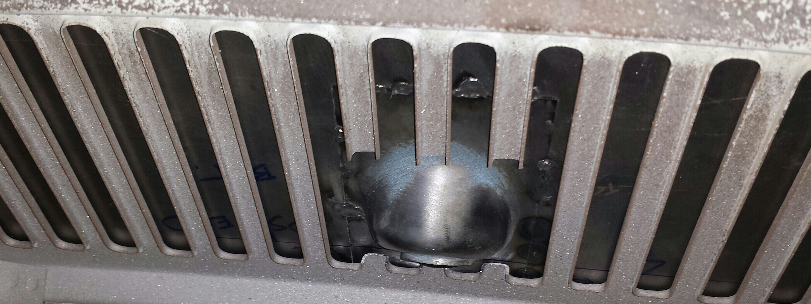

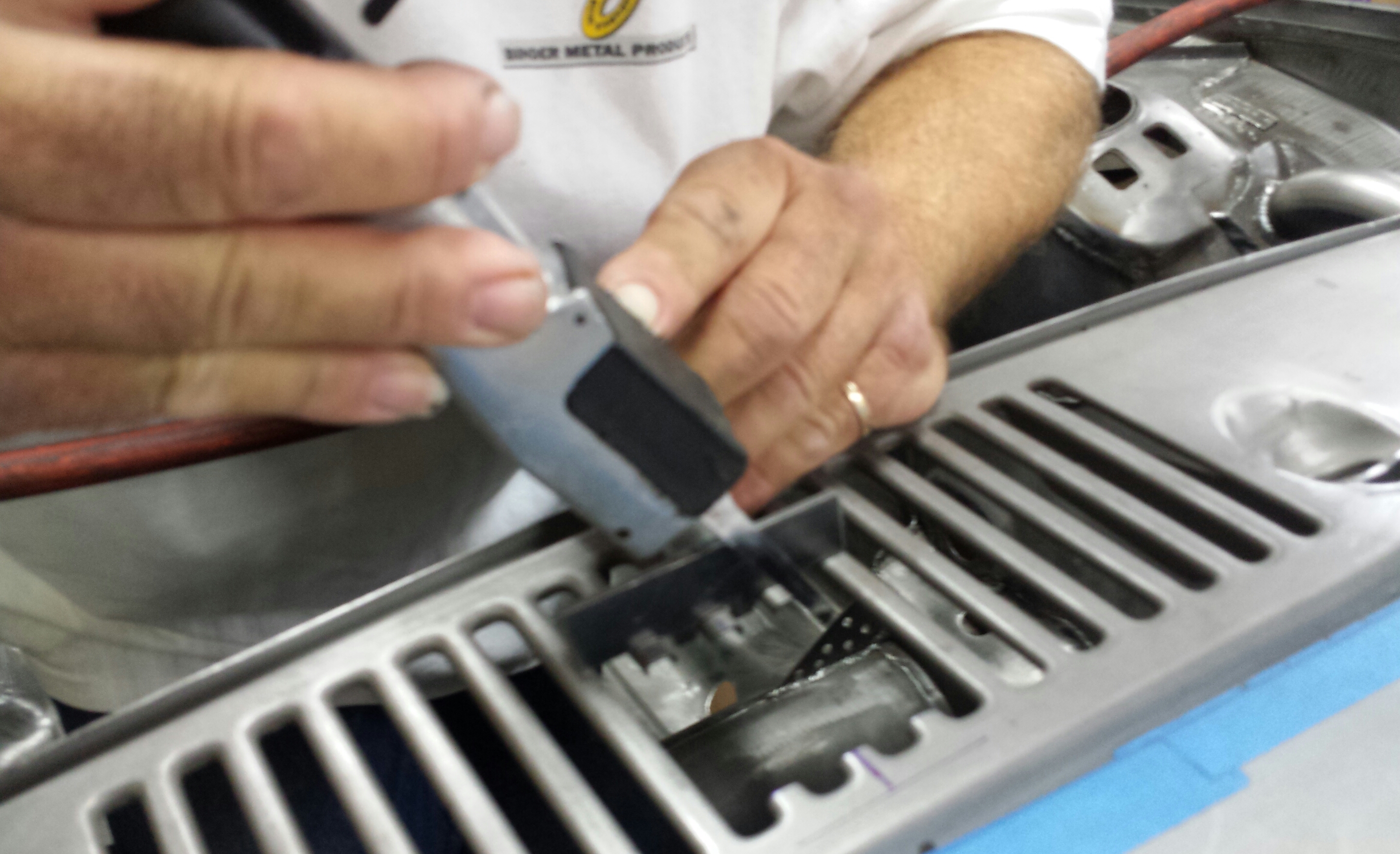

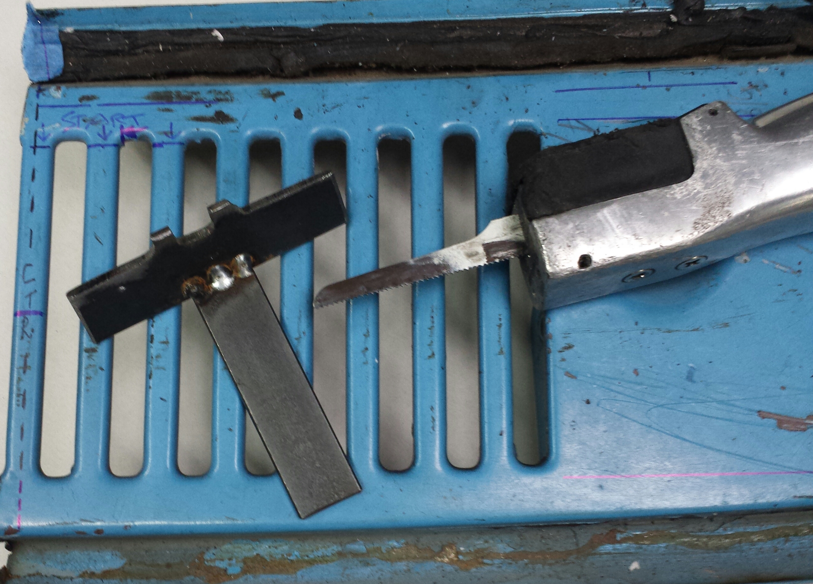

A custom tool that I fabb'd up, it holds the vents down in place on the cowl while I'm cutting away. The tool is held down on the sheet metal with one hand while I run the small saw with my other hand.Attached Image
Maltese Falcon
post Oct 16 2015, 09:54 PM
Post #192
Posts: 5,473
Joined: 14-September 04
From: Mulholland SoCal
Member No.: 2,755
The placement of the holding tool; the grille "Fingers" stayed in place while cutting...nothing bent or damaged.Attached Image
Maltese Falcon
post Oct 16 2015, 10:02 PM
Post #193
Posts: 5,473
Member No.: 2,755

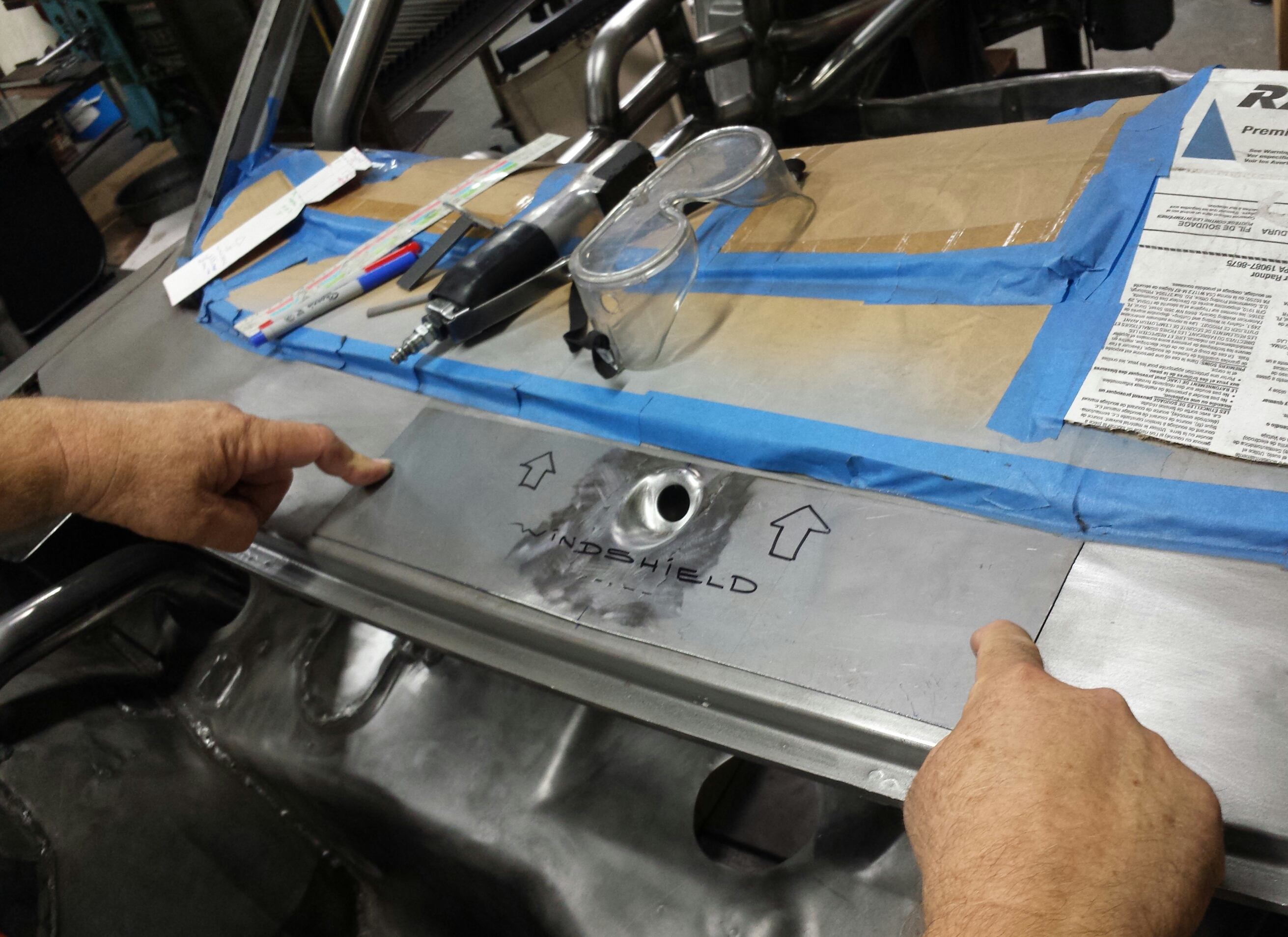

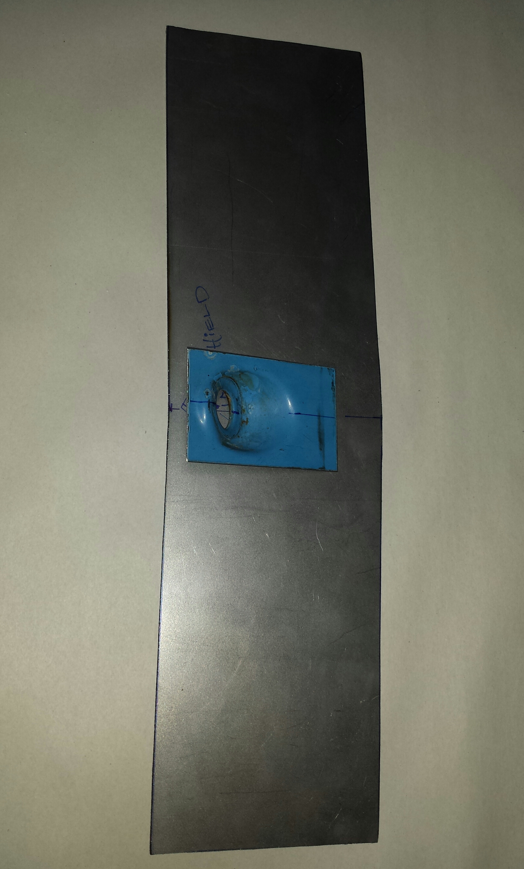

Cutting out the recess for the bottom of the new mono-wiper/ 18 ga. mounting plate. The hold down tool also doubles as a safety buffer for my fingers while cutting.Attached Image
Maltese Falcon
post Oct 16 2015, 10:05 PM
Post #194
Posts: 5,473
Member No.: 2,755
Trial fit and almost ready for welding in place.Attached Image
Maltese Falcon
post Oct 16 2015, 10:09 PM
Post #195
Posts: 5,473
Member No.: 2,755
As viewed from under the cowl, recess is approximately 2" x 2" area.Attached Image
