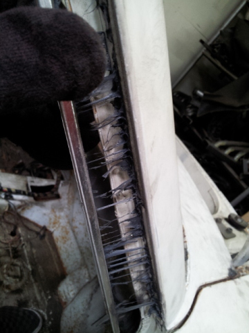

QUOTE(stateofidleness @ Mar 14 2013, 07:53 PM) *
how do you/did you remove the glue residue from where the backpad was in the engine compartment without removing the paint?
I'm in the same boat and I want to get rid of the residue left behind but I don't want to remove any of the paint if I don't have to.
<forgive me if that's a noob question>
i used a gallon of goof off. its not so harsh on the paint underneath.

QUOTE(mrbubblehead @ Mar 14 2013, 09:32 PM) *
That's great information to know...wonder if ScottyB knows about this trick...

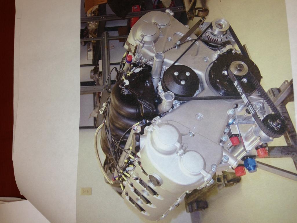

An LBP 5.0 cayenne v8 n/a built to Daytona Prototype spec.
Circa 2010.
Marty Attached Image

Member No.: 814
QUOTE(stateofidleness @ Mar 14 2013, 10:53 PM) *
I used Purple Stuff, worked fine.

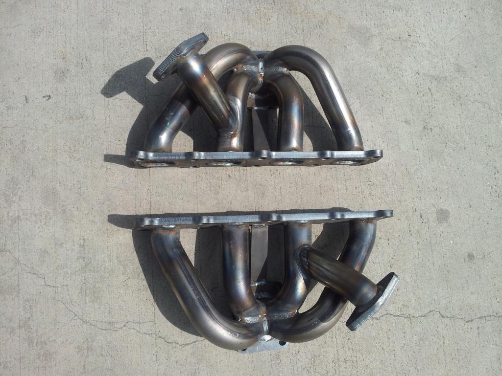

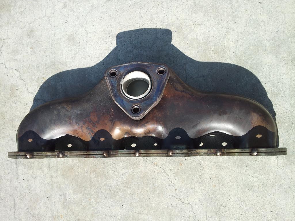

One of the oe turbo exhaust manifolds.
You can just about pass a silver dollar through the discharge.
Too small for our turbonetics gtk.
Not even tubing, just 2 low grade stainless steel clam shells welded together.
We are designing some tubular Shorty turbo headers for decent spooling.Attached Image

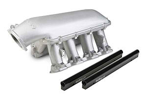

The "Flying mailbox" intake plenum.Attached Image

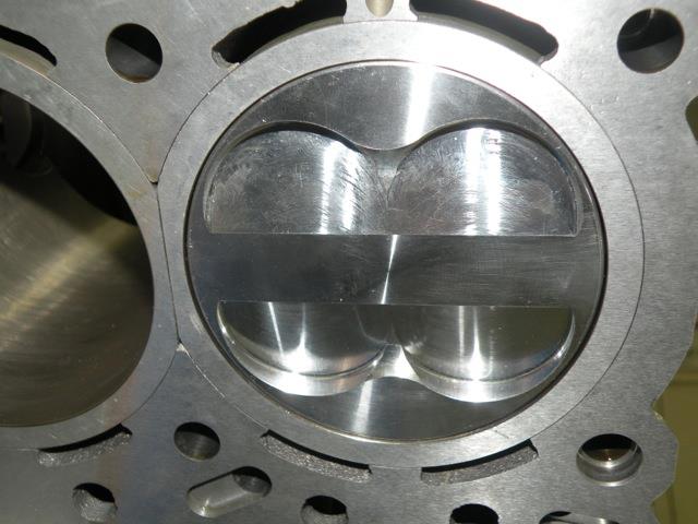

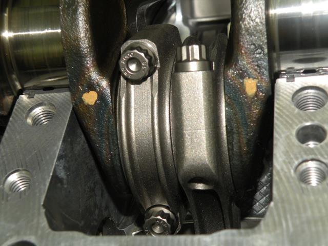

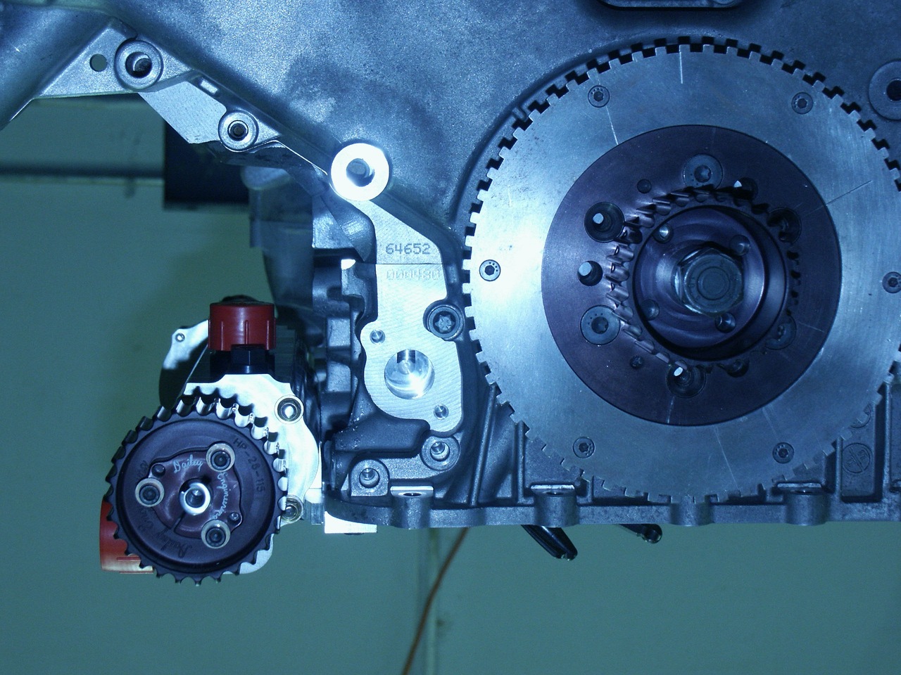

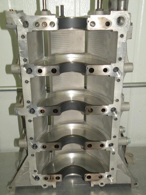

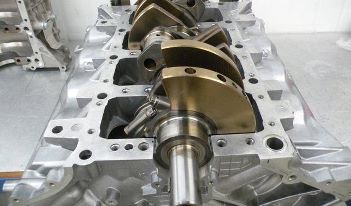

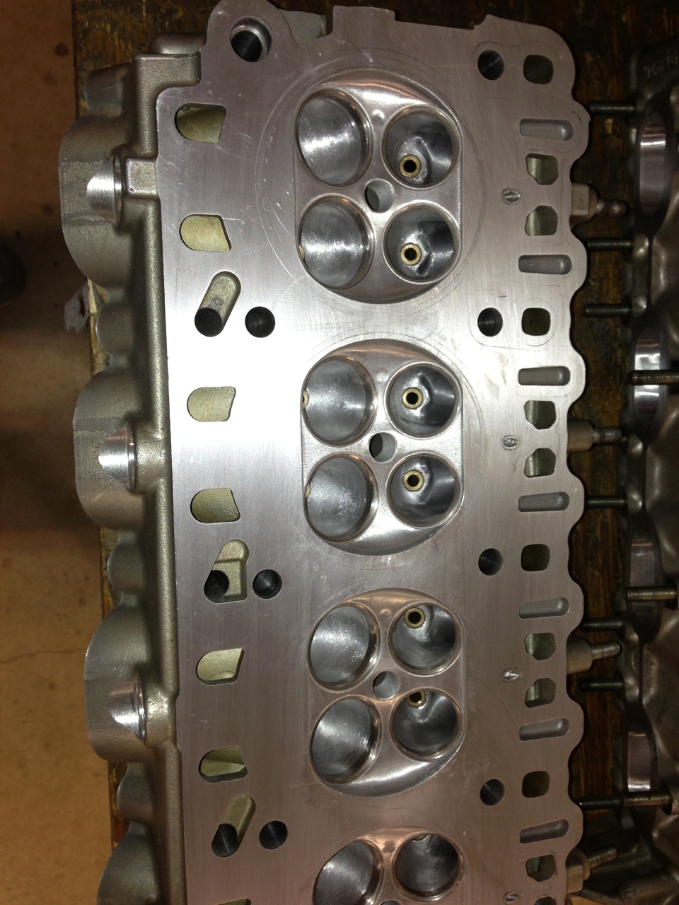

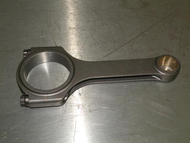

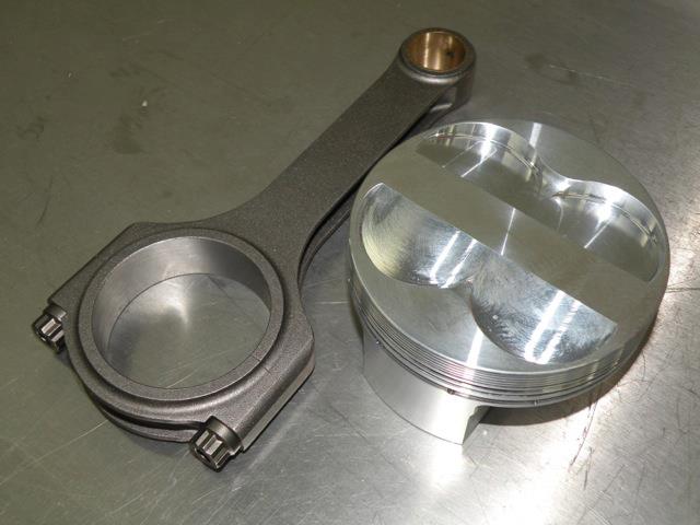

Here is my 5.3 liter engine based from the 4.5 Cayenne. This is the normally aspirated configuration going into the LN Engineering Cayenne S. Next comes the 5.5 TT version for Beth's beast.
Genuine LN Nickies, our own billet rods, true 4 valve piston design from JE and all the other goodies. Having fun developing these components, engine designs and assembly procedures.
Nothing like doing it all from scratch... This is a 13:1 daily driver. The 6 liter stroker version is going to be a lot of fun to complete, for sure.

QUOTE(sixnotfour @ Mar 24 2013, 06:14 PM) *
And what does this has to do with ????
These are Cayenne engine internals..

Deep breathing for the new gtk's . Mandrel formed, Laser cut flanges ,
better spool up time. Attached Image

Here you can see the 35+ years of Germany's finest glue coming off the aluminum trim from the A pillar. Also, if anyone is looking for near perfect 914 aluminum trim pieces PM me.

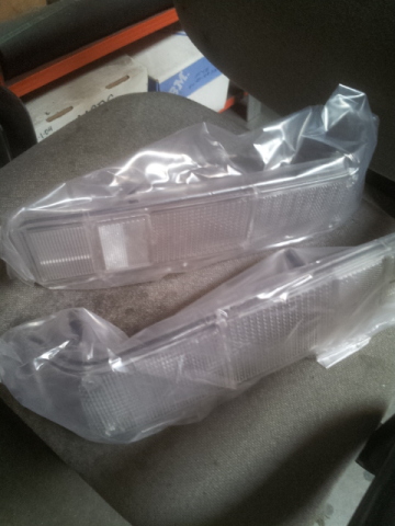

These are the clear tail lights that came in from Auto Atlanta. They'll fit right in for that modern look we're going for.
(IMG:http://www.914world.com/bbs2/uploads_offsite/img16.imageshack.us-14843-1368644739.2.jpg)

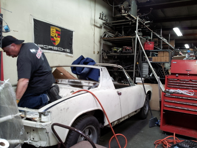

Cutting out the trunk floor pans
(IMG:http://www.914world.com/bbs2/uploads_offsite/img442.imageshack.us-14843-1368644739.3.jpg)

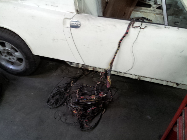

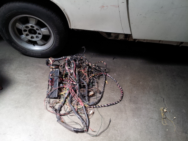

Removing the wire harness
(IMG:http://www.914world.com/bbs2/uploads_offsite/img138.imageshack.us-14843-1368644739.5.jpg)
And completely out! Pictures don't show the work it took to get this all out in one piece justice. PM me if you're interested in this.
(IMG:http://www.914world.com/bbs2/uploads_offsite/img10.imageshack.us-14843-1368644739.6.jpg)

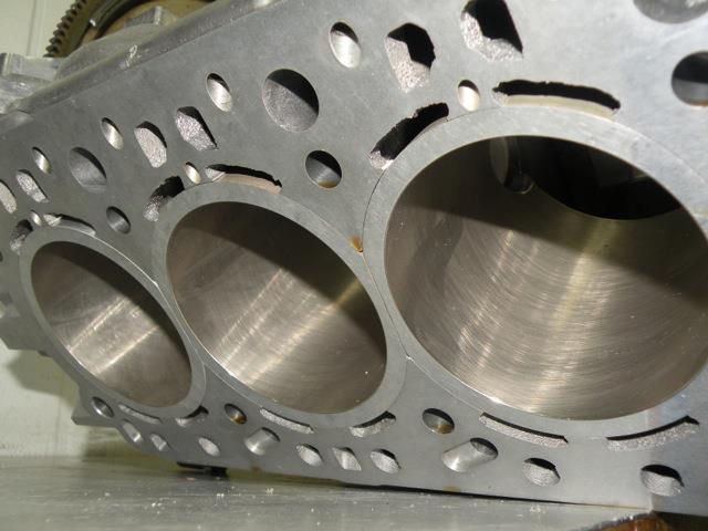

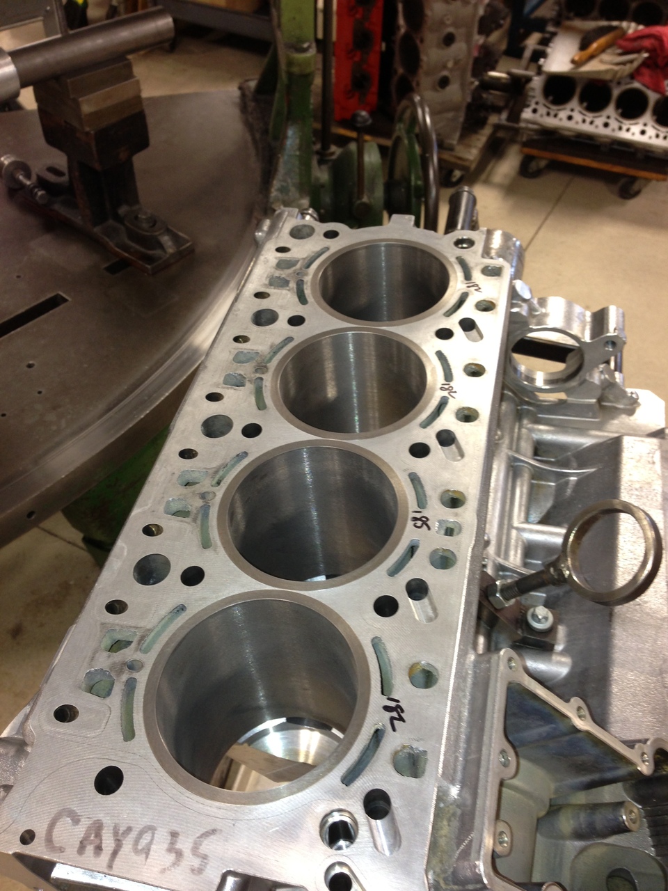

Several engine pics just in from Lozano Brothers Porting. Here you can see the cylinder head porting they have done.
(IMG:http://www.914world.com/bbs2/uploads_offsite/img6.imageshack.us-14843-1368644739.7.jpg)

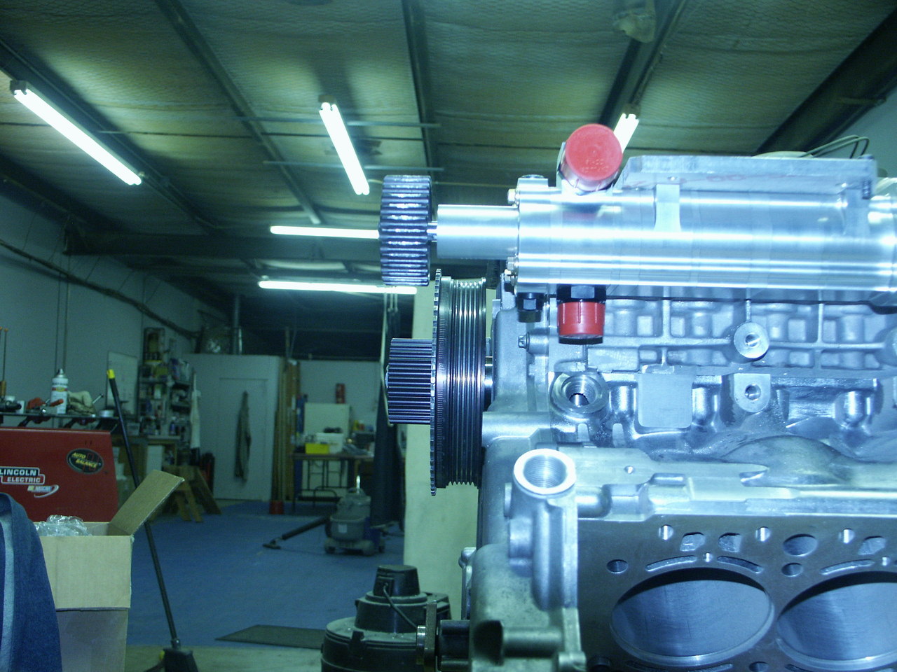

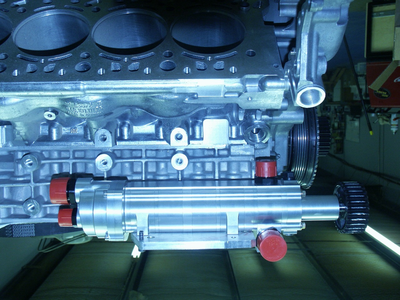

Here is the oil pump being fit, notice no oil pan as it is currently being CNC'd for bottom clearance.
(IMG:http://www.914world.com/bbs2/uploads_offsite/img6.imageshack.us-14843-1368644740.8.jpg)

Here is the block with the iron sleeves fitted
(IMG:http://www.914world.com/bbs2/uploads_offsite/img24.imageshack.us-14843-1368644740.11.jpg)

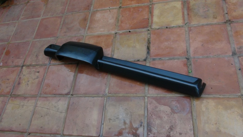

This is the carbon fiber dash that will bring that race car elegance to our project, can't wait till it's finished!
(IMG:http://www.914world.com/bbs2/uploads_offsite/img89.imageshack.us-14843-1368644740.12.jpg)

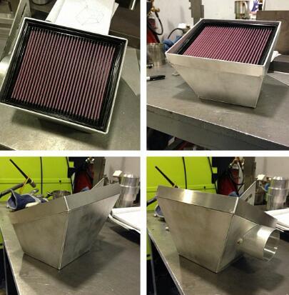

Air intake box idea from BBI's fabricator, "The_Fabricator" of Instagram, we'll be utilizing two of these for the twin turbo set up
(IMG:http://www.914world.com/bbs2/uploads_offsite/img153.imageshack.us-14843-1368644740.15.jpg)
