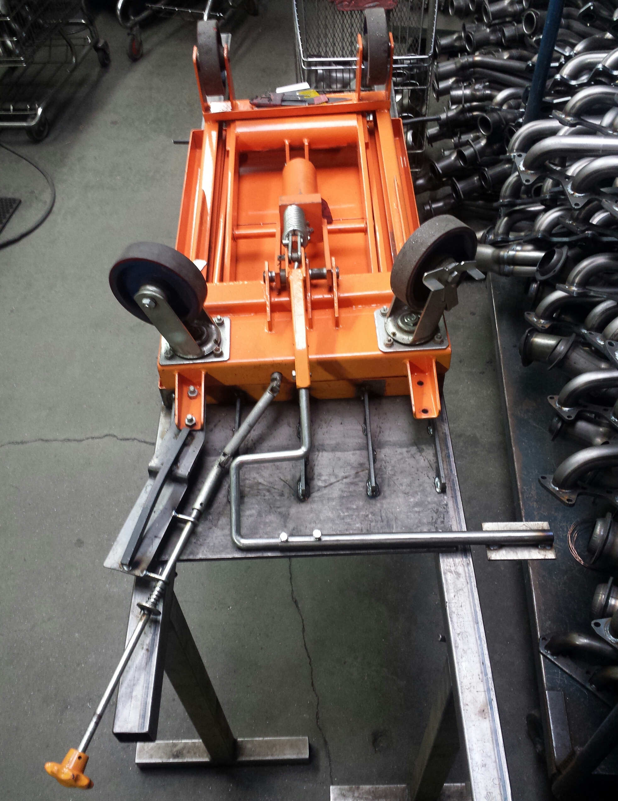

Here's the drive train hoist that we fabricated for about 625 lbs.of engine/Trans placement.
Bottom view; foot pedal, hand control and extended base.Attached Image

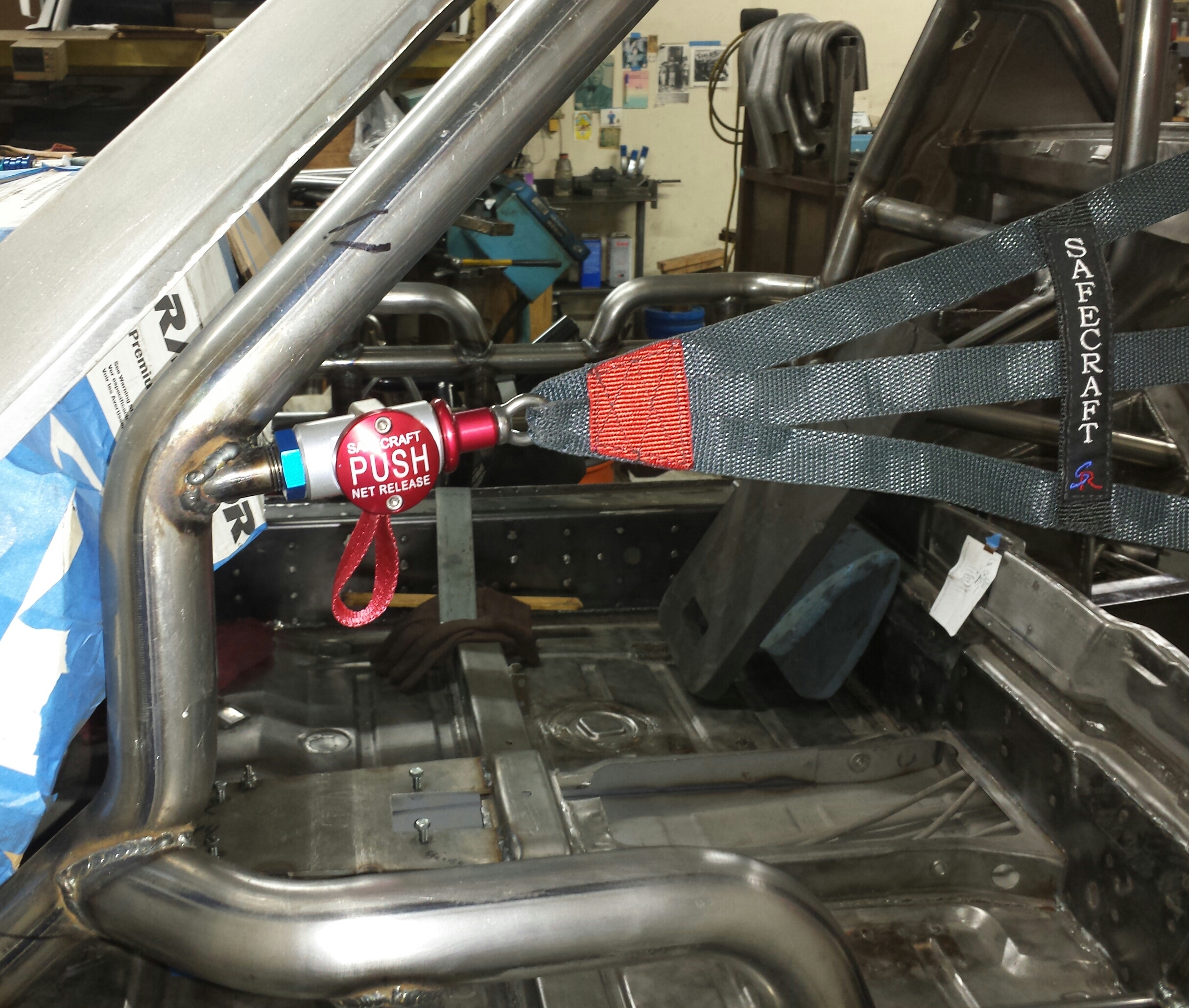

Another view of the quick release for the Safecraft netAttached Image

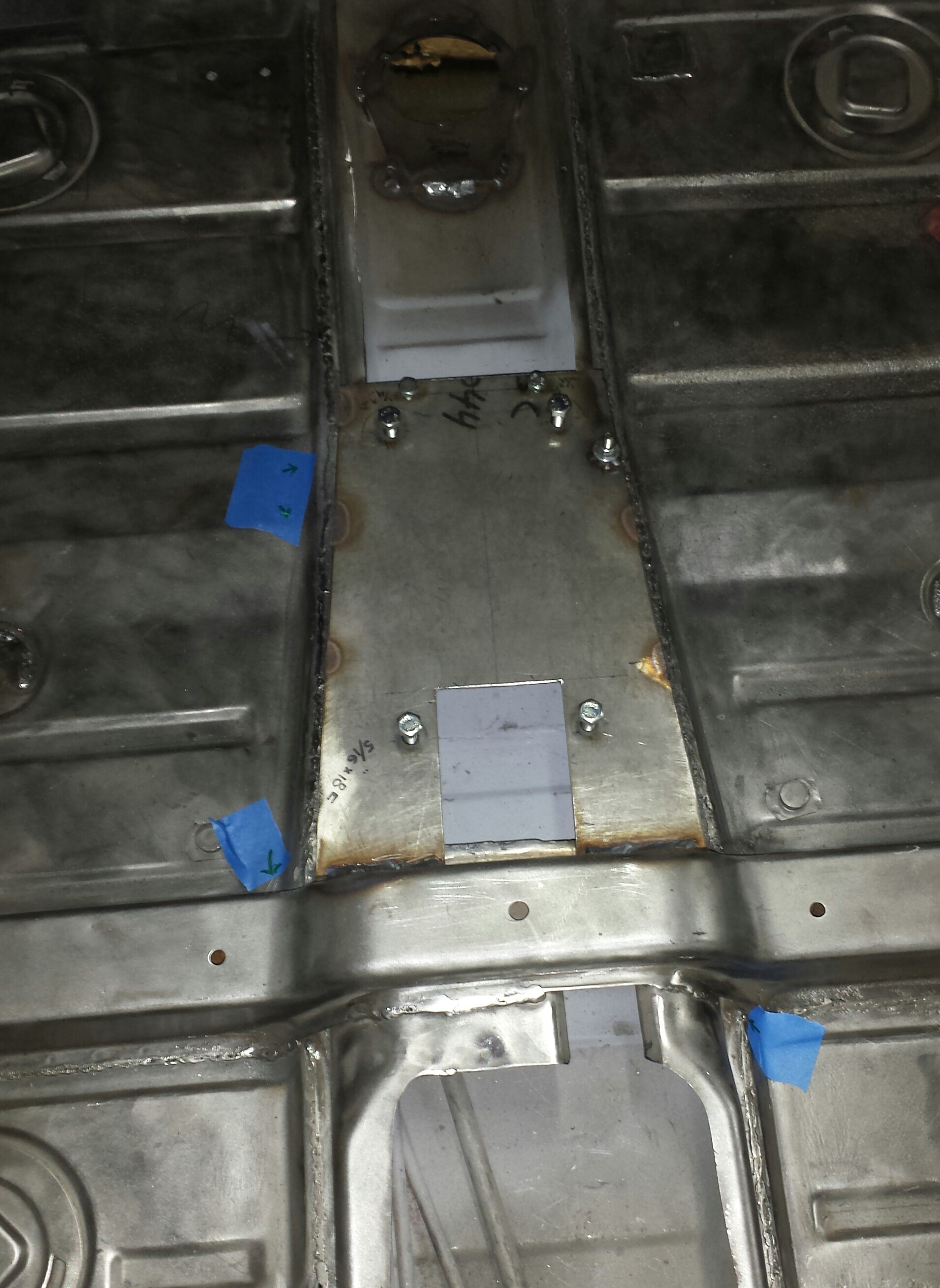

Stainless steel shift tower plate (.250") welded in place, across the tunnel.Attached Image

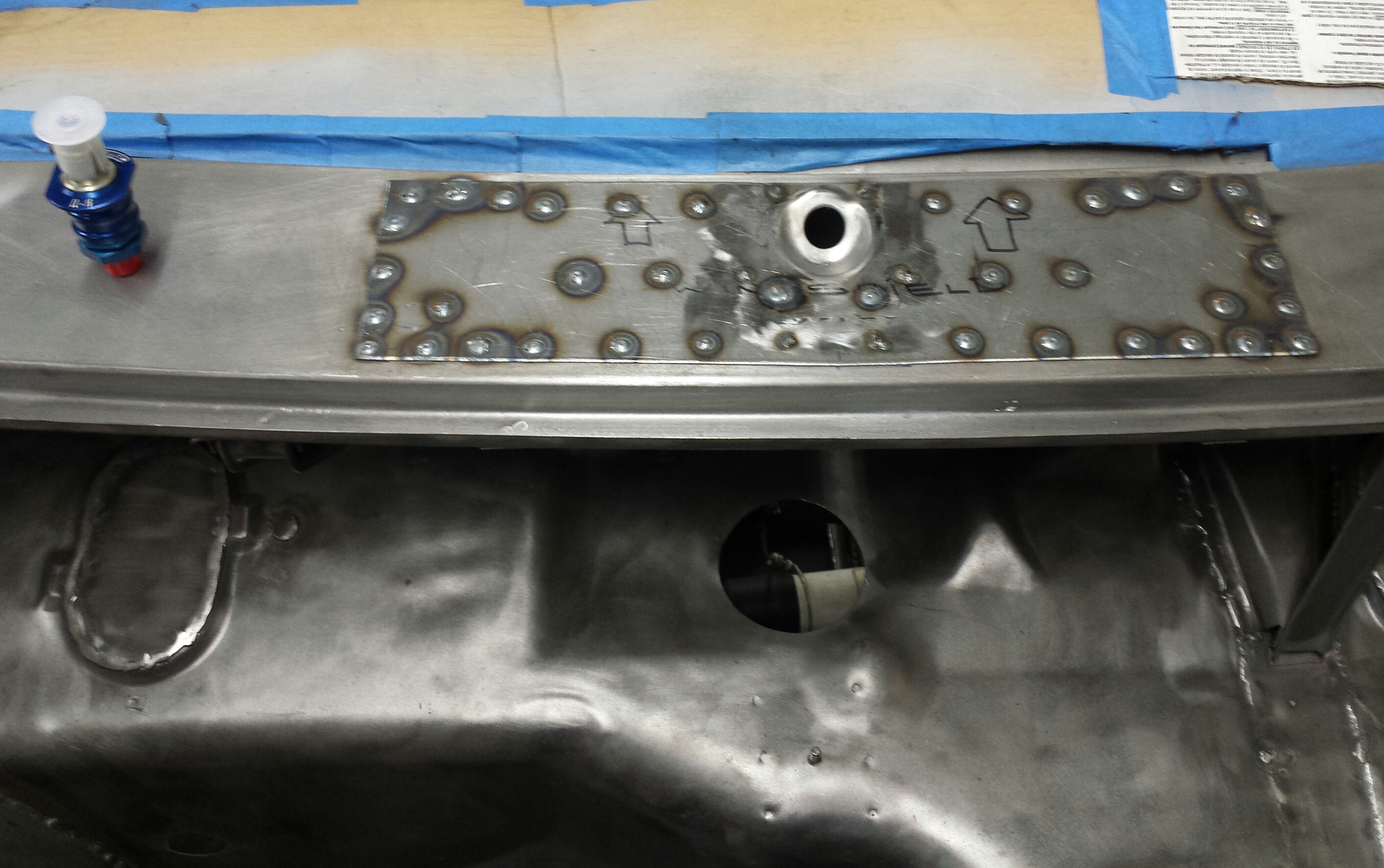

Mono wiper plate now welded down to the cowl.Attached Image

I was just thinking the other day I probably need a net...I hope my copy-cat is taken as flattery. Would you kindly post a picture of how you fabricated the rearward mounts? Thank you in advance!

Tony, they make the net-strap end real simple to install.
Each of the 3 horizontal straps wrap around the vertical section of the roll bar.
Each strap is held in place with a buckle, similar to the type used on your helmet strap (just wider for this net-strap). No welding at all, makes a real clean installation.

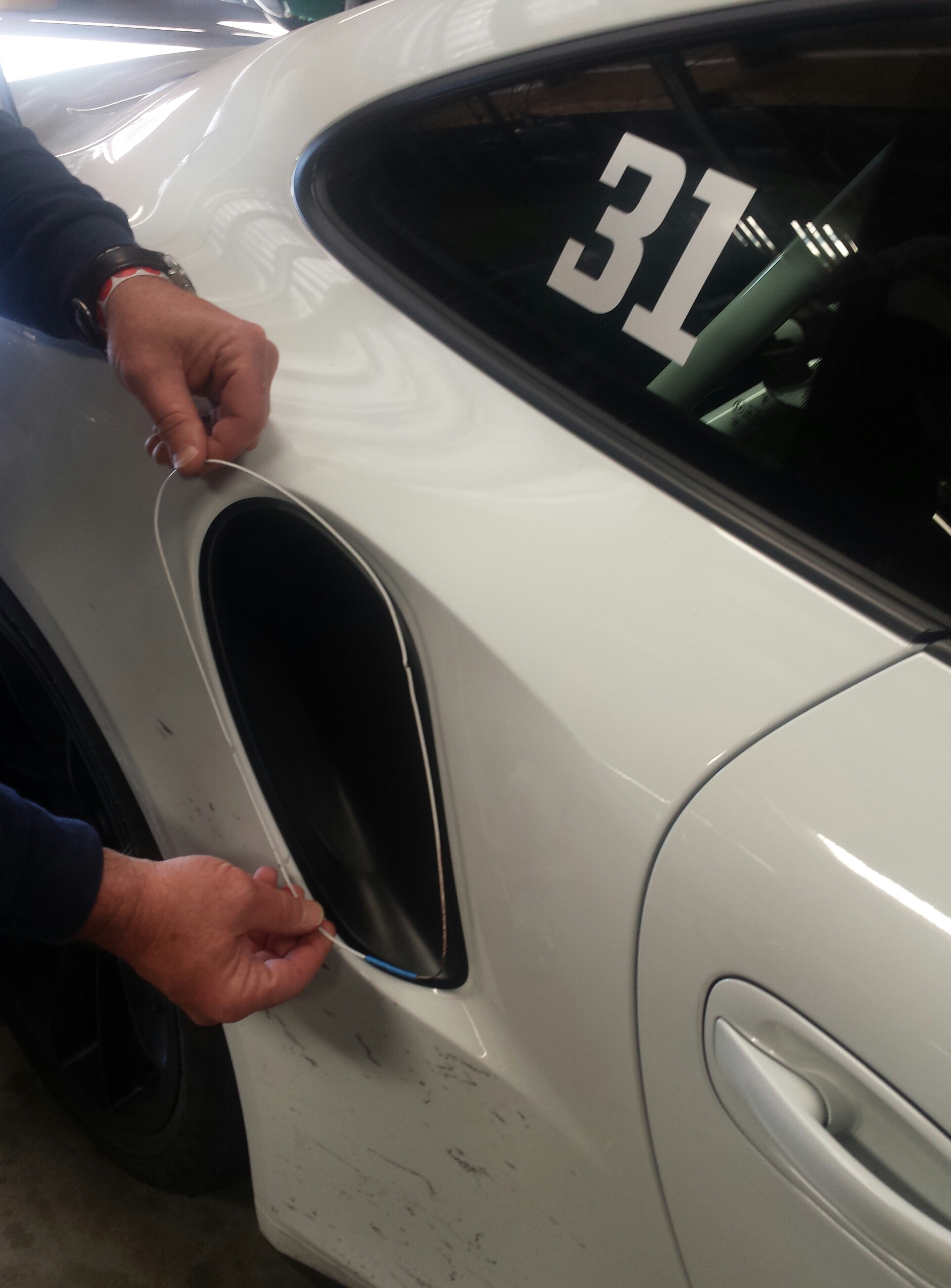

Took a measurement and made an outline off of a gt3RS quarter . I'll sketch it into the rear Sheridan 914 quarters, and install the factory gt3RS ducts.
These will feed air to the left + right rear oil coolers. Always handy to have another Porsche nut in the neighborhood (IMG:style_emoticons/default/blink.gif)

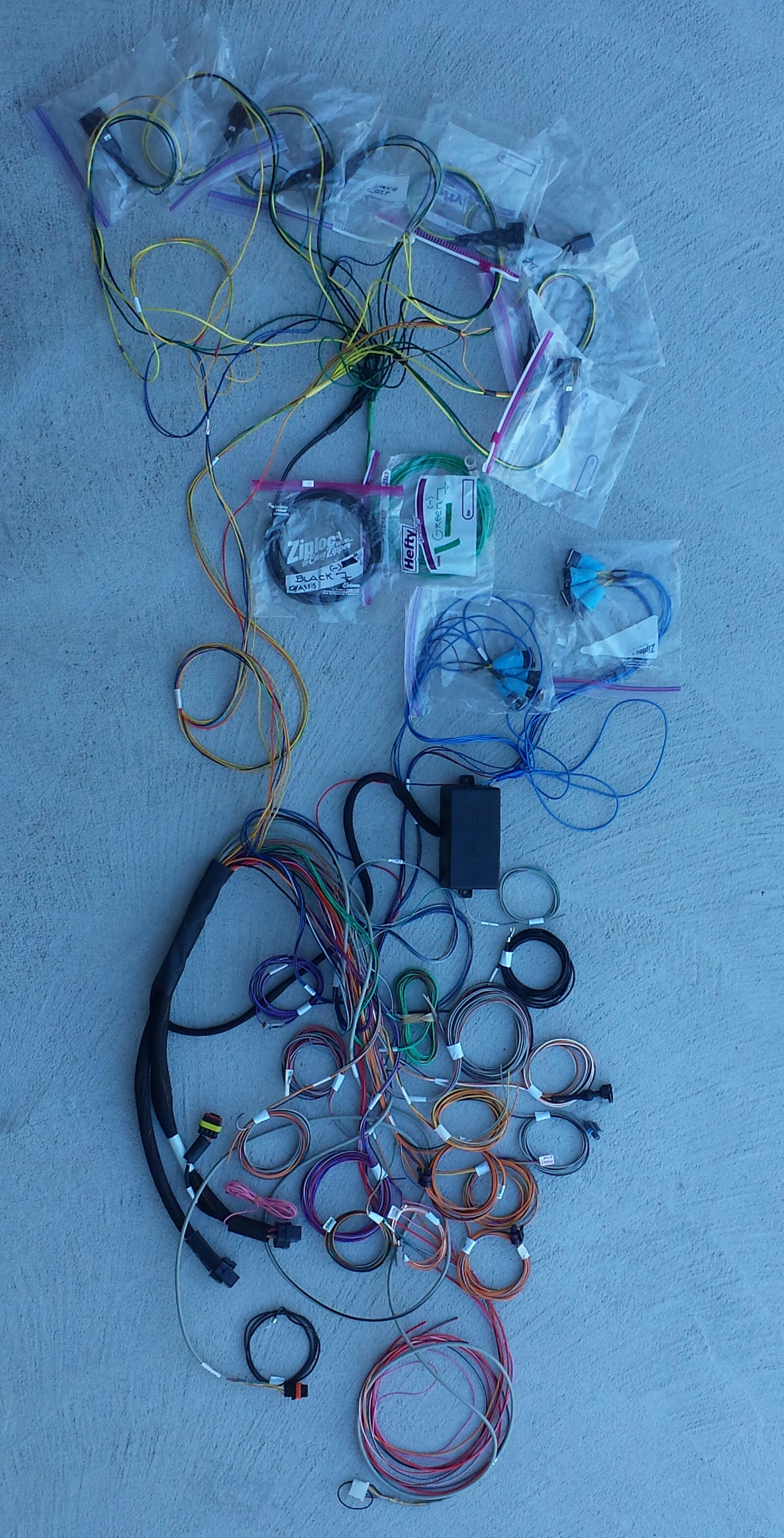

One more item completed; hand built ecu harness for the Haltech Elite 2500 management system. Designing the custom schematic and the harness build was fun , the Weller soldering gun got her done ! The Porsche Cayenne TT ecu is not tuneable for anywhere near the needs of this 5.0Attached Image

Very nice Marty...I'm glad those days are over!

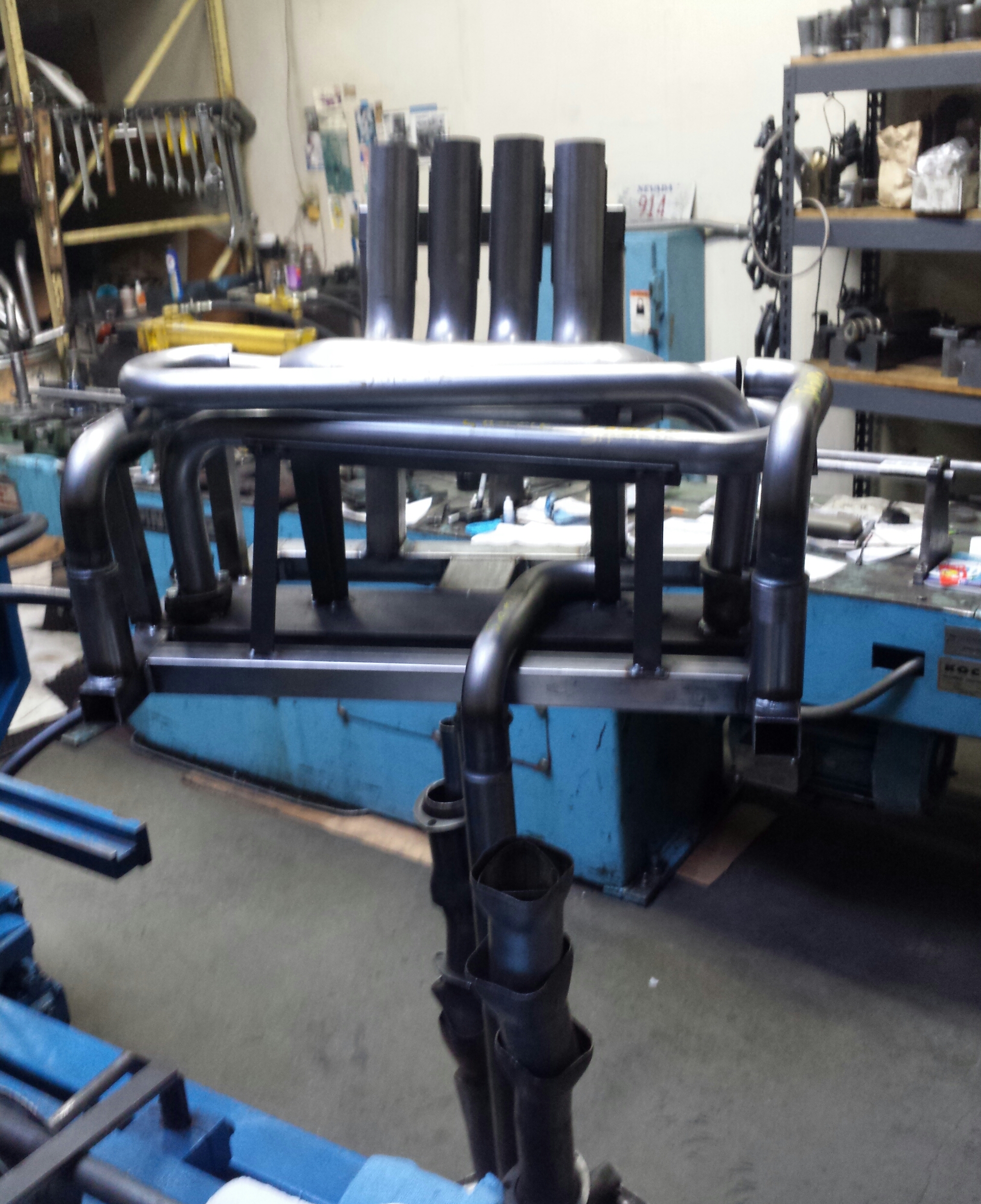

Here is a "Continuation " product that I haven't made in about 35+ years, some customers want these again. For the Manx + dune buggy guys, the MSDS Baja Eliminator.
Cool angles and precise bending going on here in the extractor header, and 4 over the top exhaust tips. Attached Image
