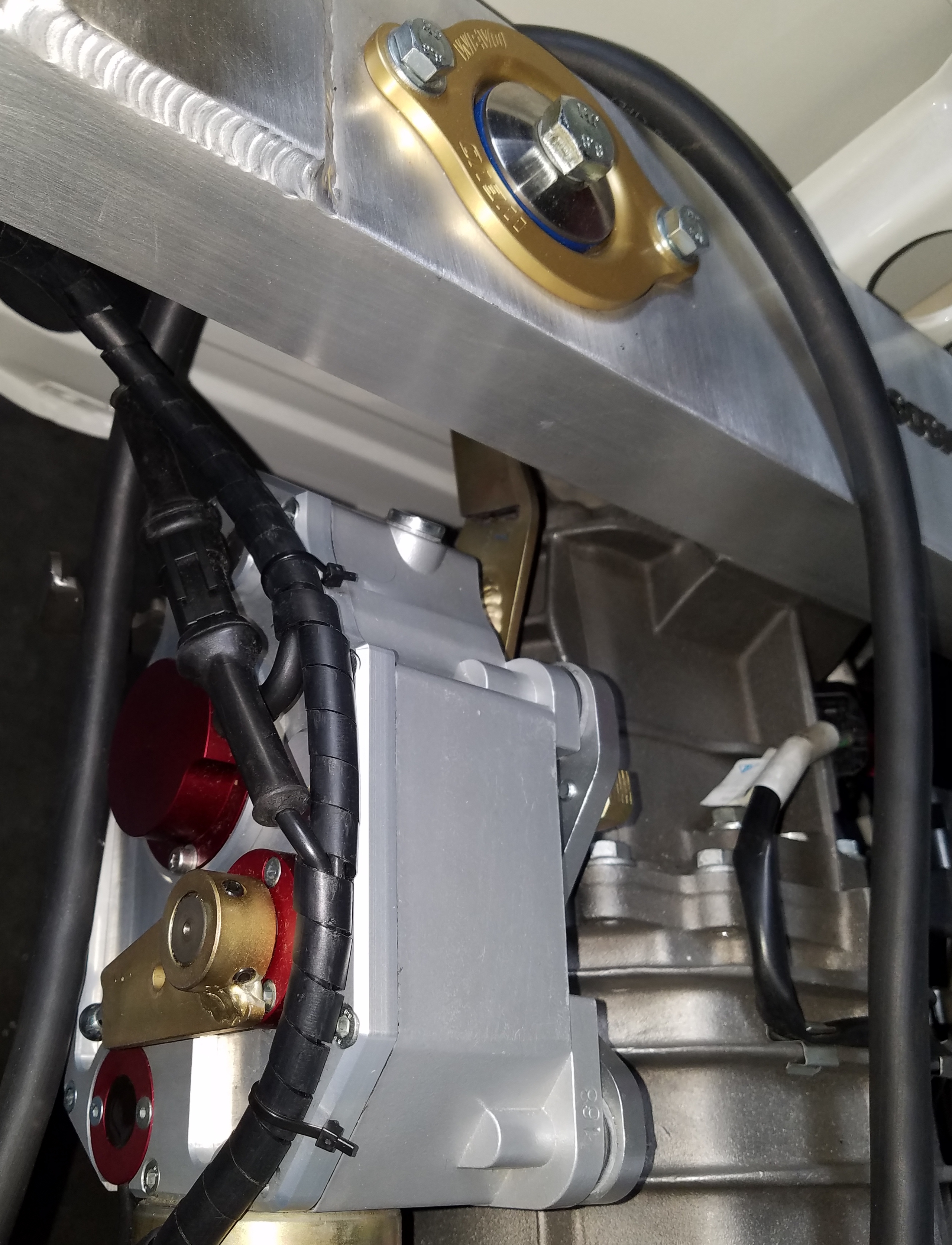

Getting back into assembly of specialty equipment to the project; starting with the SQS sequential shifter module
I bet some trick engineering went into designing and making that puppy. Wow.

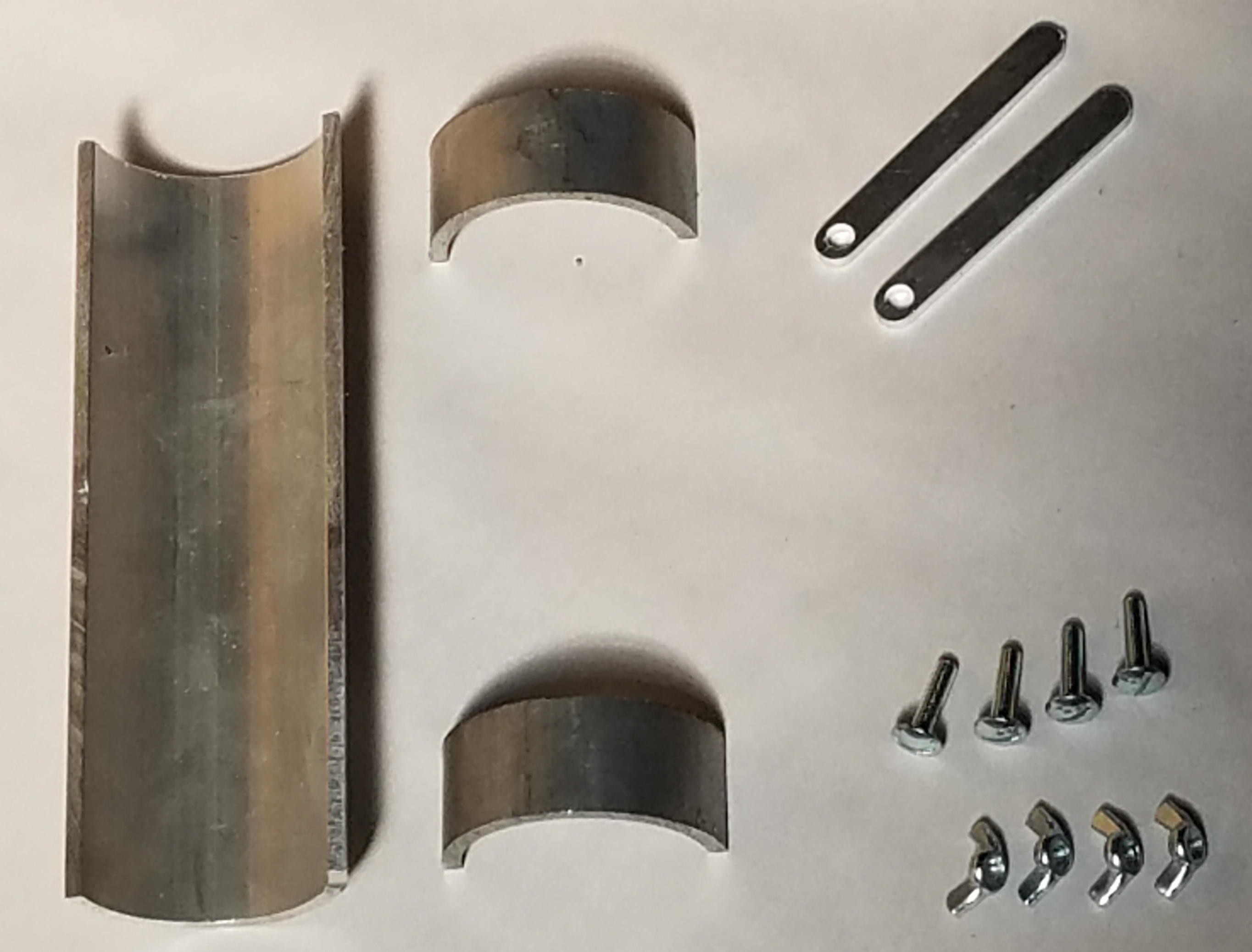

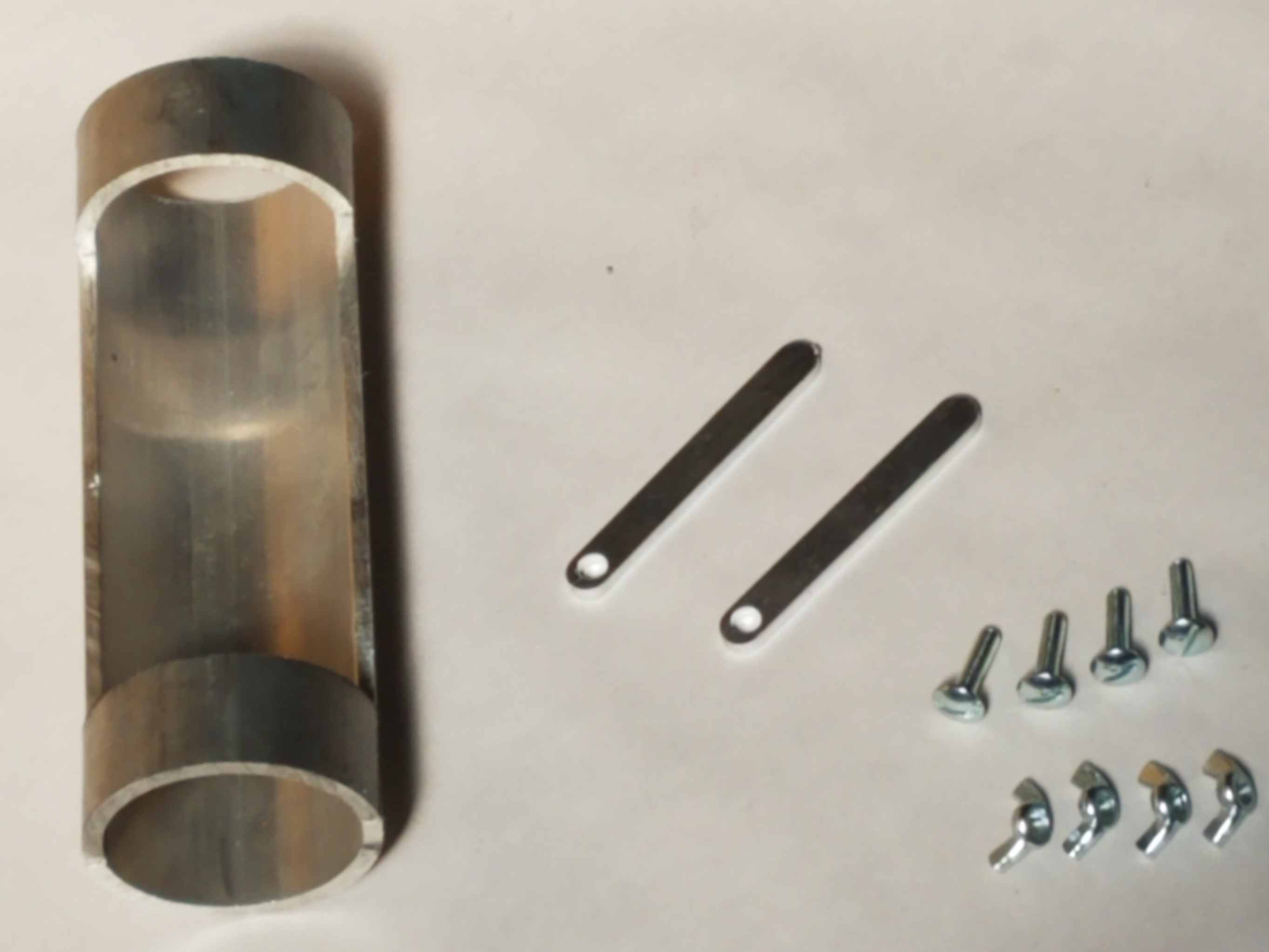

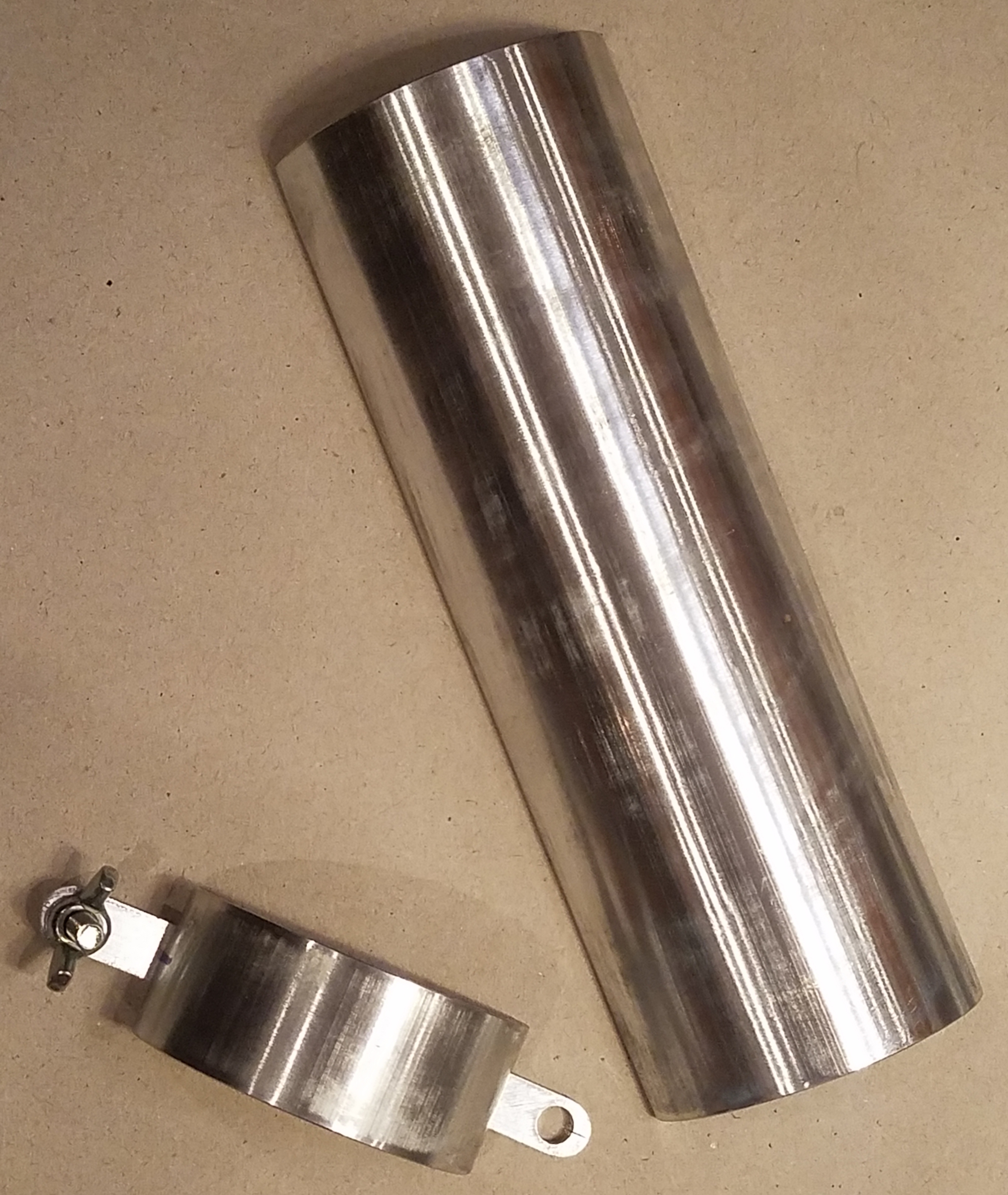

The new JRZ suspension does not come with supports, nor brackets to hold the nitrogen canisters....just not for sale SO; building 4 of these tubular aluminum sectional housings to keep things in place. At Rennsport6 we just wrapped in small towels & zip tied !

Pieced together, minus the tightening tabs ...which need to be cut to size and Tig'd in place

What do you say; leave alum sheen OR color match GP white ?

QUOTE(Mueller @ Nov 2 2018, 08:16 PM) *
QUOTE(Maltese Falcon @ Nov 2 2018, 08:11 PM) *
SQS makes a large selection (various vehicles brands) of sequential shifter kits. They are good at what they design + mfg. The module is basically a blend of human input (you move the stick), changes into electronic command to solenoids which create shift linkage movement from the H pattern into a Linear pattern.

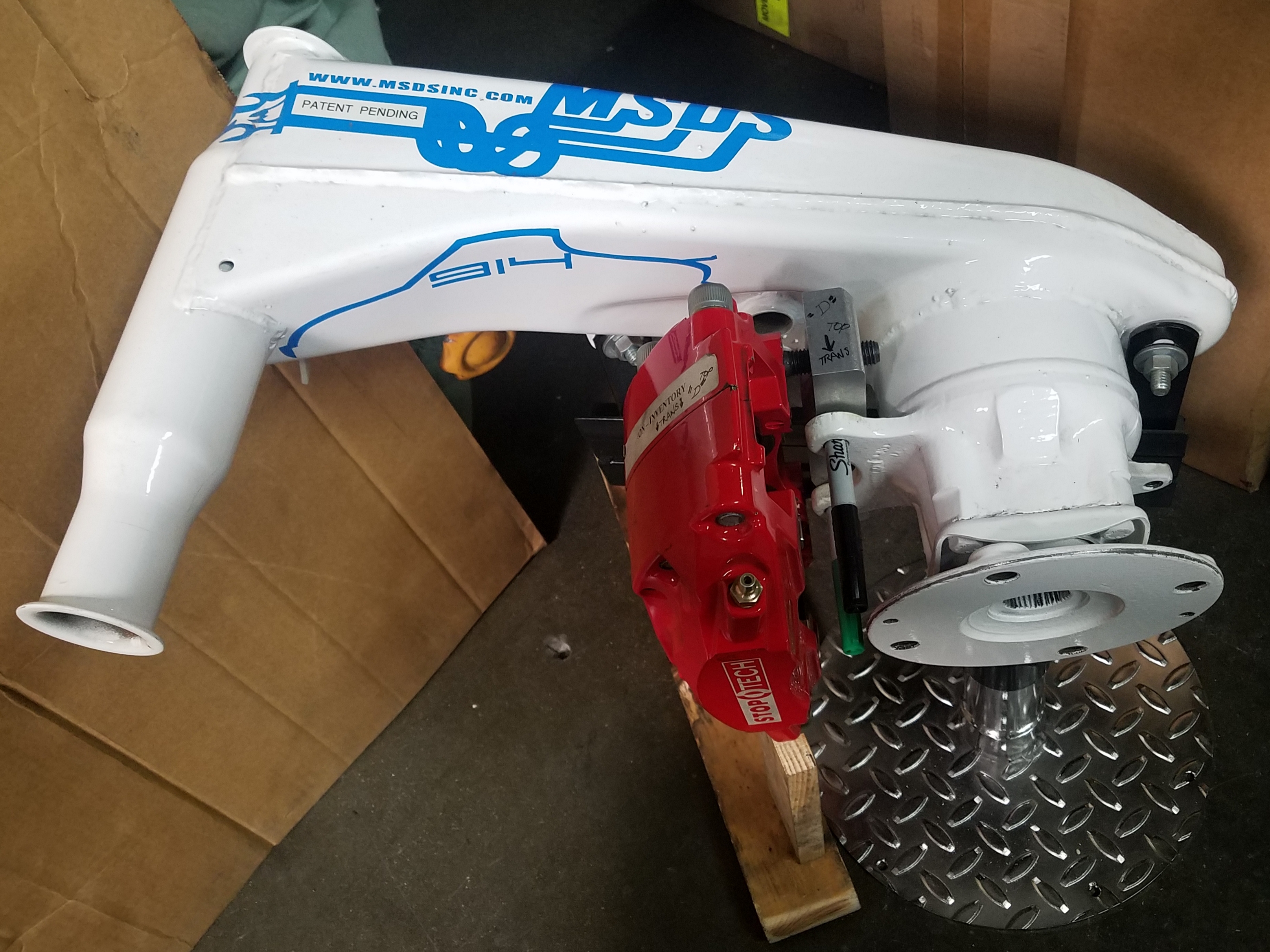

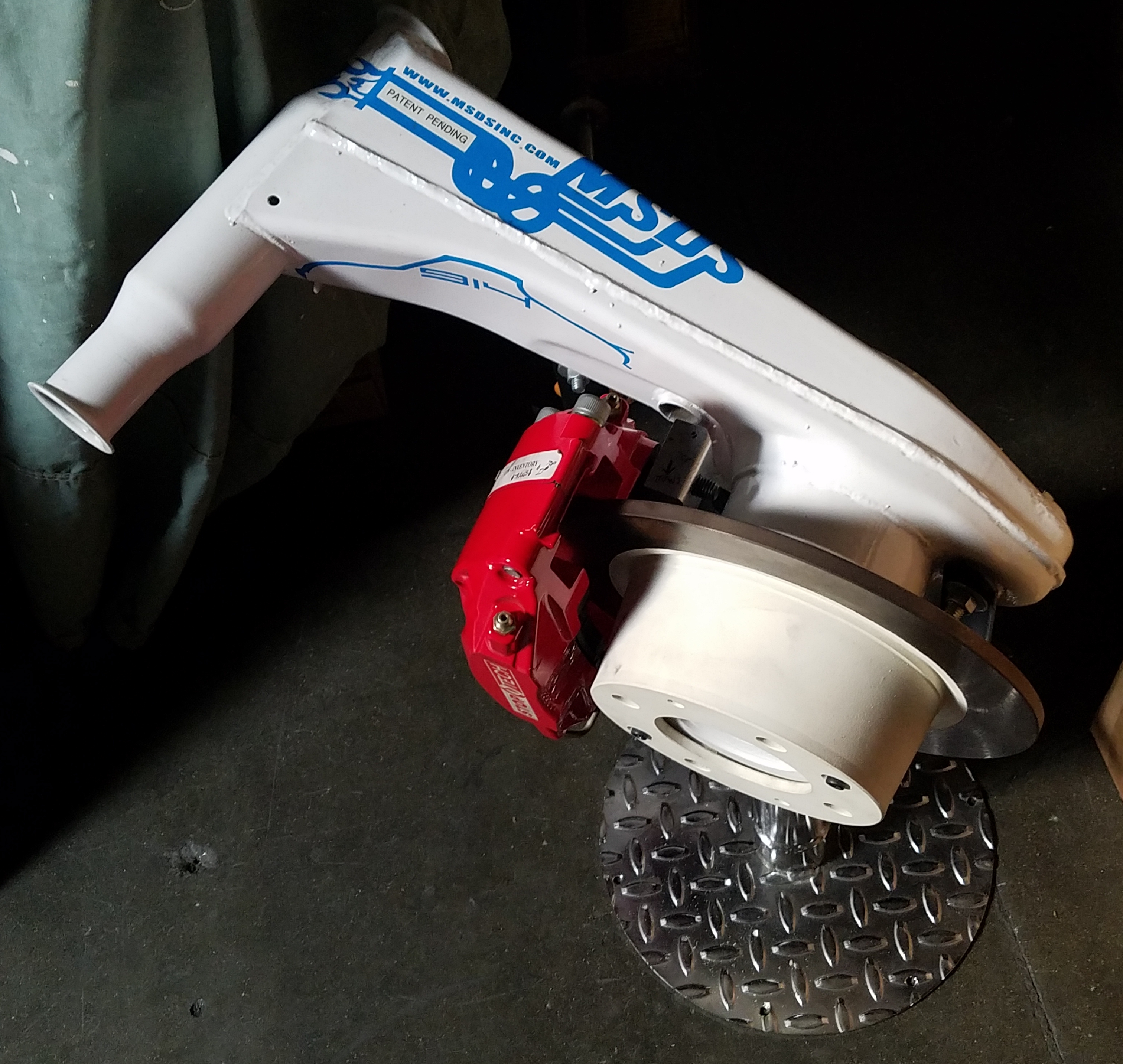

Rear StopTechs are their #ST40 4 piston model. Using the Rich Johnson style 986 Boxster adapters, the ST-40's are 99% in position on the trailing arm. I'll use 12mm washers to shim the caliper into final position, then remake the aluminum blocks to the new fitment spec. The white trailing arm in the pic (use it at trade shows) is my workhorse for the rear prototype; so dont mind the solid rotor in place>> just being used for reference. The final rear rotors are 355mm x 32mm vented floating discs.
Sharpies make for decent 12mm soft dowels (IMG:style_emoticons/default/smile.gif)

With the 12mm hardware in place...
