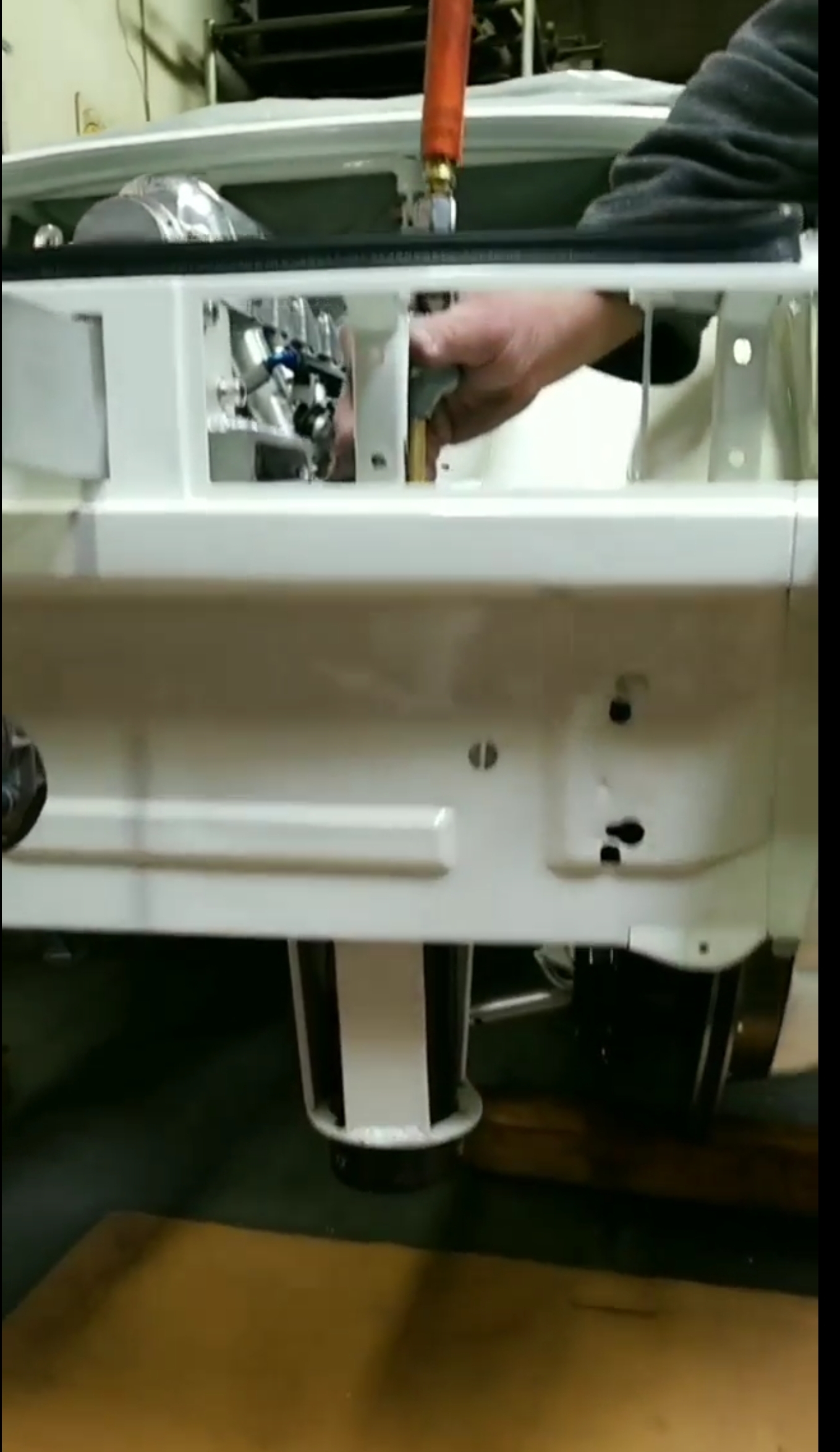

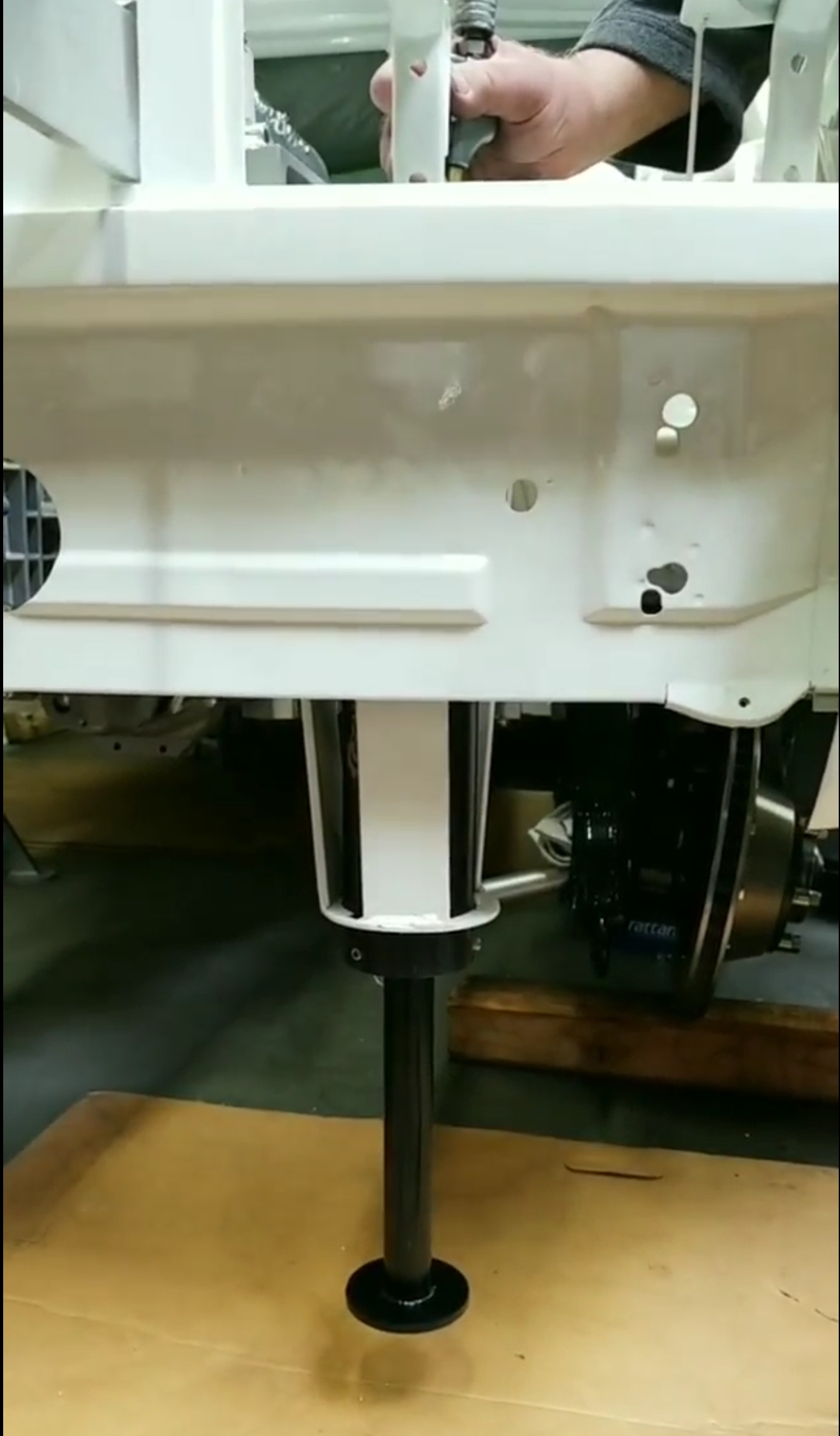

As we are now with wheels + tires, today setting the total "Droop stop" limit of JRZ shock travel. We have 9" ram extension length on the Genesis air-jacks.

...apply about 100 psi of air (or nitrogen) for activation = aOK .
Def keep all fingers away from these bad boys (IMG:style_emoticons/default/biggrin.gif)

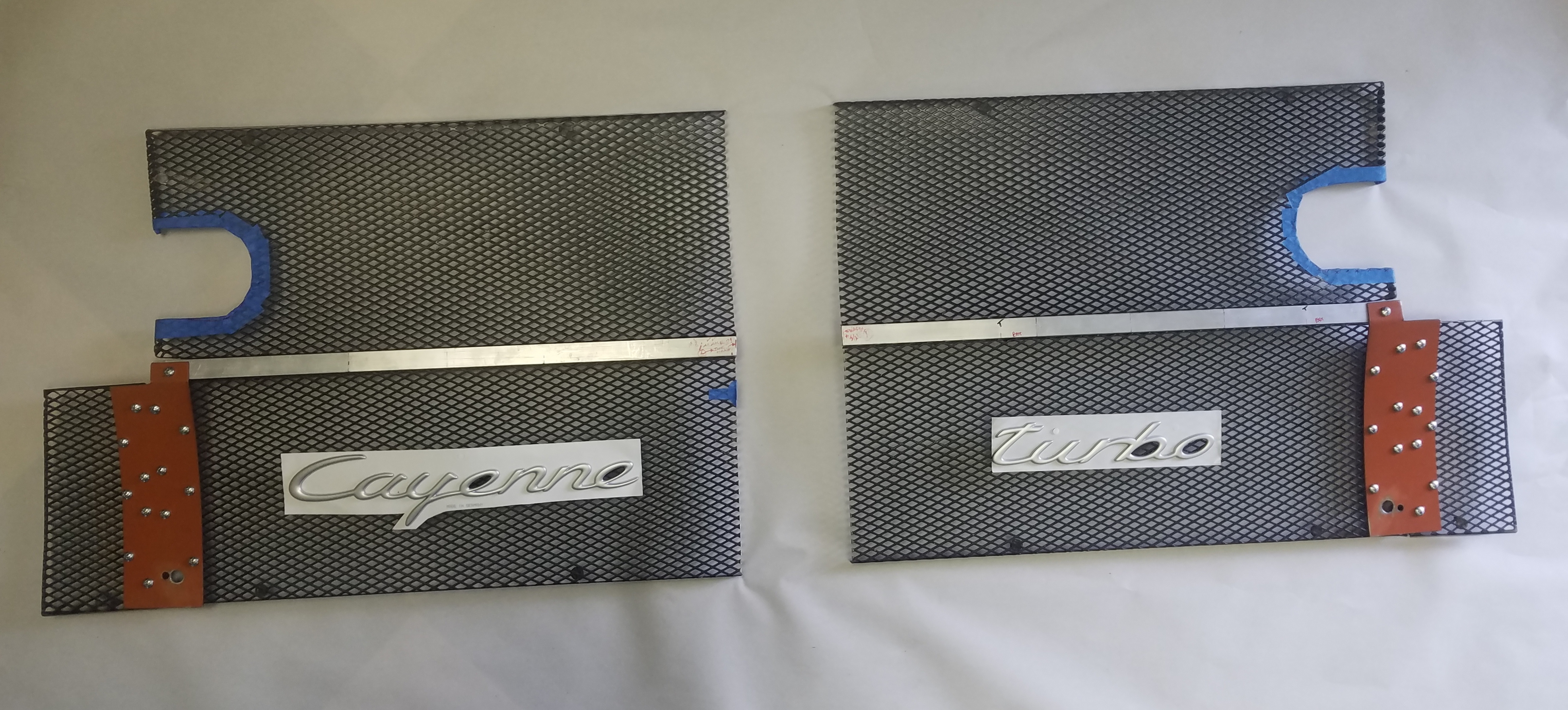

Schriftzug on the grills, but will probably be placed elsewhere on the build

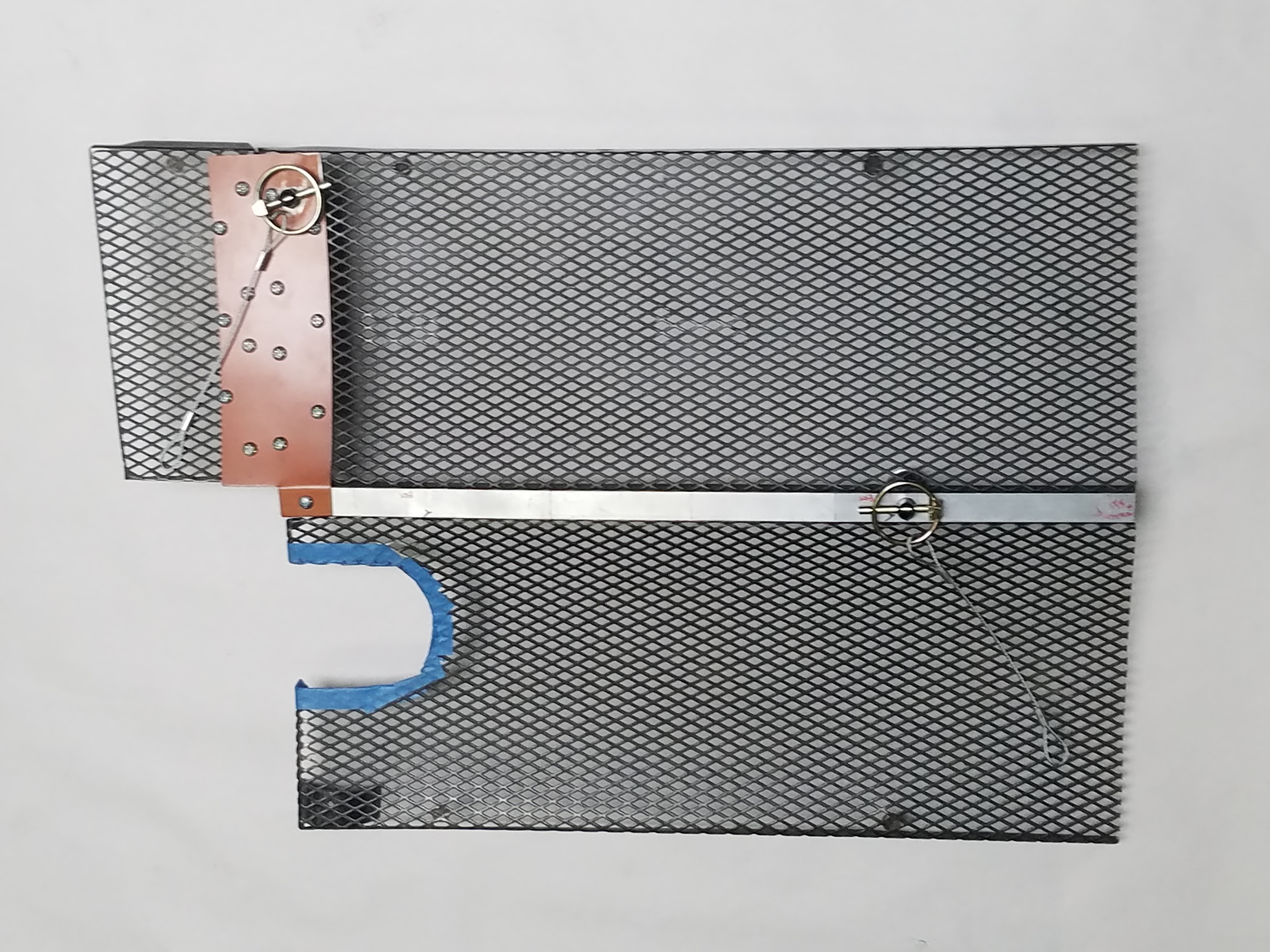

Feeling a little "Pinned In" this week , so finalized the measurments for the secondary hood pins. These are only 7/16" dia pins (normally 1/2") and sourced from Pegasus

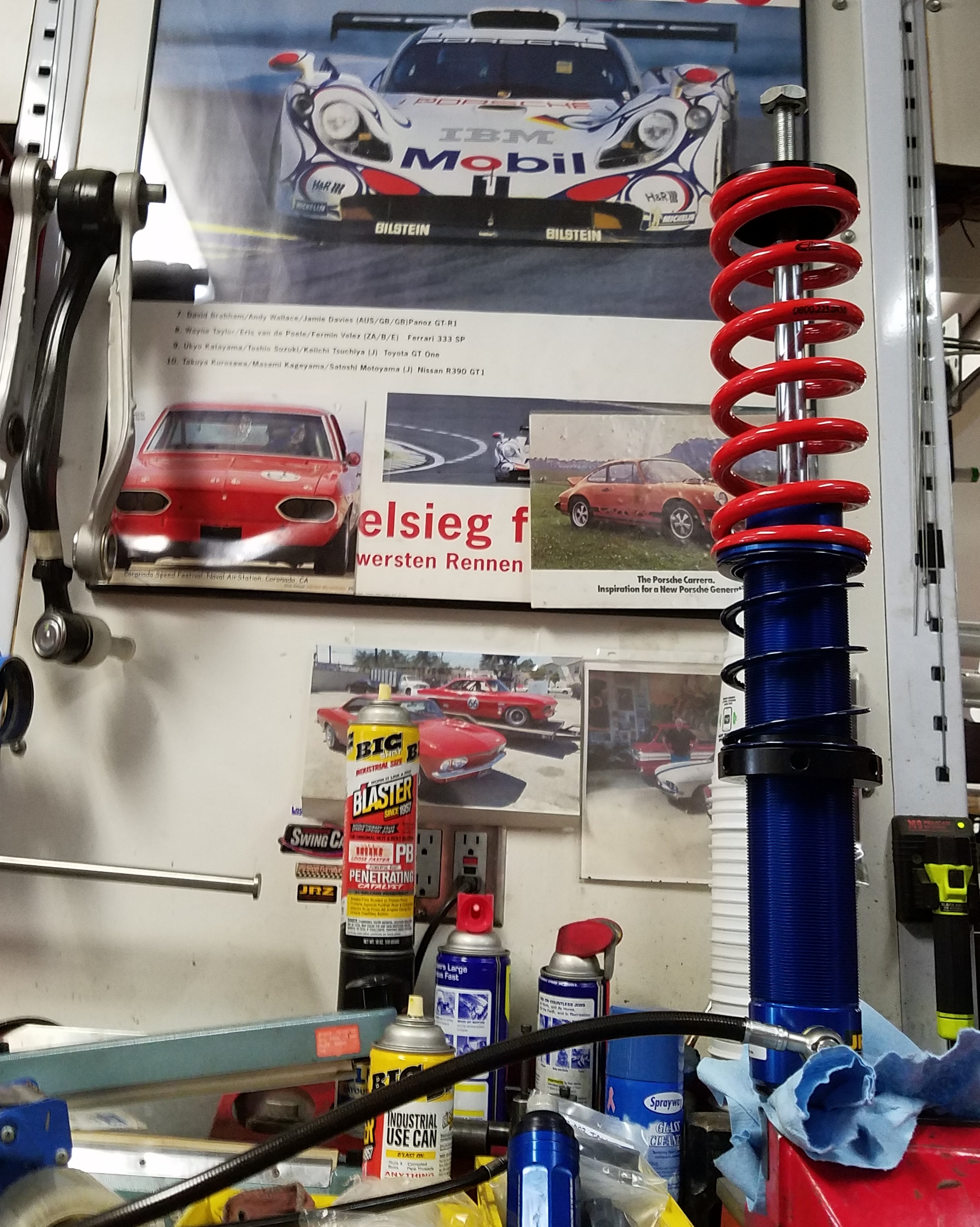

A little too much "Droop" in the rear JRZ shock assemblies, so a bit of time spent down at ERP suspension. We took 1.75" out of the equation, so this allows the air-jacks to operate at max, and the rear tires now clear the tarmac. Fronts were spot on--no changes needed.

JRZ rear suspension now corrected at "Full-droop" , allowing just enough tire clearance-to-lower lip of quarter panel for tire changing during air-jack activation

The open space just above the 4x4 and .375" alum bar, is the tire-to- ground gap, which allows for tire changing when the air-jacks activate at 9" ram stroke.

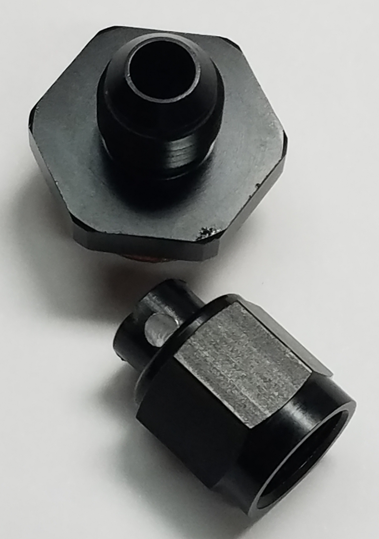

New combination Trans vent/ fill plug for the top of the inverted 996gt2 trans
Maltese Falcon
post May 10 2020, 05:48 PM
Post #458
Posts: 5,285
Joined: 14-September 04
From: Mulholland SoCal
Member No.: 2,755
Installed...with a bit of Anti-seize on the threads

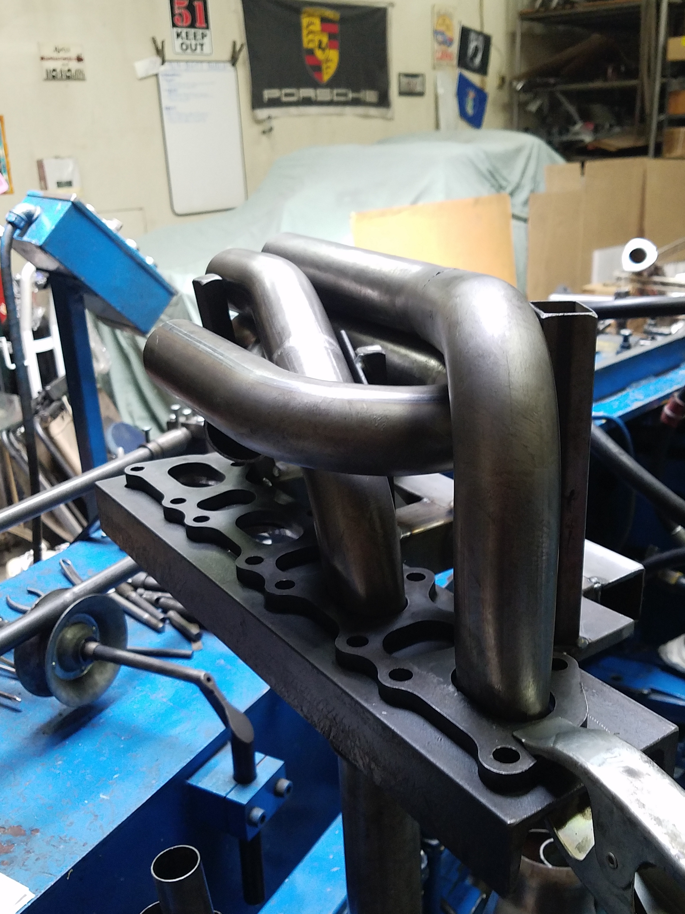

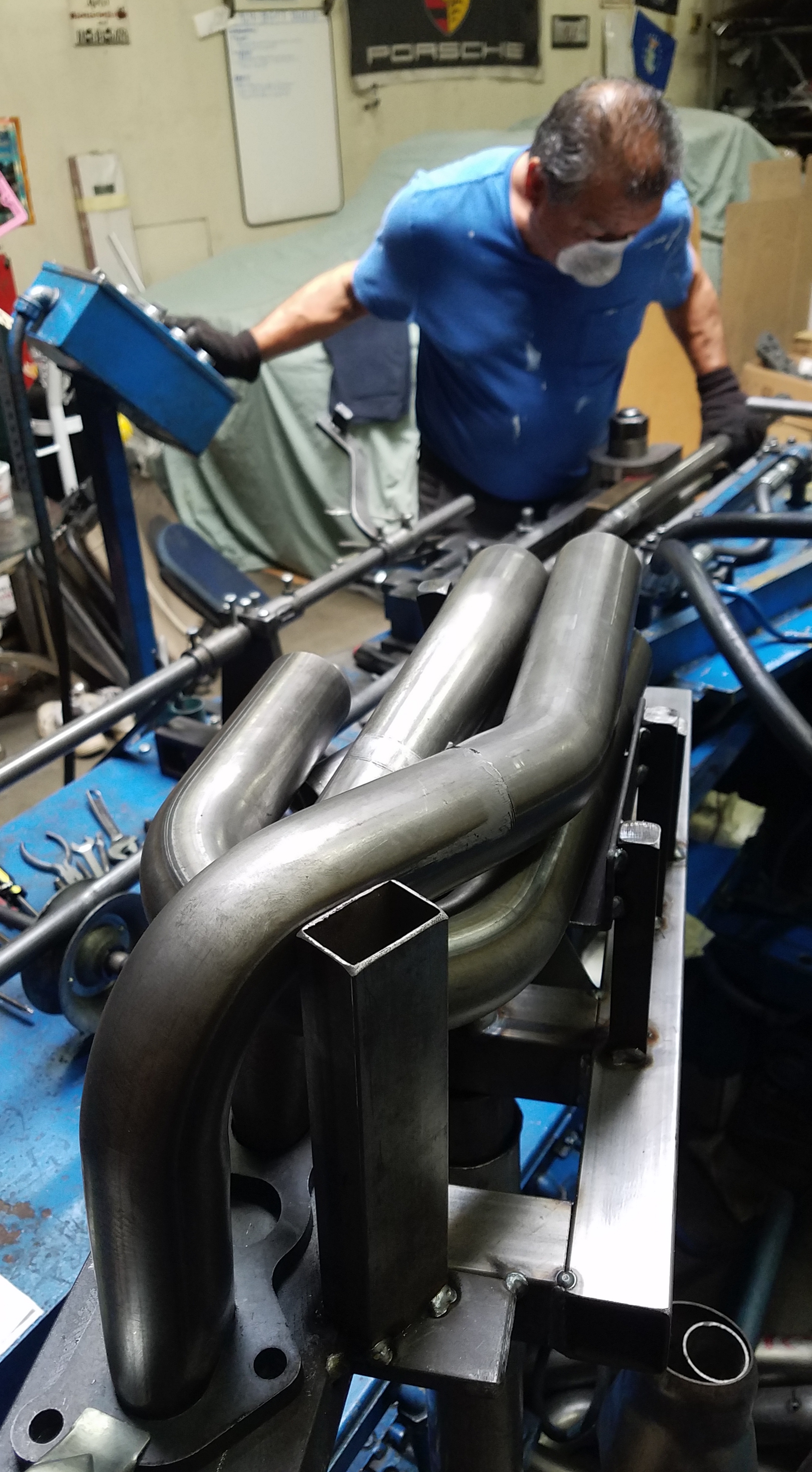

Header primaries 1.75" od x .125" ga. mandrel bending completed today. Precise assembly fixtures are the key in making the fitment to the Cayenne v8 engine 100% right on

After the primaries are completed, the secondary portion of our exhaust system including all of the turbo, wastegate, and exit piping will follow in various sizes; ranging up to 3" od . Everything x 2, (left + right sides) as this is a twin (biturbo) system
