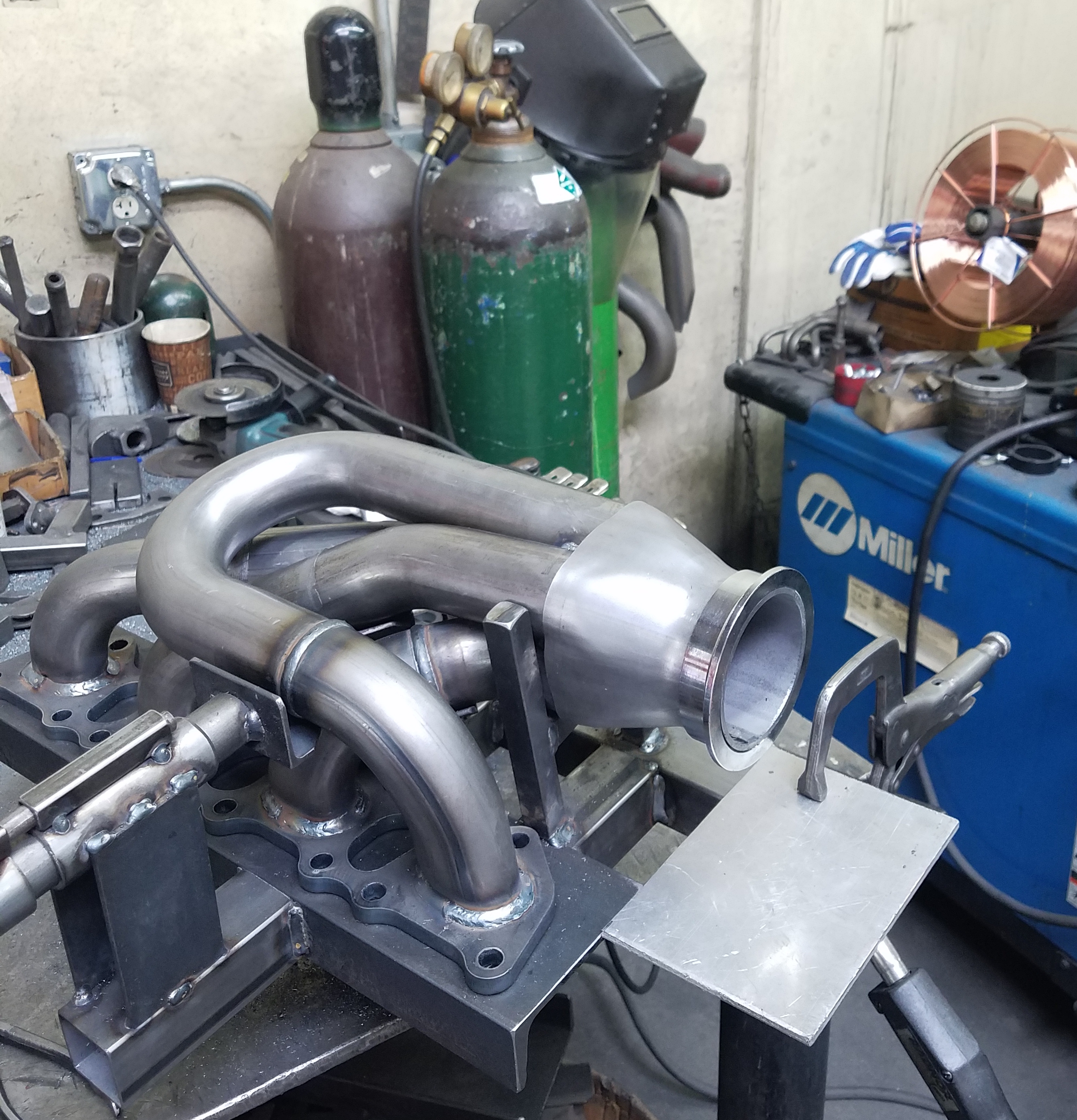

Shorty turbo headers in the finishing phase, then off for black ceramic coating. A few extra sets built for spares ¡

I dig it.
Great idea on that fixture for the exhaust.
The fixtures make quick work of the mandrel bending, fabrication, welding; and keeping the symmetry of the Left and Right sides looking + fitting proper (IMG:style_emoticons/default/smile.gif)

Can Marty make an exhaust system or not WOW ! Nice
