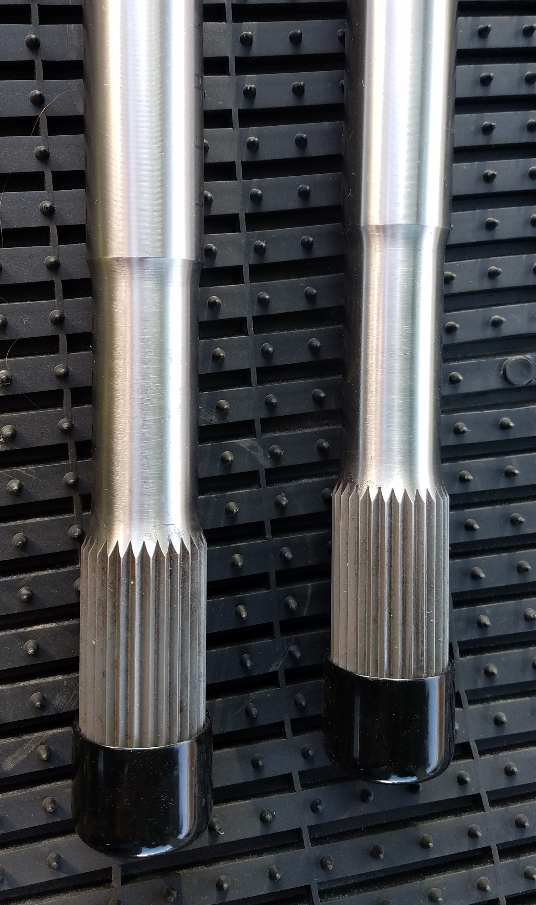

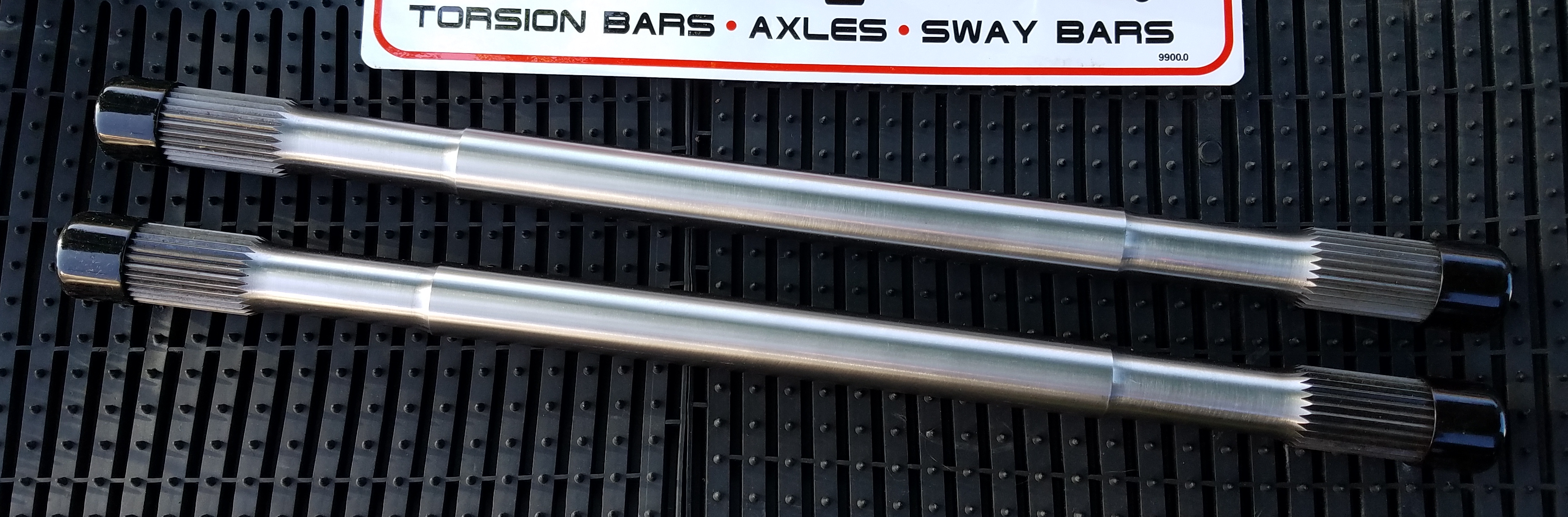

Sway-Away custom 300m alloy axles have come in...time to join these up with the CV's !
21 1/16" is the length end to end

The engineers over at Sway-Away use this slightly larger bump in shaft diameter, helps out with extra strength in high HP applications.
These are also floating style axles, with longer (than OE) dimension splines.

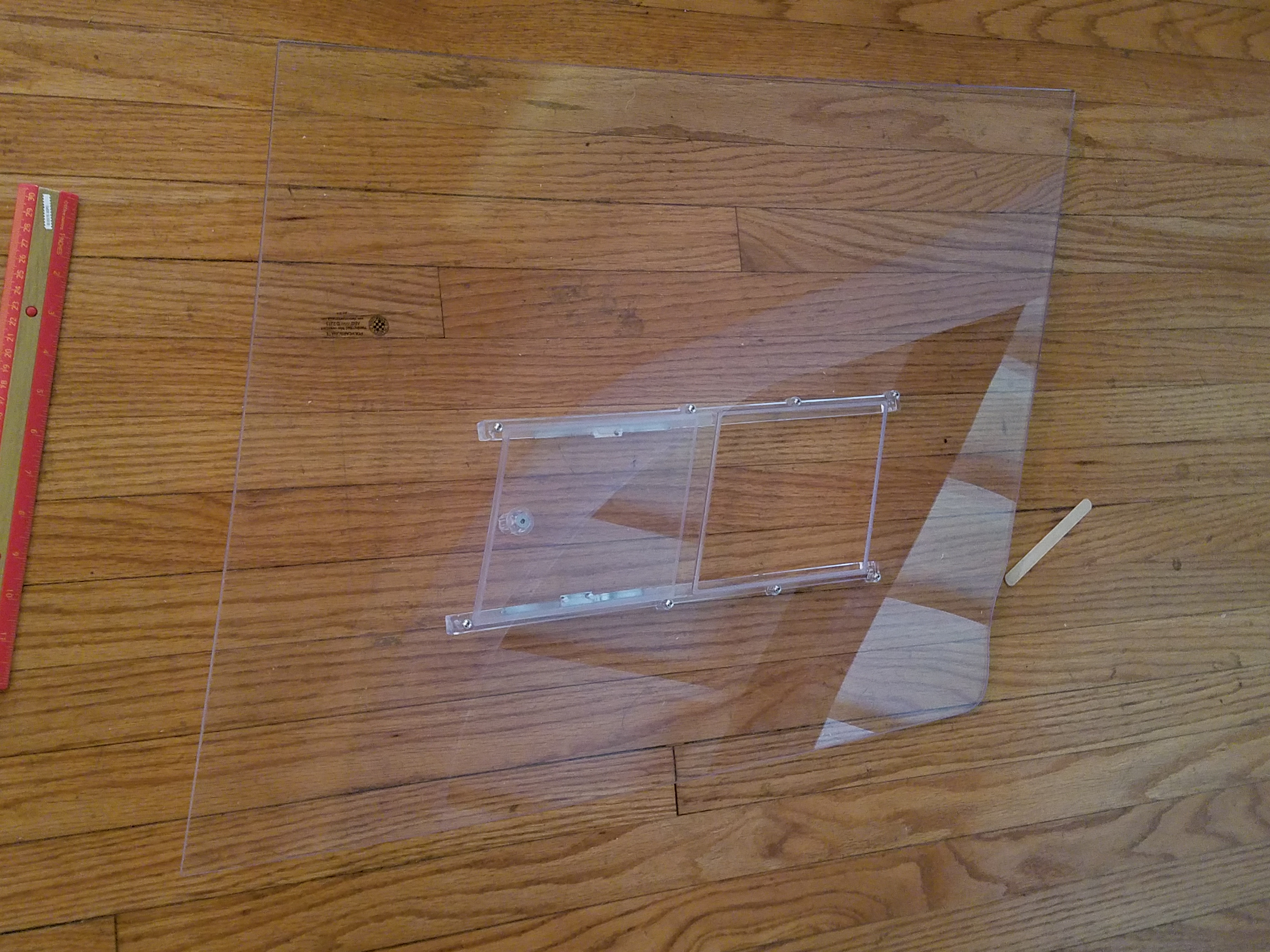

I'm kind of baffled on the way these plexi (Perfomance4Plastic, UK) 914 slider windows appear. On most racecars I've seen in the last 5 decades, the slider moves rearward so the opening faces forward in the window; these are made with the slider that moves forward so the opening is in the rear of the window ...And
Check out the curved contour cut at the bottom-rear of the window (see pointer) I couldn't find any early or late 914 window diagrams that indicate a cut-out like this (just a slight diagonal). No matter, as I'll be trimming most of the Below the Sill plexi in order to clear the side safety bars. I'll run these over to the shop today and test fit...I might need to get happy with these; although great QC in their product an order takes approx 4 months .What do you racers think on the positioning of these sliders ¿

Another slider window assembly on their (P4P) website; the F40 showing the window opening in the way I'm familiar of seeing

Perhaps they switched the orientation on the slider because they knew it was going in the 914-8 GTT? I think you'll be able to open the window on acceleration if you use the standard front-to-back operation (IMG:style_emoticons/default/driving.gif)

Now that's a proper answer ! (IMG:style_emoticons/default/biggrin.gif)

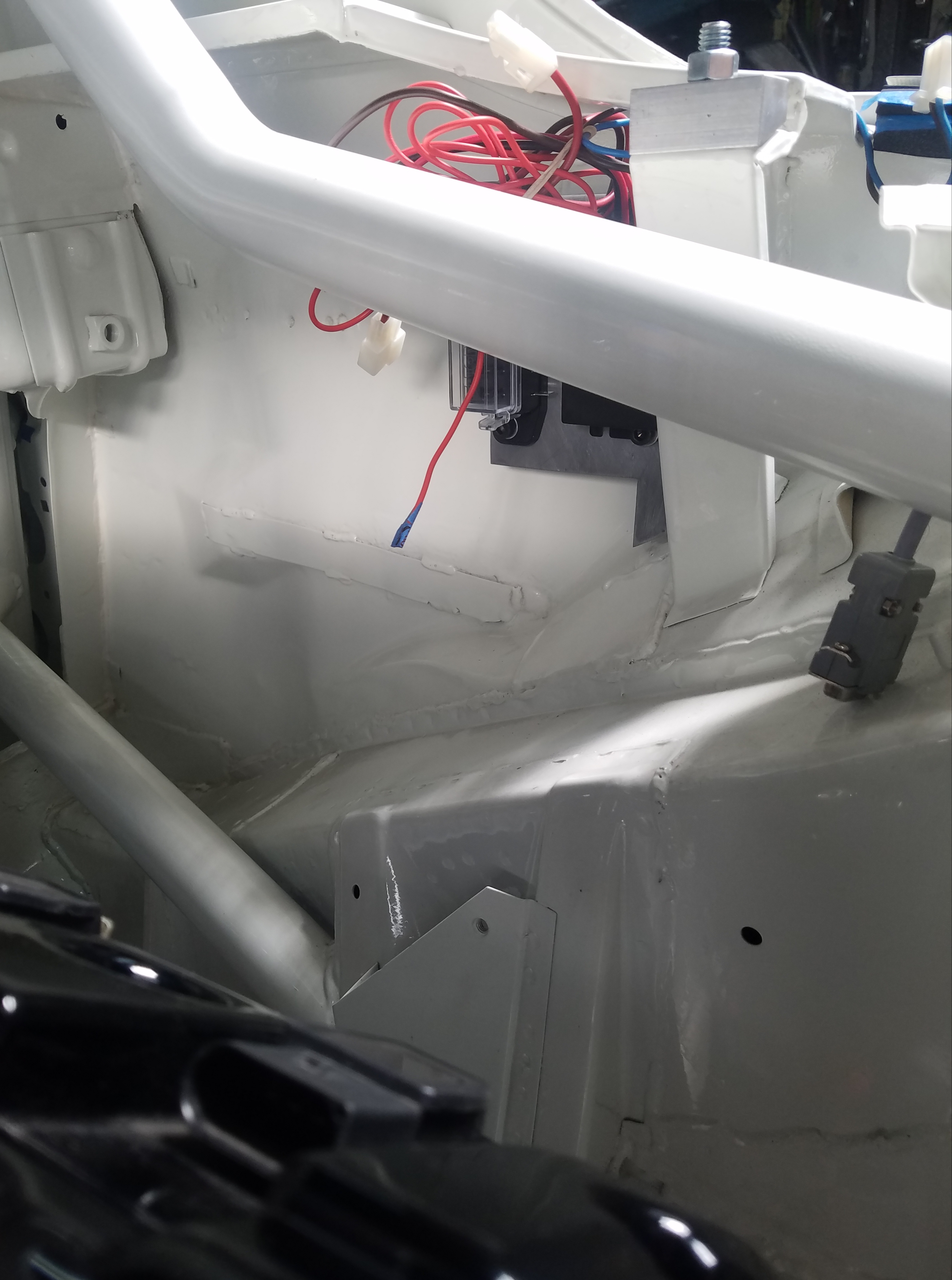

Added a few items , and fished a couple of SQS control wires through the Goodridge fire-sleeve
