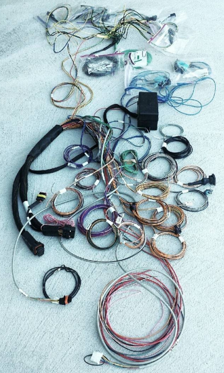

This phase of the 8gtt assembly deals with many items that we have already built early on and put aside until needed; the trans oil needs to be filled, as we wouldn't want to test shift the gearbox (while setting the SQS shift rods) if dry. Building the full Haltech management wiring harness was a 6 week project...but can now be dropped into the car in a few hours. I jump around different areas of the build, depending on the amount of time that I can spend on it...otherwise working on customer orders in the shop (IMG:style_emoticons/default/welder.gif)

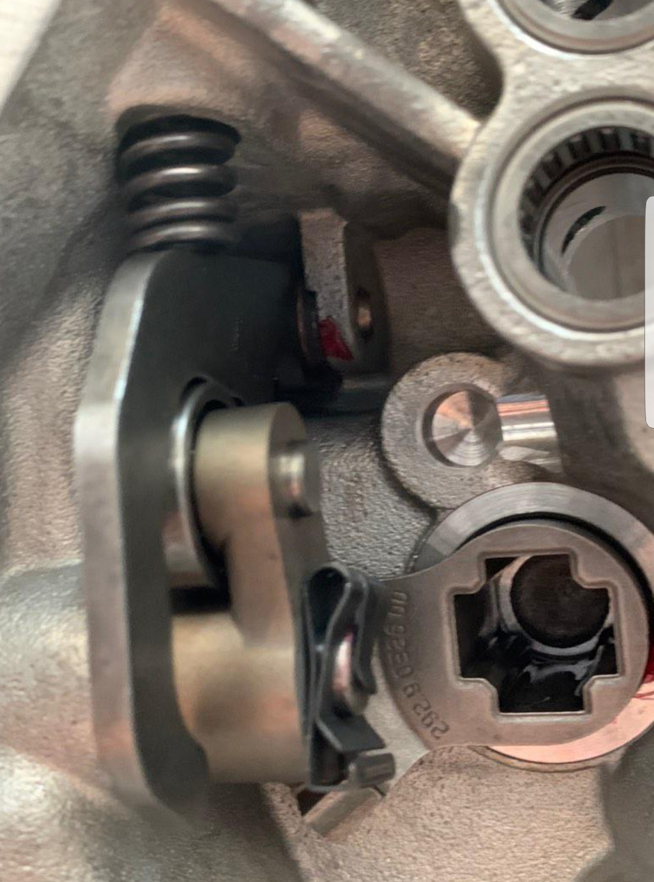

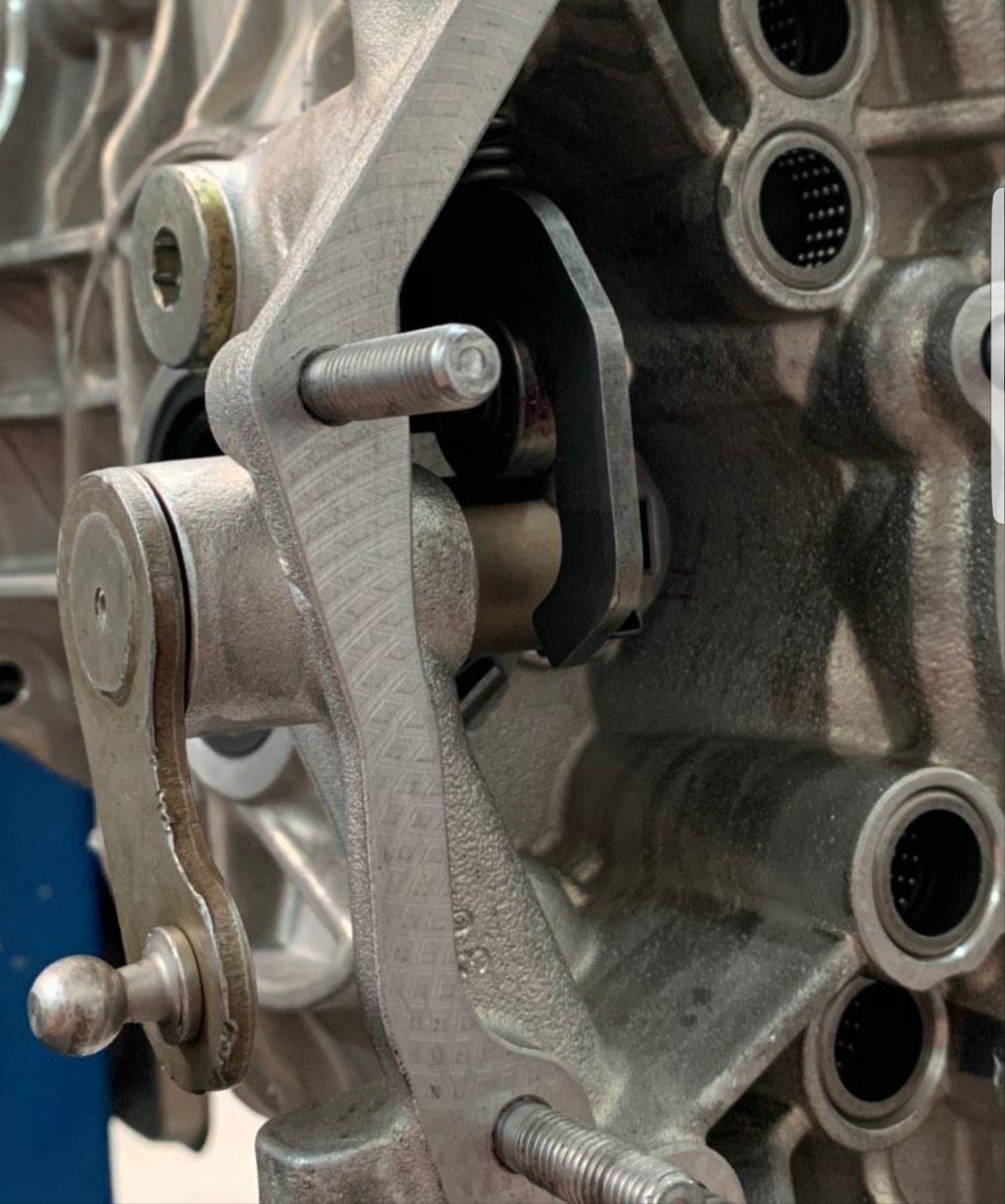

For those who need to see the inside of the gt2 trans this is the spring-loaded selector which has 3 positions; at rest= neutral, up= 1,3,5,R and down= 2,4,6
Maltese Falcon
post Nov 7 2020, 01:29 PM
Post #526
Posts: 5,286
Joined: 14-September 04
From: Mulholland SoCal
Member No.: 2,755
another view...

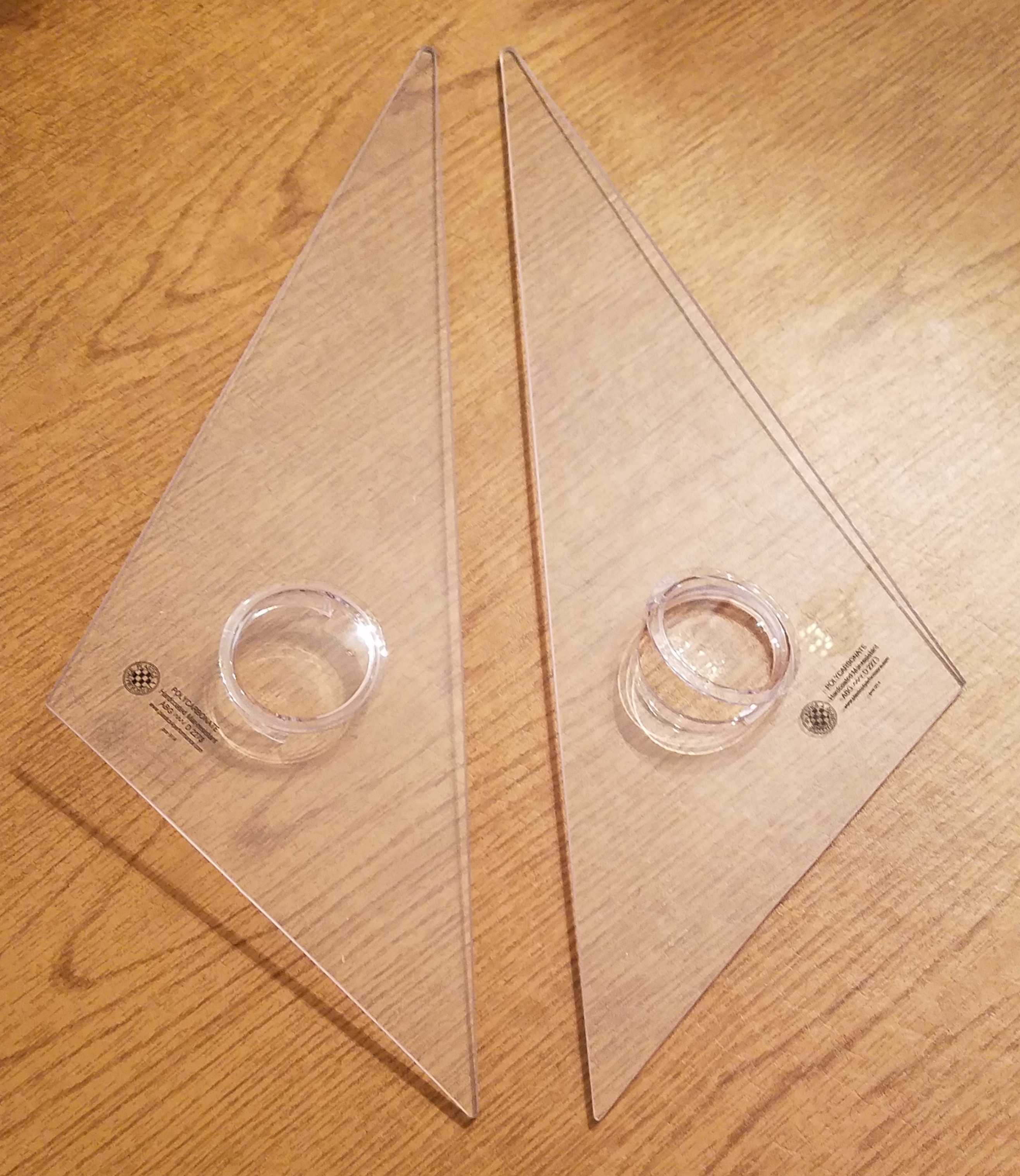

These cool polycarbonate vent windows just in, has a small Pop out vent- disc: use as a vent or spin around and use as an air scoop, or just snap down and close. "Performance4Plastics", UK

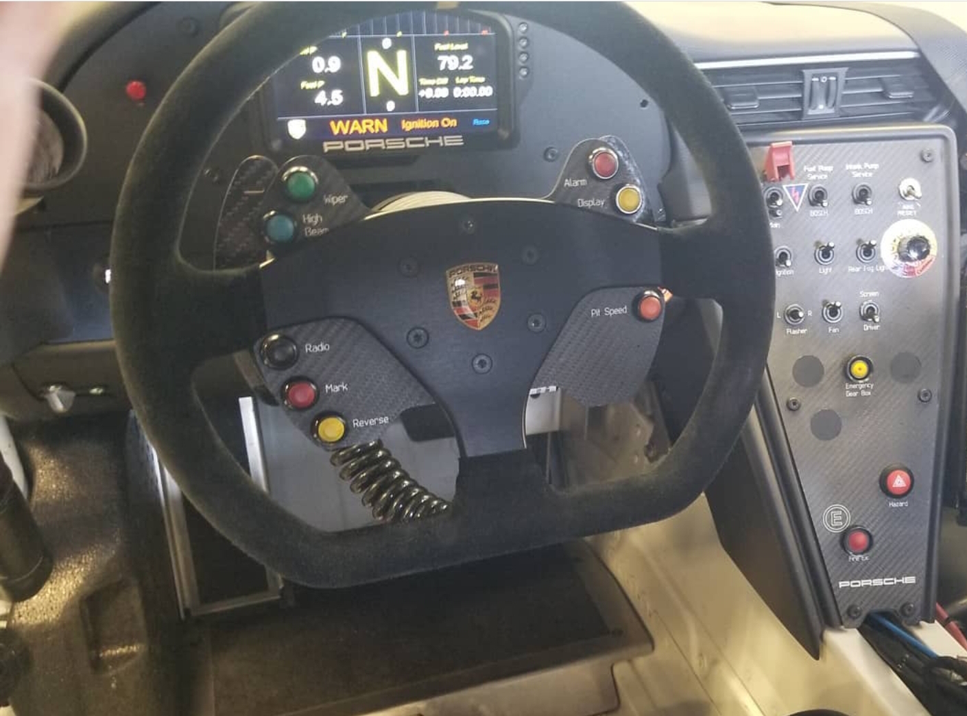

Not just yet on the Paddles ! but I'm going to incorporate this C/F center control panel design (GT3cup) for all required toggle, push switches, etc.
I've sourced a rectangular C/F sheet and it will double as a cover plate for the cabin air-jack cylinder, which sits right below the dashboard.

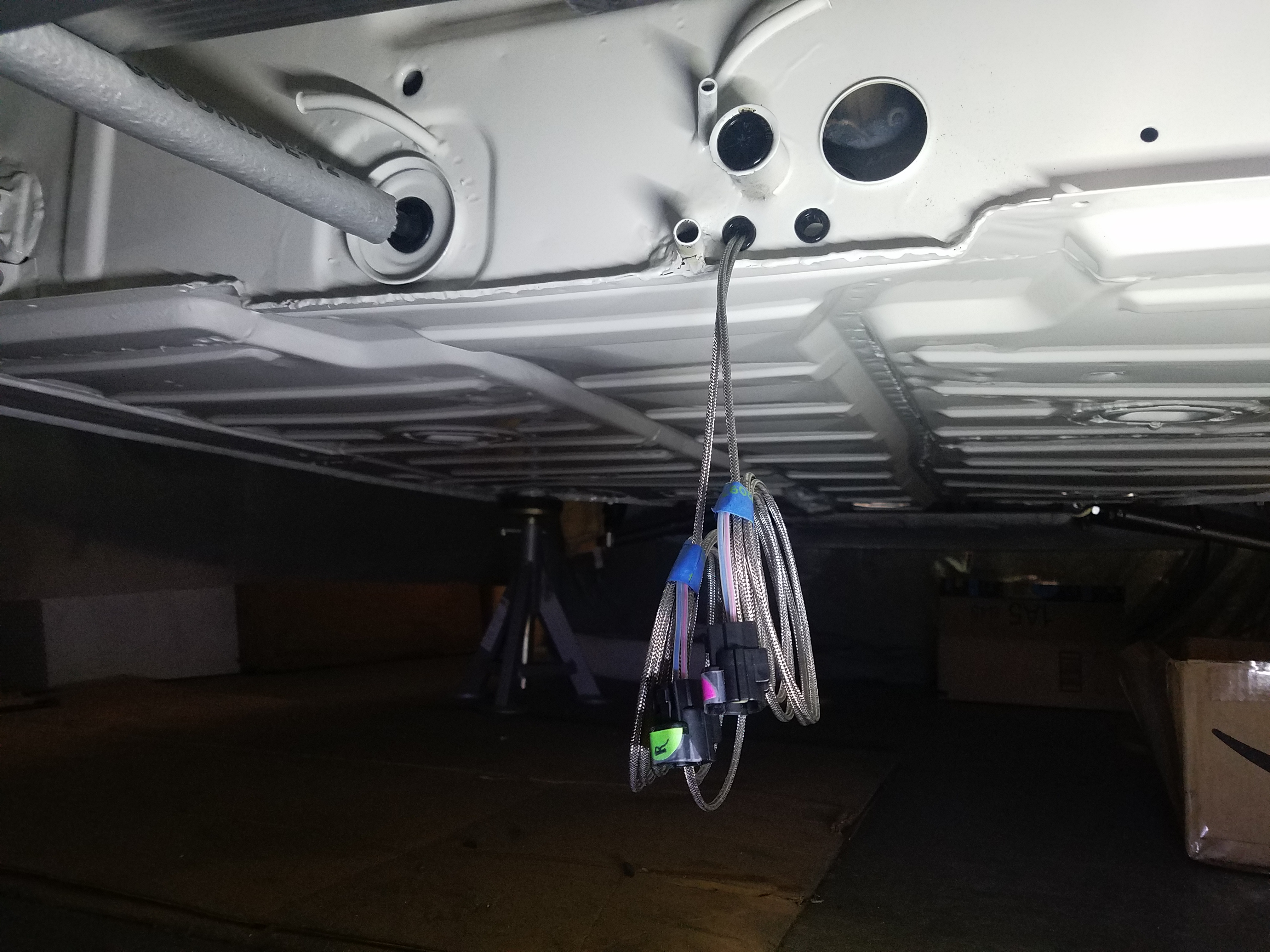

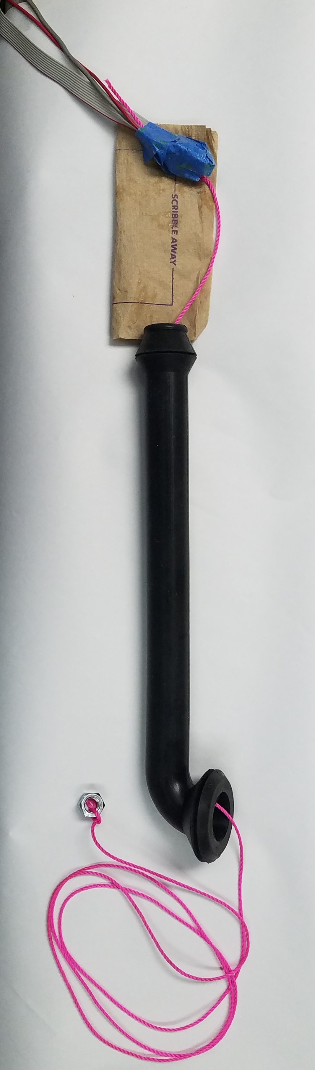

Making use of all of the OE lower firewall passageways
Maltese Falcon
post Dec 4 2020, 08:28 PM
Post #539
Posts: 5,286
Member No.: 2,755

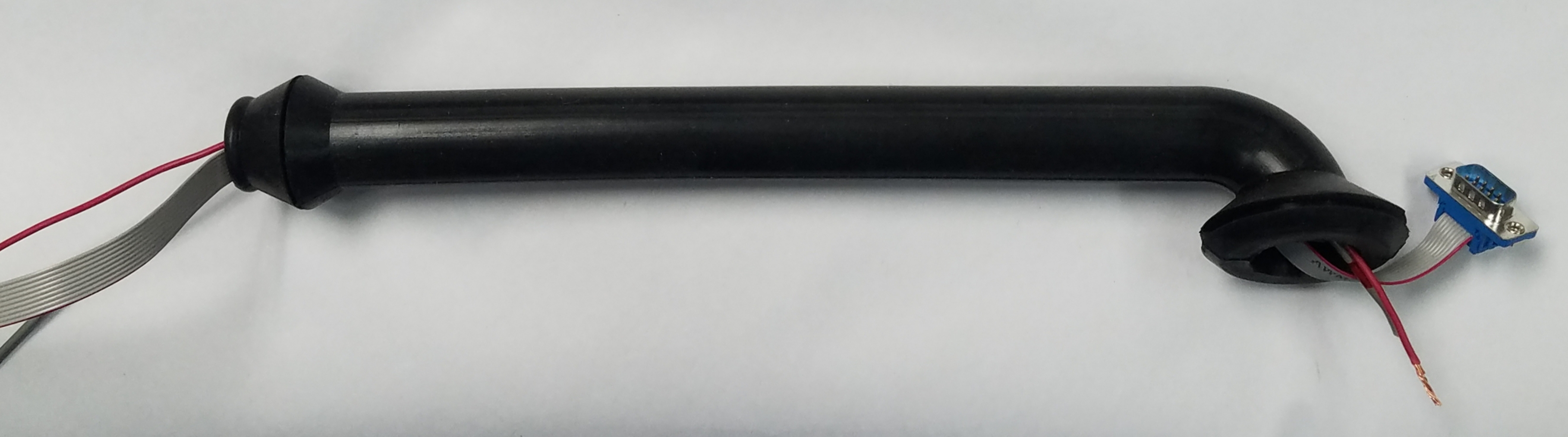

Mr. Snorkel taking on some new residents
Maltese Falcon
post Dec 4 2020, 08:33 PM
Post #540
Posts: 5,286
Member No.: 2,755
A couple of SQS control wires, and a 9-lead connector cable, easily pulled through. Still have more room in the Snorkel; keeping some OG style in the engine bay (IMG:style_emoticons/default/smile.gif)
