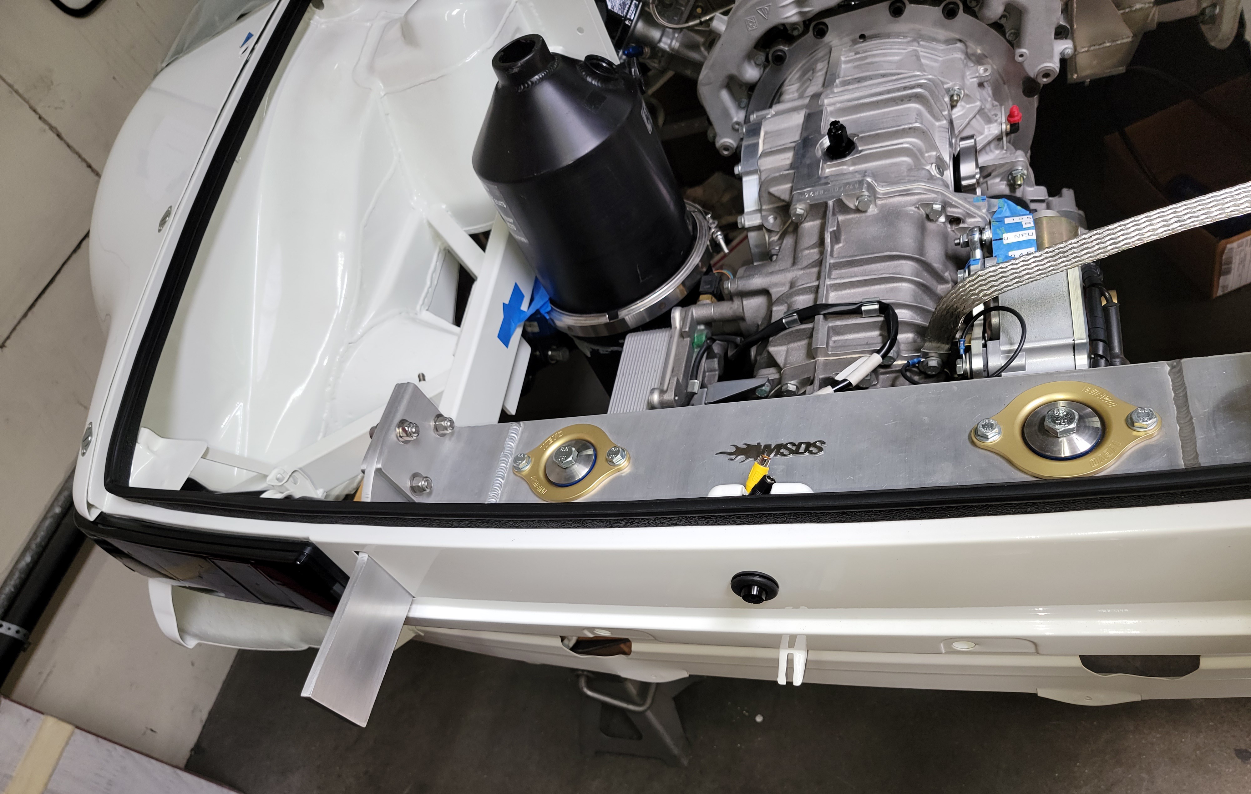

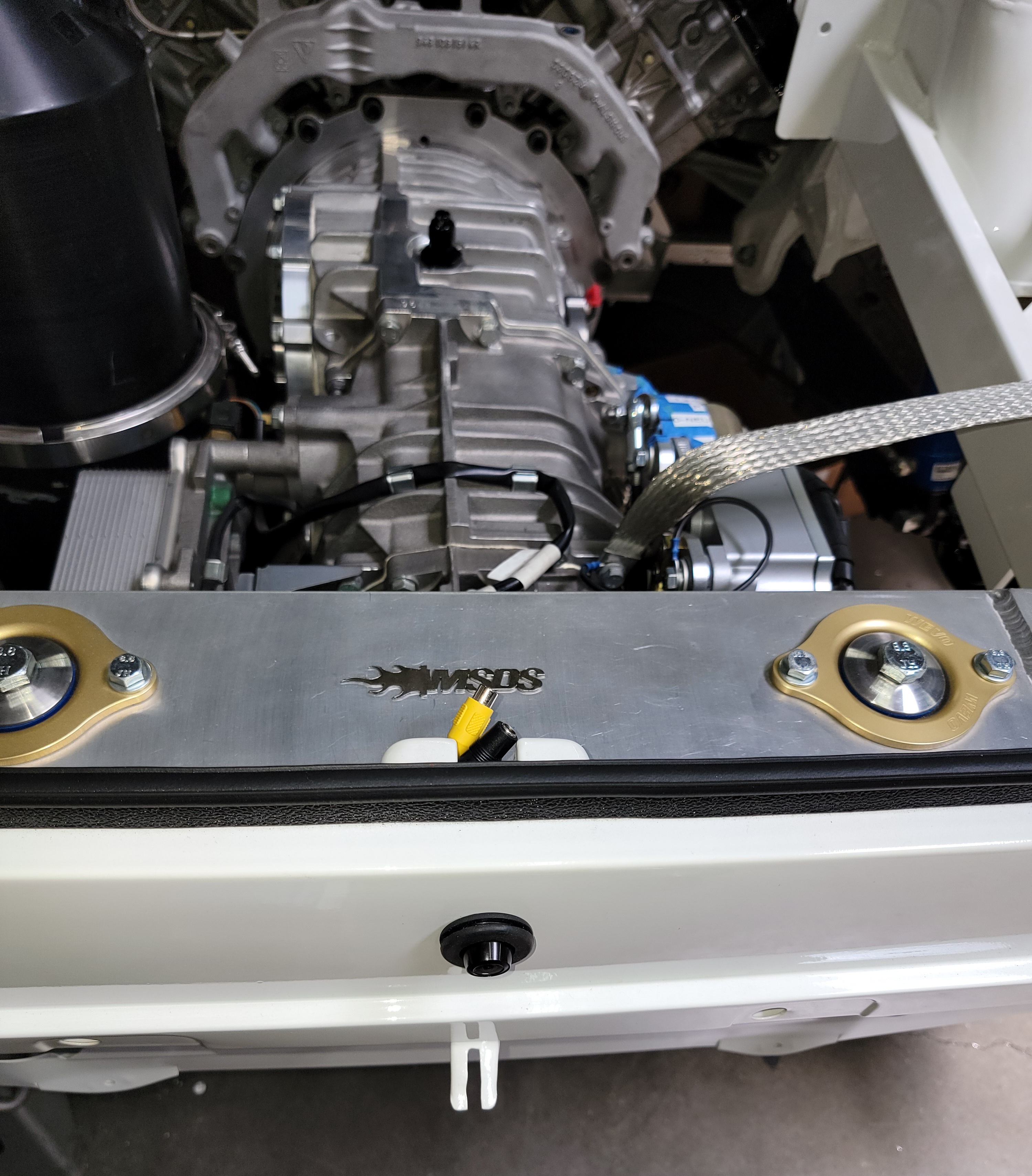

Rear viewing camera location is the former trunk latch
Maltese Falcon
post May 27 2021, 09:20 PM
Post #563
Posts: 5,286
Joined: 14-September 04
From: Mulholland SoCal
Member No.: 2,755
Very helpful when suited up with Hans Device and backing up; and as a big screen rear view mirror !

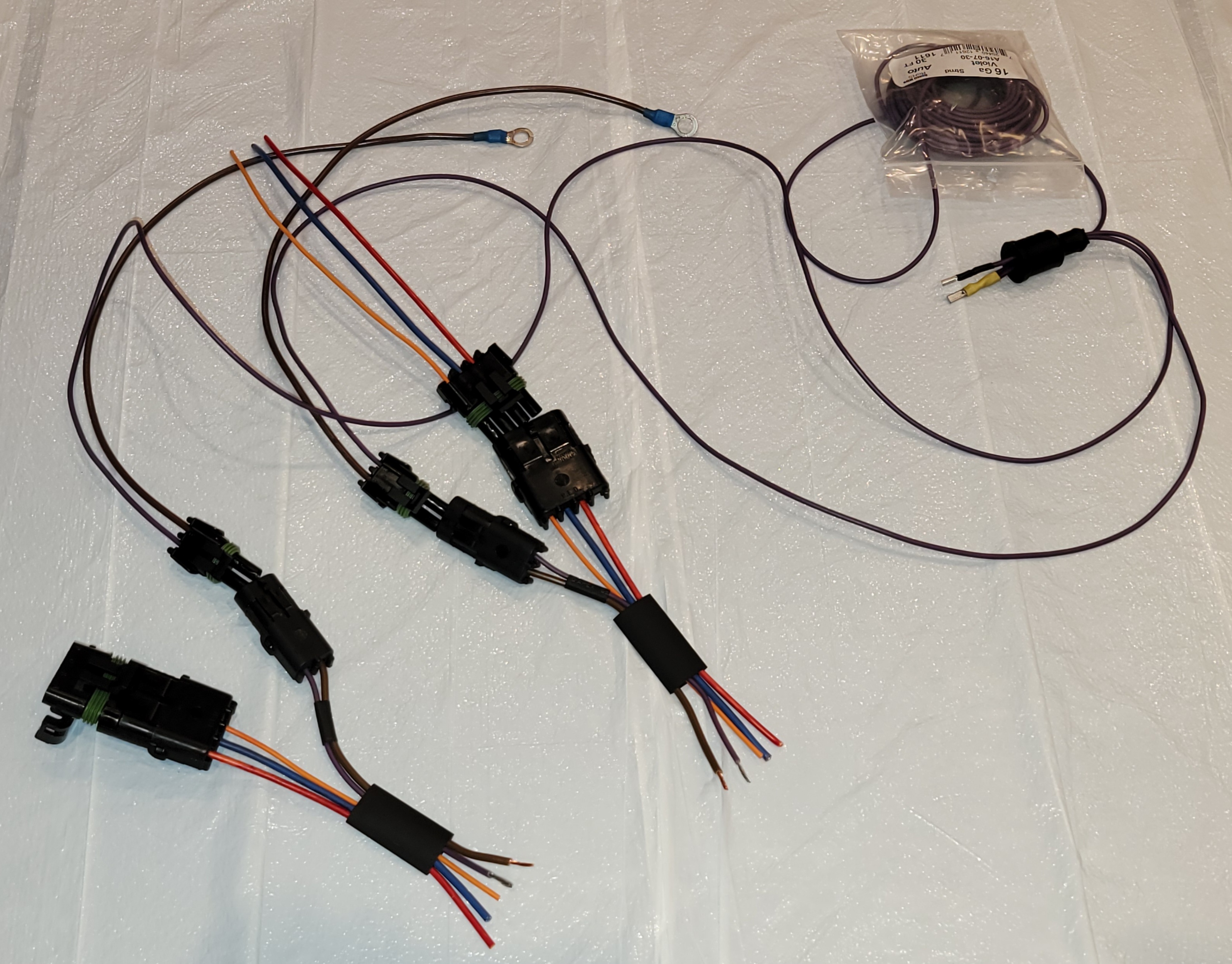

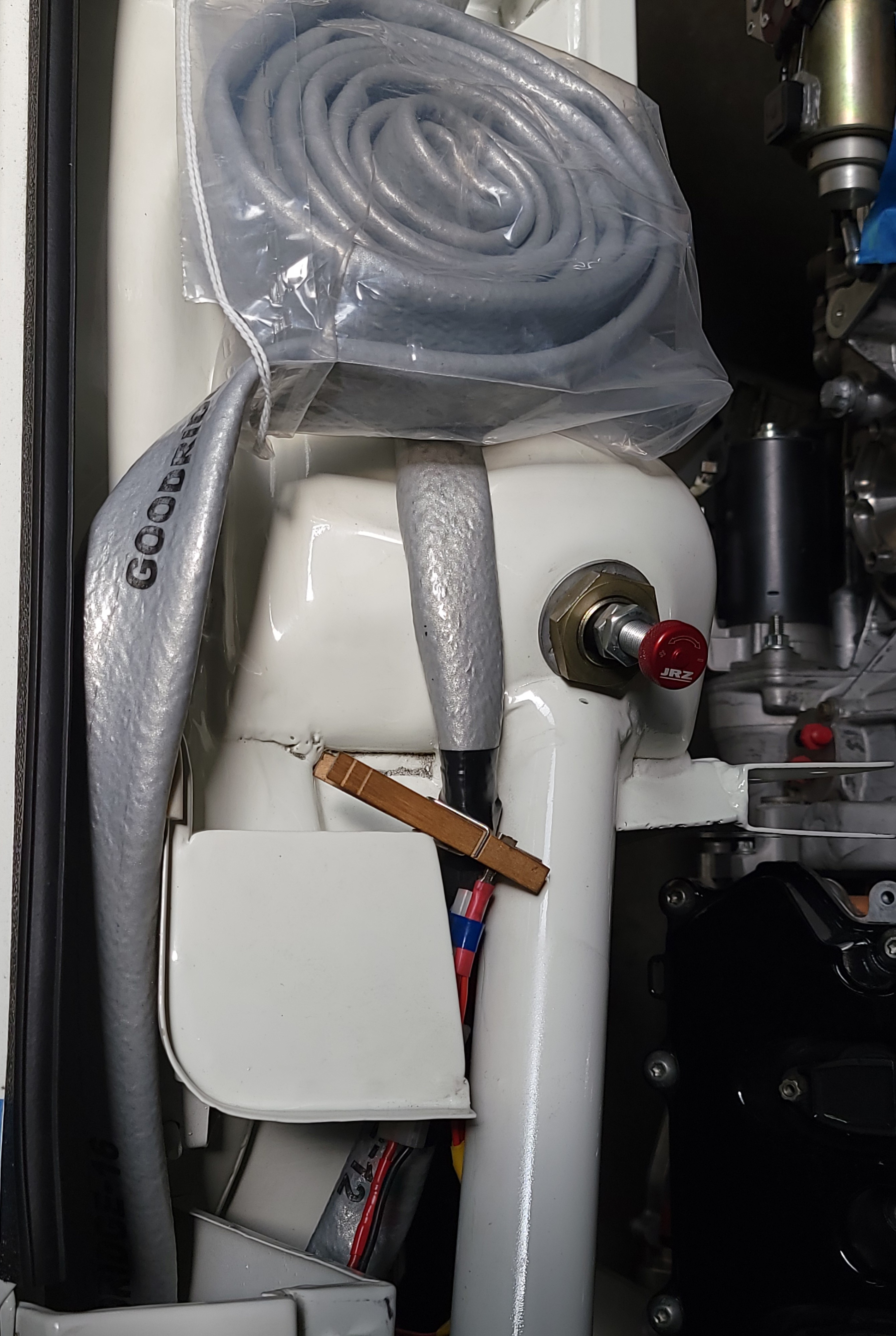

Made these quick-release connection circuits for the rear tail-lamp housings. Since the Left and Right housings are removed whenever the quarter panels are R+R, this system is way quicker than messing with 10 push-on connections. Yes this car comes with a new color coded schematic, several of them (IMG:style_emoticons/default/smile.gif)

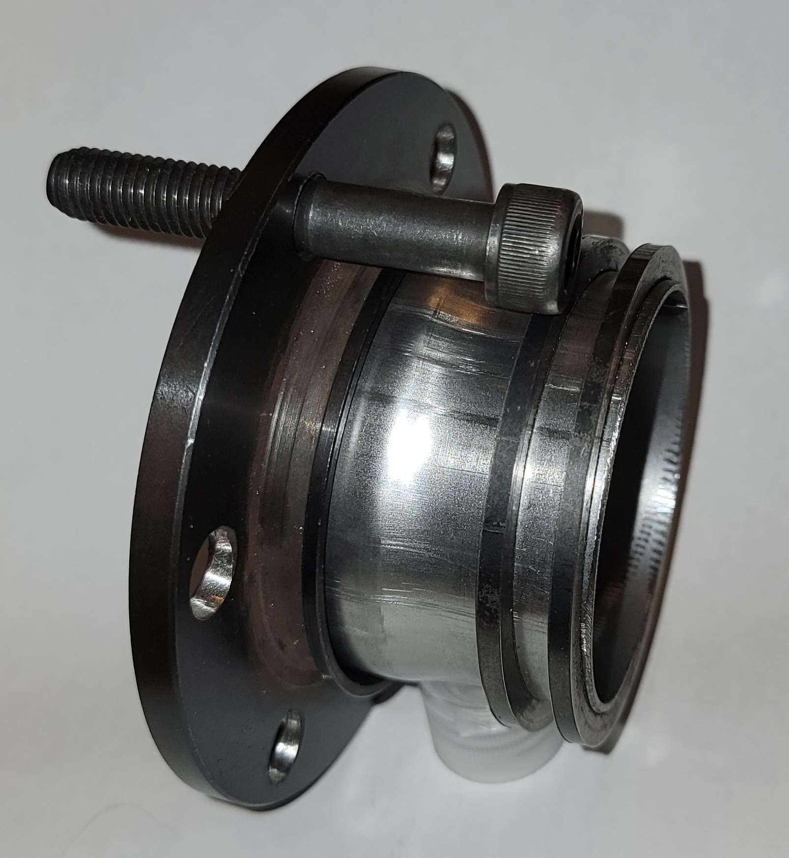

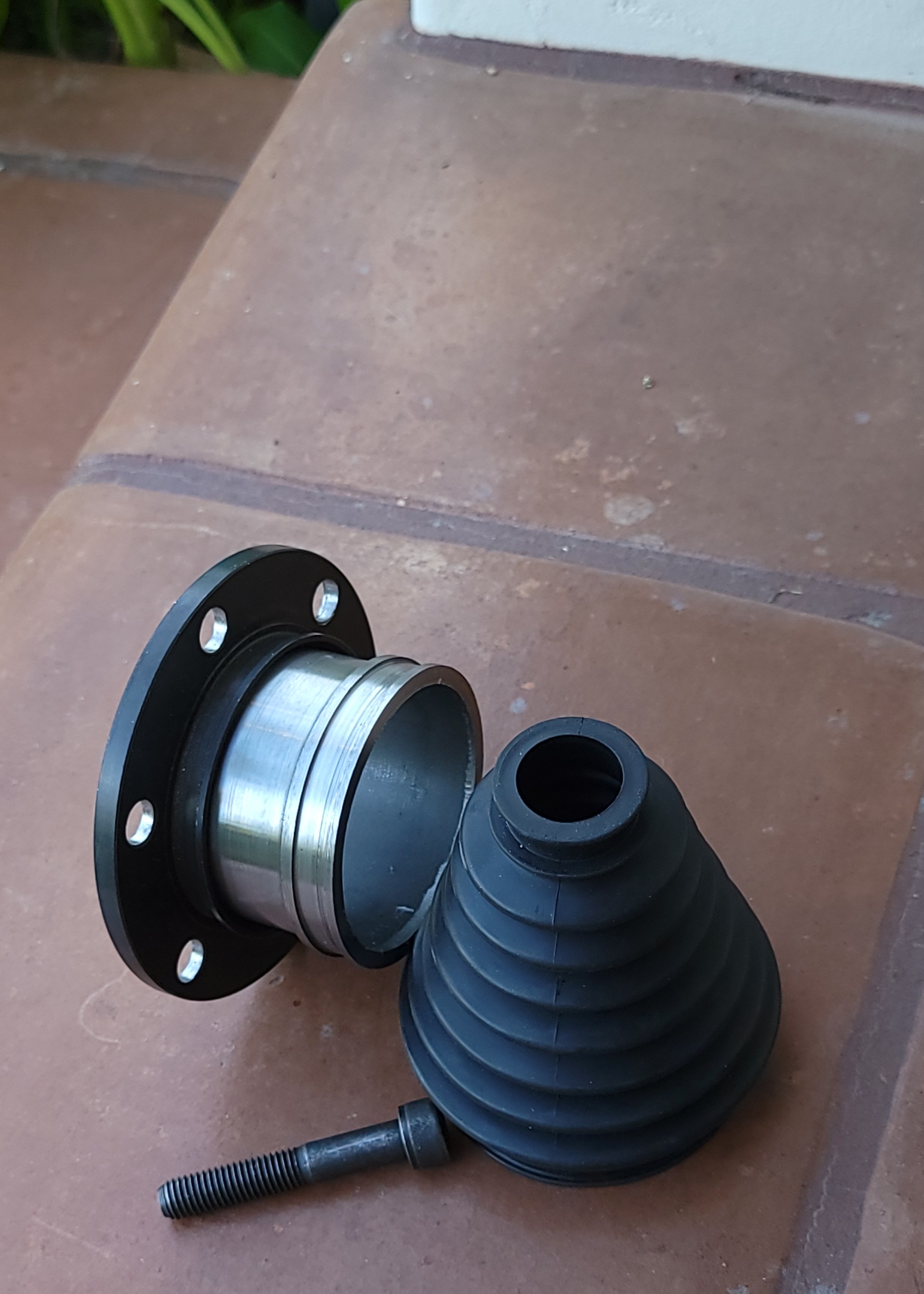

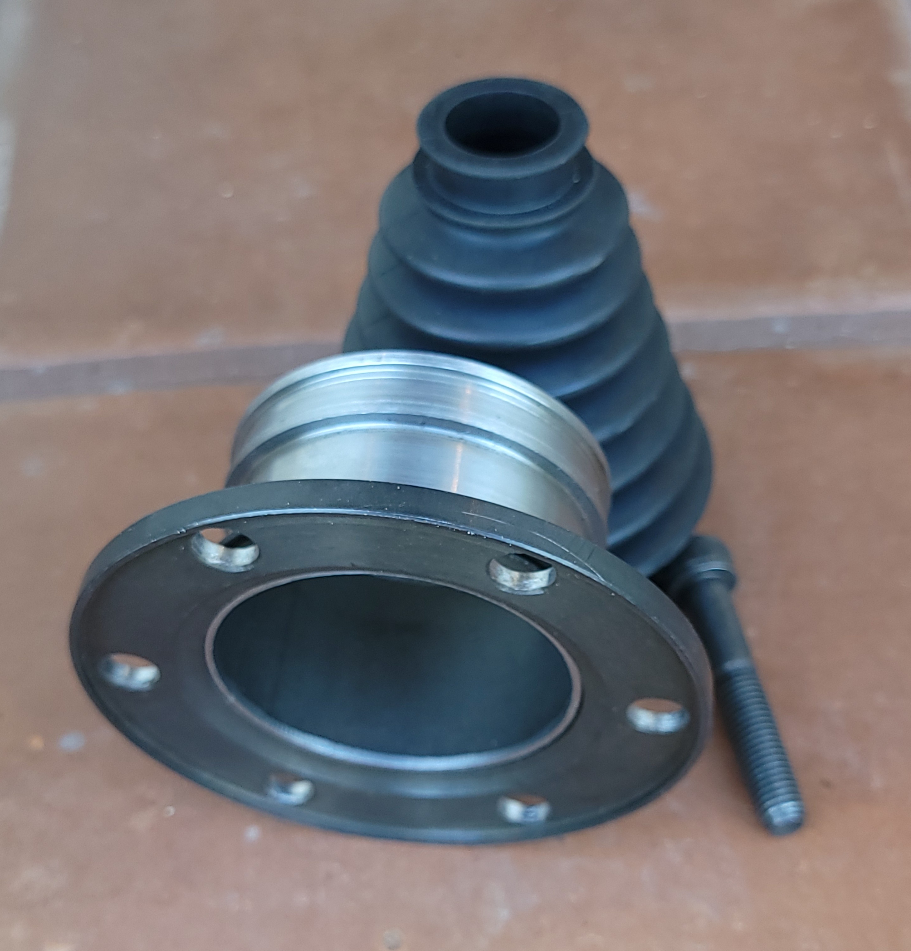

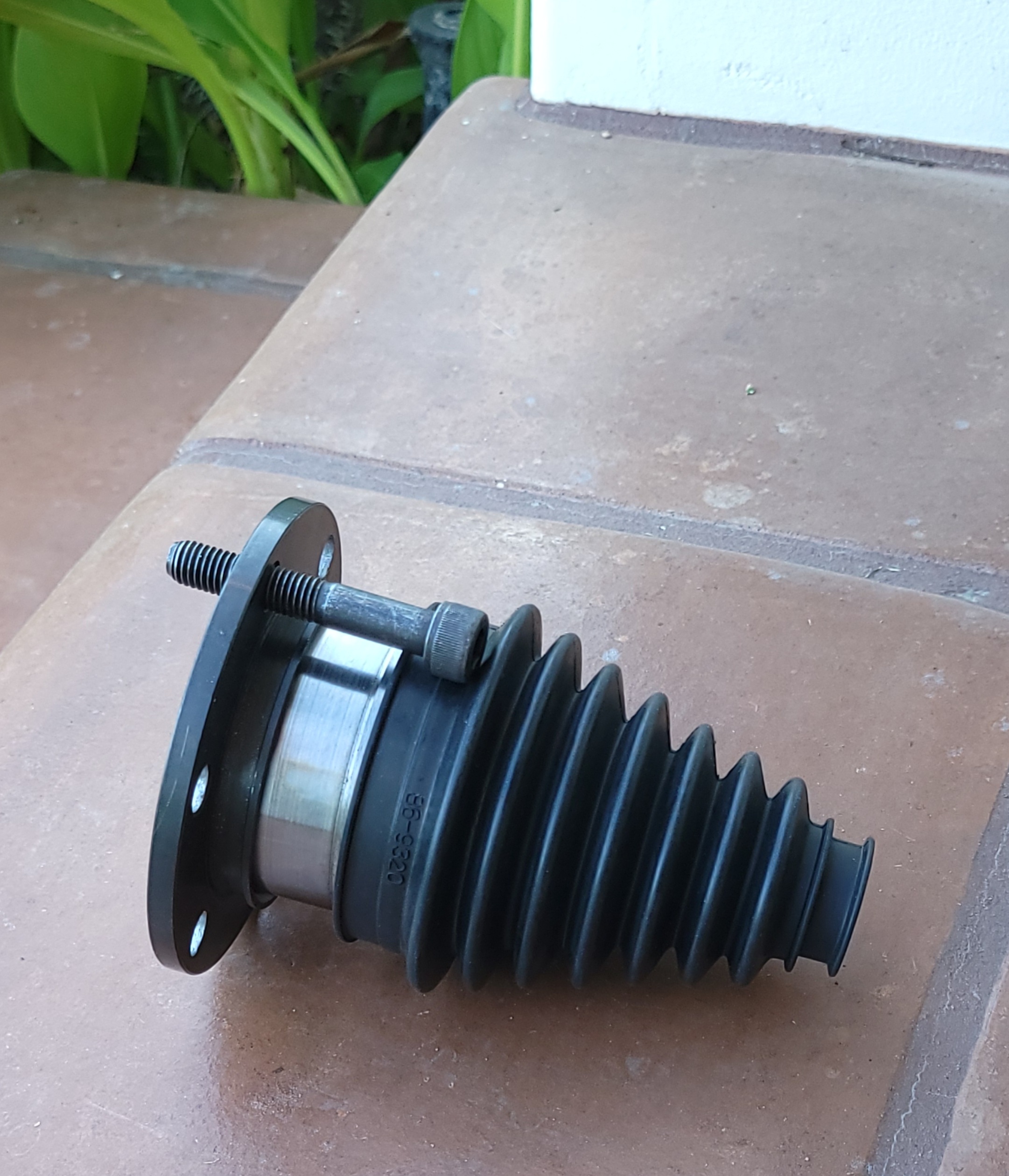

Small but major issue with the spec-mfg C/V boot -flange and 10mm bolts; just not made right ! The dia of the boot "Seat" where the clamp pulls the boot tight, is so tall that the bolts get canted...so one can not work the bolts into the joints. Even worse deflection when the clamp is installed.
Maltese Falcon
post Jul 8 2021, 11:54 PM
Post #568
Posts: 5,286
Member No.: 2,755

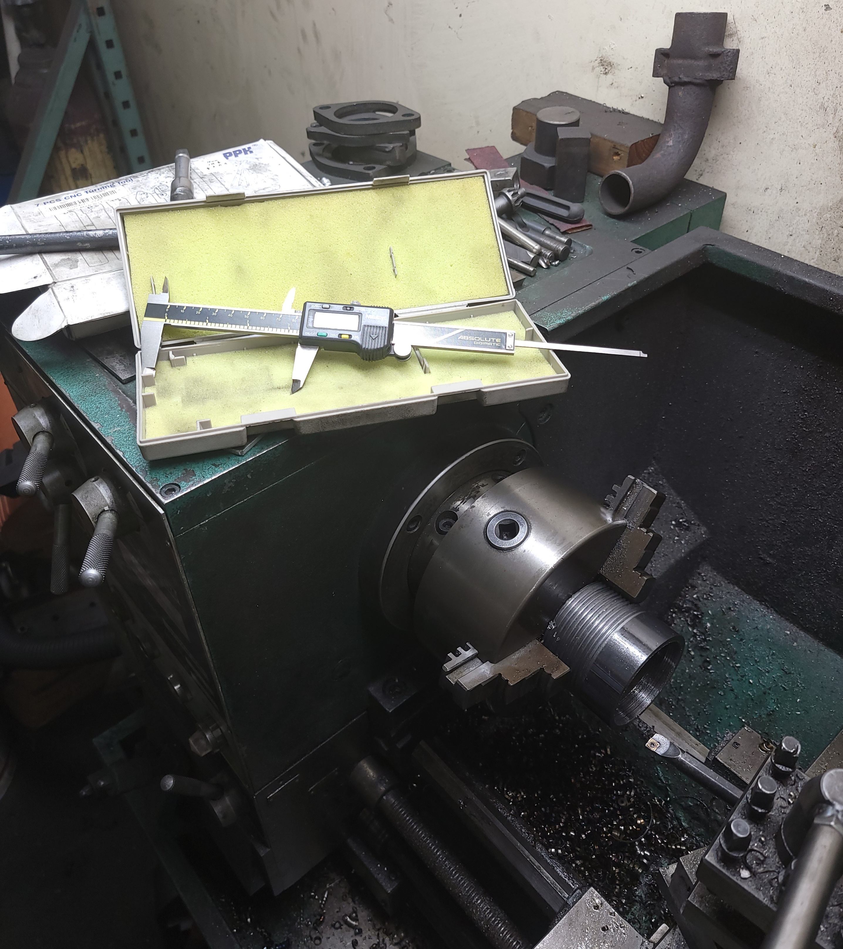

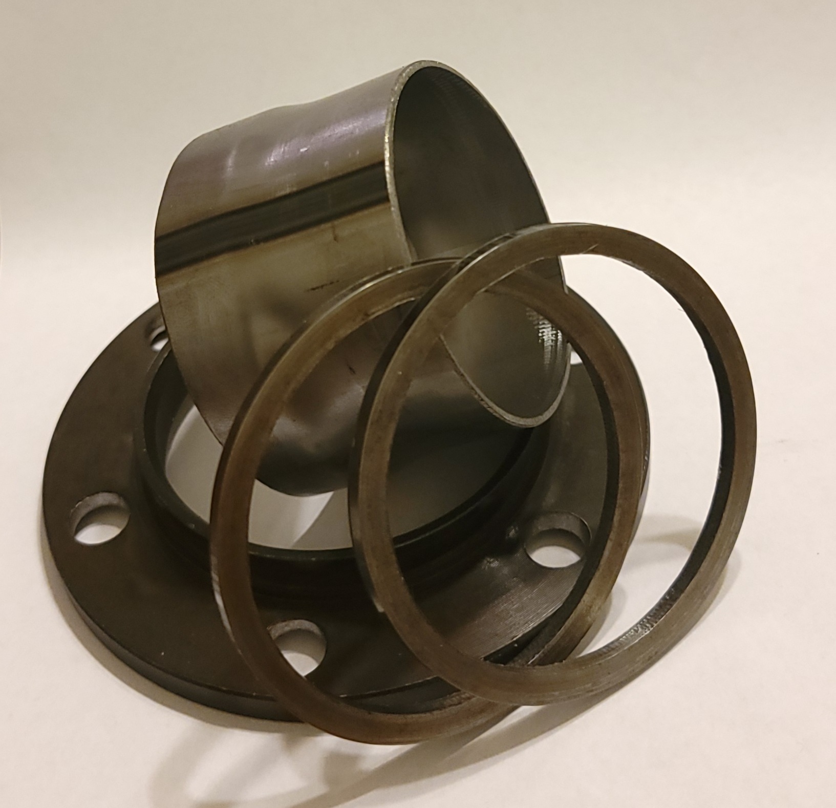

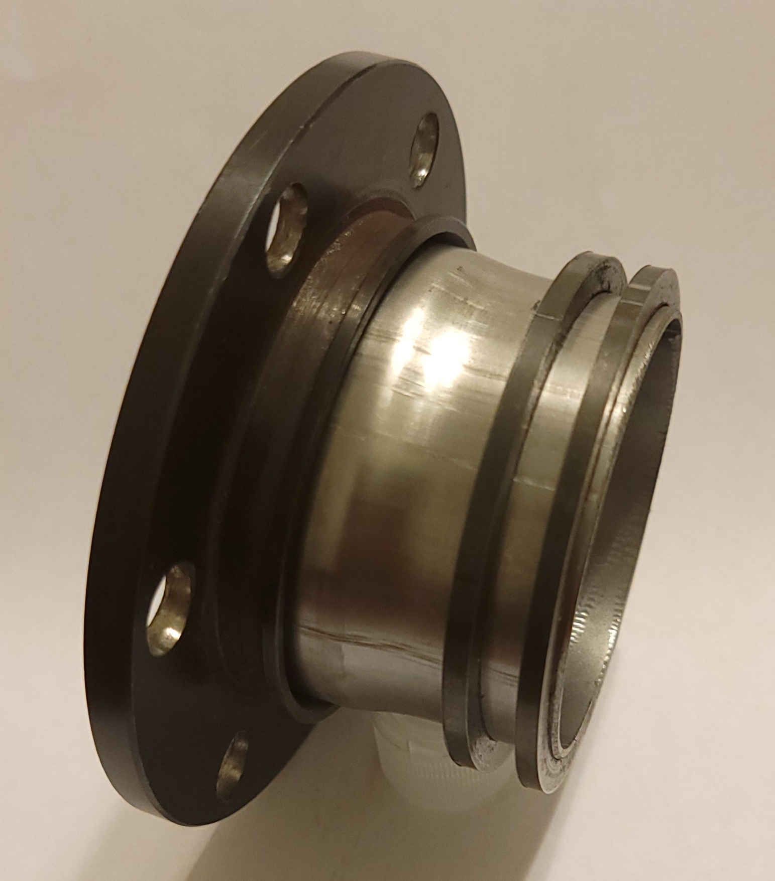

Making some custom rings from 2 ¹/²" sched 40 steel pipe
Maltese Falcon
post Jul 9 2021, 12:00 AM
Post #569
Posts: 5,286
Member No.: 2,755

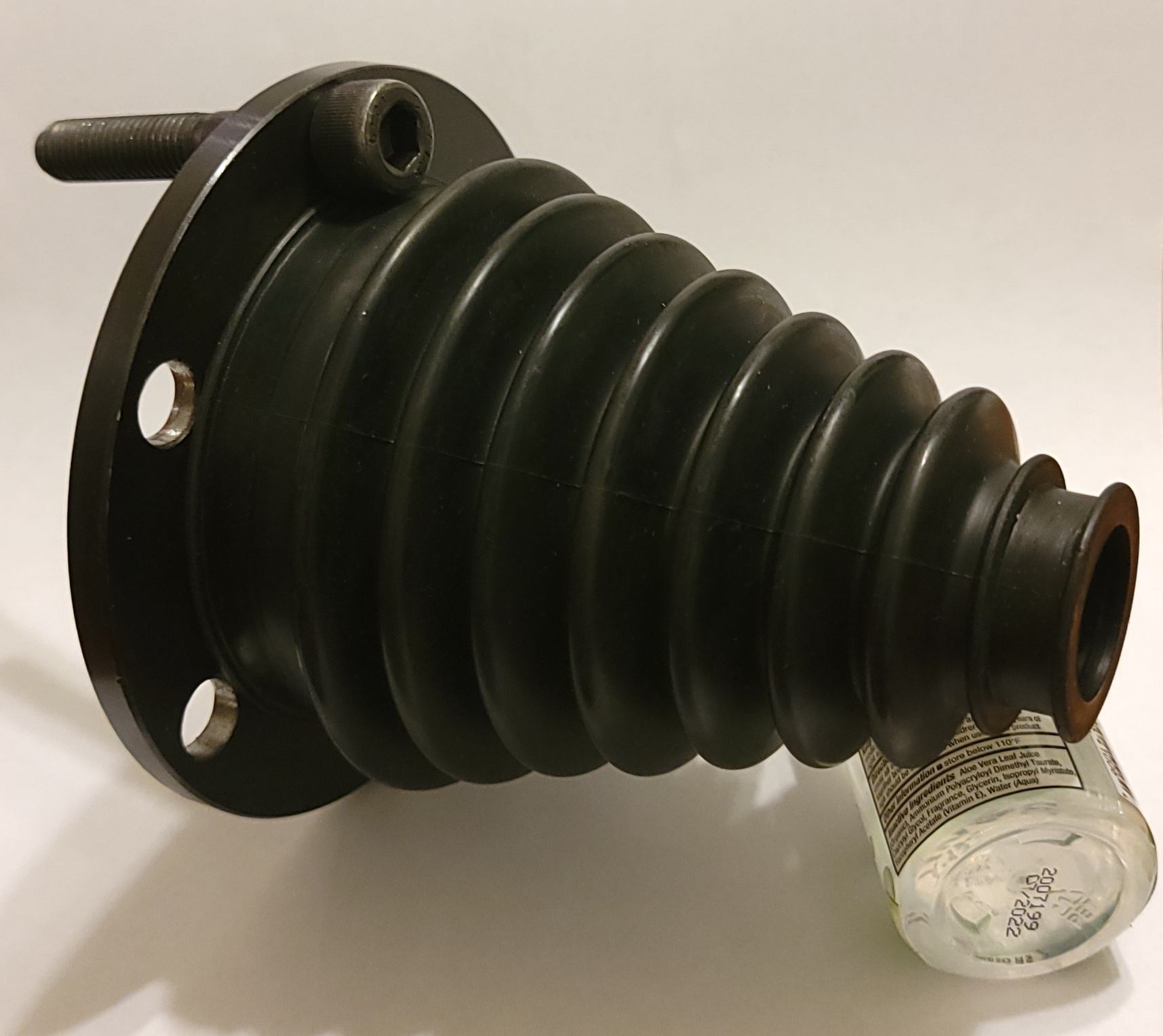

Then using a small piece of 2 ¹/²" c/r .065" tubing, swedged to slip into the c/v boot flange, place the rings on the opposite ends for a New clamping area, =straighter shot for the bolts
Maltese Falcon
post Jul 9 2021, 12:07 AM
Post #570
Posts: 5,286
Member No.: 2,755
Just need to finish welding these components together, coat and get back to fitting the 300M Sway-Away axles to the rocket. Bolts are happy and can enter horizontally/ non binding

Going to use this Gen-2 style; made from sched 40 2 1/2" pipe

Nice snug fit

Inside view

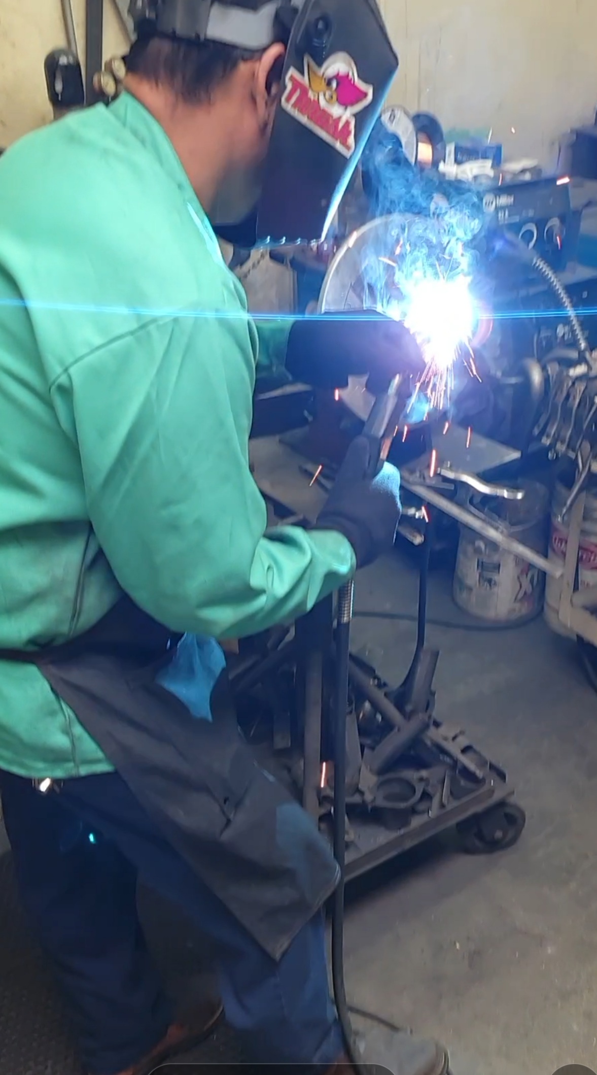

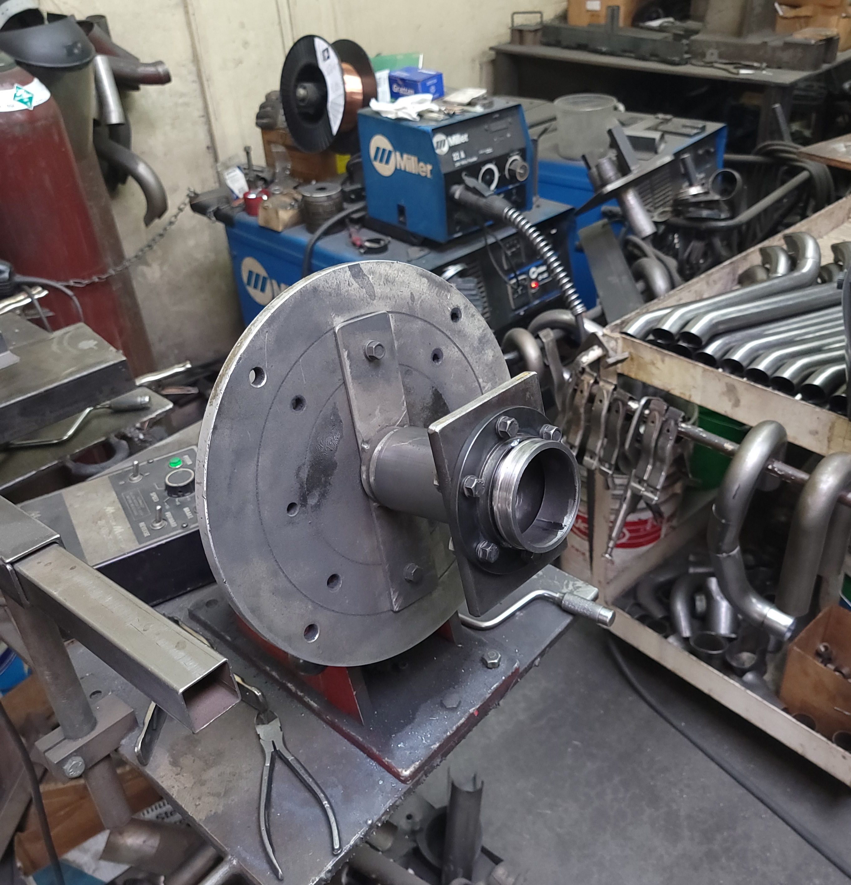

Setting up for MIG welding in the "Rotator"
Maltese Falcon
post Sep 3 2021, 10:05 PM
Post #577
Posts: 5,286
Member No.: 2,755
Burn 'em in !
Maltese Falcon
post Sep 3 2021, 10:08 PM
Post #578
Posts: 5,286
Member No.: 2,755
1 down , 3 to go

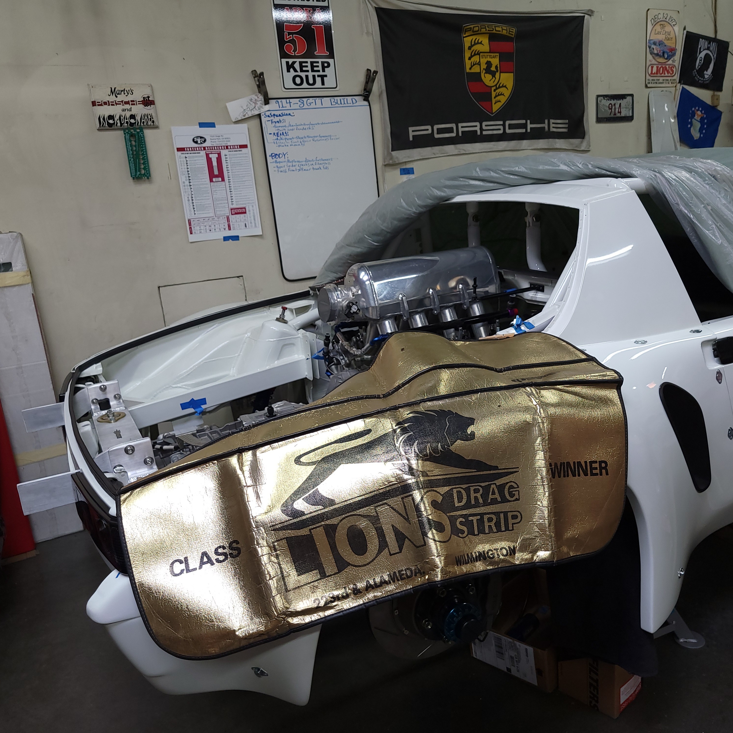

A little throw back to my days spent down at Lions Dragstrip. This fender cover has been on all of my proj's, since Nov. '71. It was the "Doorprize " for my run that Sunday morning !
