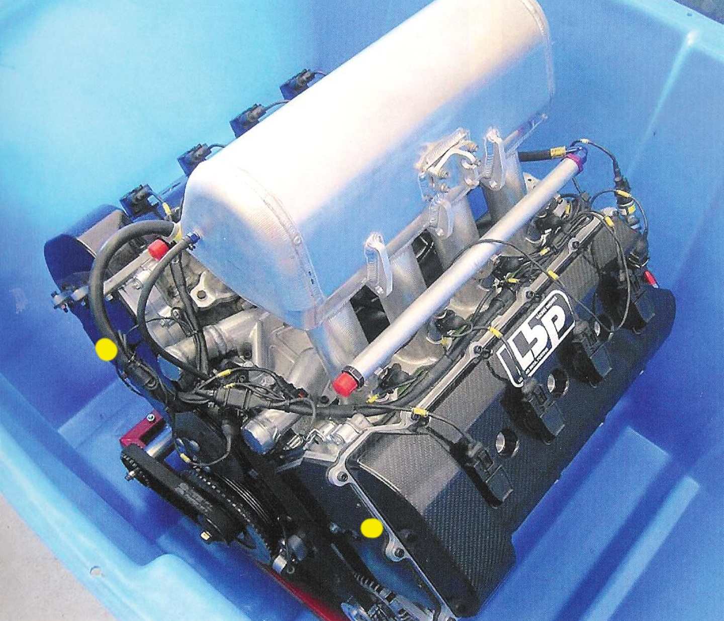

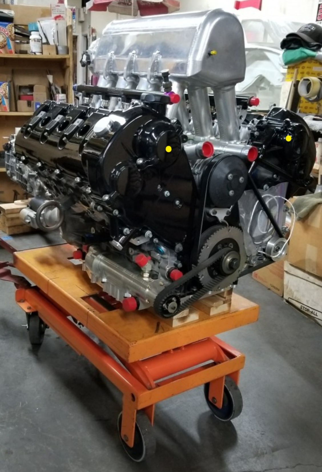

The heart of the beast when it was first received
(IMG:http://www.914world.com/bbs2/uploads_offsite/img28.imageshack.us-14843-1363241871.16.jpg)
What the engine will 99.9% look like when finished, and yes this is the 2010 Daytona Prototype (and Cayenne V8 all motor) winning car that you were just trying to remember.

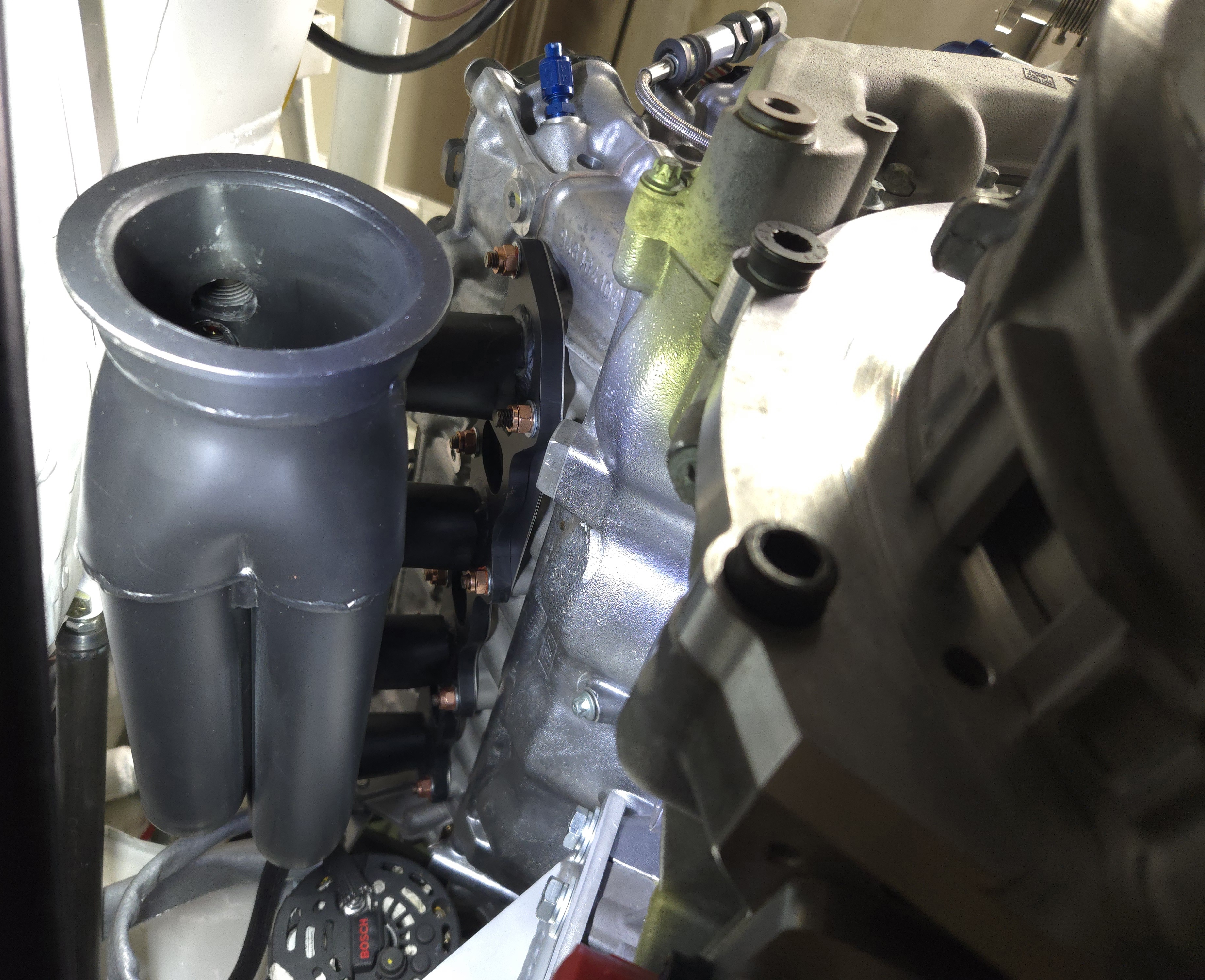

Maltese Falcon   One of the oe turbo exhaust manifolds. You can jus...   Mar 22 2013, 07:04 PM
Maltese Falcon   The "Flying mailbox" intake plenum.   Mar 22 2013, 08:38 PM
