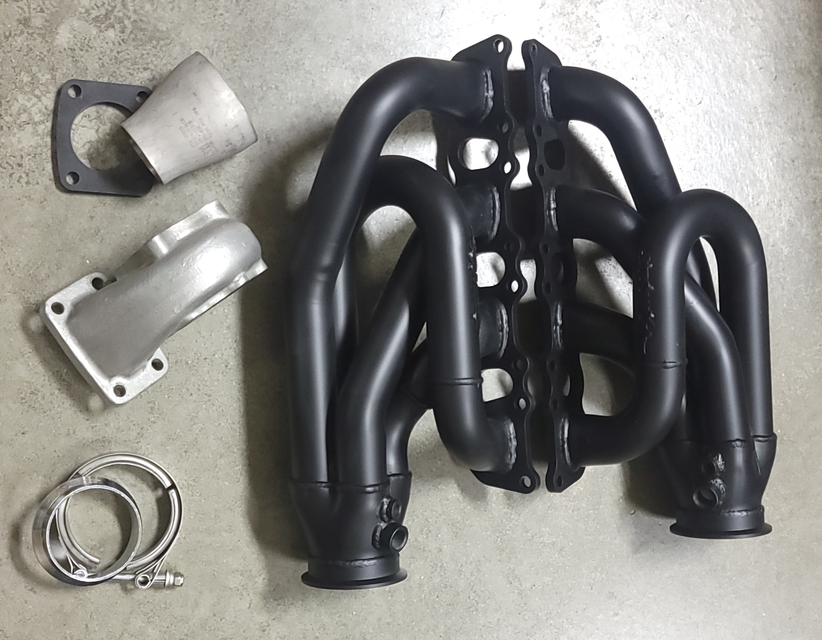

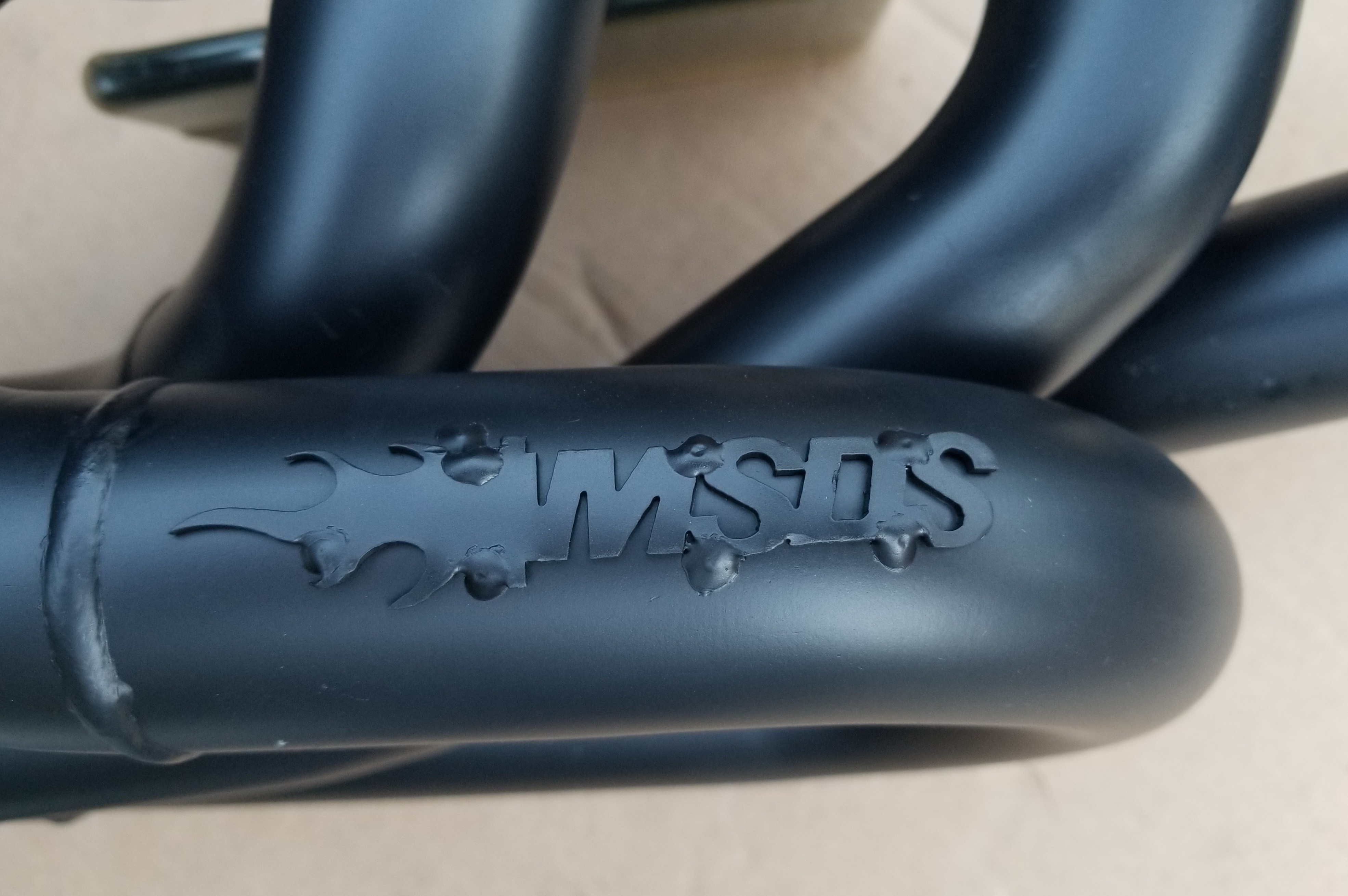

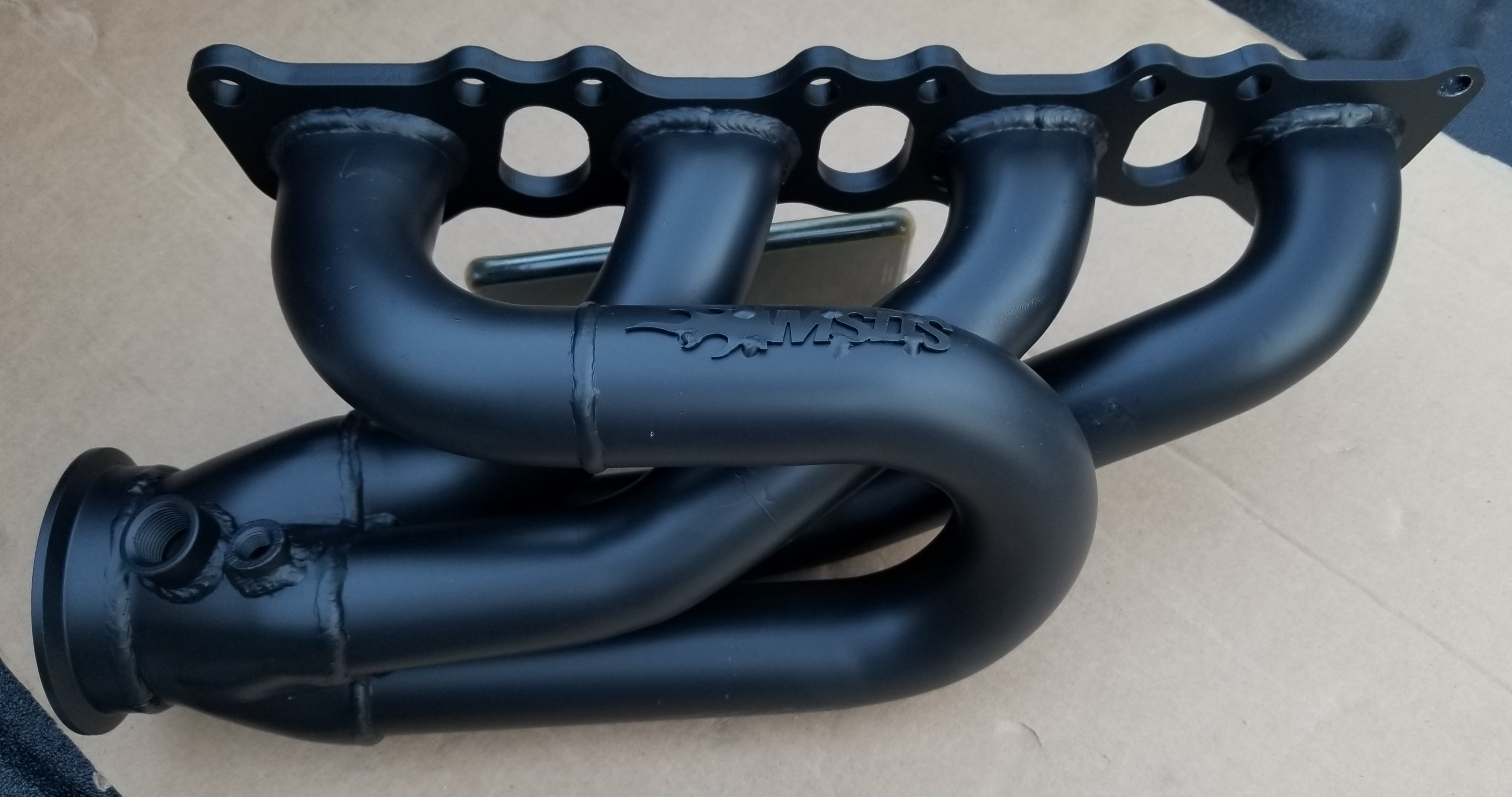

Moving into the forced induction segment of this build, just received the shorty headers back from Ceramic shop; we are using hi-temp satin black coatings on the entire exhaust system.
Both left and right sides header collectors have an O2 and egt port.

Gathering several misc items needed for prototype locations of the Garrett turbos

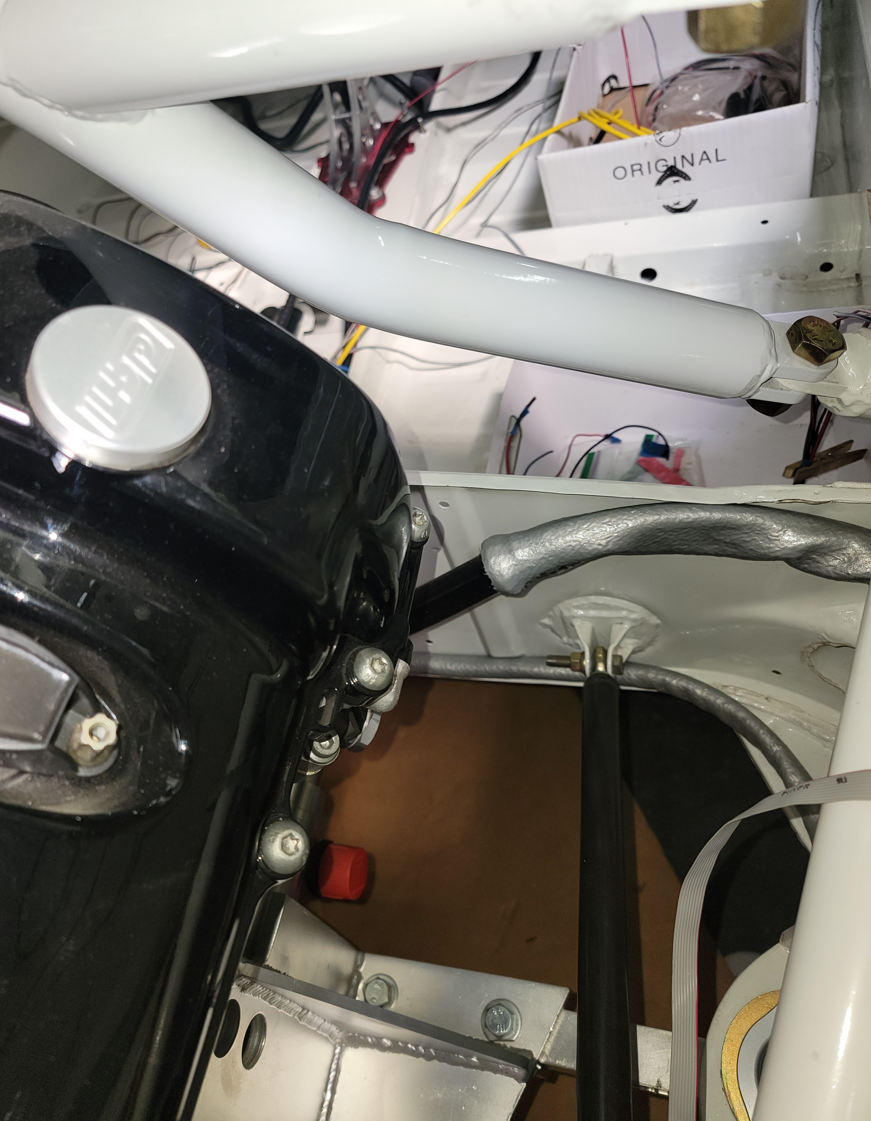

914 firewall wiring Snorkel is a great fit into the Goodridge fire-sleeve, and something else we're fitting into this build "Old Skool style" 914 parts.
It's very accommodating and we can fit lots of wires + one 8- piece (14ga.) insulated cable in there ! This particular electrical run spans from the dashboard, pedals (floor area), and center console to the rear of the trunk area.

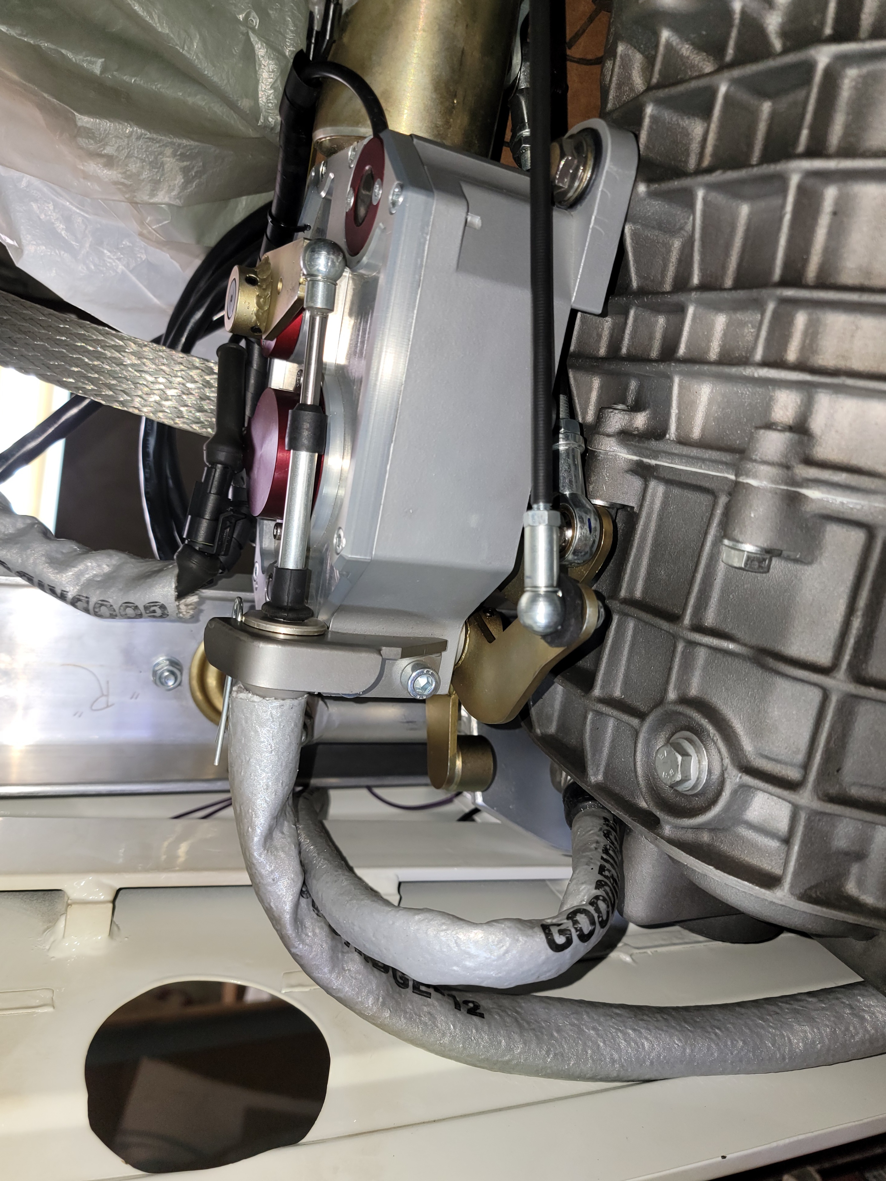

Onward to the transaxle nosecone, wiring for the Reverse light sending-switch in the (narrow dia) Goodridge fire sleeve now complete.
