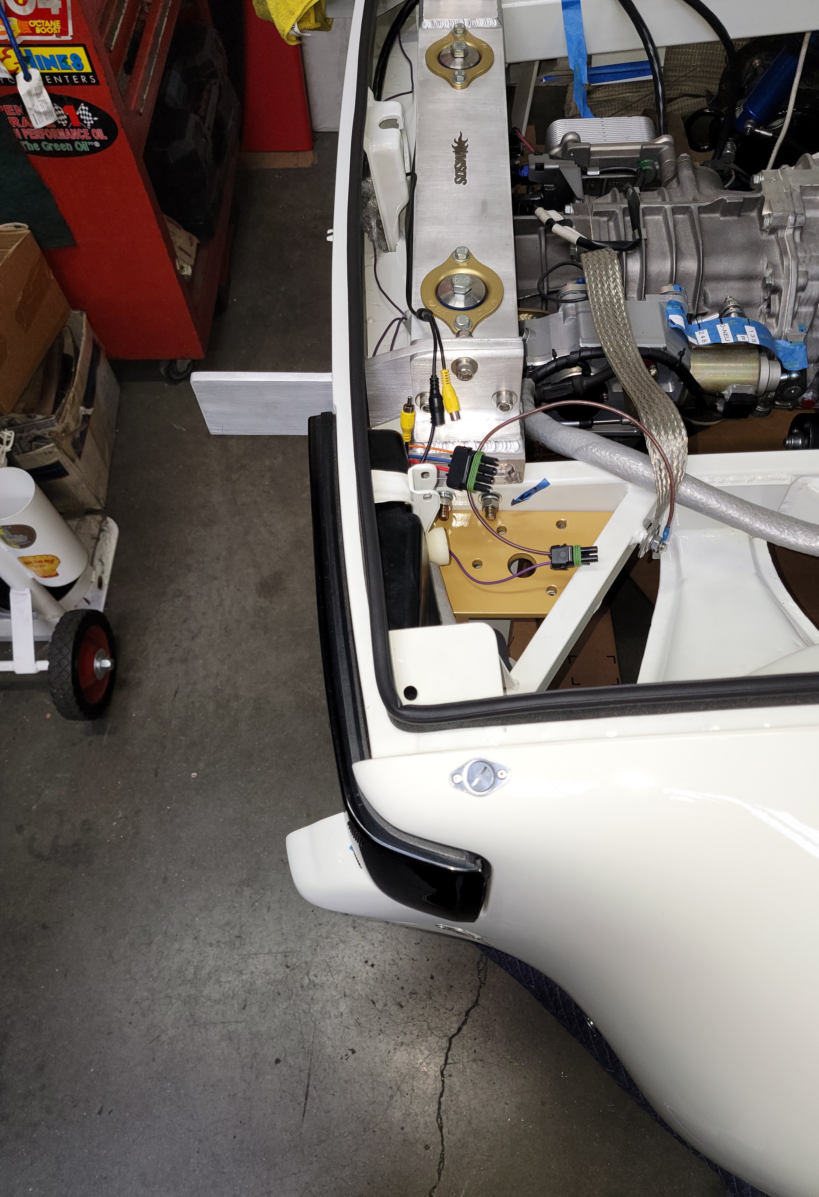

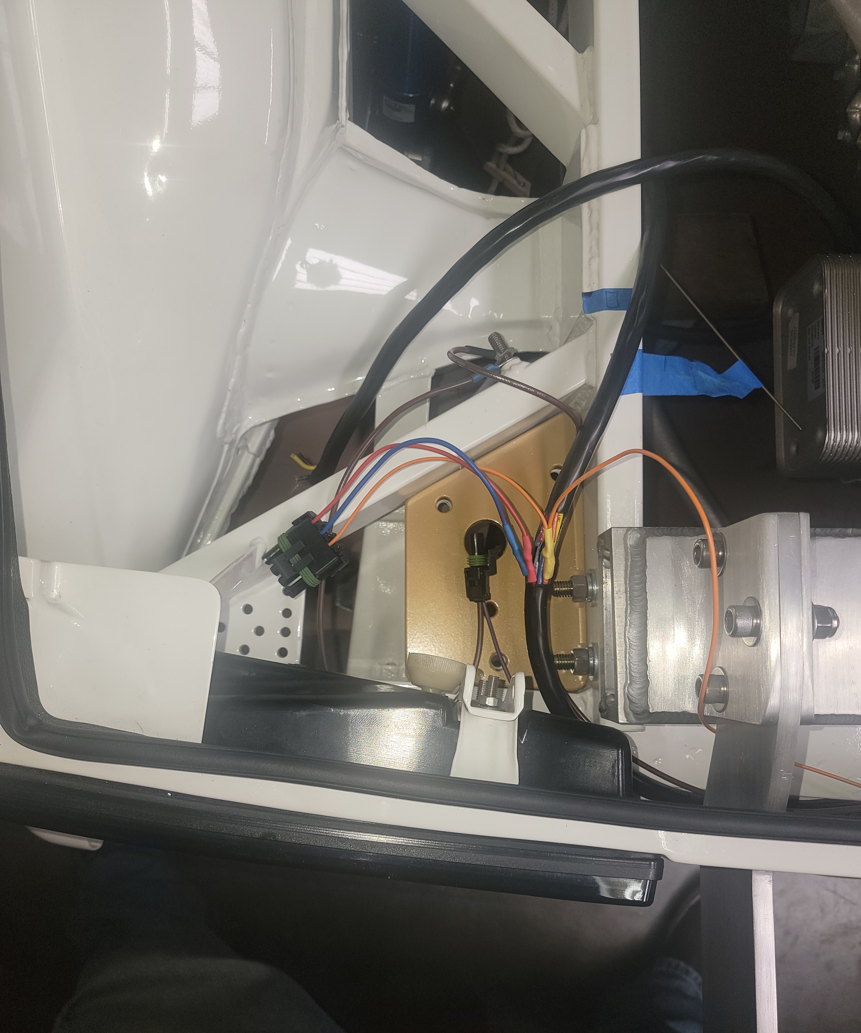

Left-side rear wiring ; black (8 wire) cable will finish up making a U turn heading back to the engine bay.
The last available wires will run to Coolant temp/ engine oil temp/ trans oil temp.

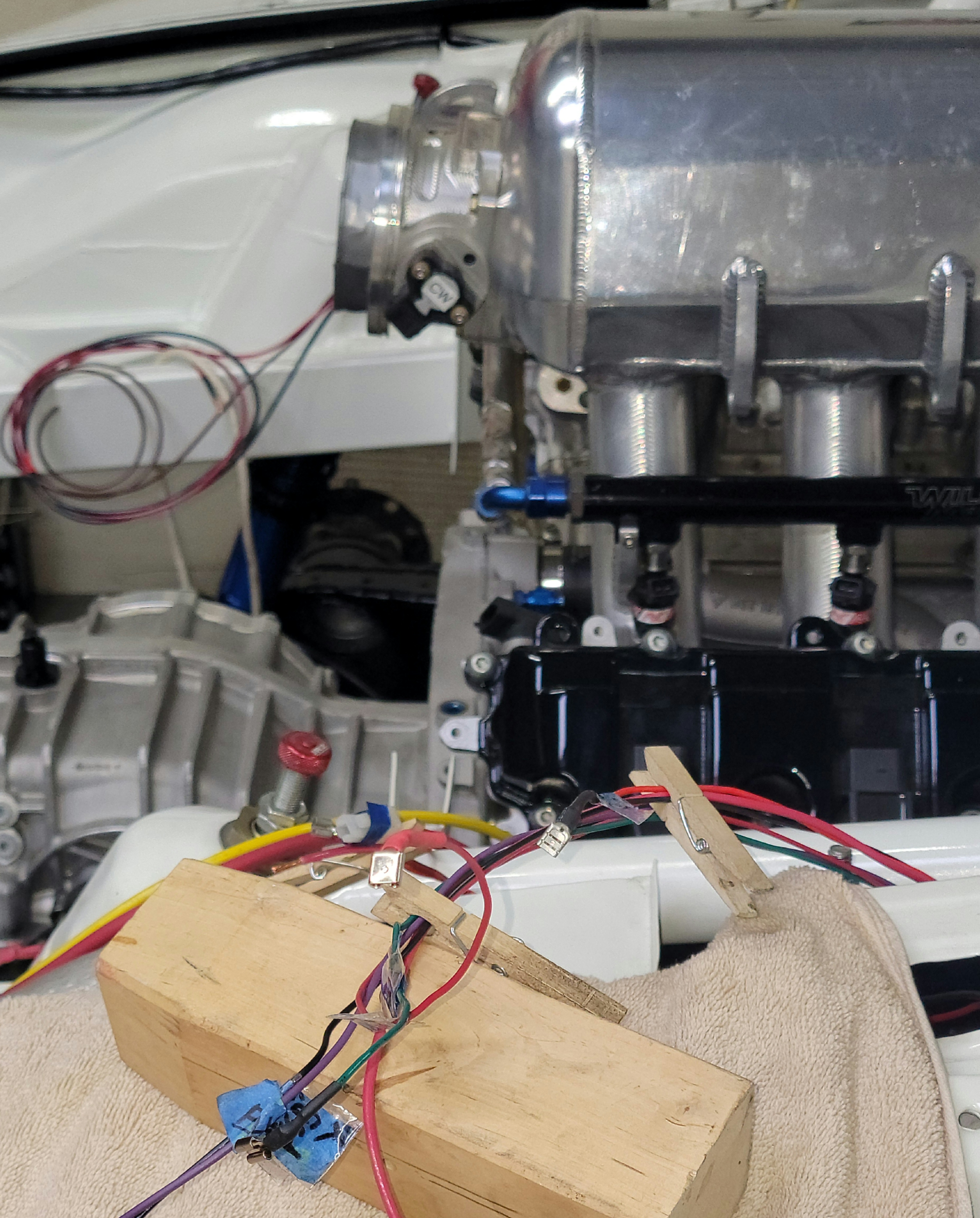

Interior multi-wire cable now totally supplying circuits to left, center, and right sides of the engine bay. 12v Coolant pump for the transaxle cooler will be on a manual switched circuit, not triggered by the oe temp switch.
OE temp switch is being replaced by a VDO oil temp sender + gauge for monitoring trans temp.

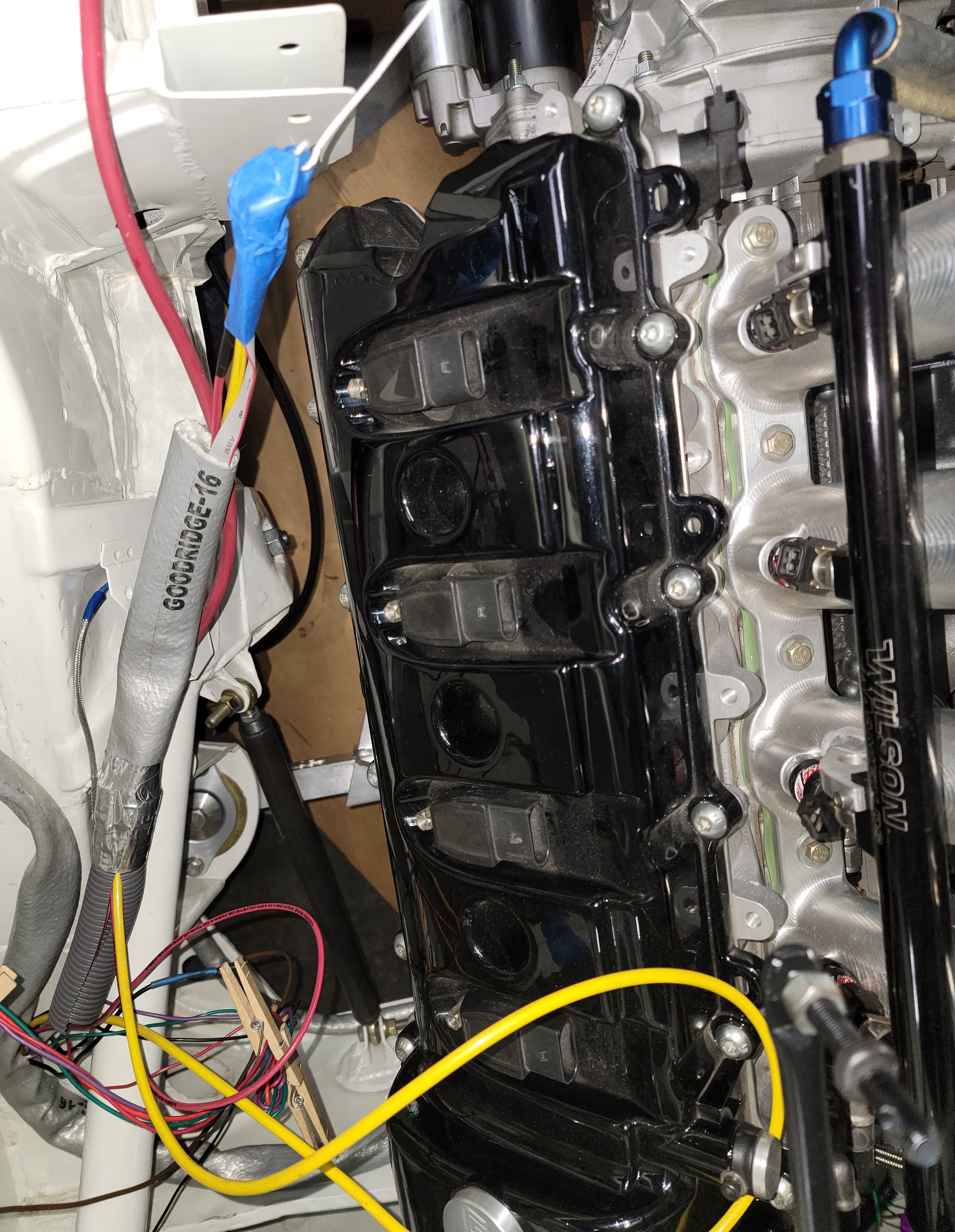

Still having lots of fun pulling wires through Goodridge fire-sleeve. Customized end on one side mates to a curved split-wire sleeve. I found a very special roll of "Aero grade" aluminum tape in the toolbox to join the 2 together.

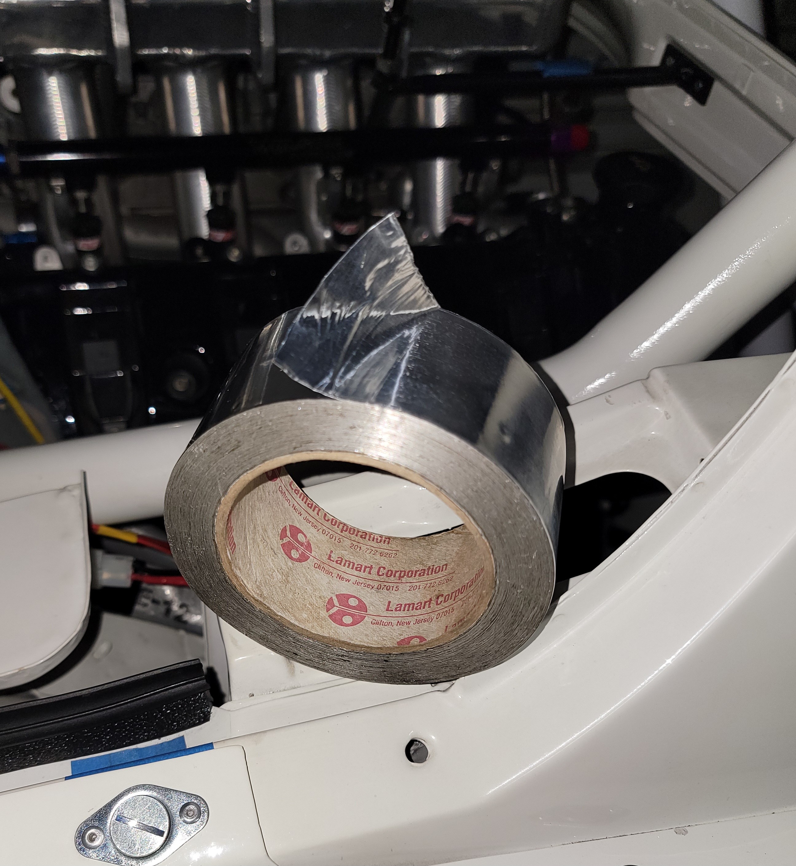

A Naval Air friend gave me this surplus roll of Lamart 3-mil aluminum Aero tape. He used it during temporary repairs on the birds, just to keep out debris.

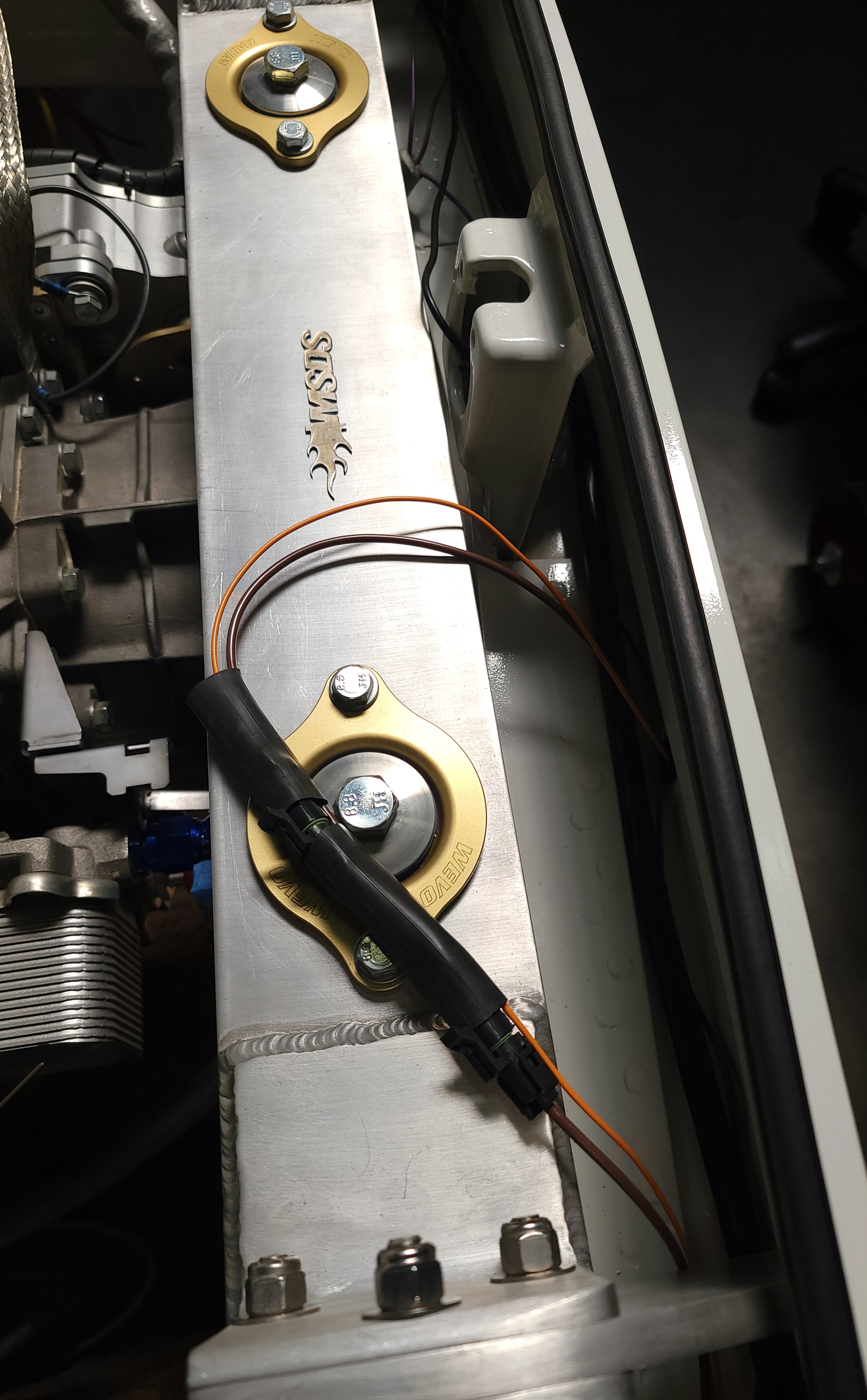

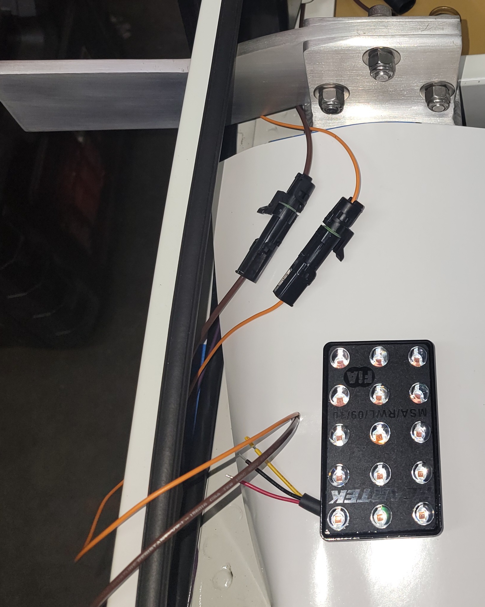

I never walk by this proj in the shop and Don't tinker with this or that. This connection is for the Cartek l-e-d rain-light...also wired with a couple of quick-disconnects.

Cartek brand L-E-D rain light

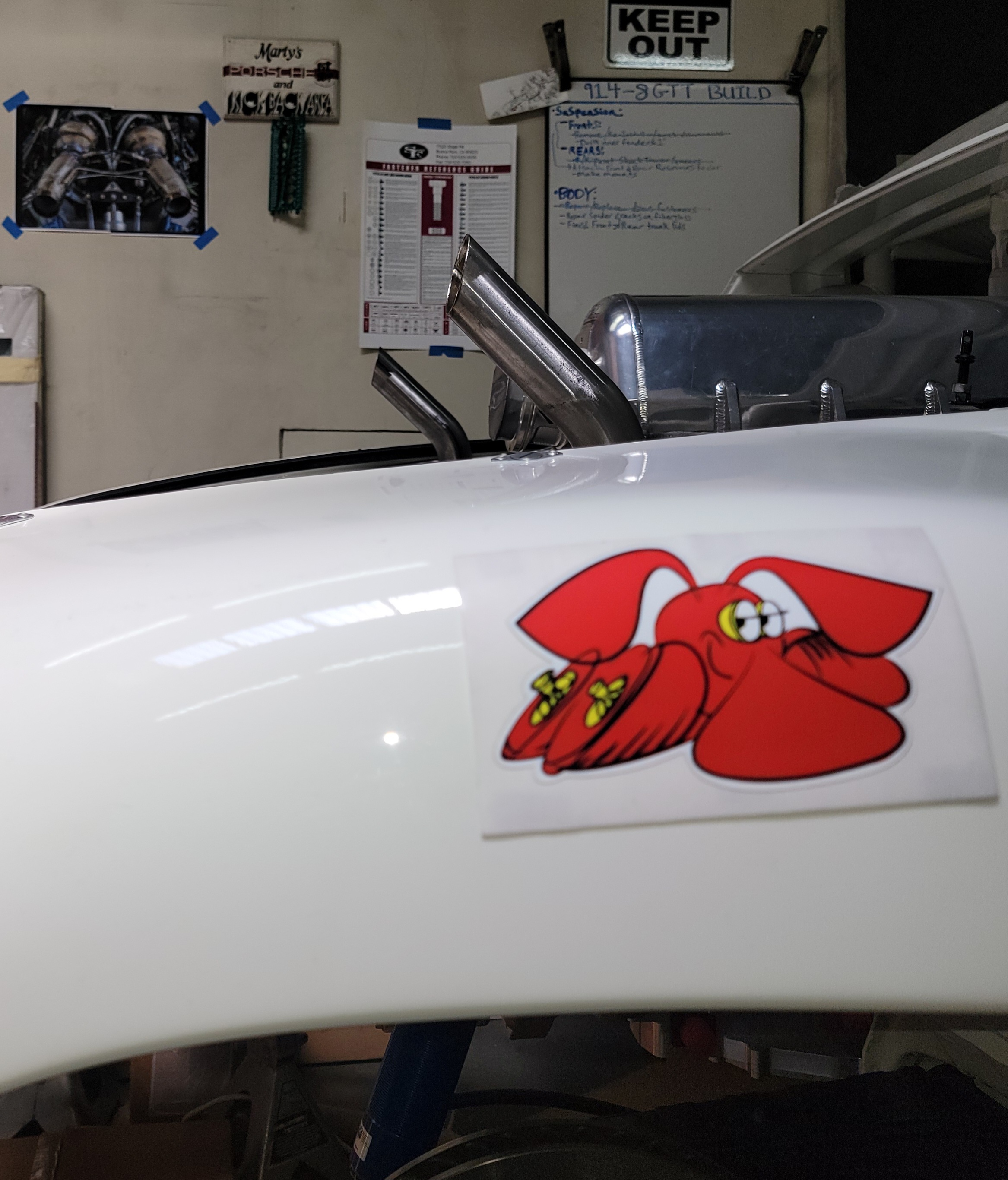

The livery for 8gtt has been voted on by us 3; @MATTYLITE and Mrs. Falcon say "Go with a 21st Century rendition of Sonauto #40".
Me...I'd like to keep sketching, but majority rules (IMG:style_emoticons/default/biggrin.gif)
In any event, we're also collaborating with various Wrap guys for their ideas.

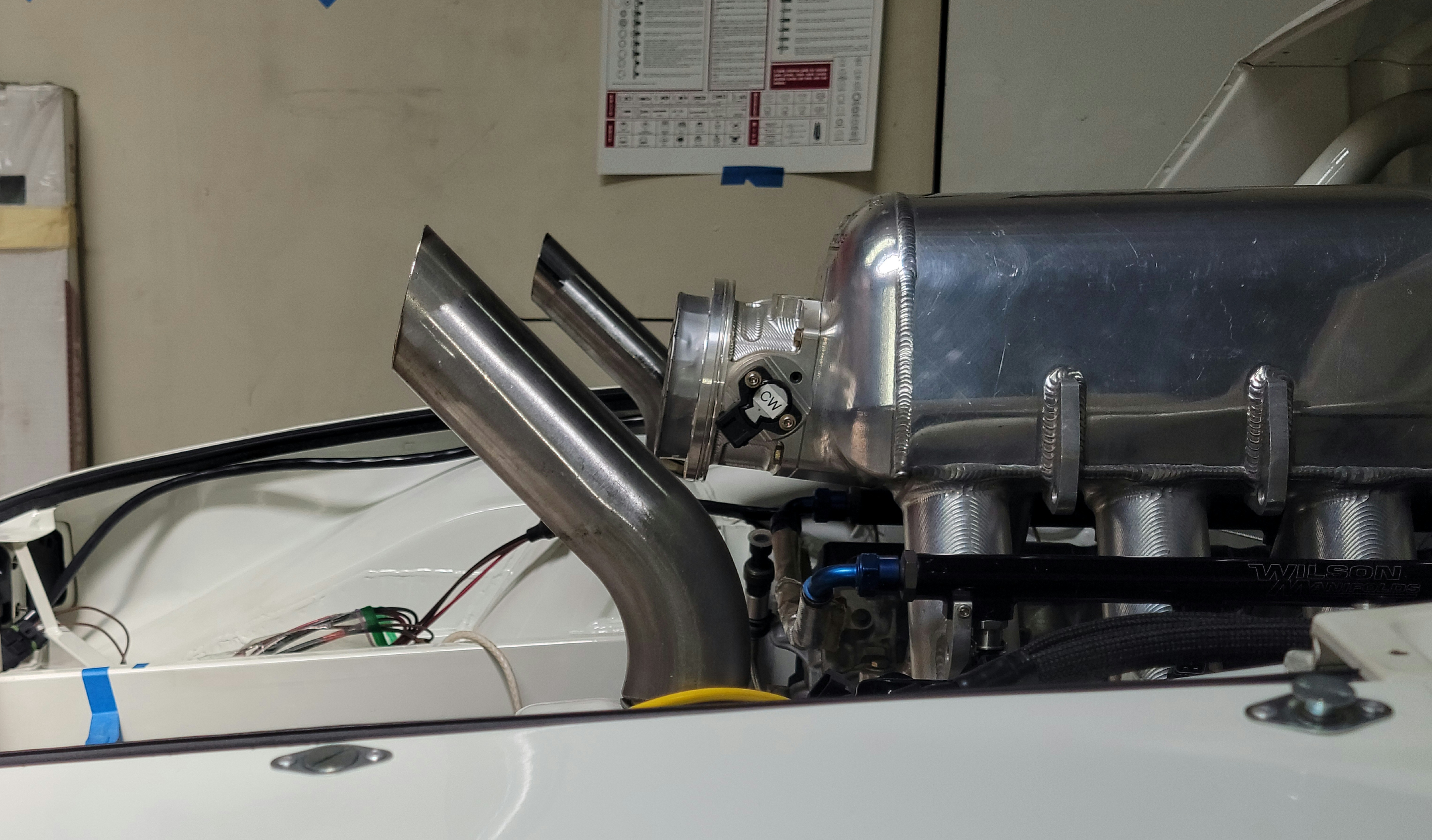

Laying out some real estate in the rear "Trunk" area; which will have a big intercooler , two wastegate exhaust pipes, 2 heat-bonnets (over the Garretts), 4 hood pins...so before I start sawing out the Sheridan trunk lid for all of these contour-cuts, it's good to have a quick look see at the basic layout.
Note: these are not the pipes I'll be using as they're much too tall, just some 2"od slash-cut exhaust tips for another product laying around.
