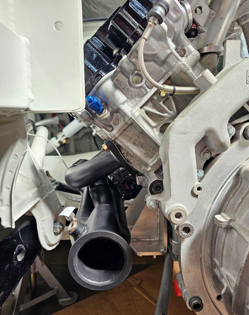

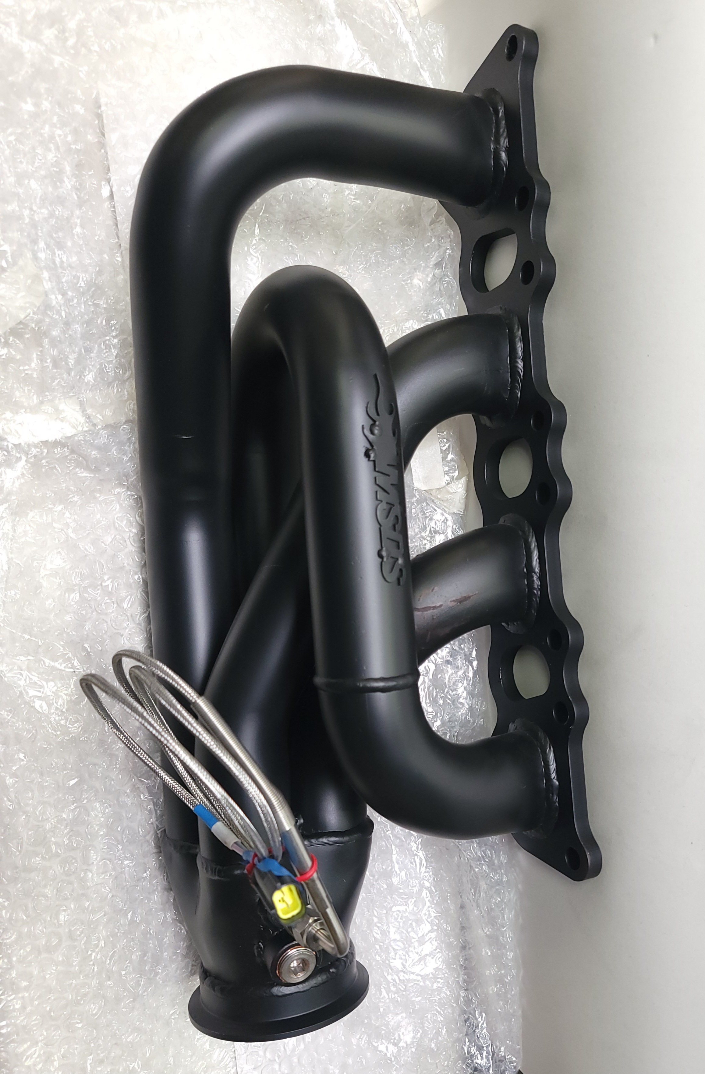

Header finished in high temp Satin Black ceramic coat.
Maltese Falcon
post Oct 14 2023, 10:28 PM
Post #722
Posts: 5,451
Joined: 14-September 04
From: Mulholland SoCal
Member No.: 2,755

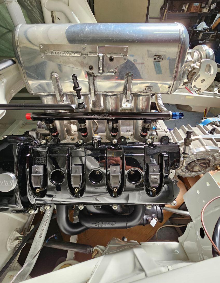

Under shot pic
Maltese Falcon
post Oct 14 2023, 10:32 PM
Post #723
Posts: 5,451
Member No.: 2,755
EGT probe, o2 port/ pre-exhaust turbine sampling location. Secondary o2 ports go on the turbine outlet exhaust pipes.

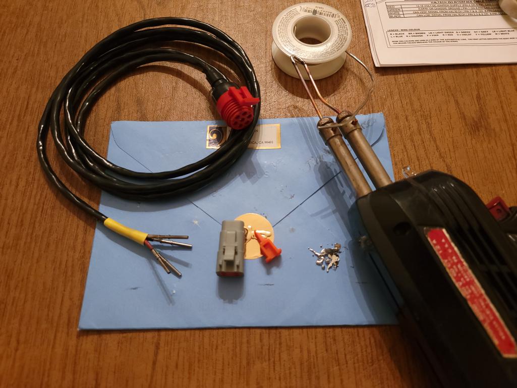

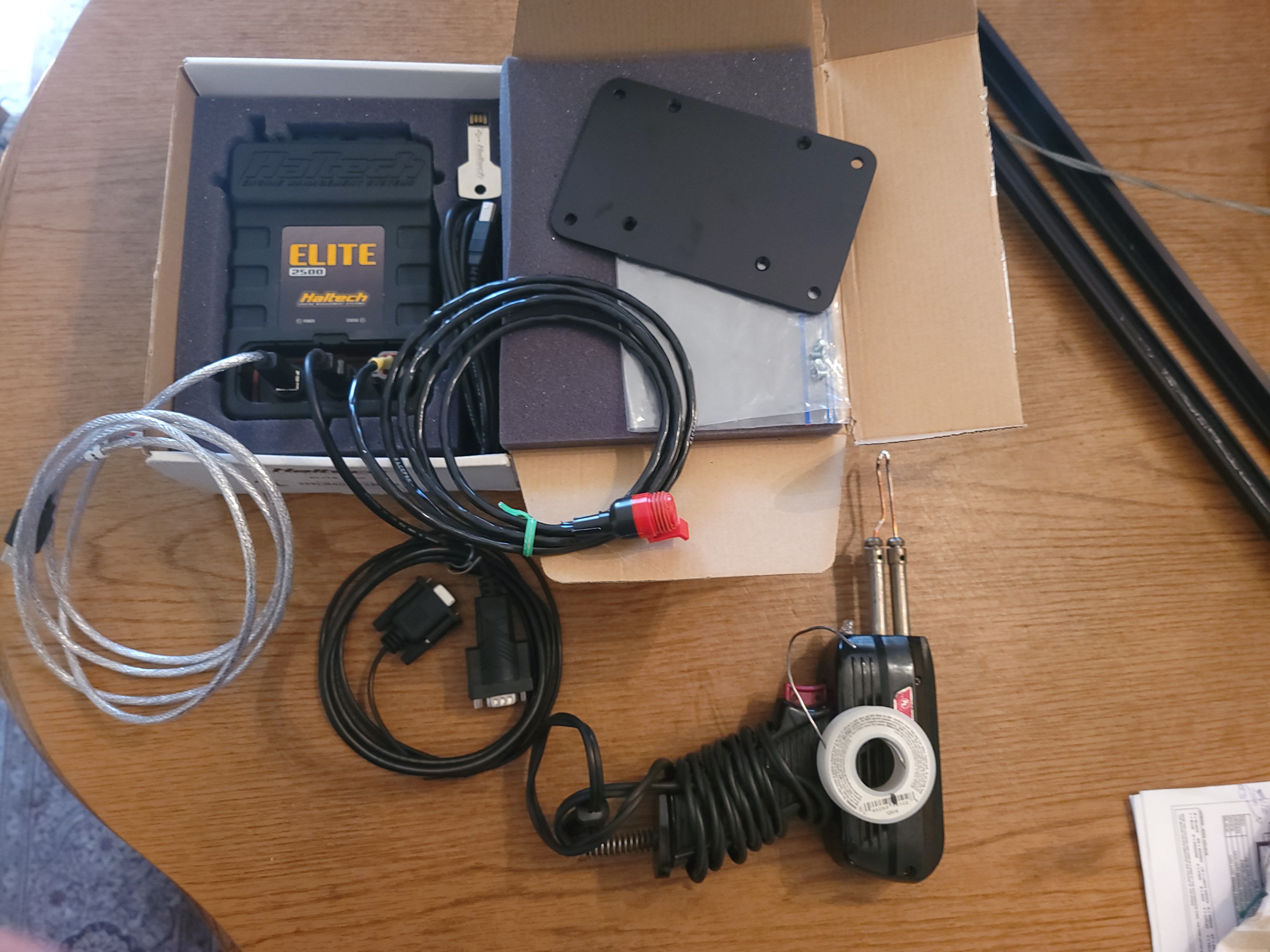

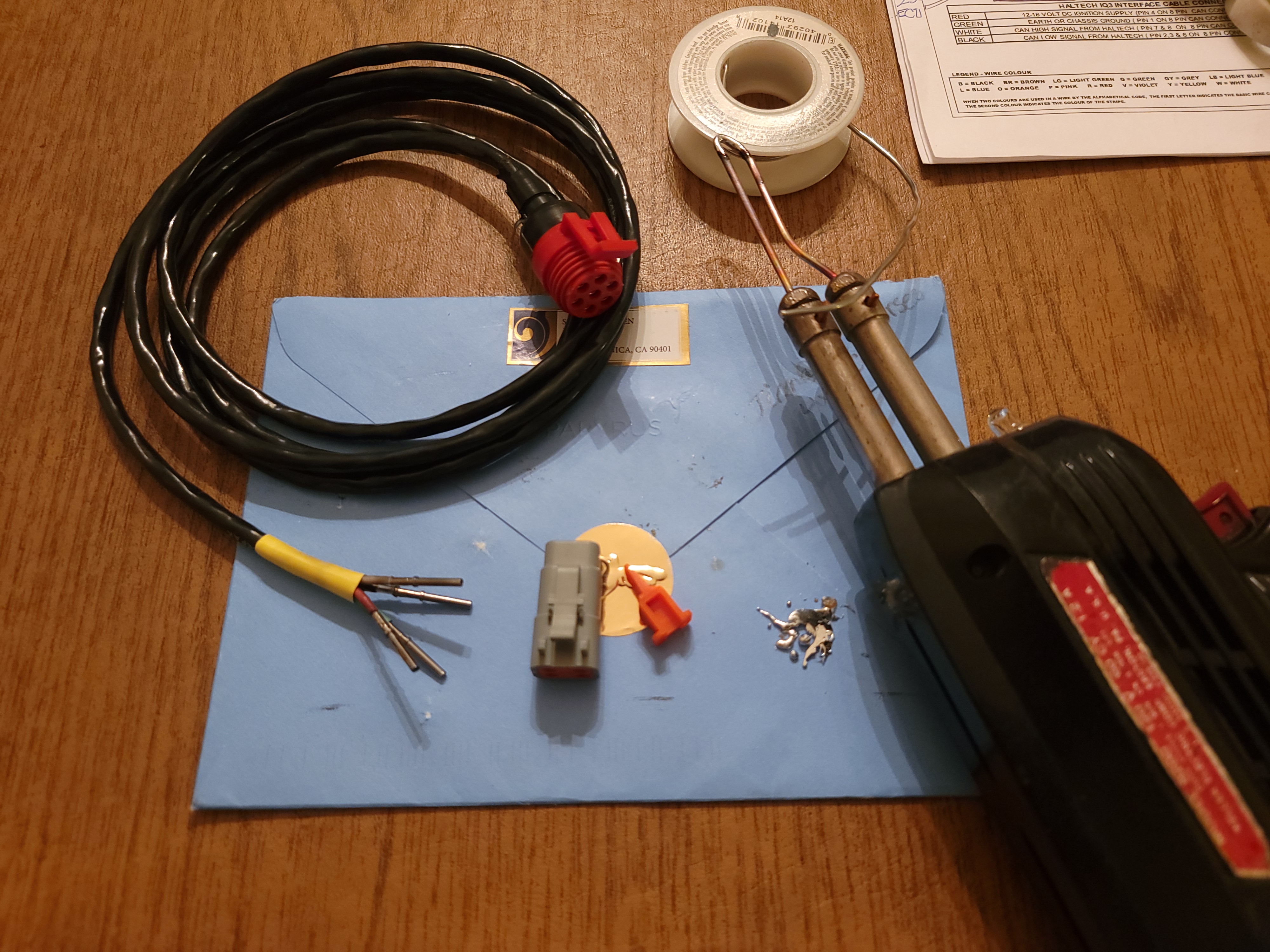

Addressing the Haltech Elite2500 ecu & some of the accessory and C-A-N cables /from and to the IQ3 Racepak dashboard
Maltese Falcon
post Oct 28 2023, 06:33 PM
Post #737
Posts: 5,451
Member No.: 2,755
Complete and ready to plug in and move to the next component

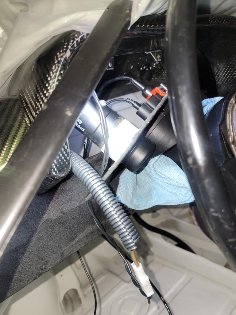

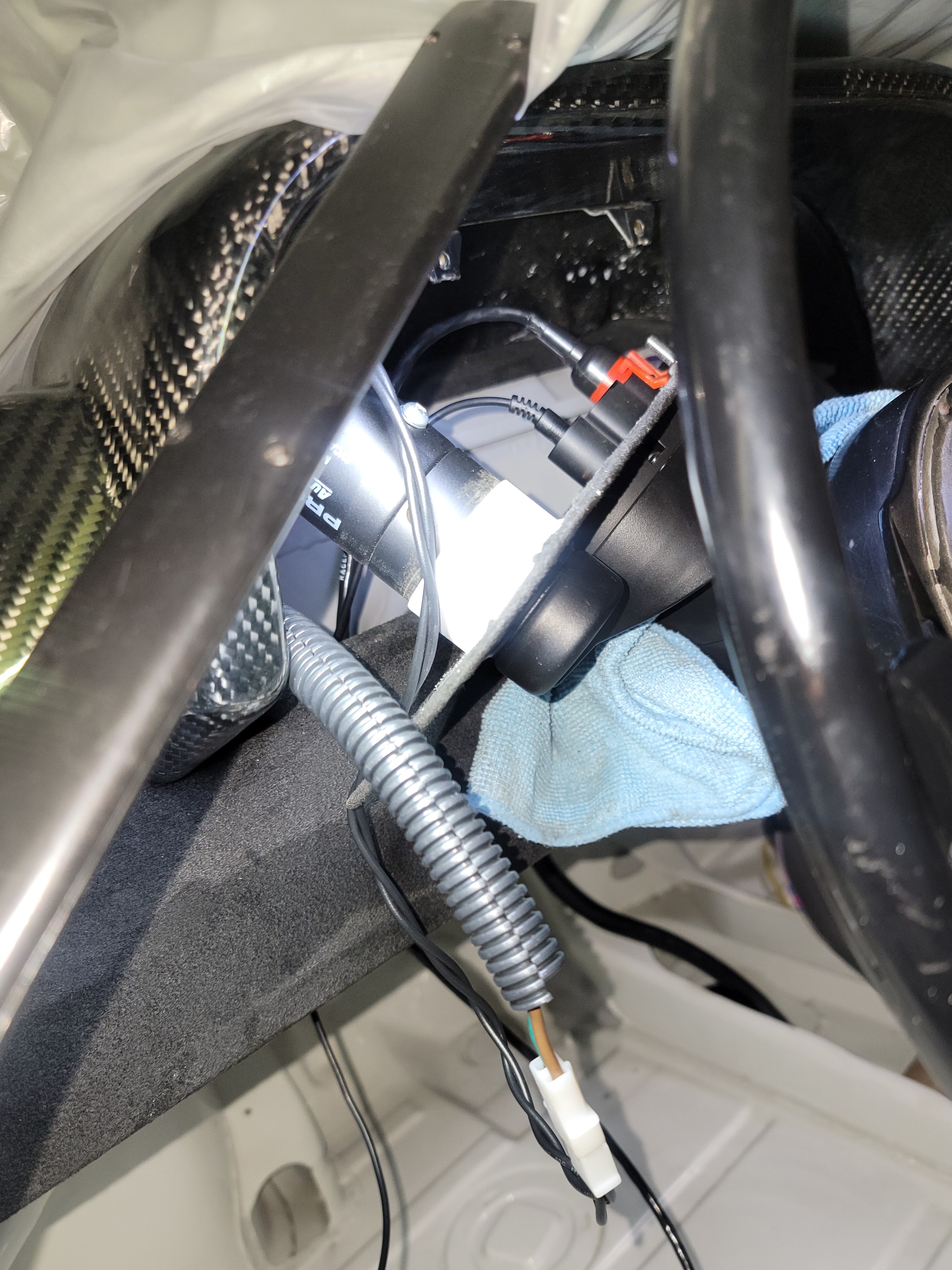

Cables snapped into the IQ3 Racepak dash, with slack wires for easier component maintenance.
Next up GPS antenna routing for heads up speedo display.

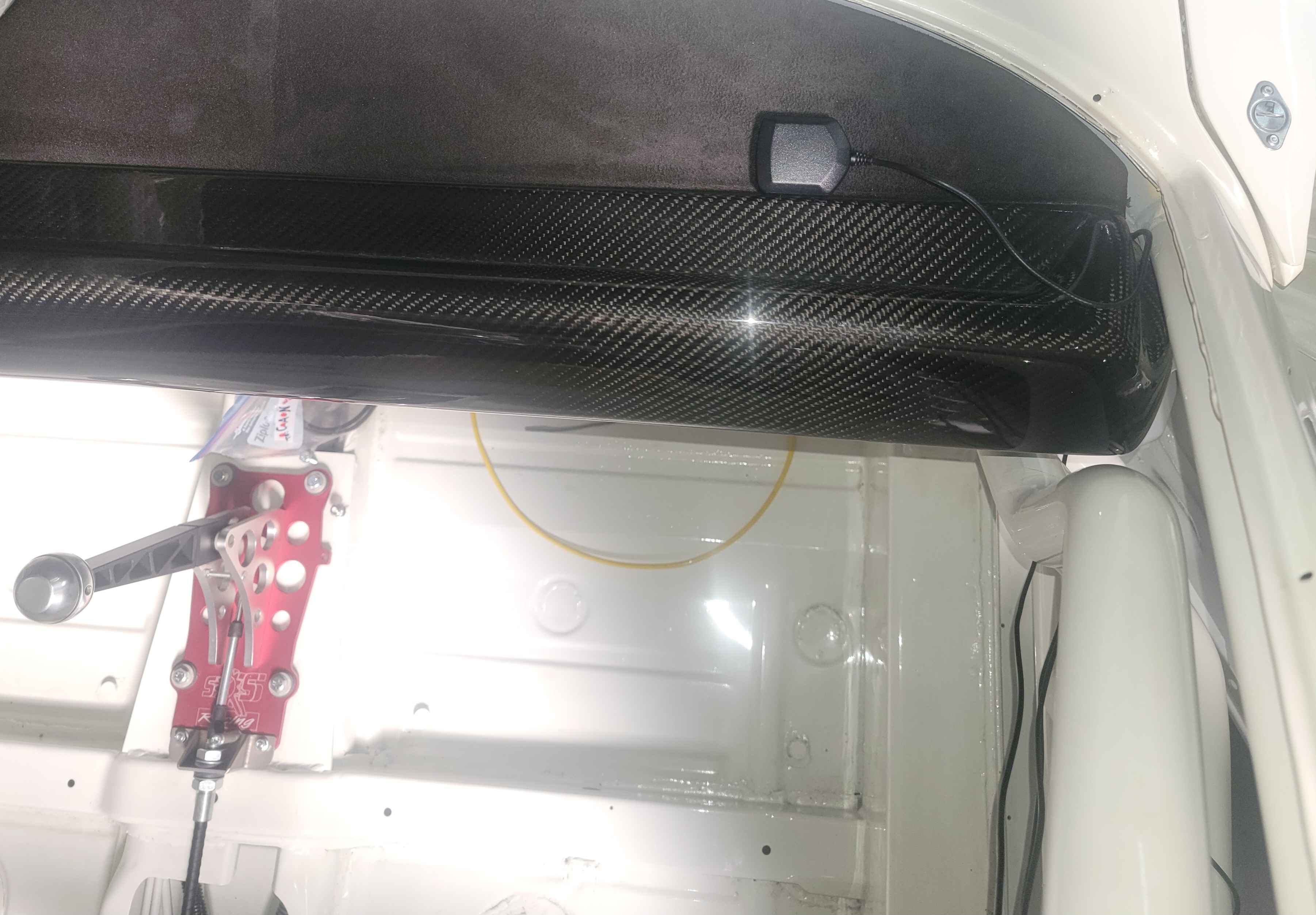

Maltese Falcon
post Nov 4 2023, 09:09 PM
Post #740
Posts: 5,451
Member No.: 2,755
Not a final placement of the GPS /speedometer antenna, but it will be on the dash, facing upwards towards windshield.
