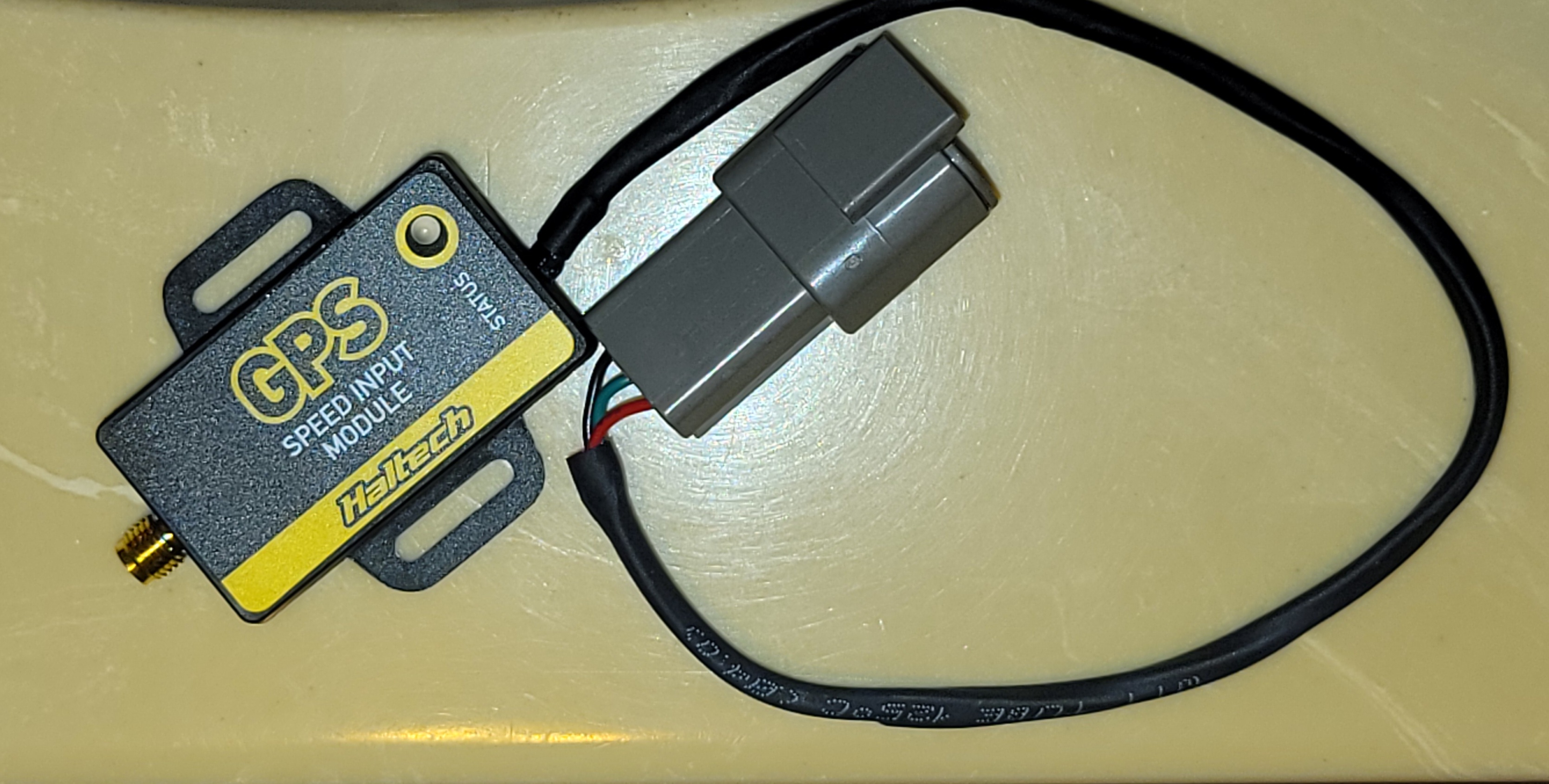

and another small component which works with the antenna signals, then interfaces into the ecu. MPH (or KPH) Speeds are determined by how fast the 914 travels between 2 satellites (IMG:style_emoticons/default/smile.gif)

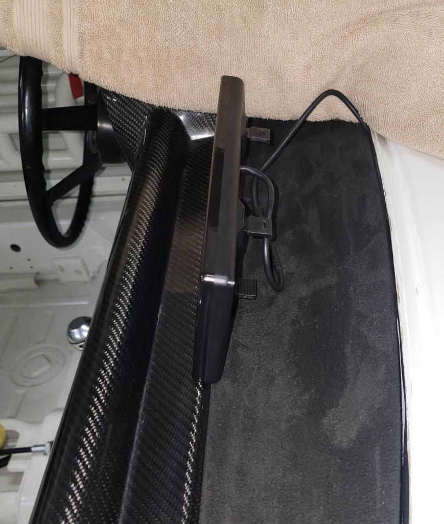

Member No.: 2,755

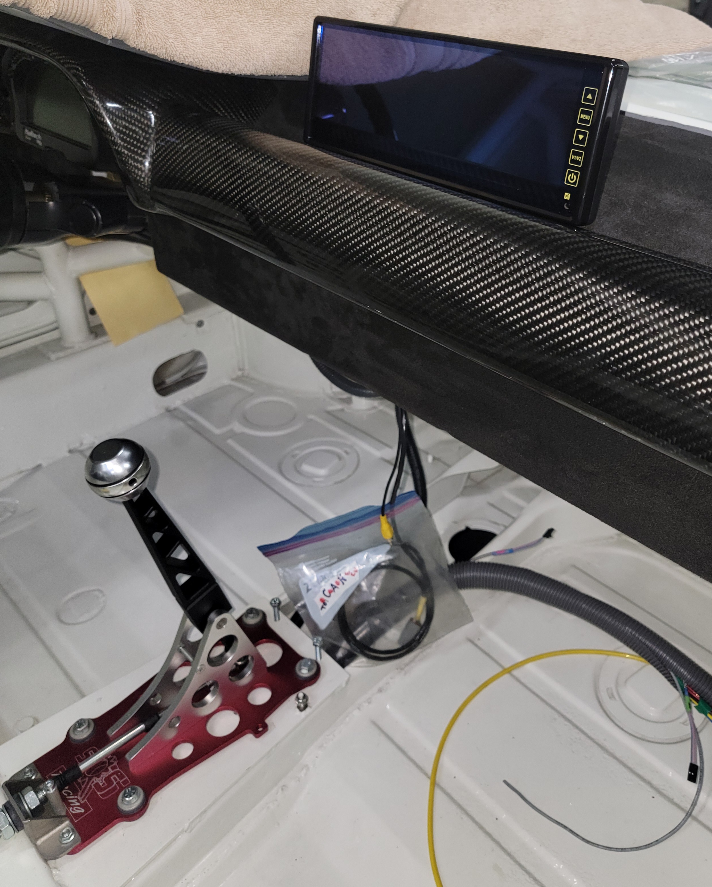

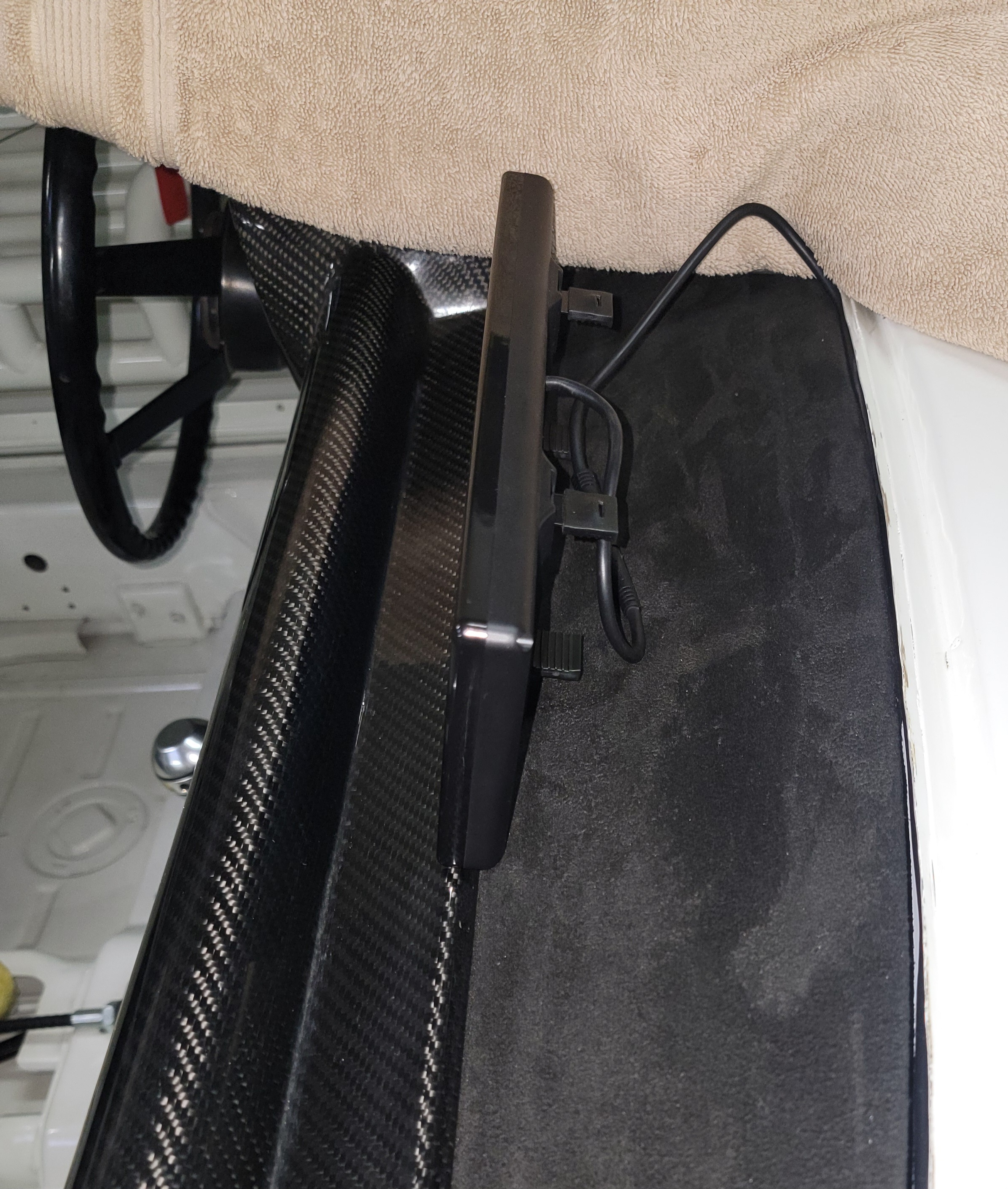

What's behind us is Important so: rear facing camera feed. Just looking at placement options

Member No.: 2,755

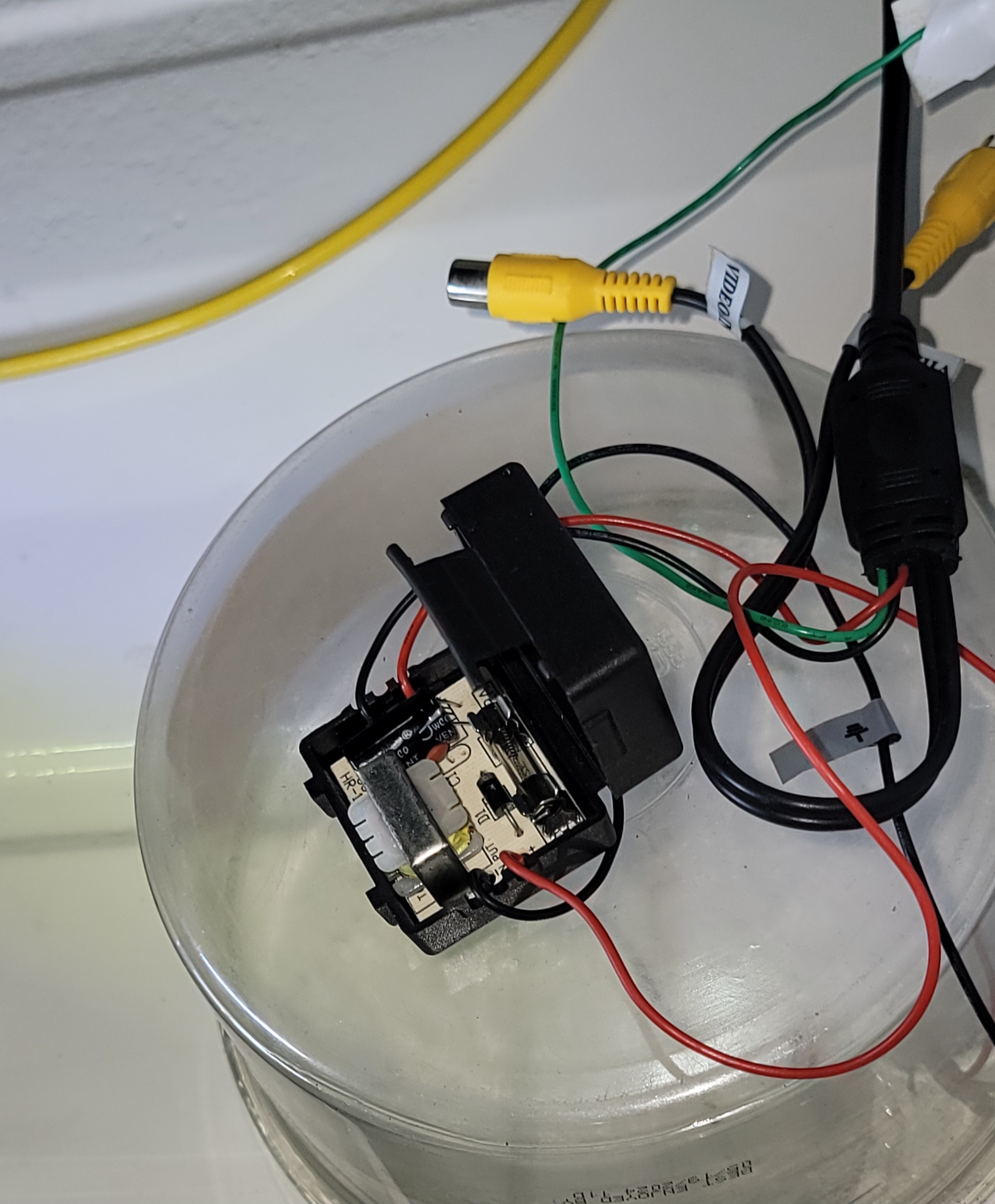

A few improvements to the camera circuit, easier now to mount + access the small enclosed fuse.

Member No.: 2,755

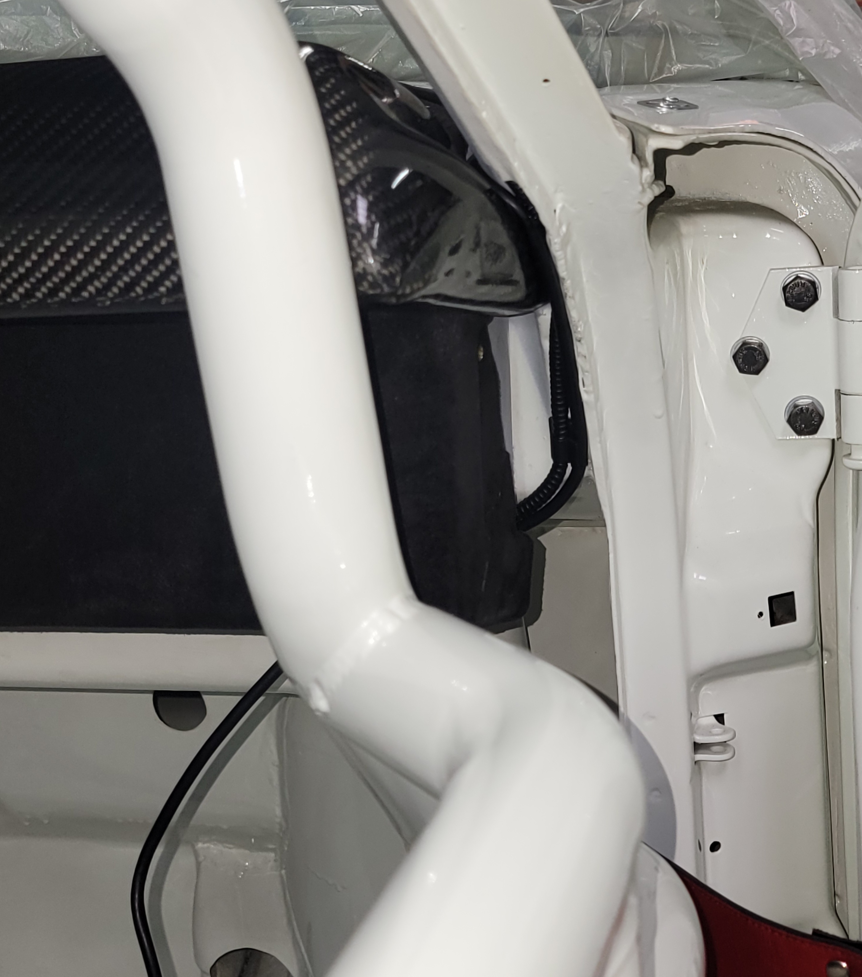

Routing the camera coax line through small passages...less drilling is always good ! Black cable sits in a small groove inbetween the cowl + dash top.

Member No.: 2,755
Routing the ¼" camera wire cable in the dashboard gap

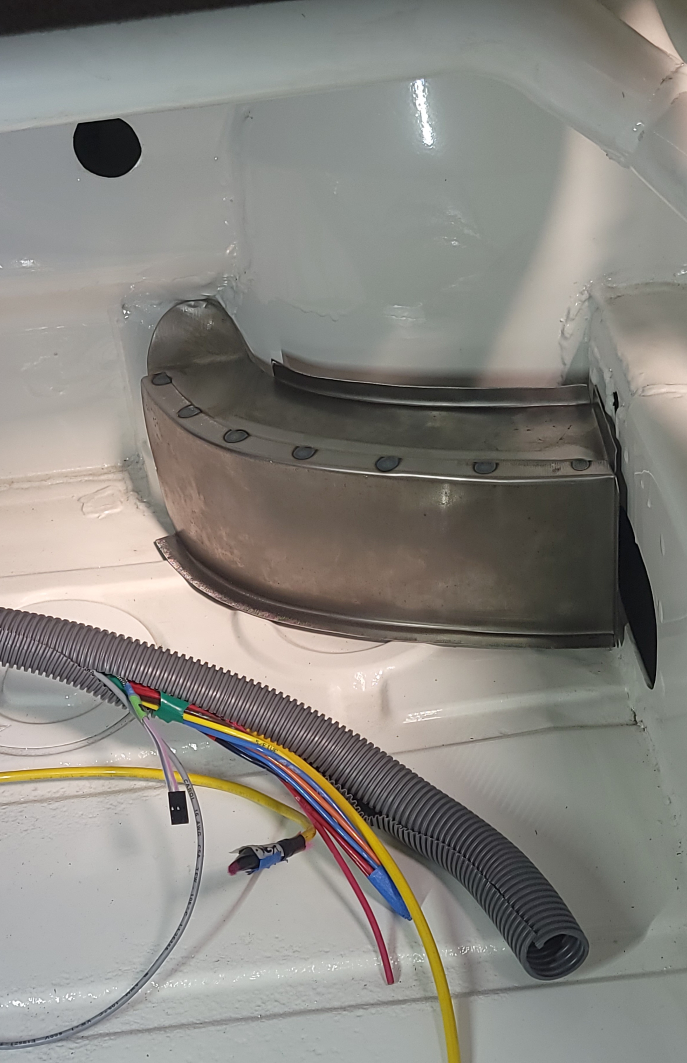

This is the custom right side coolant line cover-plate that Ben @mb911 mfg for us. It's perfect for our use, and since I've elongated the oe opening.. only a small 2×3" piece of sheet is needed to seal it up.
Thank you Ben for the pair of cover-plates (IMG:style_emoticons/default/biggrin.gif)

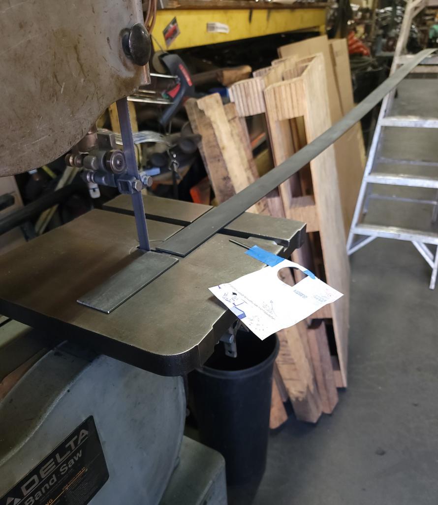

Member No.: 2,755

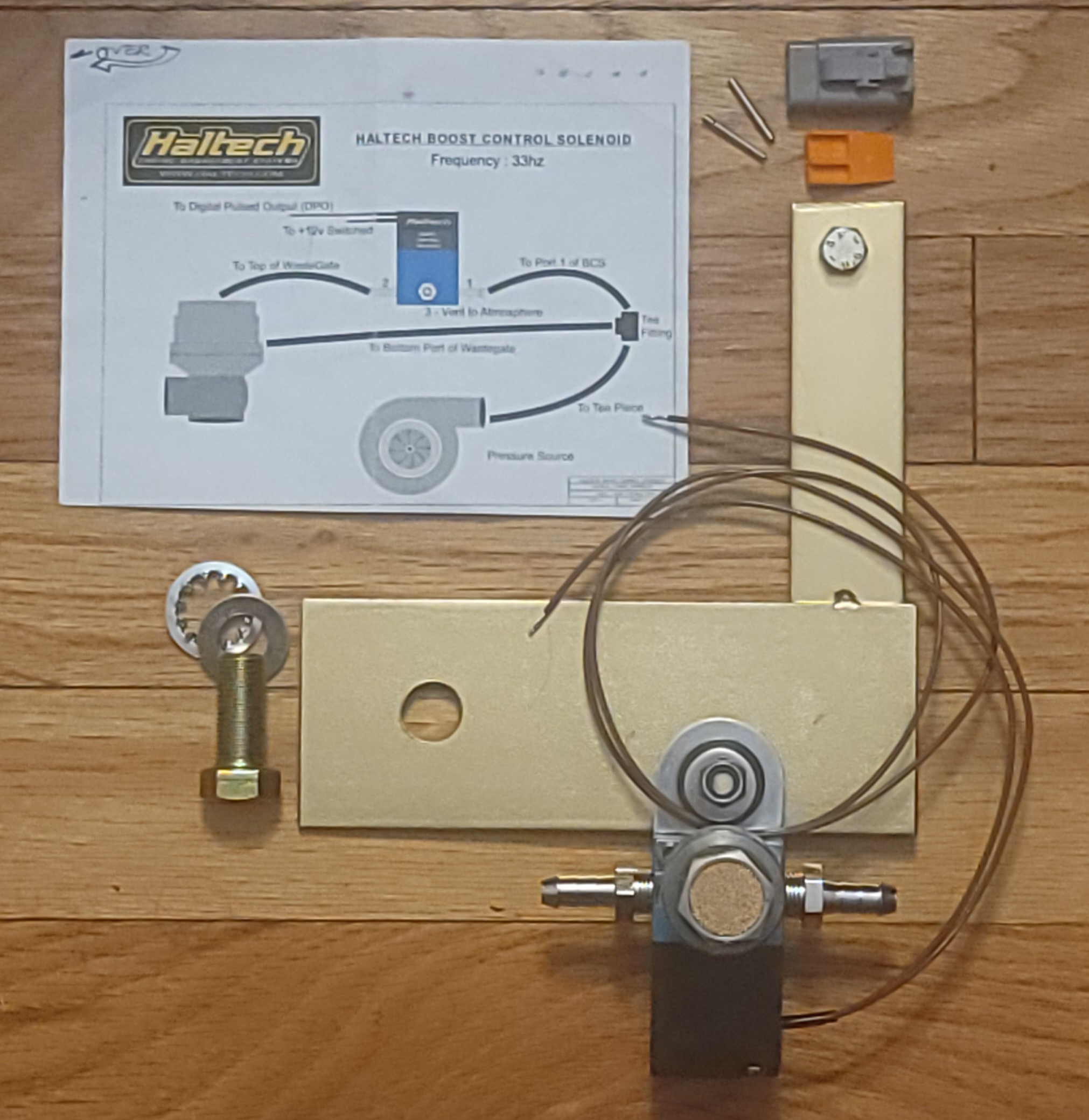

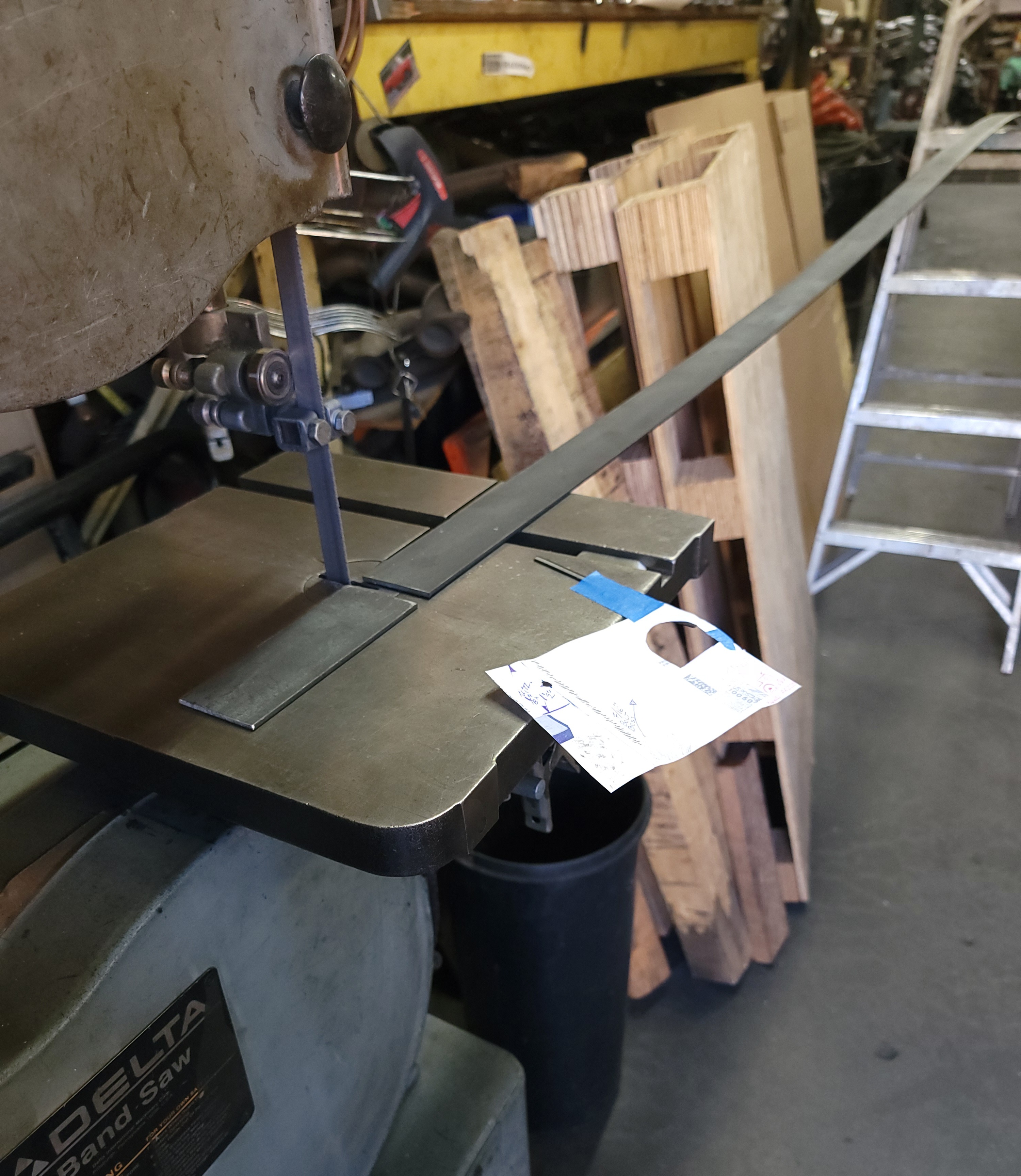

Let's make a boost-solenoid bracket

Member No.: 2,755

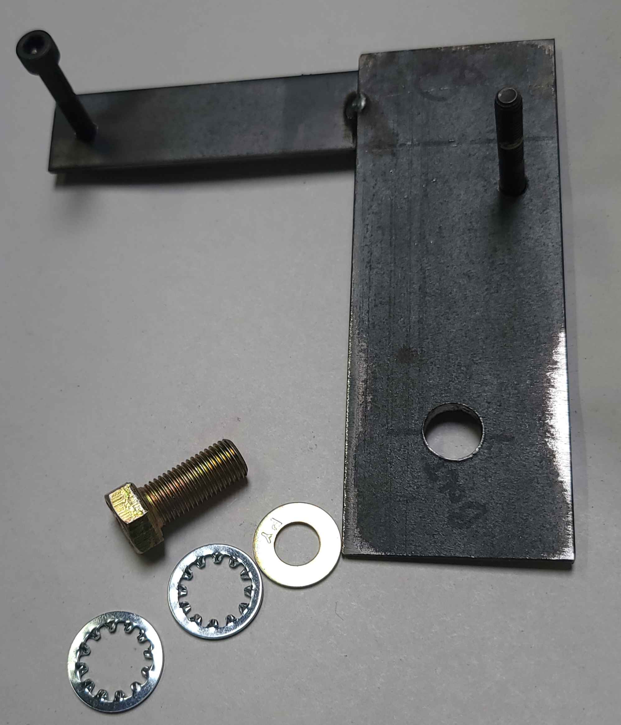

Basic layout.

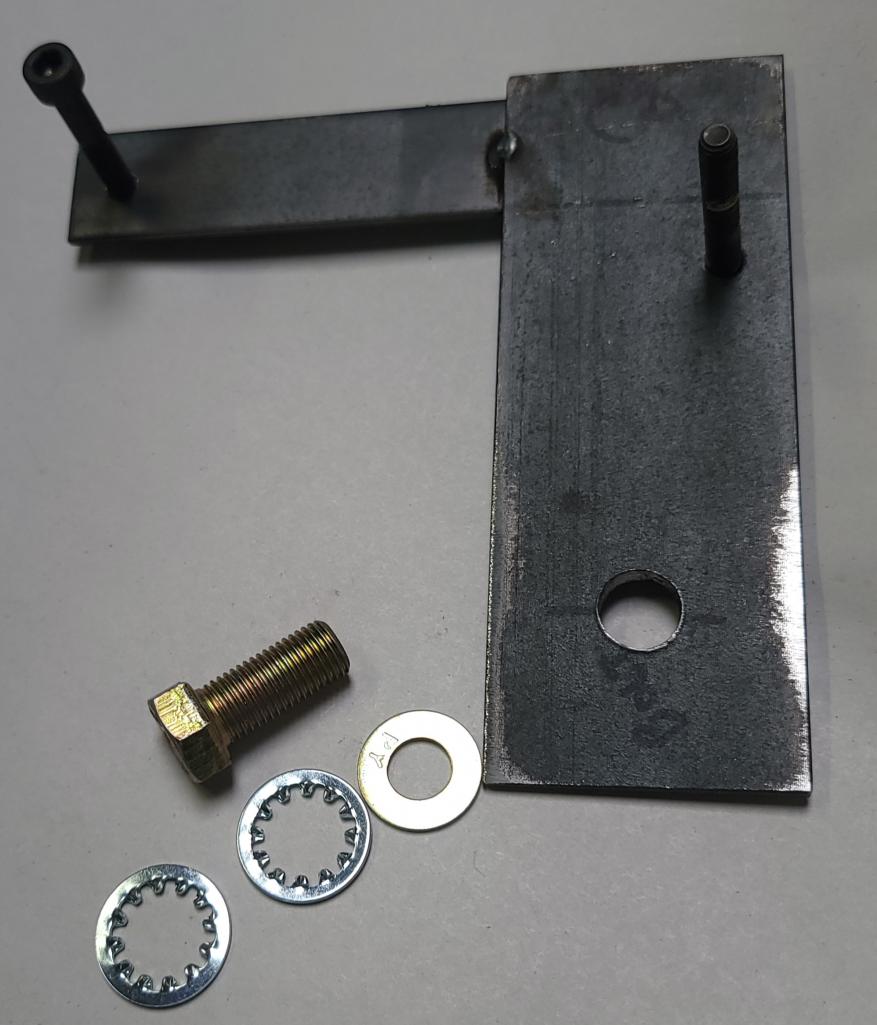

Member No.: 2,755

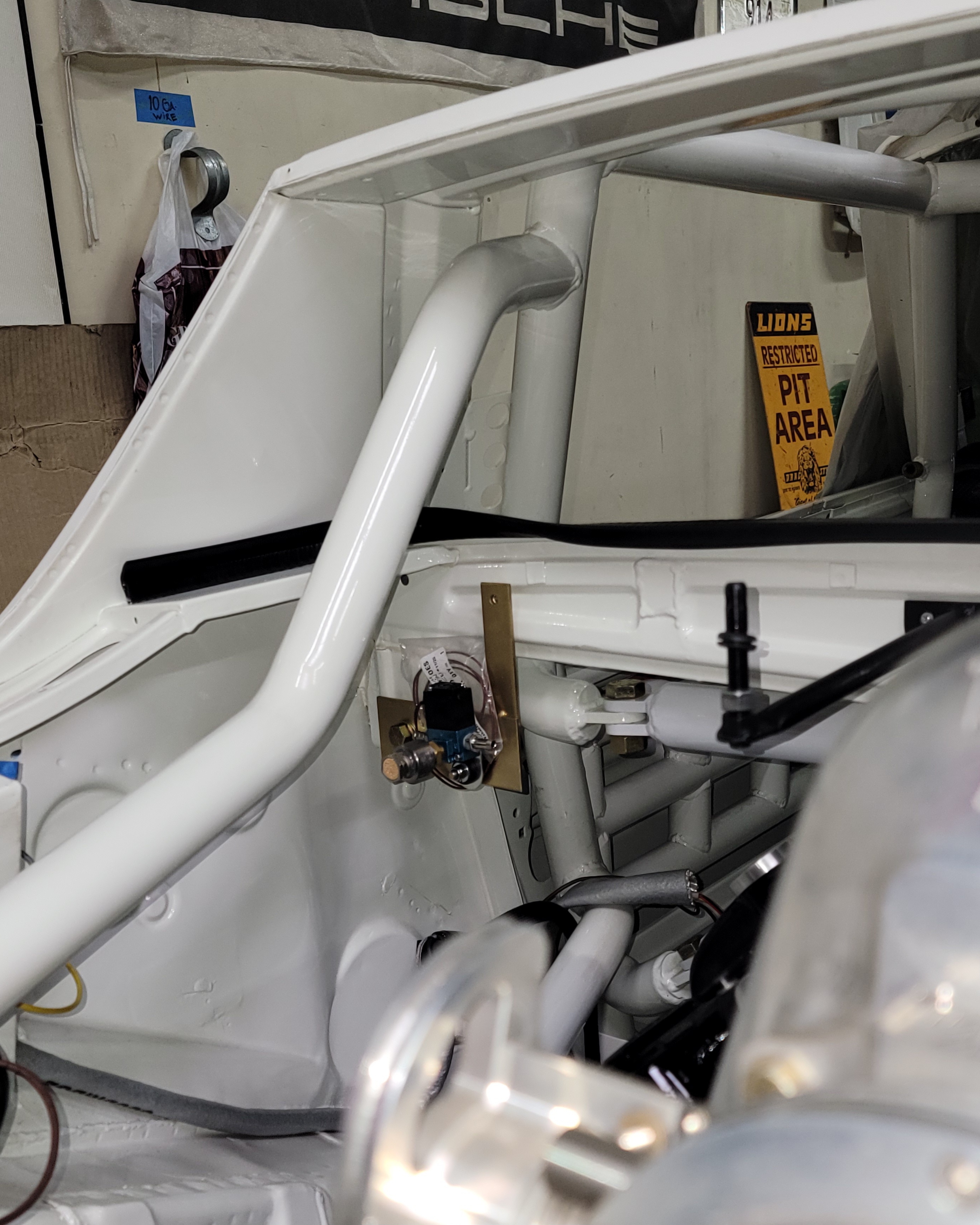

Ready for engine bay mounting, then finish hooking into the ecu wire harness.
The upper 6mm bolt at the top of bracket will be a fastening point for 1 of the fire suppression nozzles.

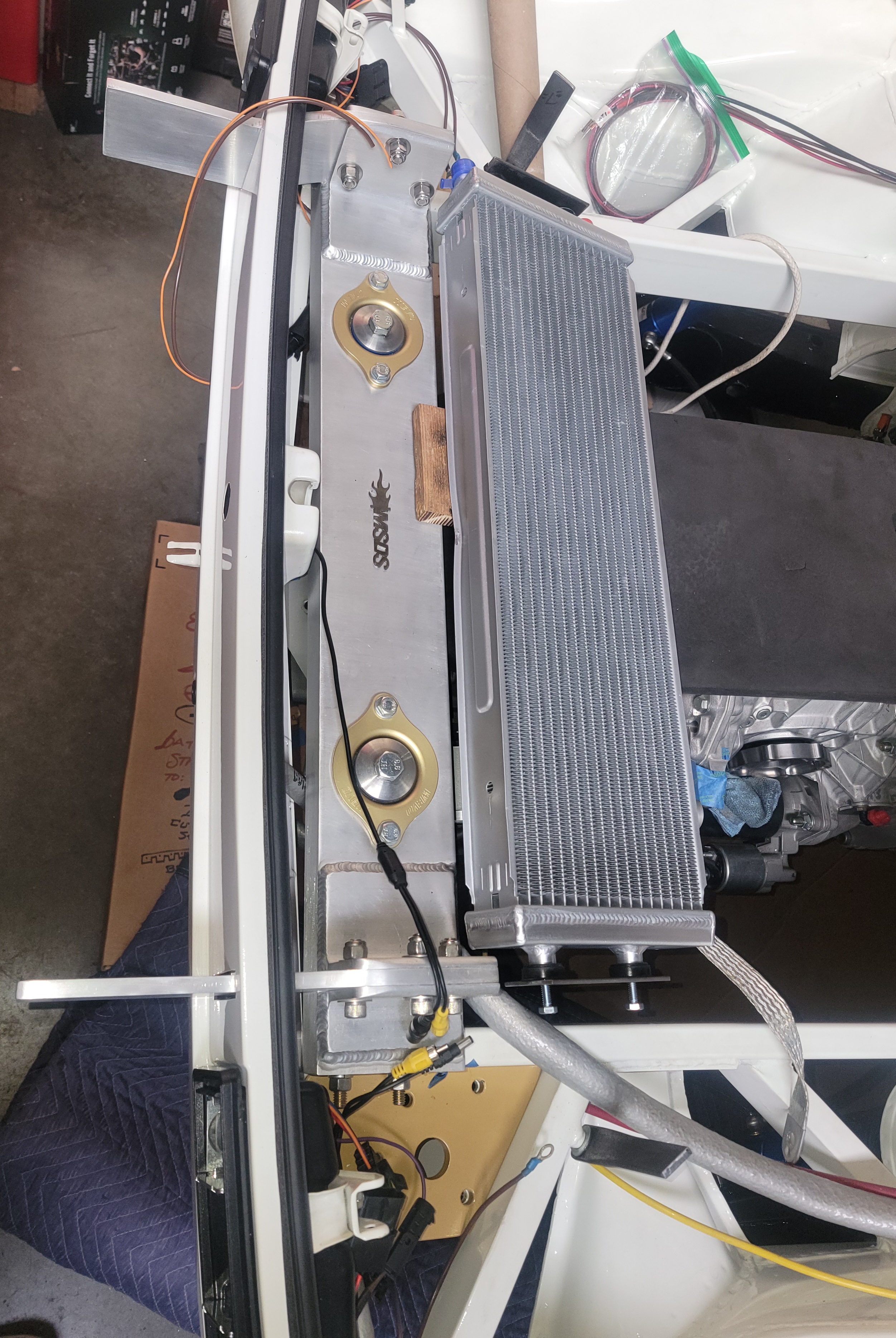

Member No.: 2,755

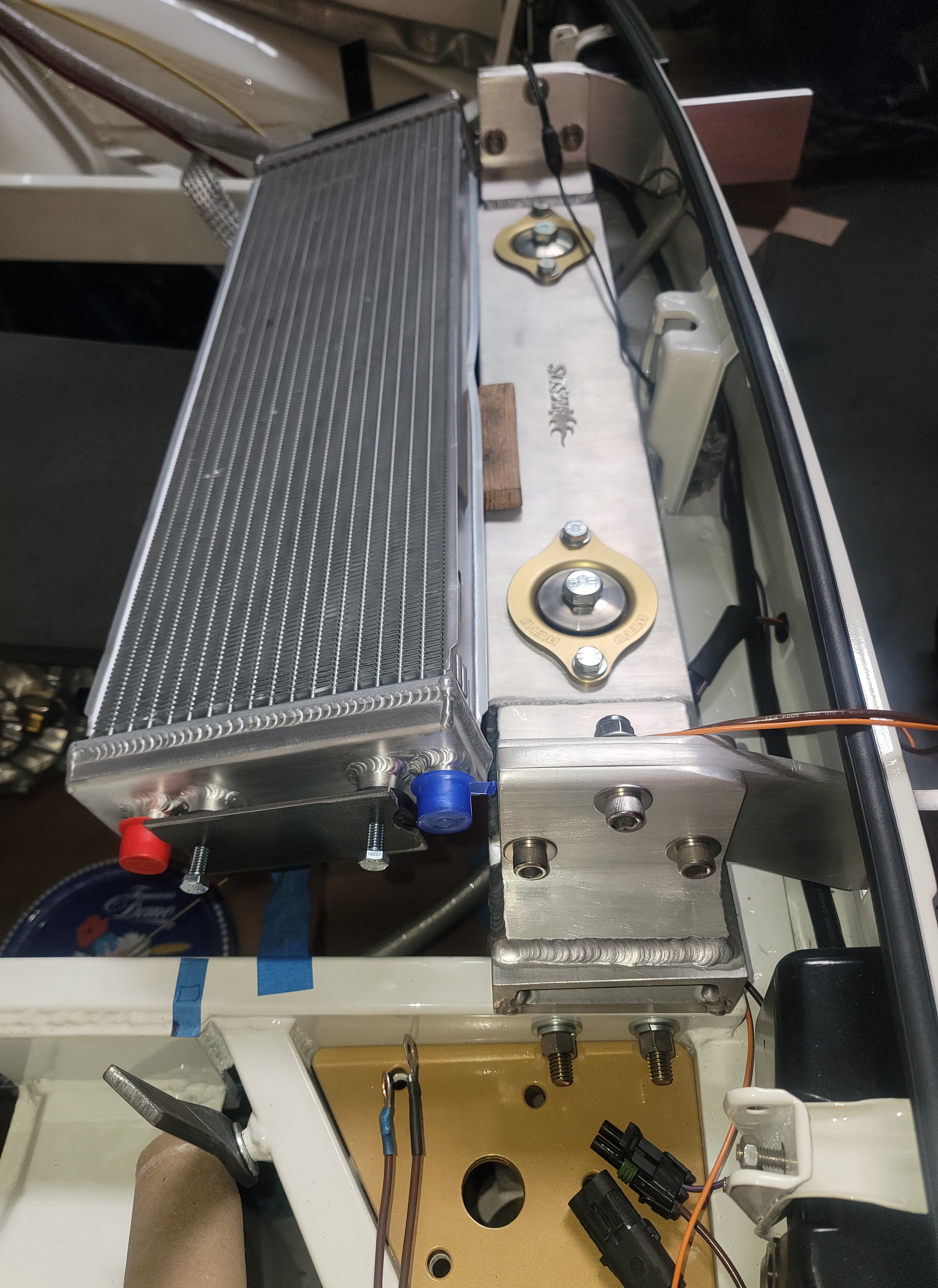

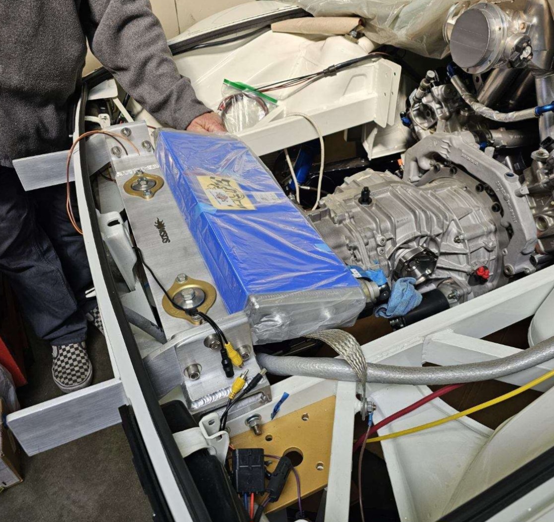

CSF radiator (trans cooler) just in, and working out the rear placement mounting alternatives

Member No.: 2,755
More brackets this week, I'll tack these in place with the .035 Miller mig then finish up in the welding dept.

Member No.: 2,755

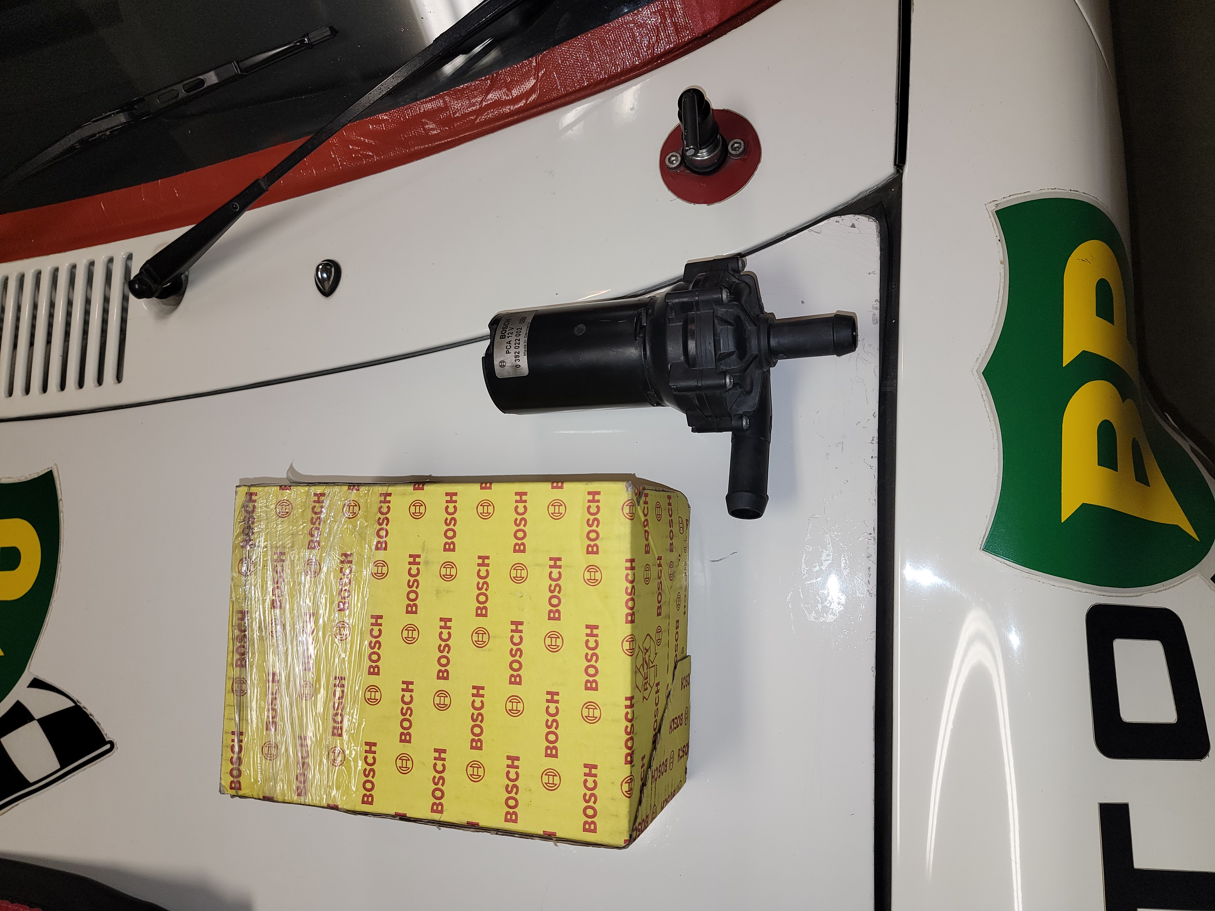

This is the Bosch 12v coolant pump which will be utilized for the trans cooler radiator. Its main use is for the heater system in Mercedes; but also used by Magnacharger (kits) in their supercharger intercooling just under the blower /integrated in the intake manifold. These are built stout and I've only changed 1 pump in 200k miles of use in my supercharged '05 F150 (IMG:style_emoticons/default/smile.gif)

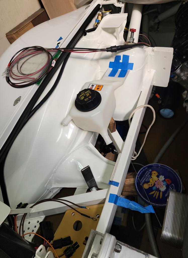

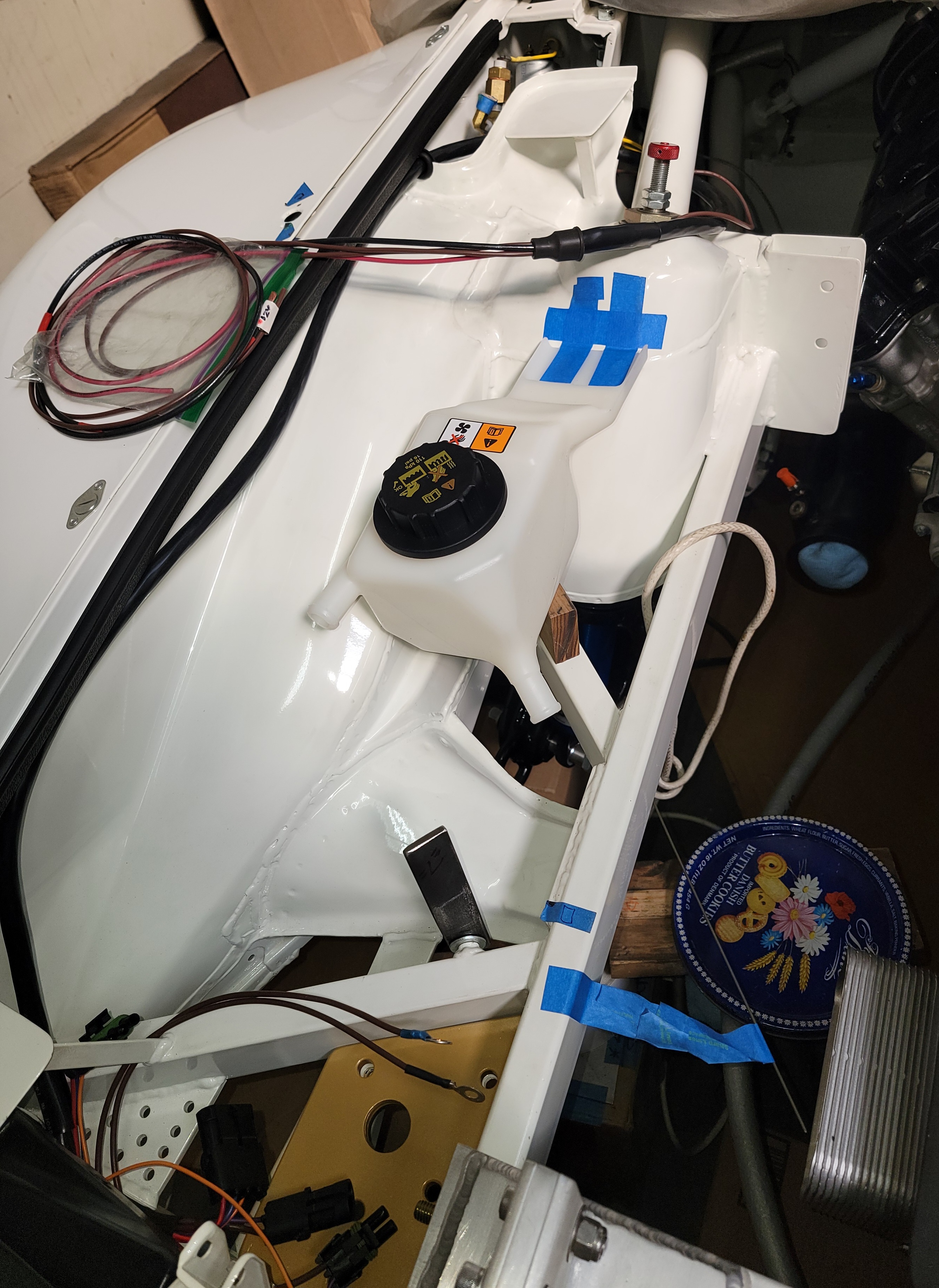

Member No.: 2,755
Trans cooler resevoir; basic location and bracket designing. The small expansion tank is sourced from the Ford parts bin; 2004 4.6 supercharged Mustang.

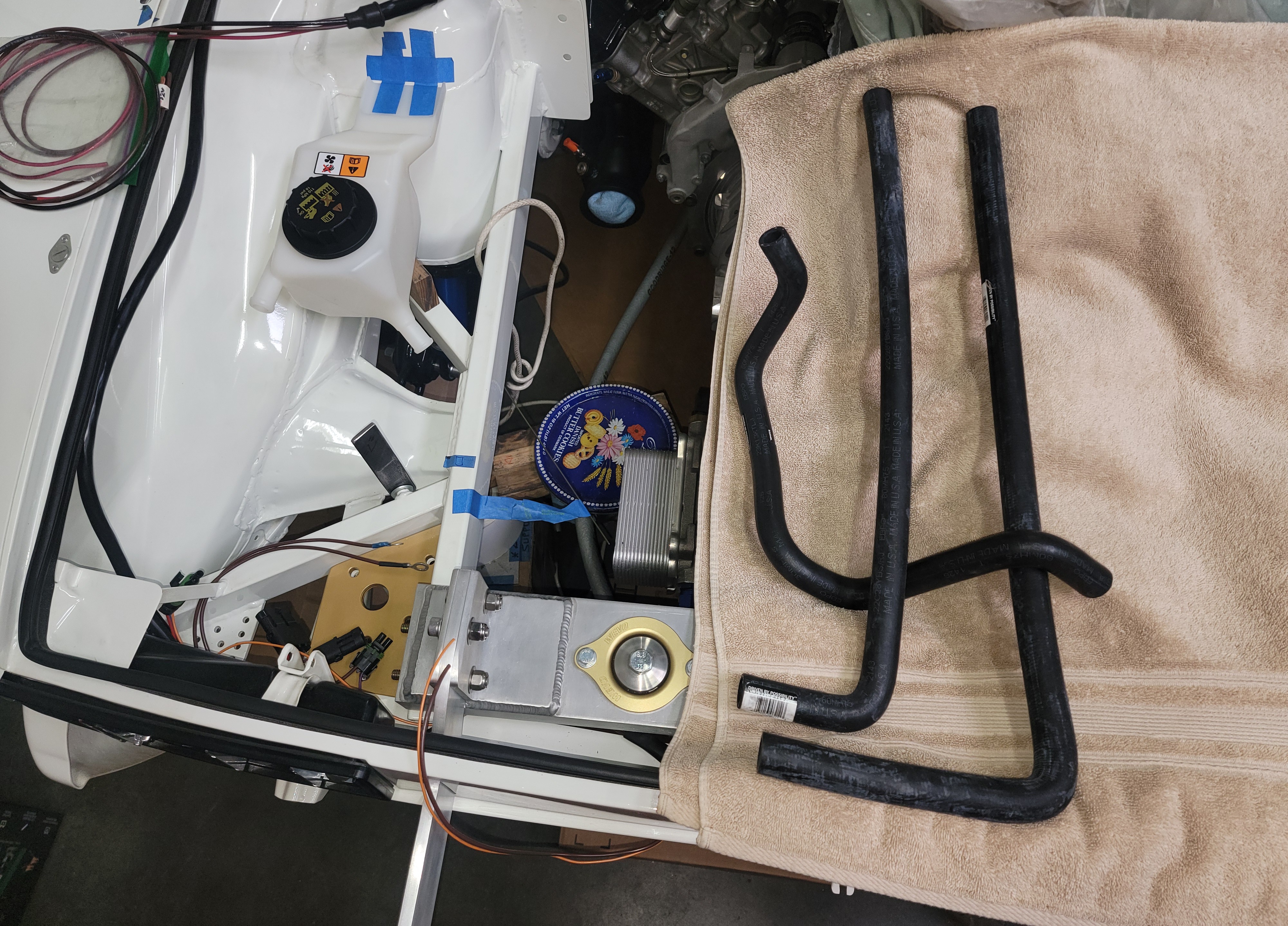

Member No.: 2,755
Parts warehouse supplied all sorts of pre-shaped ¾" coolant line for me to trim down to spec !
