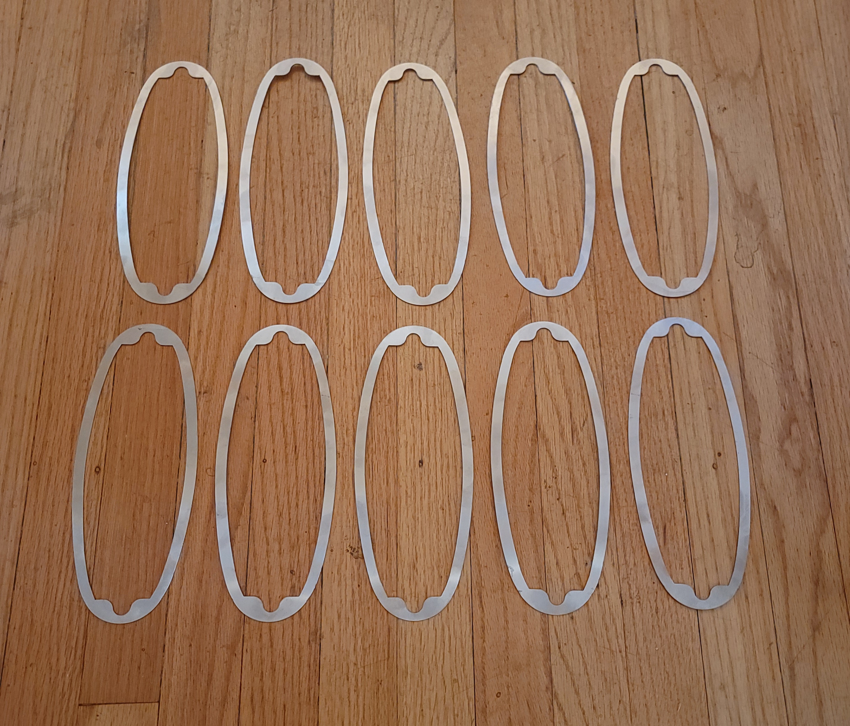

I'm having a few sets of these 18ga. SS plates laser cut for use with these cool 914 headlights, which install into the previous front turn signal locations.
Since we are using Sheridan fiberglass body panels, when you slice the (faux) turn signal 'Pods from the top of the fenders you are left with a ¹/16" perimeter edge...which is not real sturdy to attach these light fixtures on.
The thin plates will be epoxied into place, then these new light assemblies* will have a sturdy foundation to sit on. Then I will add another support bracket inside the fender, in order to catch the stud/nut on the assembly.

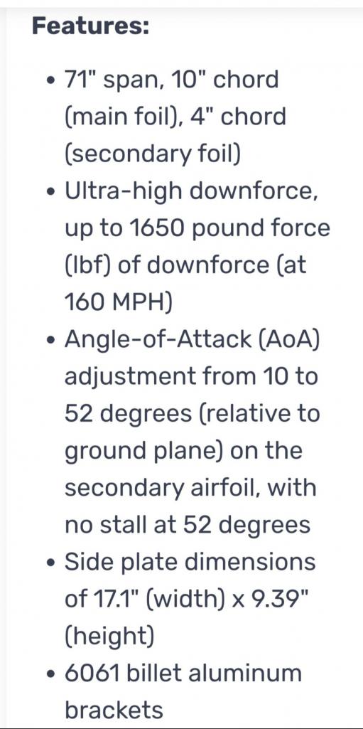

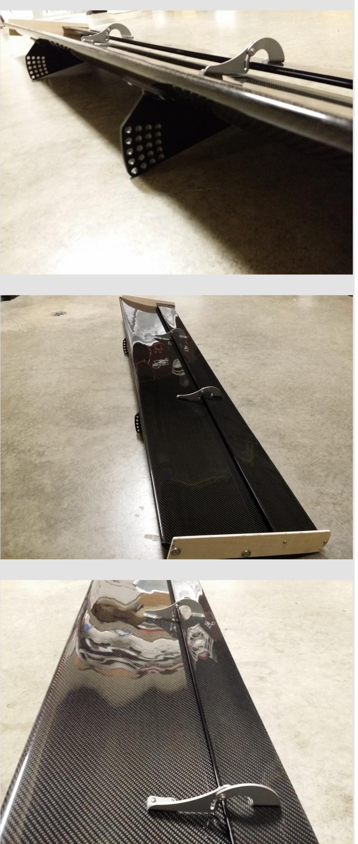

@technicalninja >> this is the APR Performance rear c/f wing that we chose for the job. Our own water-jet formed t6 .375" aluminum supports will capture the 1600 psi downforce (rated at 160mph) and send it downwards directly through the transaxle mounting frame. Front canards, and a totally sealed undercar tray with diffuser out back. The wing alone will never reach 7k psi of downforce, and I may never experience w/o/t in 6th gear on a long track; might let Patrick Long enjoy some seat time (IMG:style_emoticons/default/biggrin.gif)
Maltese Falcon
post Jun 26 2024, 11:48 PM
Post #847
Posts: 5,451
Joined: 14-September 04
From: Mulholland SoCal
Member No.: 2,755

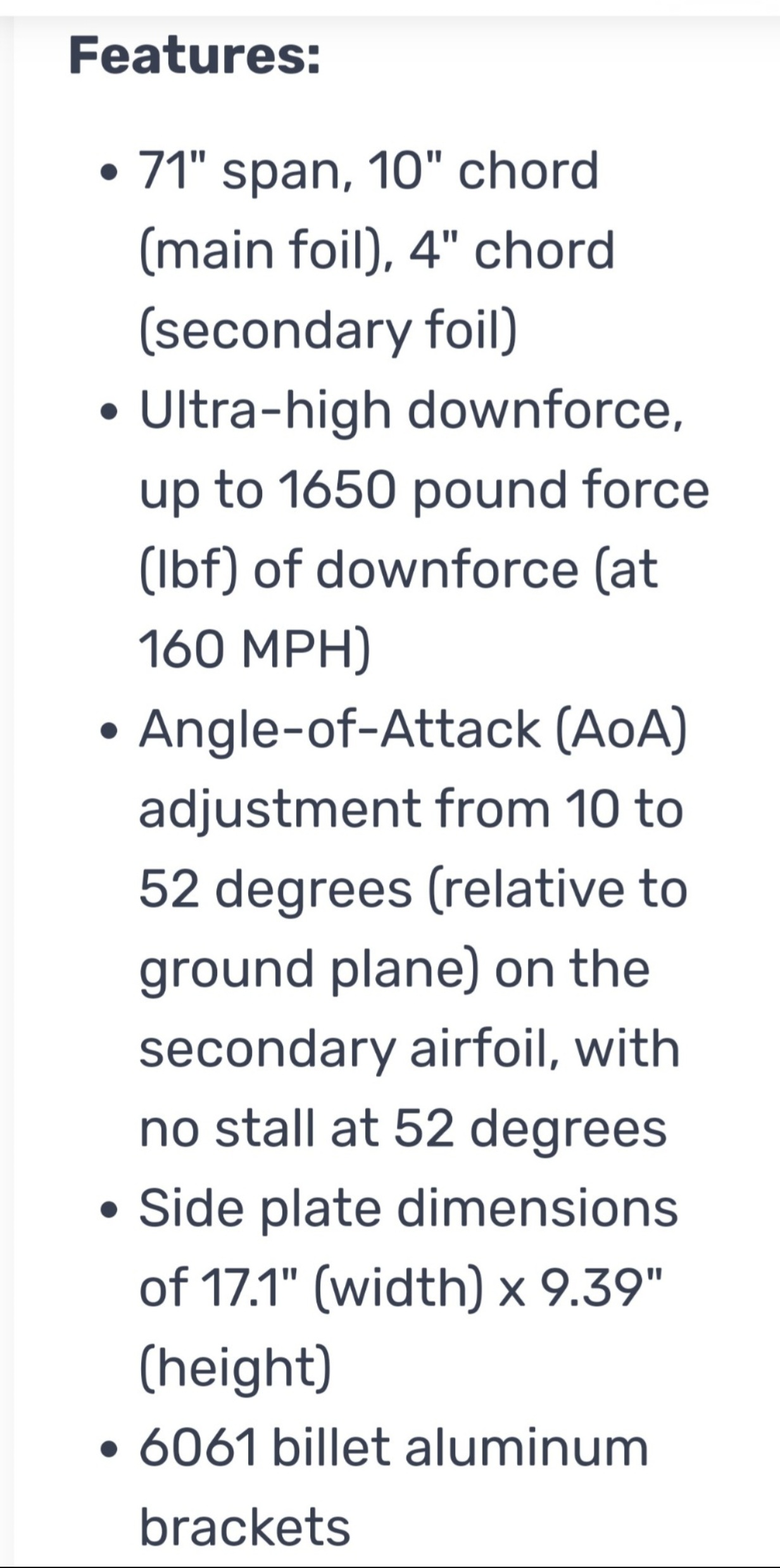

Some APR specs...
Maltese Falcon
post Jun 26 2024, 11:50 PM
Post #848
Posts: 5,451
Member No.: 2,755
Few more pics

"No stall at 52 degrees" is HARD to believe!
BAD ASSED if it can do that...
I was joking, playing with you!
I DON"T believe you will EVER be able to apply WOT at ANY speed.

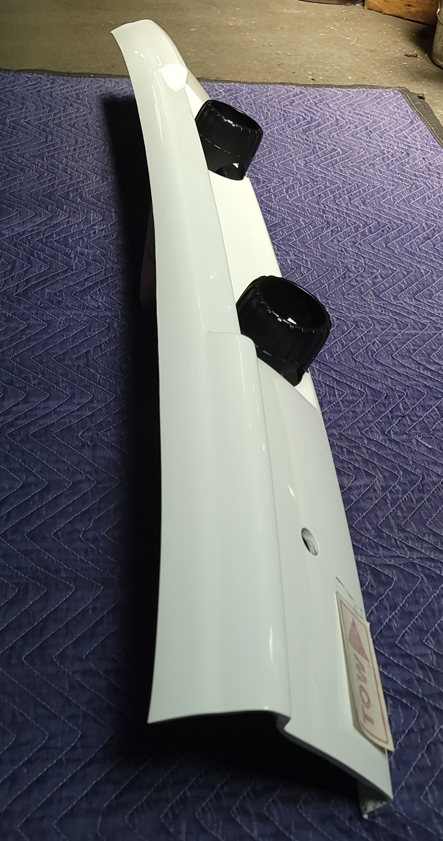

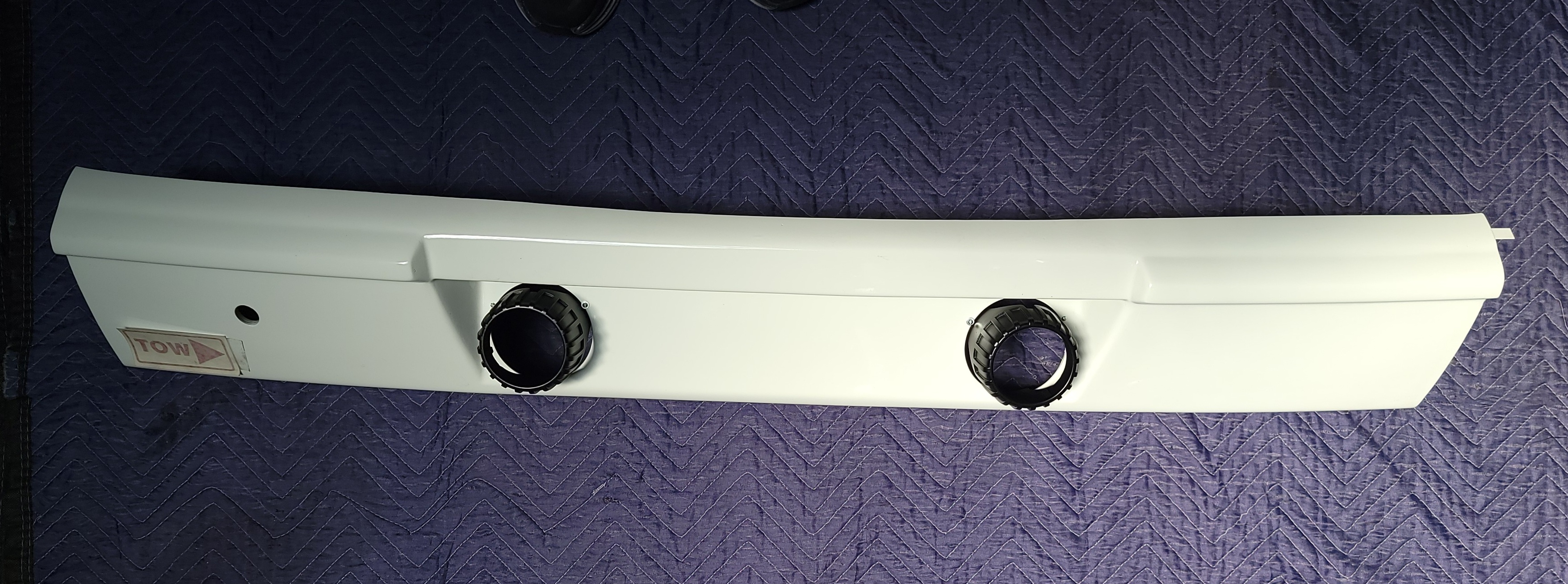

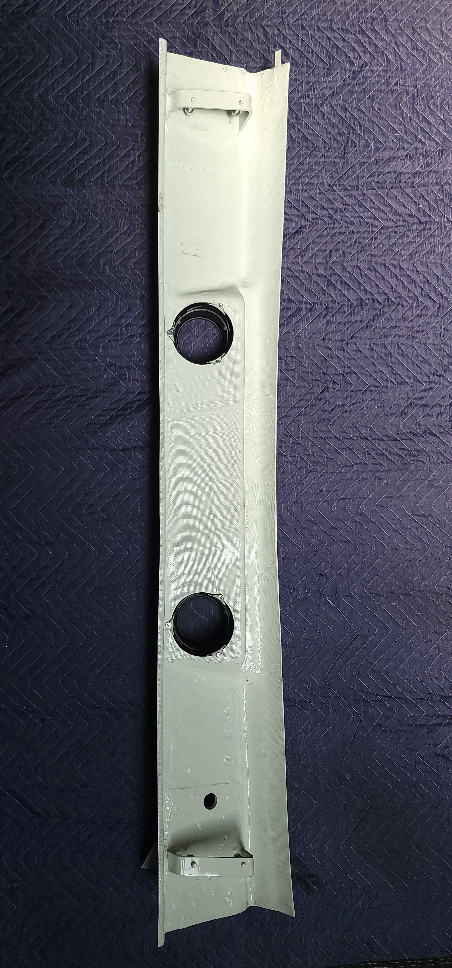

Another body part finished up; rear bumper now set up with the CGT exhaust tip 'Surrounds.
Maltese Falcon
post Jul 7 2024, 06:49 PM
Post #852
Posts: 5,451
Member No.: 2,755
The final 3" o/d exhaust system will exit through these housings; and coated in black Ceramic...same color is used throughout the entire exhaust system.

Backside of the rear fiberglass bumper: it's A.I.R. brand very sturdy build>> but Lots of time and labor getting their left and right steel brackets Tweeked to fit the unibody (IMG:style_emoticons/default/wacko.gif)
technicalninja
post Jul 7 2024, 07:55 PM
Post #854
Posts: 2,531
Joined: 31-January 23
From: Granbury Texas
Member No.: 27,135
Those look interesting.
What sort of magic will you use to keep the fiberglass from degrading?
Exhaust tubes slip through them without touching?
I'd guess at full tilt that might see 6-800 degrees, maybe more.
How do you make it live?

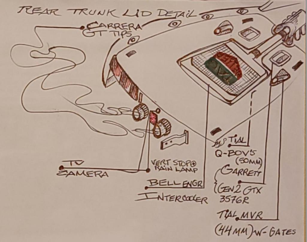

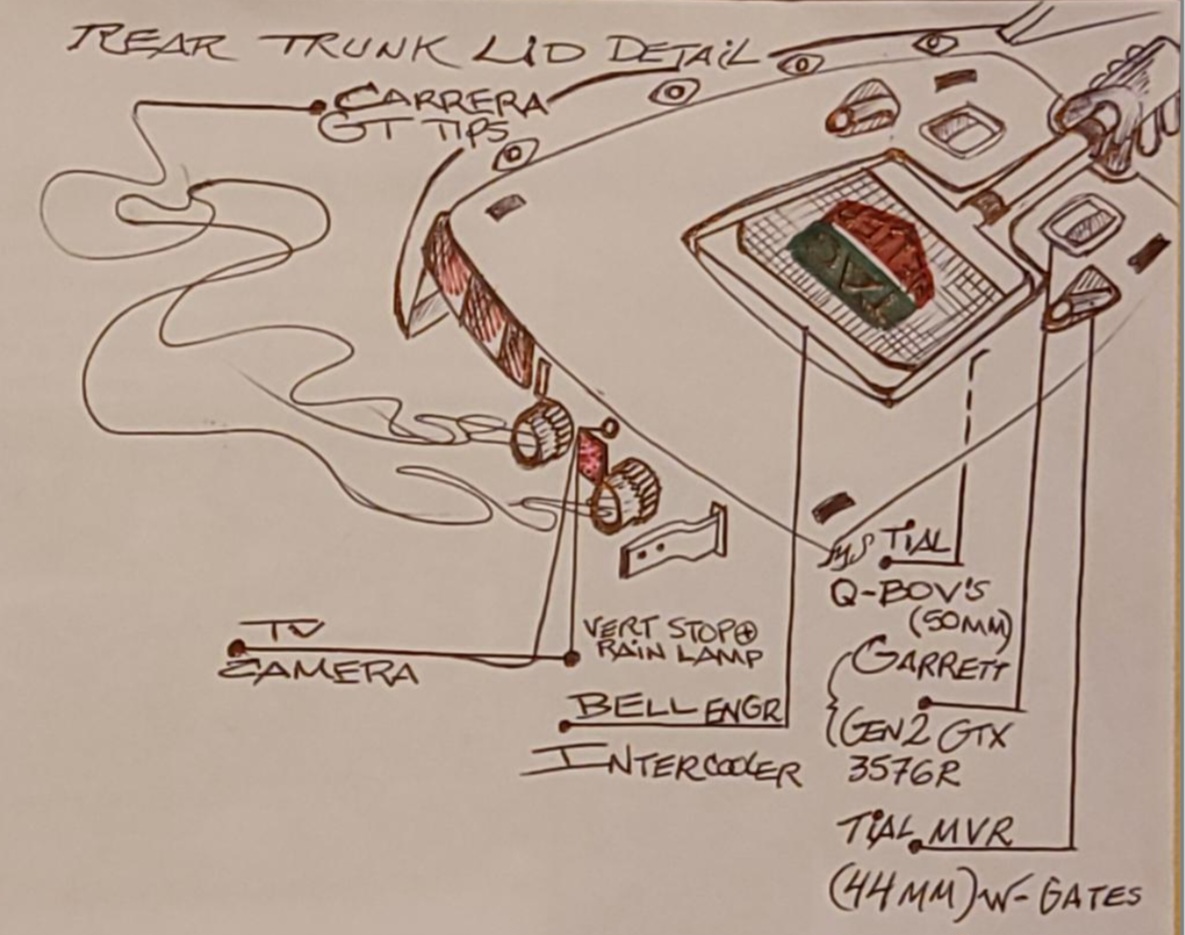

@technicalninja it's not a big problem with temp, the exhaust exits the turbos at approx 1200°f and cool down somewhat heading towards the back bumper.
Coatings bring down the egt's too. Main design challenge is shoving twin 3" od compound/ mandrel formed tubes through a left and right maze of components AND a bunch of SS heatshields, all in
tight 914 rear confines !
This is a quick thumbnail I sketched up which shows a bit of goods I'm hauling around back there !
I have a crazy idea brewing up regarding better 'Packaging of the exhaust...and has been planted in my brain ever since RennSport7, viewing the 963 in the workshop with its rear bodywork removed.
Keep watching our progress here for my easy way around dealing with this heat.

These SS base plates just received for the 3DGAuto.com headlight assemblies.
Now to start laying out the outline for cutting the Sheridan "Turn signal" bucket area.
I have 4) extra pair if anyone is planning on running these headlights on their fiberglass bodywork (Sheridan, 914Rubber, GT Racing) style. Attached Image
