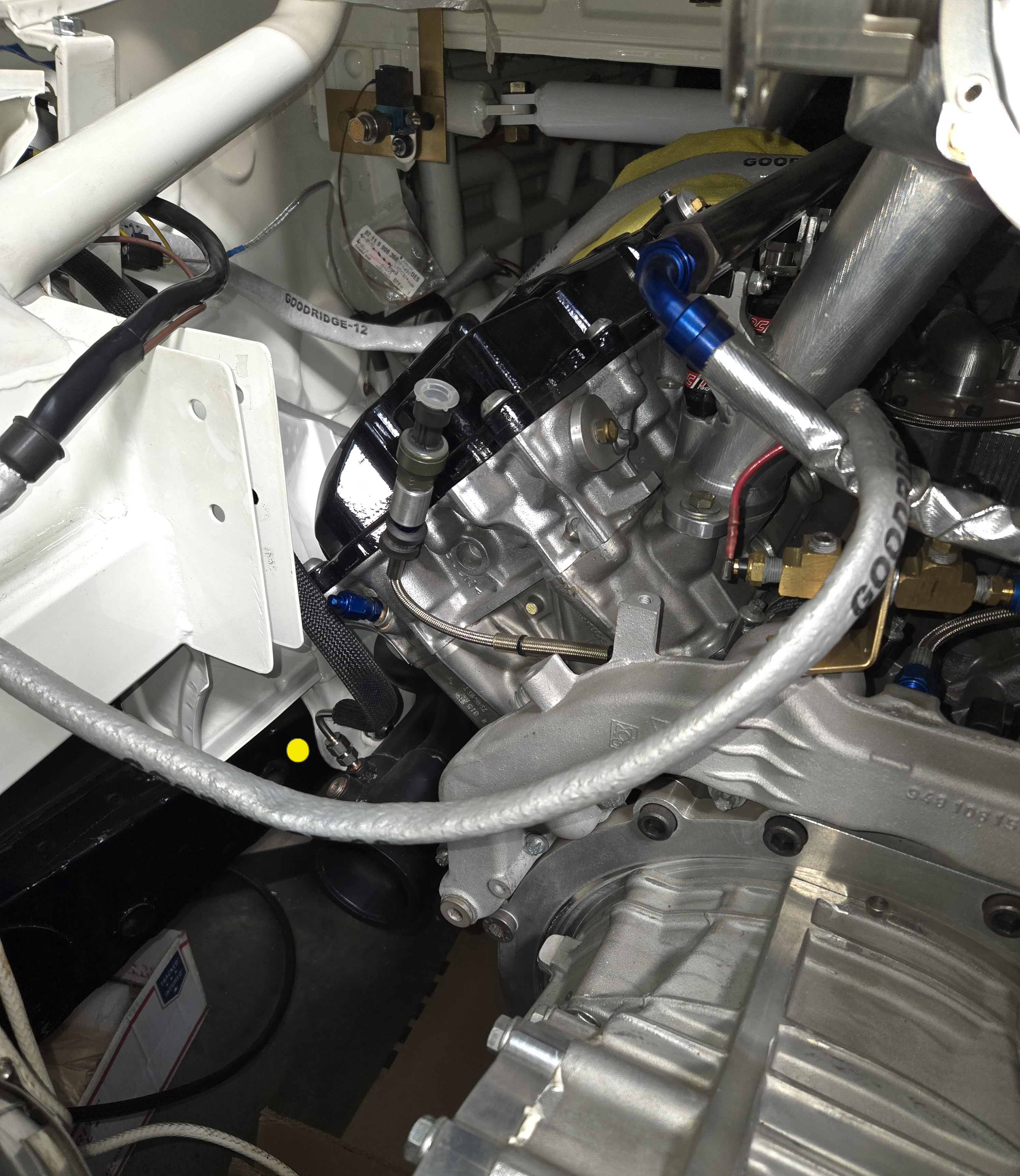

@tecnicalninja just a factory hard-mounted transaxle-to gear oil heat exchanger /probably will run pretty hot gear oil with sustained speeds + heavy throttle; then a higher mounted CSF air-to-coolant (independent of engine coolant + seperate pump) exchanger mounted in rear using the forced air stream...that's where most of the cooling takes place for the cooling of gear oil.
Two engine oil coolers (in L+R ¼ panels) will keep the oil (in tank as well) approx 170-180°.
Undershot pic makes some things look stacked >> but not the case.

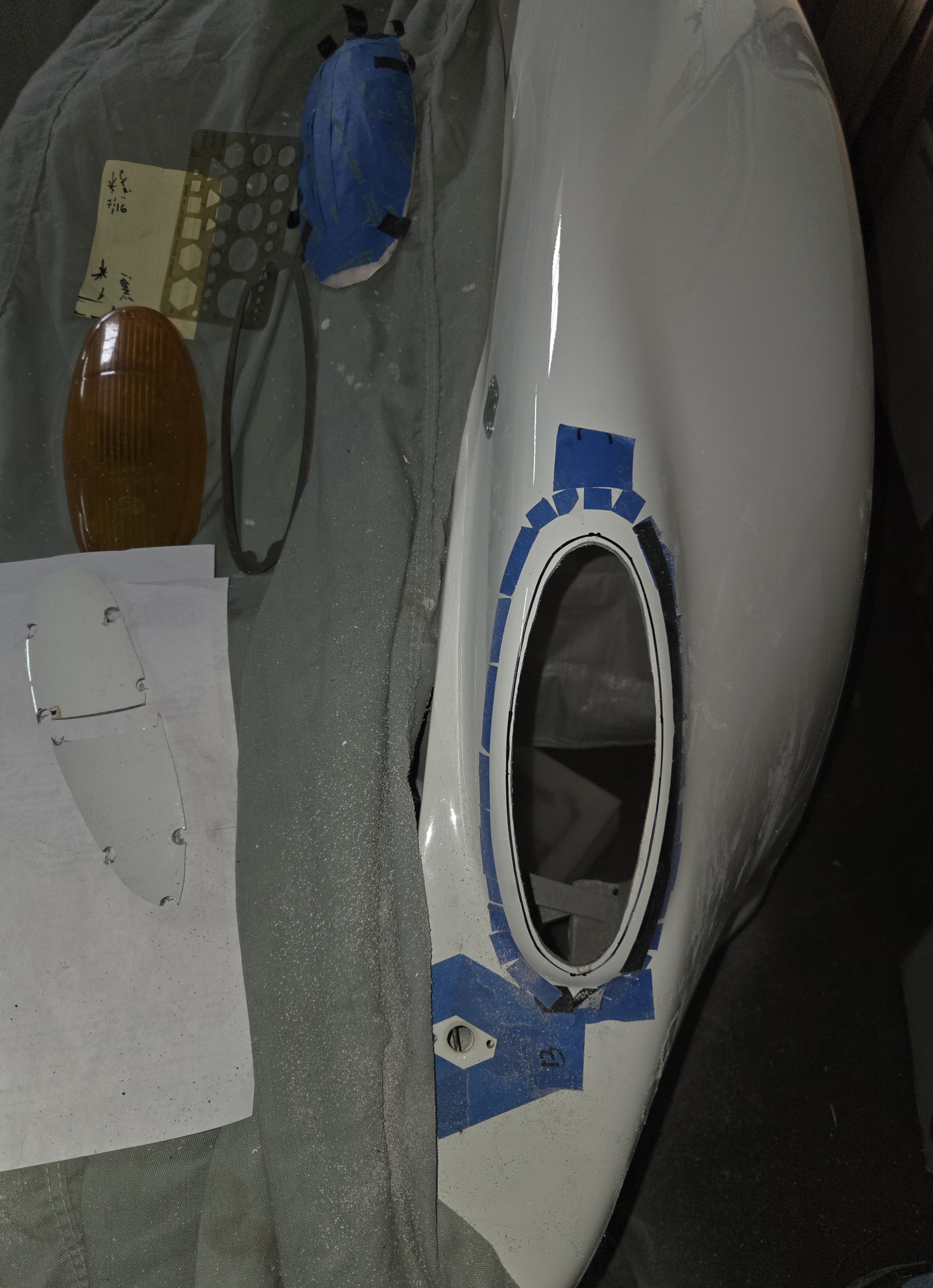

Today's work on the Drivers side front turn signal pod; make it resemble the Passenger side for the 3DG Auto headlights. My 'Marty San RWB saw -cutting 15 minutes of fame...hope that Rodger Sheridan isn't dropping tears over the shredding of his body kit (IMG:style_emoticons/default/biggrin.gif)

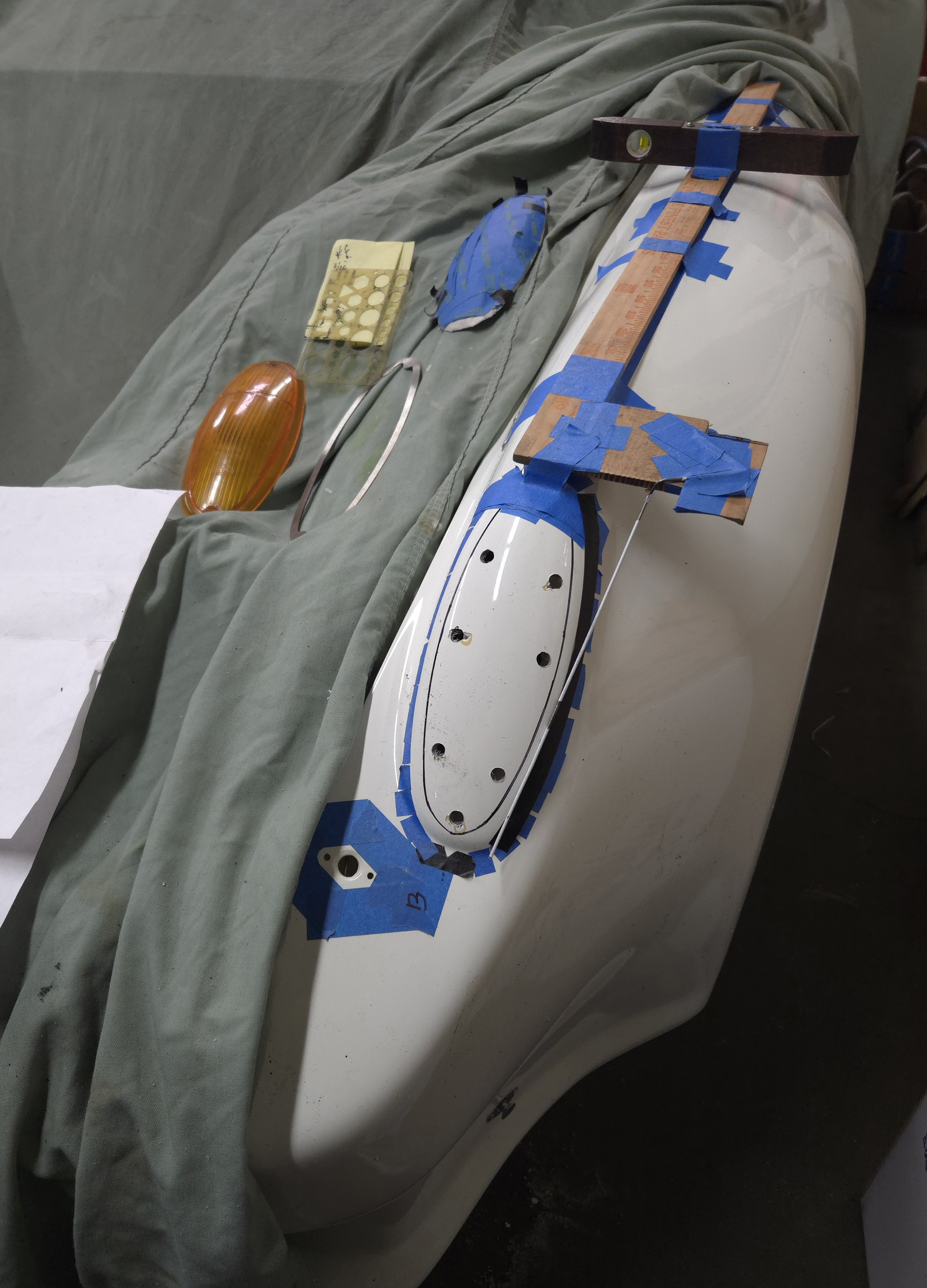

Basic jig-fixture for marking the proper raked angle at the top of the Sheridan fender/ 3dg-auto headlight area.
I've set the angle with a thin strip of black masking tape, and will follow while hand- block sanding with #200.
The new headlights are more pronounced than the oe turn lenses...so I want to keep these sitting into the cut-outs at a nice swept back angle.
Otherwise this mod could come out looking like a '59 Bug eye Sprite (IMG:style_emoticons/default/shades.gif)

...good set-up, now on to block sanding
