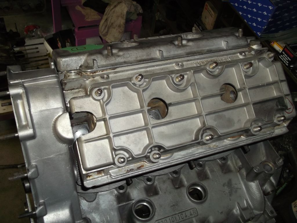

Damn I put the head on upside down,,,, (IMG:style_emoticons/default/screwy.gif)

OK, kidding aside....
A borrowed set of DP valve covers...nice to see other peoples mistakes, so you don't make them yourself. (IMG:style_emoticons/default/biggrin.gif)
I have to cut the half cap on the chain cover and then I can make a perfect hole on my turbo cover.
Isn't there also a minor mod you have to do on the turbo covers for the 914?

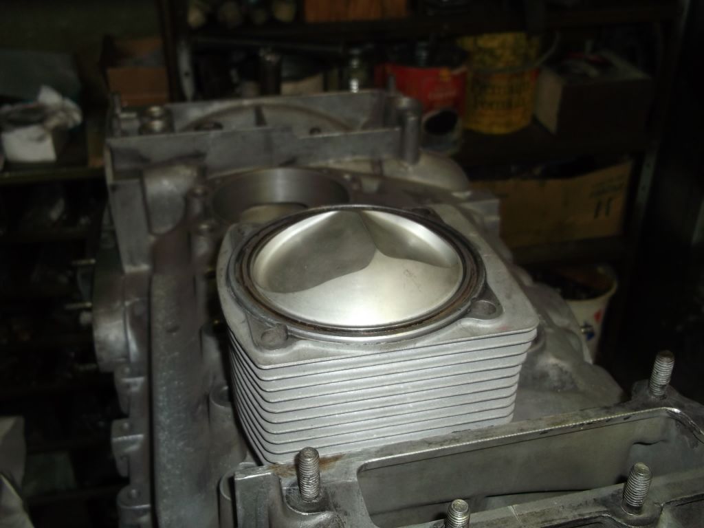

Of course I'm not happy just working on one project (IMG:style_emoticons/default/rolleyes.gif)
I'm almost ready to zip up the case on my type 4
This engine was originally for my 914 but DWS set in (and I took a break for a while, something like 4-5 years ago) and plans changed to a 3.0 /6
This puppy is now destined for my '67 bug (IMG:style_emoticons/default/biggrin.gif)

Nothing I build for myself is stock (IMG:style_emoticons/default/happy11.gif)
2.6L in a bug (IMG:style_emoticons/default/shades.gif)

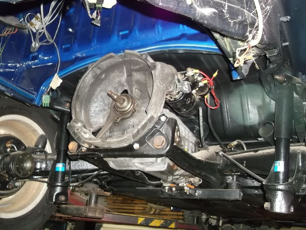

Going to couple that to a 901...in a bug (IMG:style_emoticons/default/smile.gif)
Been making major progress this winter. (IMG:style_emoticons/default/popcorn[1].gif)

QUOTE(Woody @ Mar 15 2013, 12:14 PM) *
2.6? Are those 103s? (IMG:style_emoticons/default/popcorn[1].gif)
102mm nickies and JE's with custom valve pockets. (IMG:style_emoticons/default/smile.gif)

If you're using turbo valve covers on a 914-6, you need to machine some of the ribs off the end 1/4 of the lower valve cover to be able to remove the cover when the engine is in the car. Pics have been posted somewhere,but I don't remember where right now.

yes I found this one and other threads
http://www.914world.com/bbs2/index.php?sho...00517&st=20

Mill the whole covers fins down to the stud bosses....looks better.
