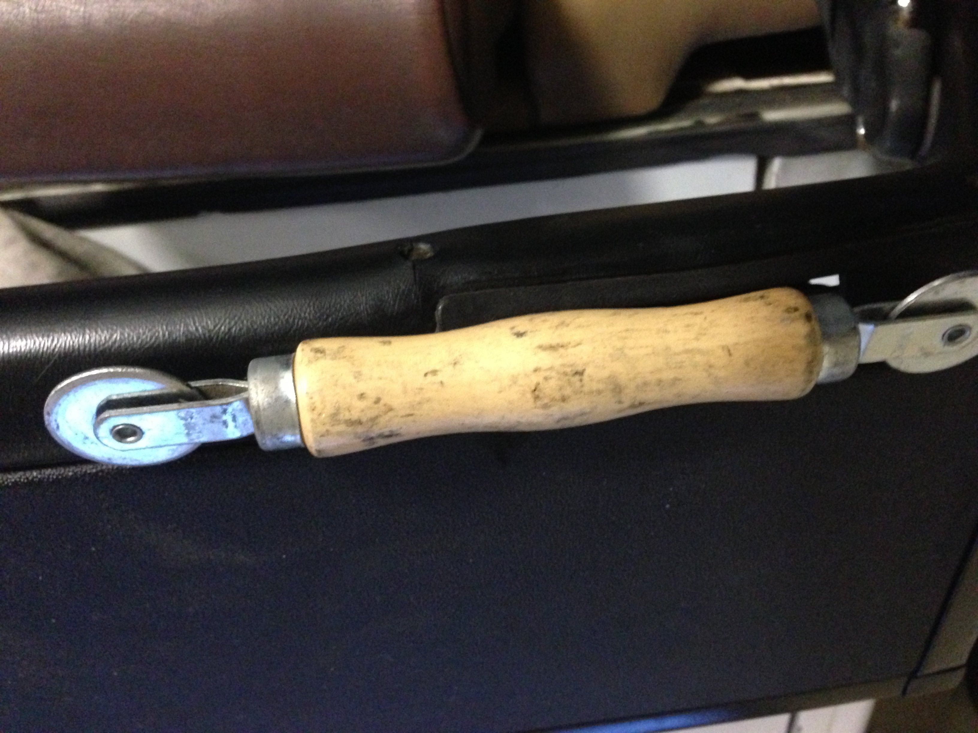

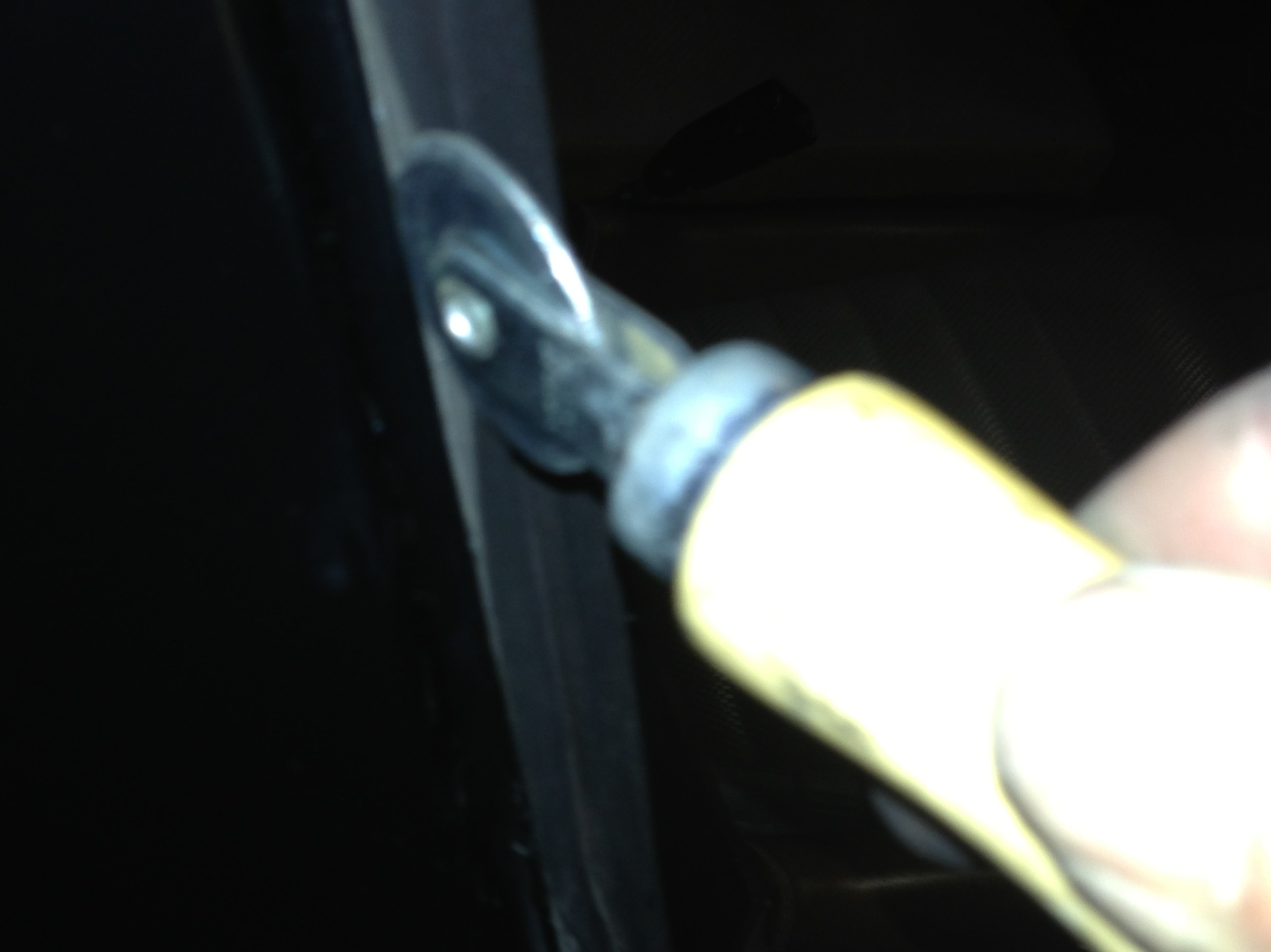

Alright here is the answer to my question (IMG:style_emoticons/default/cheer.gif) if you need to squeeze 40 year old rubber back into its channel use a window screen roller. It worked perfectly. No lube or blunt object needed. Once you get the right angle and pressure it zipped it right in with one continuous pass. Simple. (IMG:style_emoticons/default/aktion035.gif) I knew there was a trick! Thanks toadman yougot me the right track with wall paper seamer technique. Attached Image Attached Image

Nice.
Yes, rubber has memory, stretch it with vibration and hot/cold cycles, it will shrink back.
