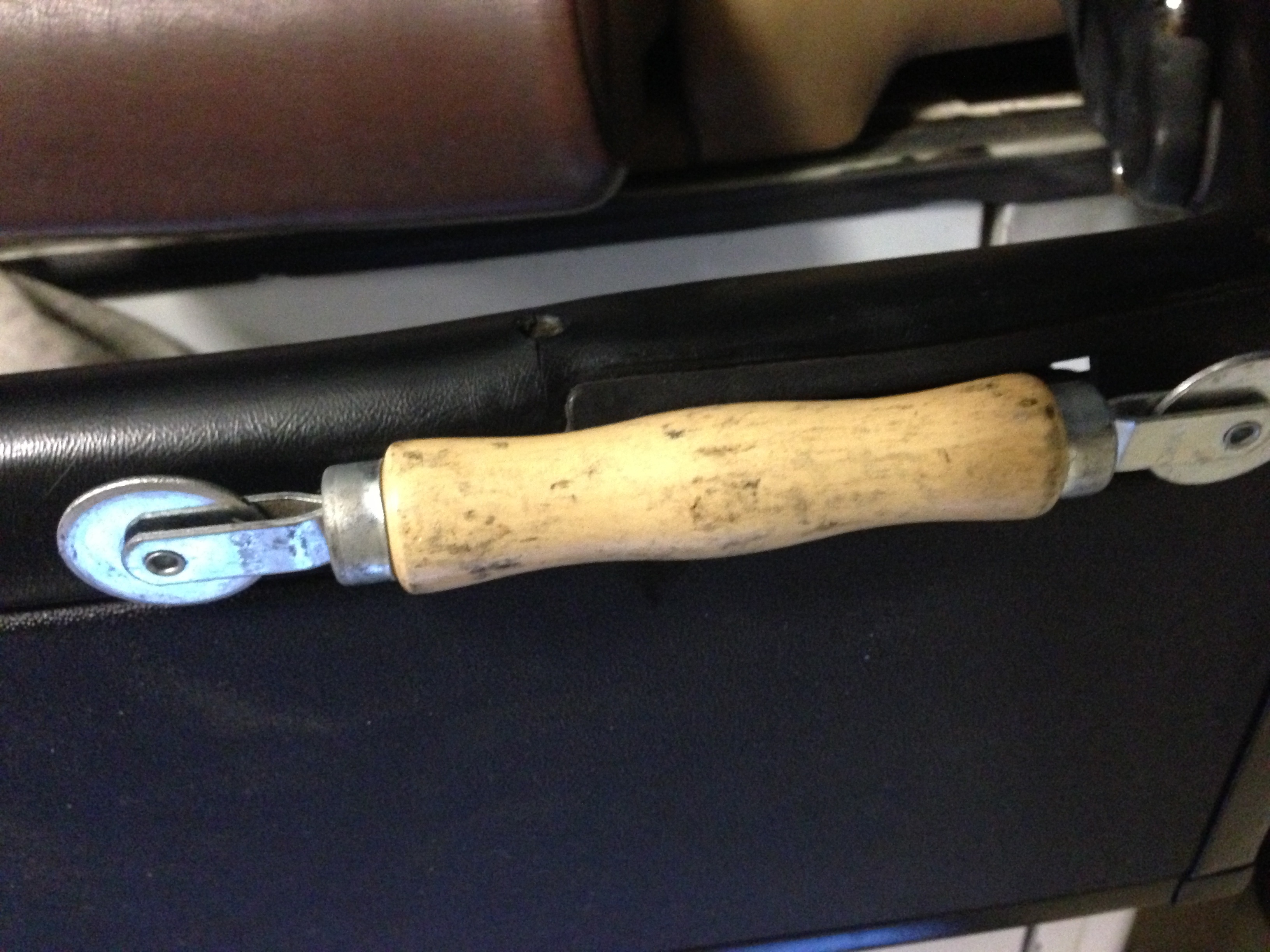

I did this little job awhile back. IIRC, it looked like the factory intentionally dented the channel a little bit to hold the seal in place. I straightened out these dents a bit before putting in the new seal. I used a silicon lube on the seal and a wall paper seam roller as my "blunt object". Start at the top or bottom and use the seam roller to press the seal into place. I think it took me about 15 minutes to do one door-glass-to-targa-pillar seal. You could carefully "dent" the channel to hold the new seal in place but it seemed like such a tight fit that I did not do this.

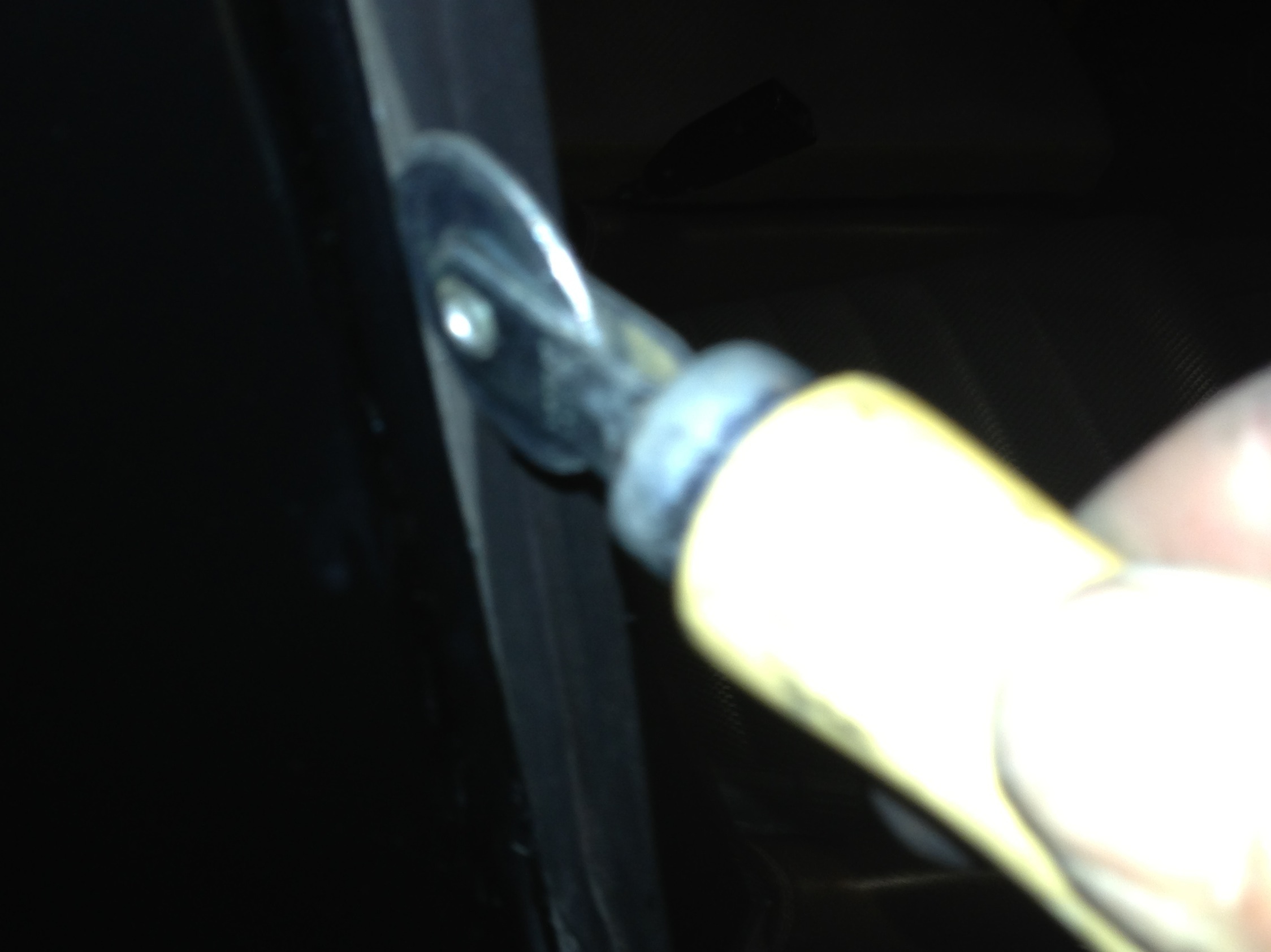

Alright here is the answer to my question cheer.gif if you need to squeeze 40 year old rubber back into its channel use a window screen roller. It worked perfectly. No lube or blunt object needed. Once you get the right angle and pressure it zipped it right in with one continuous pass. Simple. aktion035.gif I knew there was a trick! Thanks toadman yougot me the right track with wall paper seamer technique. Click to view attachment Click to view attachment
