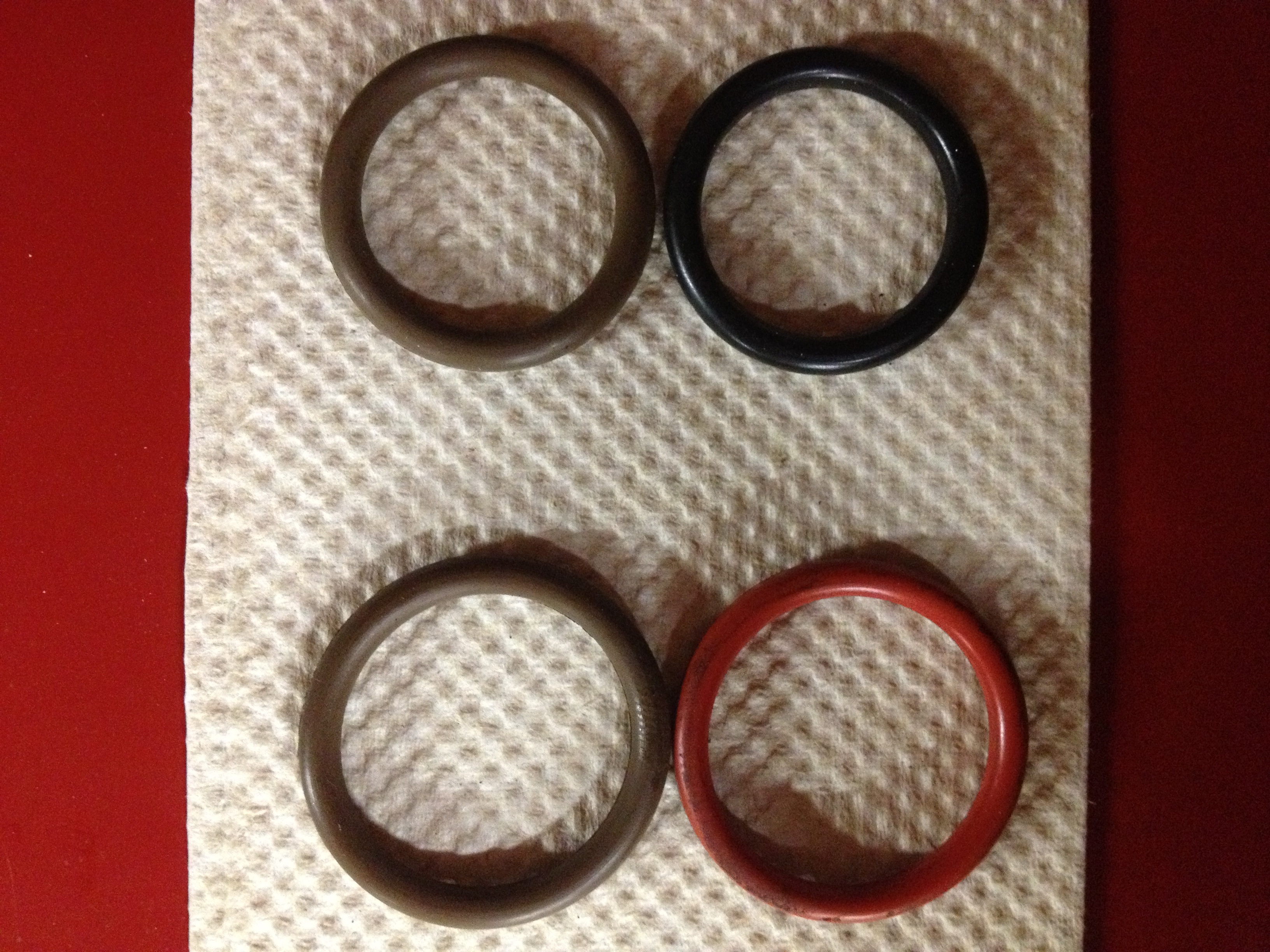

There are some early 1.7 engines that have different sized pushrod tubes than everyone else. Compare an old seal with the new ones.

Here's what came out compared to the new seals. There appears to be a slight difference. So where do I find the early seals?Attached Image

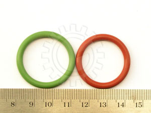

Nope, those look right.
The small pushrod tubes only affect a very few engines. That's why you don't see much attention paid.
Here's a comparison from German Supply.com
