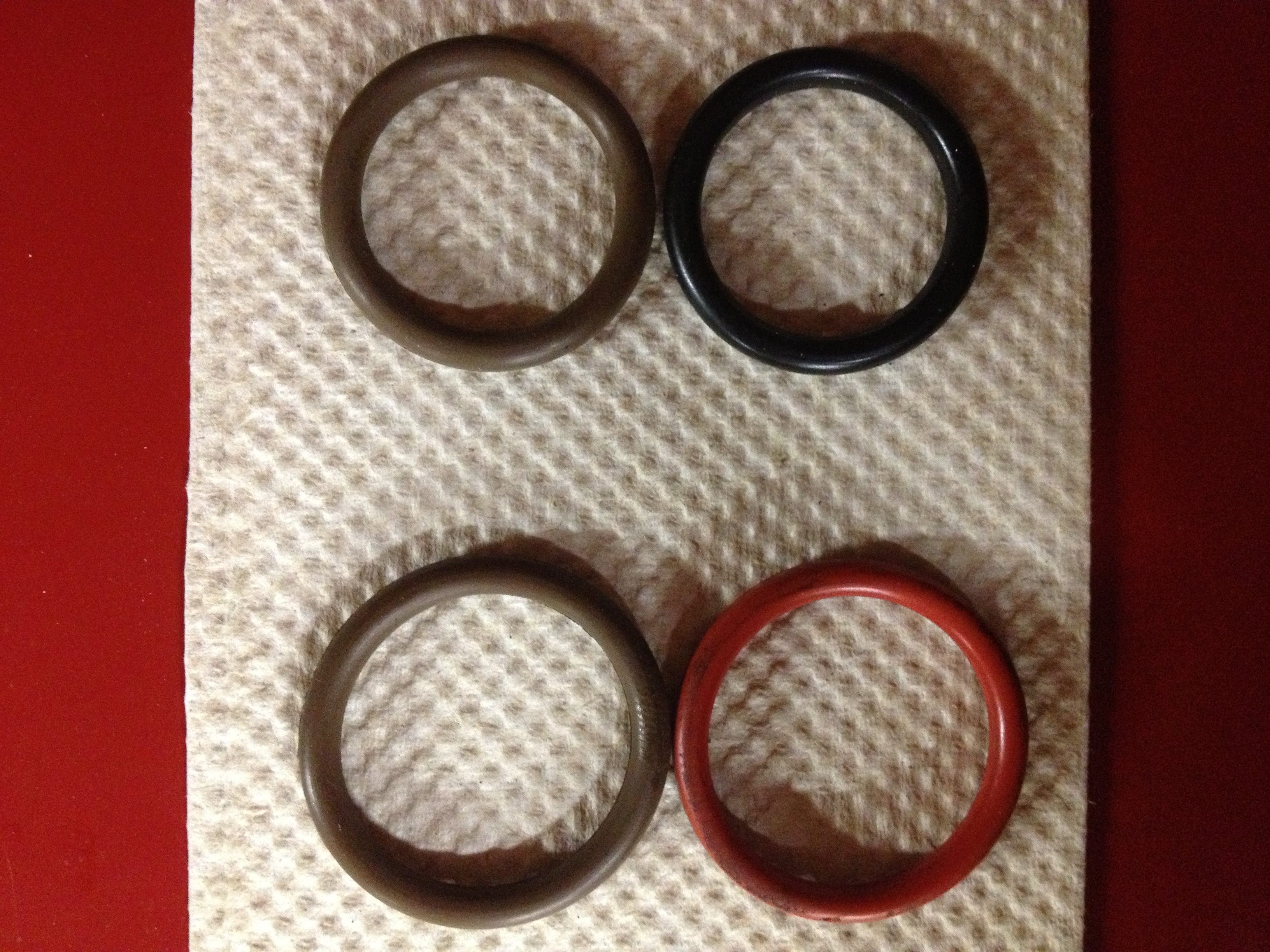

Here's what came out compared to the new seals. There appears to be a slight difference. So where do I find the early seals?Click to view attachment

McMark
Nope, those look right.
The small pushrod tubes only affect a very few engines. That's why you don't see much attention paid.
Here's a comparison from German Supply.com
