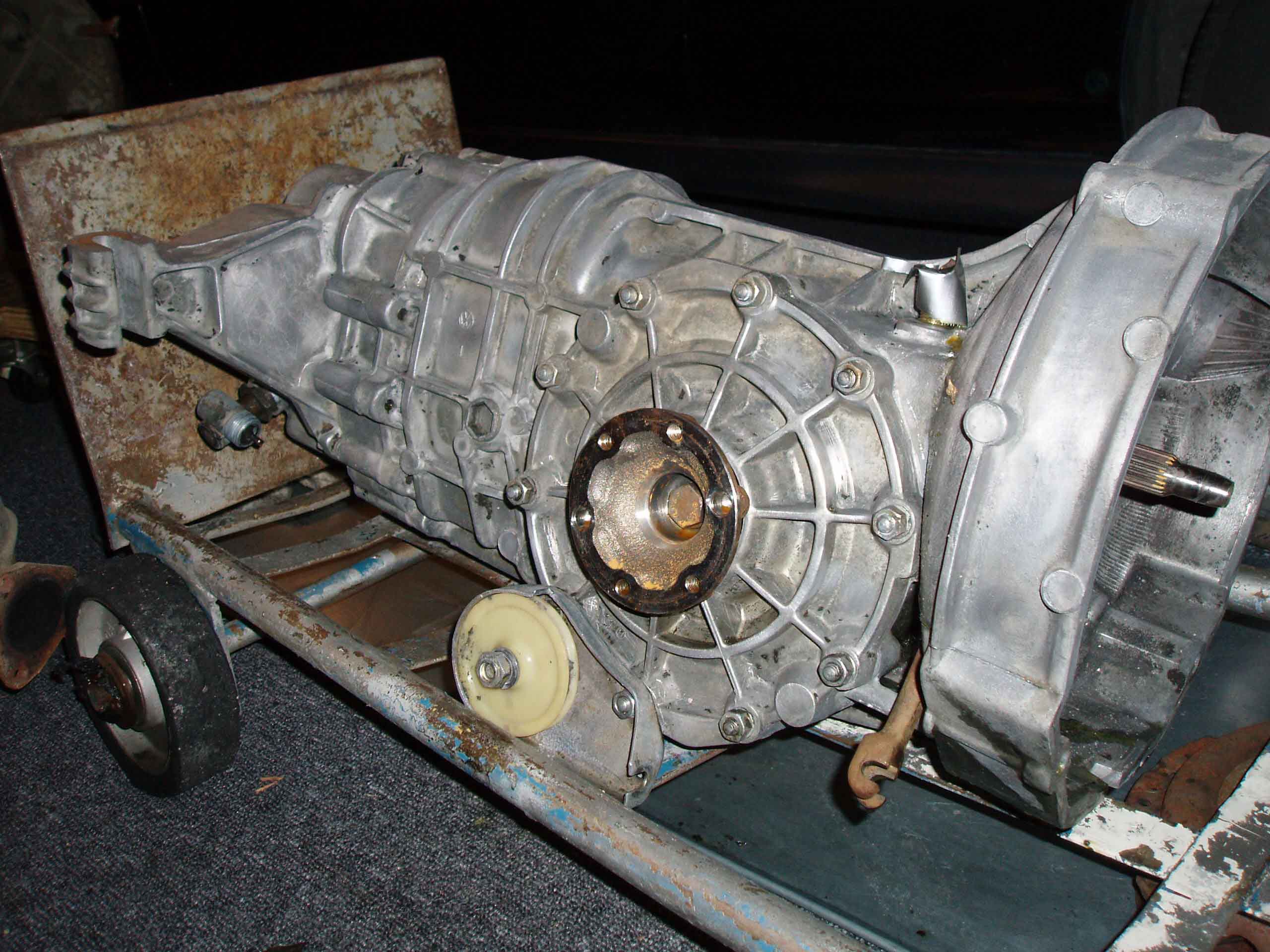

I have pulled the transmission on my parts car removed lose oil and grime with Gunk spray let it sit then took it to the car wash tried cleaning it up with the engine cleaner at the car wash, started to scrape the (IMG:style_emoticons/default/screwy.gif) build up mess with plastic scraper and much of it just wont come off well its certainly much better but I want it nice and clean looking like my new engine any tips on cleaning years of baked on gunk?

Well, I was able to decipher what you were saying even though there wasn't a period anywhere in your post. (IMG:style_emoticons/default/blink.gif) Dr. Evil will kill me for saying this, but I used a couple cans of brake cleaner. A lot of guys don't believe in this because it strips away the original coating that was on the transmission to protect it. After I got mine clean I repainted it silver though, just in case. Good luck!

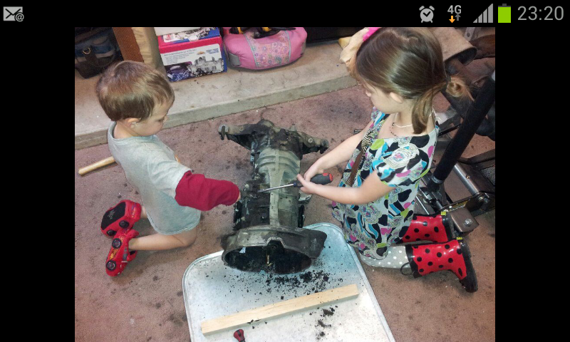

I put my kids to work srcapping at mine, after a couple days and a new coat of silver paint it looked pretty good.

Brake cleaner is fine. Water is not if it gets inside. I use the Awesome that Jeff speaks of since he posted about it a while ago. Ez-off was my old go to, but Awesome is too cheap and easy not to use.

There are a lot of harsh cleaners that will do the job. But as many others have said, a little heat goes a long way. While I am not willing to use a torch on mine, warming the trans with an electric heater or heat gun will help a lot. Also any water based cleaner will work better when warm.
