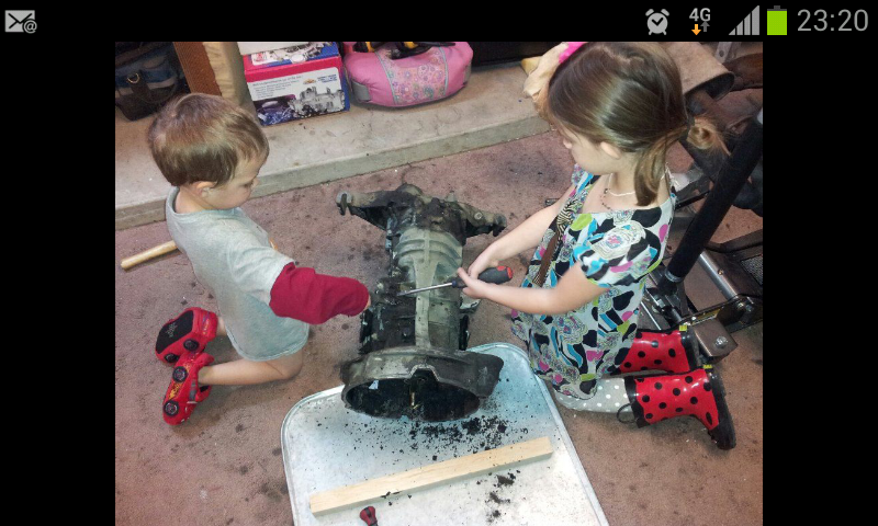

I put my kids to work srcapping at mine, after a couple days and a new coat of silver paint it looked pretty good.

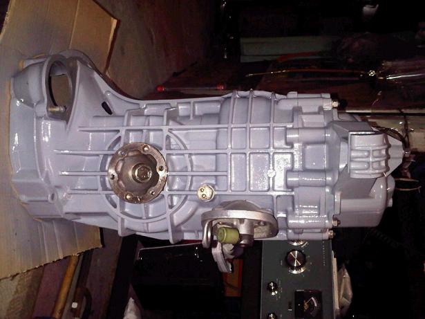

Mar 23 2013, 06:26 AM
Dr. Evil did mine. It is an original Six transaxle converted to side-shifter. I saved the tail-shift parts.
ThePaintedMan
Mar 23 2013, 07:48 AM
Wow, that last one is pretty!
This was just several cans of brake cleaner, scraping, more brake cleaner and then rattle can silver.

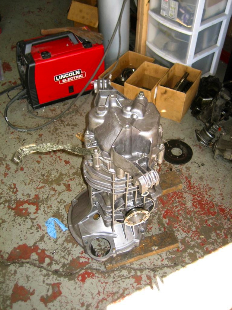

I used some concentrated degreaser from a restaurant supply store and a variety of plastic scrapers and brushes to clean mine, then sprayed it with a hi-temp glossy gray paint
Click to view attachmentClick to view attachmentI think I'll try that 'Awesome' stuff next time
