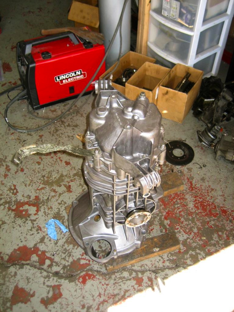

My 915 was steam cleaned by a generous member here. If you really want it to look new, try walnut after that.

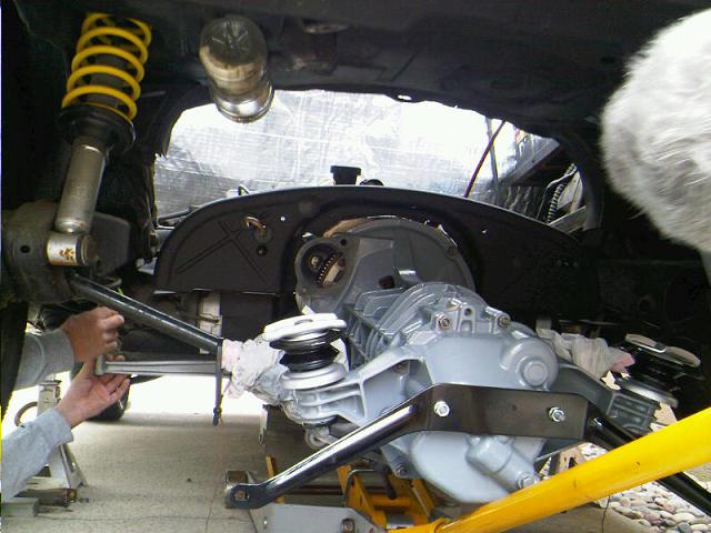

Dr. Evil did mine. It is an original Six transaxle converted to side-shifter. I saved the tail-shift parts.

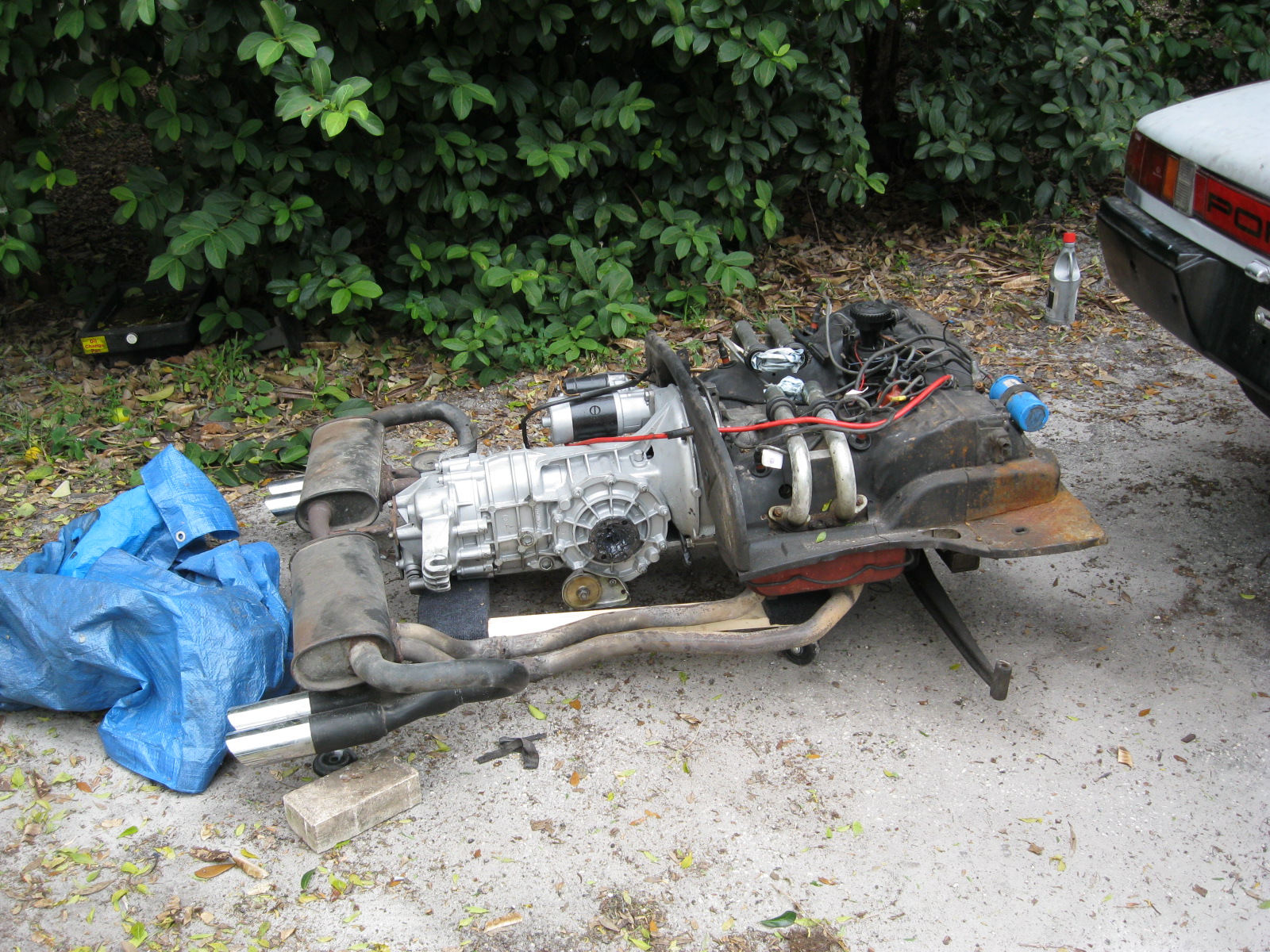

Wow, that last one is pretty!
This was just several cans of brake cleaner, scraping, more brake cleaner and then rattle can silver.

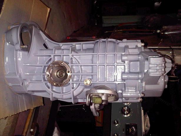

I used some concentrated degreaser from a restaurant supply store and a variety of plastic scrapers and brushes to clean mine, then sprayed it with a hi-temp glossy gray paint (IMG:style_emoticons/default/smile.gif)
