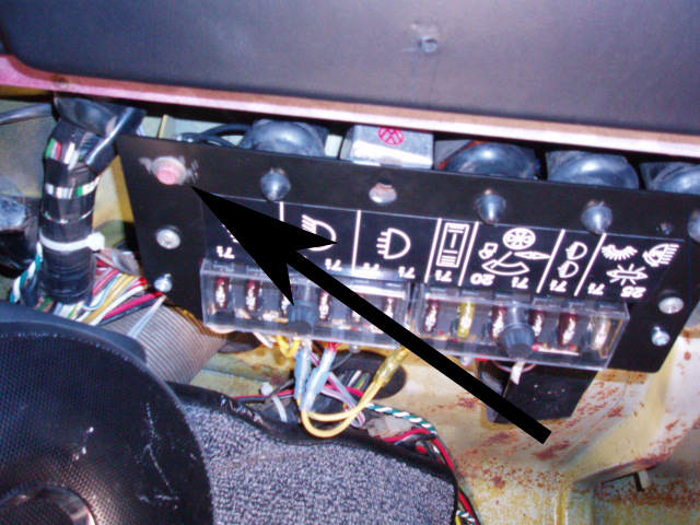

Do you mount the trunk release switch next to the engine lid pull ? If so, how long a switch is needed to go through the fire wall and backpad ? Seems like there are better places to put it- what do you have ?

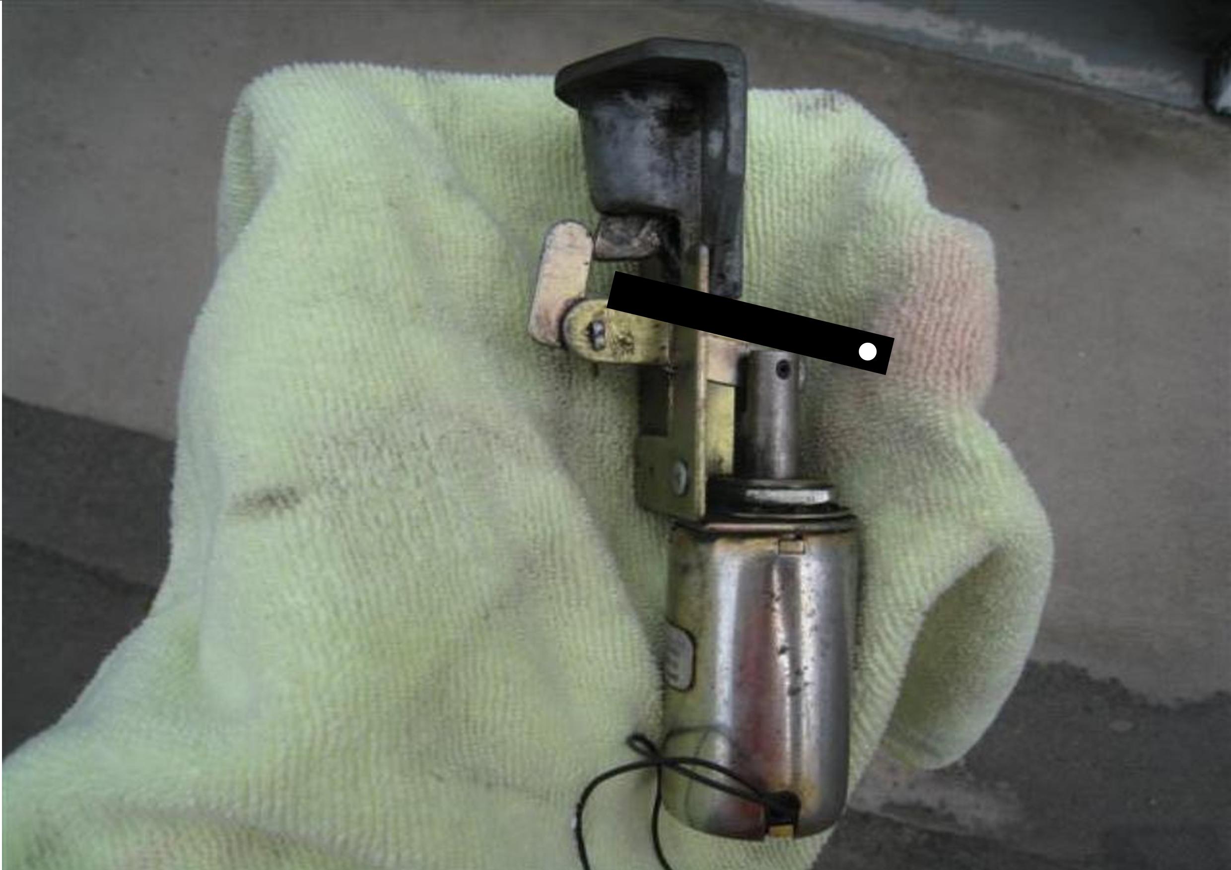

And, how is the emergency pull wire mounted to the solenoid? I don't see a place where there is going to be sufficient leverage

When I had mine, it was under the arm rest mounted to the tray.

mine is under the dash near the fuse panel

mine is mounted under dash right next to the fuse panel. mine dosent work of course so I took the catch out and hope the trunk never flies up. it was that way when I got the car and one day i will trouble shoot it.

Mine is mounted in the corner of the fuse panel!

mine is in the same spot on the other side of the fuse panel, must be a east coast/west coast thing. does yours work?

On my old 914, it was mounted into the glove box. Open the door and push.

My second question is How do I attach the emergency pull wire to the solenoid ?

Connect it to the latch at the same point the solenoid connects.

I mount the safety pull wire to the fulcrum point of the trunk
latch lever. I drilled a tiny hole , then looped the wire through. A small amount of solder onto the
exposed loop of wire. Just a small gauge wire, snake it into the engine compartment, with a small
piece of vacuum hose on the end (handy for grabbing).

Pictures coming:

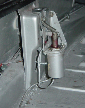

If it were mine... I would weld a bracket... Like this. With a hole in the end for the cable.

Here is how I did mine on my 74!
It has a handle in the engine compartment!

Jeff - Did you make any mods to the solenoid ? Looks like the trip wire is attached to the pivot pin
