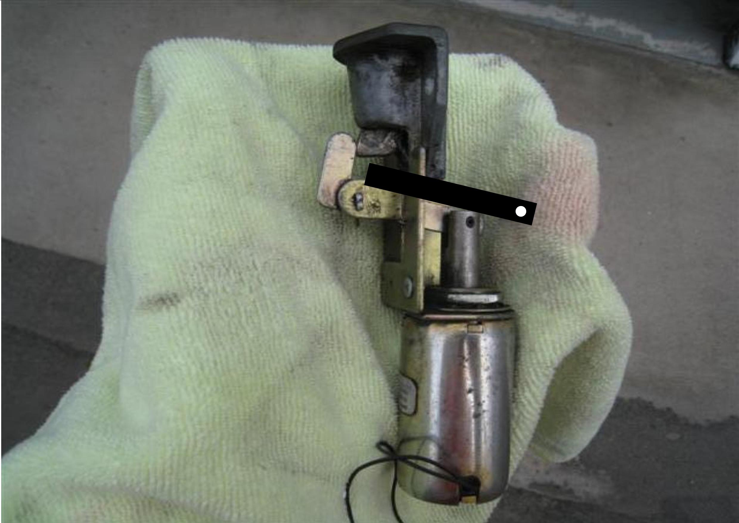

If it were mine... I would weld a bracket... Like this. With a hole in the end for the cable.

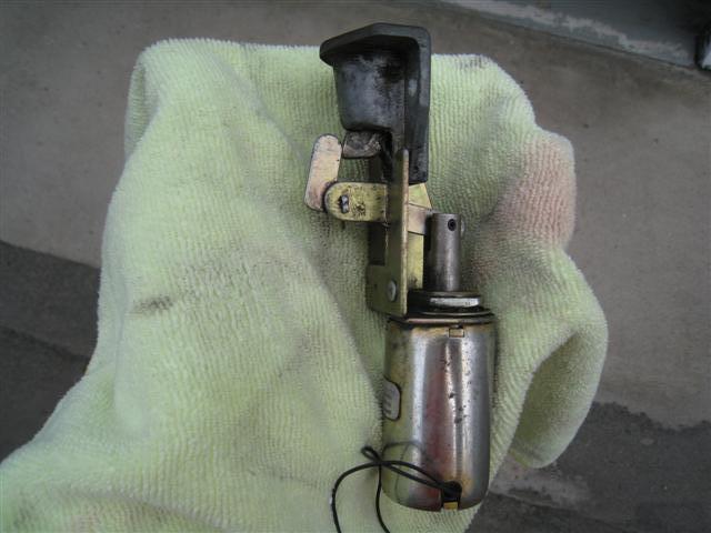

Here is how I did mine on my 74!
It has a handle in the engine compartment!

Jeff - Did you make any mods to the solenoid ? Looks like the trip wire is attached to the pivot pin

Yes I made another pin that holds the pivot arm to the plunger. It extends out with a loop so I could hook the pull cable and added a return spring to help it return to the up position!
The car has been long ago sold, at least 10 years ago, so the exact details I can't remember!

Like the spring, the pull wire pases through the base near the plunger; did you just make a hole or is that a tube ?

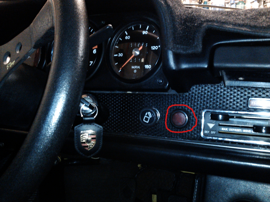

I used an extra fog light switch with a blanked-out red lens (polished the emblem off a lens from a hazard switch) for my trunk latch solenoid. I mounted it in the pre-existing cutout for the rear-window defroster switch. This gives two advantages: a clean factory appearance, and the ability to keep the solenoid engaged if I need to apply some pressure to the trunk lid to get it to unlatch (which is a frequent occurrence). It alos lights up when engaged, which I like.
Click to view attachment(Sorry about the crappy phone pic in a dark garage).
I also used a spare engine lid release cable as a manual "emergency" override with the handle accessible under the left rear fender.

Yes
