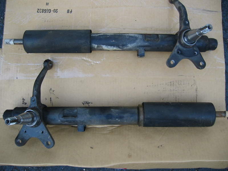

I didn't think the SC series had koni struts....
maybe koni inserts but not struts
the SC's and Carrera's did have 3.5 spacing but I thought they all came with Boge or something struts
I though the actual koni struts were roughly from about 1970- to 1976-ish years
and only an option on those years (S caliper option)
versus the standard strut with 3inch spacing
John's pictures show the difference well
you can see how the housing becomes larger on the koni just above the mounting point for the spindle... on the others it is the same tube size.
this is why you don't see koni struts with spindle mounting location modifications (the taper)
I run koni struts which are sectioned for a drop
but then race shocks inside to accomodate the modification and give travel to a lowered car.
check the shape of the struts on your car

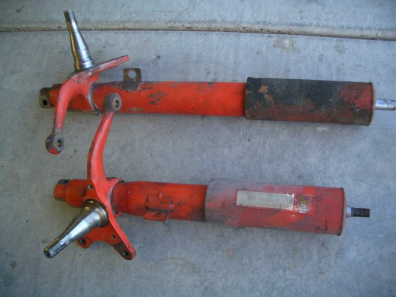

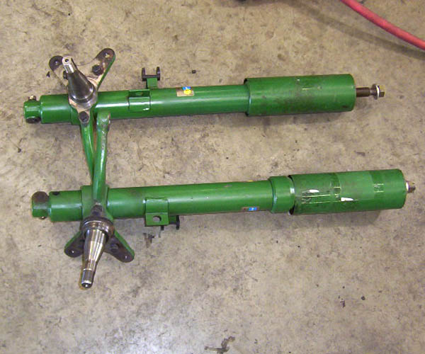

It's all about the thread pattern on the inserts.
Most 911SC models (the years you specified) came with "Boge" struts. Those later SC Boge struts (black as per the pictures above) have the 3.5" spacing "but" they have a "Boge" thread pattern for the insert.
Koni makes the orange struts you see above. They have a Koni thread pattern so only Koni inserts fit these struts.
Same thing with the green Bilsteins you see above. Bilstein thread pattern and Bilstein inserts.
Because Boge was so prevalent in the SC's (almost all of them), the other manufacturers make replacement inserts for them with the Boge thread pattern so, in a way, they're more desirable for the multitude of insert choices (even if some of those choices are KYB) (IMG:style_emoticons/default/wink.gif)
