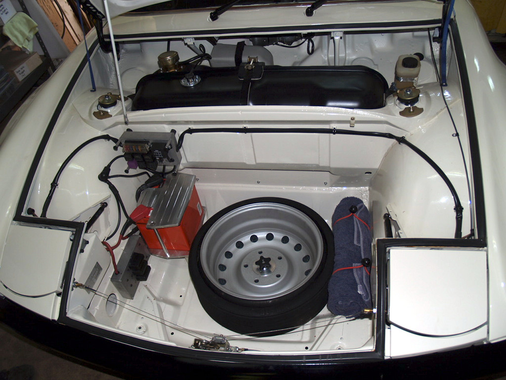

Picture below of a guy in central California with an ultralight 914. I seem to recall another 914 that had a V shaped trunk lid support that swung down from the lid, but I can't find a picture of it at the moment.

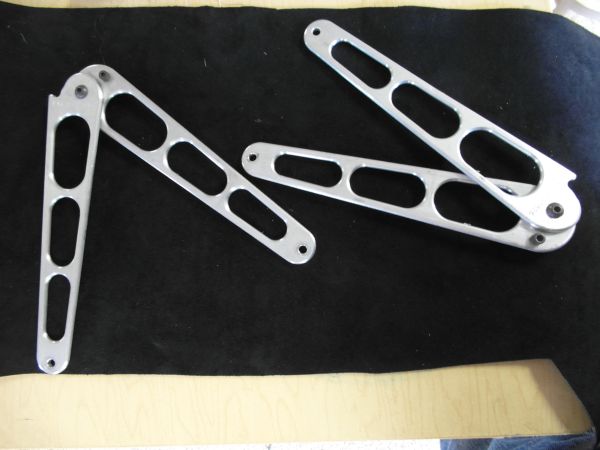

QUOTE(d914 @ Mar 25 2013, 04:04 PM) *
try ebay.. used race parts.. Thats where I got some..
And here are yours....Just walked out and picked them up in your trunk.

QUOTE(dlkawashima @ Mar 25 2013, 01:24 PM) *
HMMMMM - - -
so what are the cables going from the trunk release to the pop-up lights? Some clever version of the no-motor light actuation?
(and -wow- what a clean car! Is *that* what it looks like under all the dirt!)

QUOTE(BIGKAT_83 @ Mar 25 2013, 02:07 AM) *
I used these nascar hood props. It hinges in the middle and puts no force on the trunk lid at all.
Where can I get those? AWESOME solution!

[/quote]
[/quote]
They are on Ebay all the time look for NASCAR hood props. There are many sellers that have Ebay stores that sell nascar take off parts. I got mine in Mooresville NC at a shop.
Bob

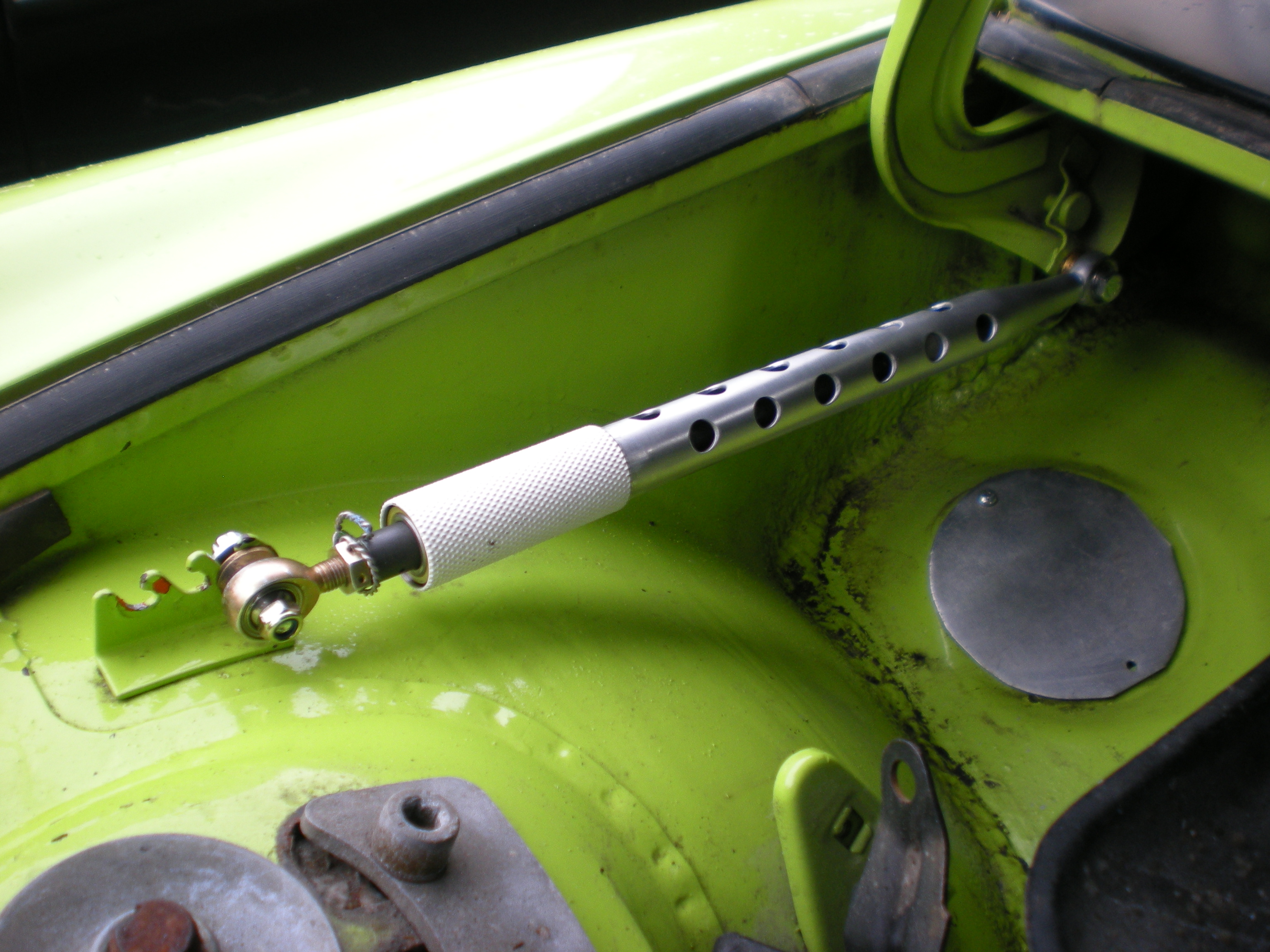

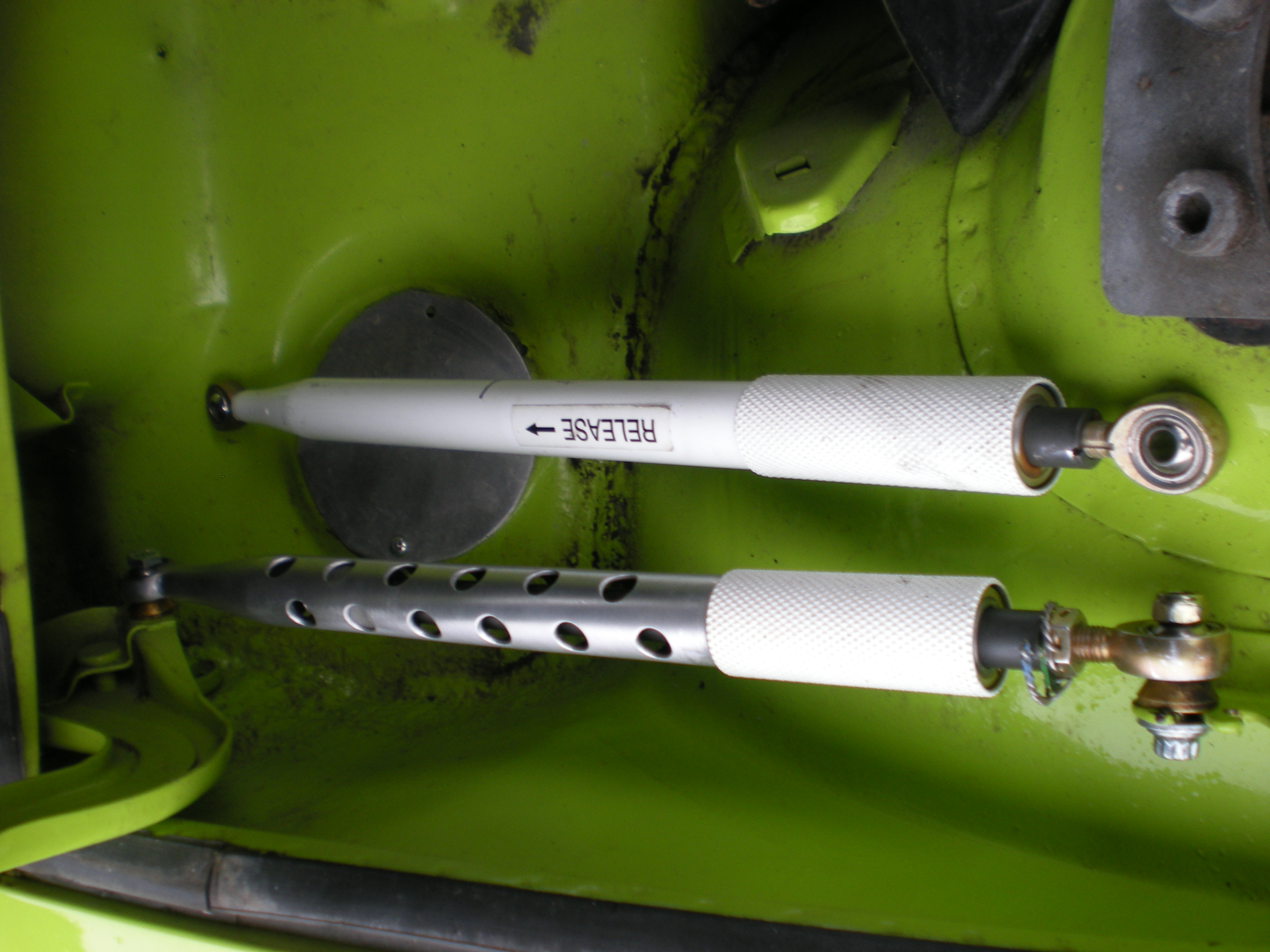

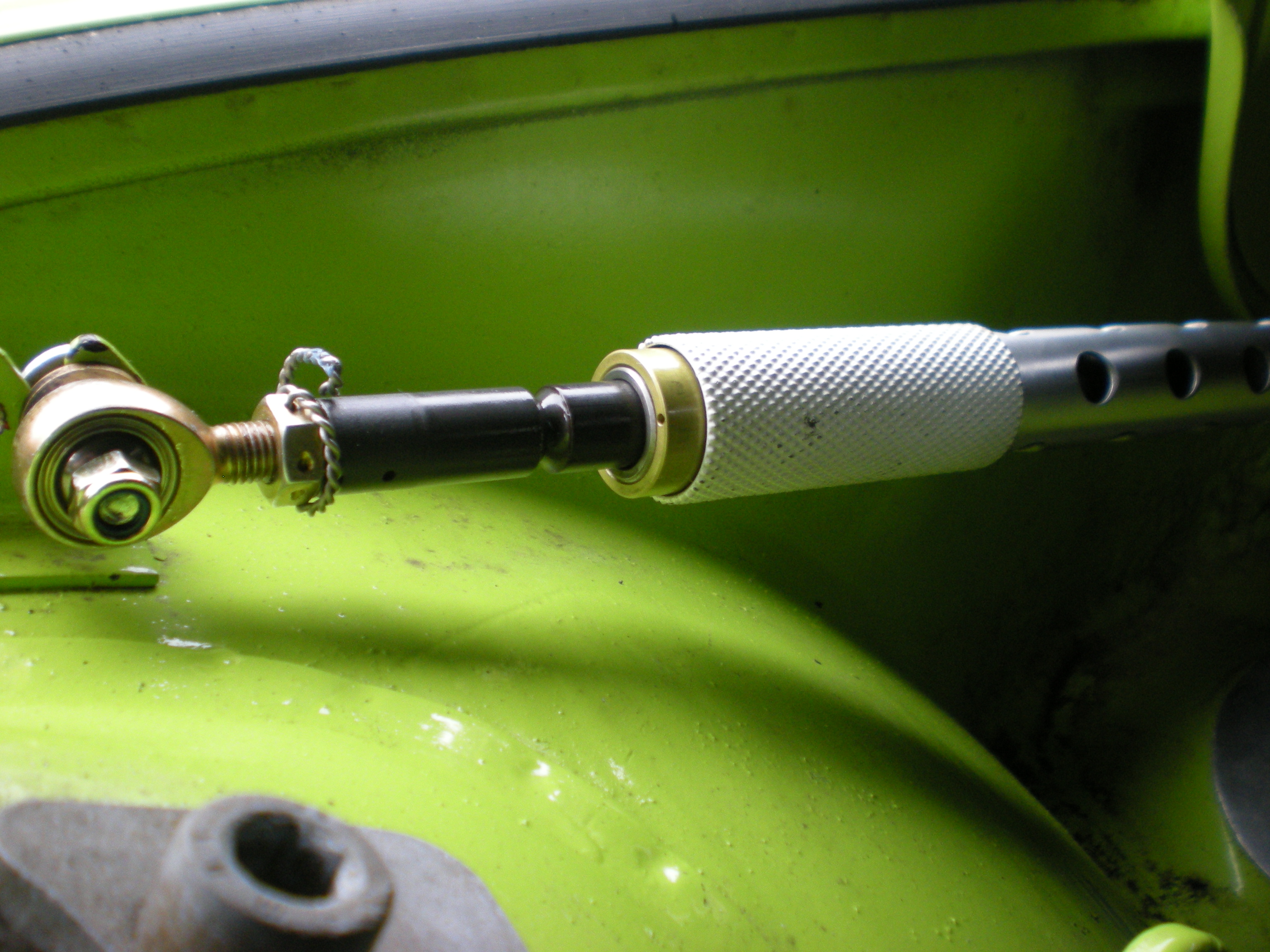

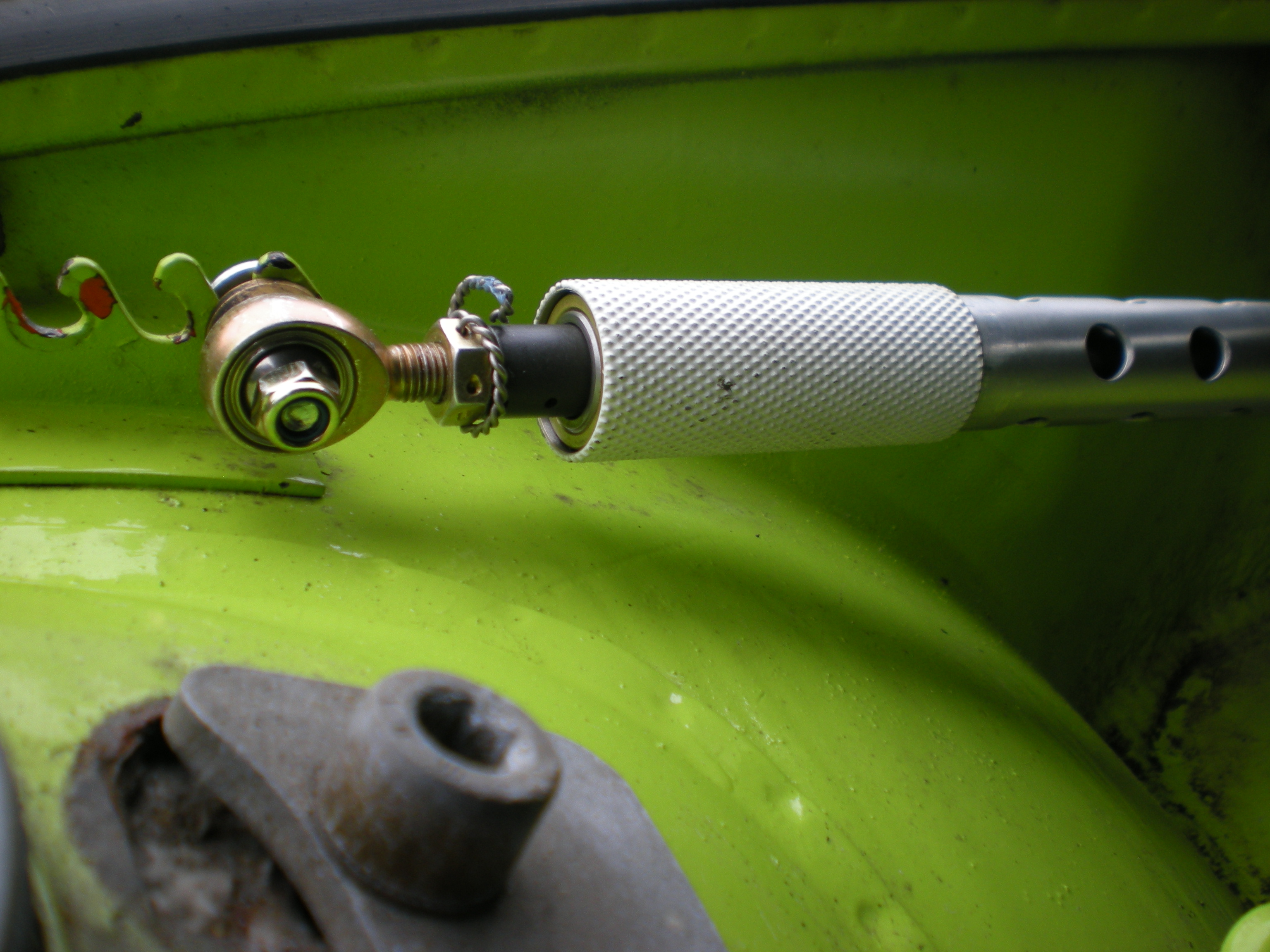

heres mine, recycled airplane part.. (IMG:style_emoticons/default/driving.gif)
sixnotfour
post Mar 27 2013, 05:35 PM
Post #28
Posts: 11,422
Joined: 12-September 04
Member No.: 2,744
unlocked and what it started as.. (IMG:style_emoticons/default/beer3.gif)

That is cool!
The fold-down prop rod above (white car) is cool as well.

low pressure , It has to have enough to hold hood up, pressure which is a difficult formula.....mine lift it locks....lower it lift and slide sleeve down....no pressure, positive... Yup I like mine....(IMG:style_emoticons/default/smile.gif)

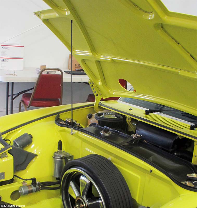

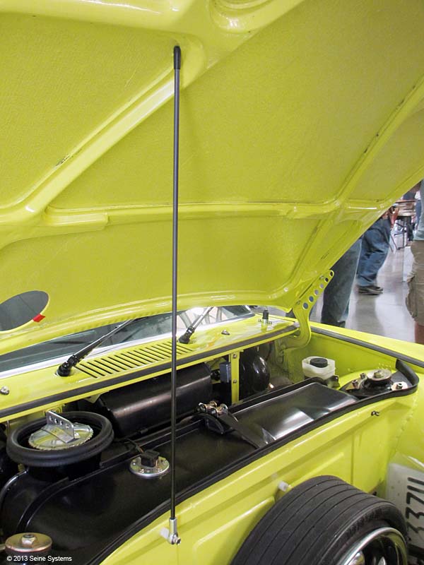

carbon fiber arrow, heim joint, vacuum rubber cap..
screenguy914
post Mar 21 2015, 02:46 PM
Post #36
Posts: 249
Joined: 6-July 09
From: So. Cal
Member No.: 10,540
We have offered a carbon fiber support tube for 911s for quite awhile. Eric, one of our forum admins., adapted one to his 914-6 a few years ago. Depending on method of attachment of the rod end to the chassis (or?), different hardware is needed.
If there's enough demand, we can make a 914-specific kit.
Sherwood
www.seinesystems
rnellums
