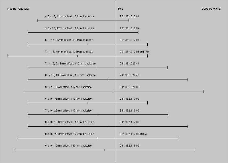

So I'm right? The ET is the offset of the mount surface, but which way?
cwpeden
post Mar 26 2013, 10:59 PM
Great White North, huh?
Posts: 916
Joined: 20-August 06
From: Victoria BC
Member No.: 6,693
Does this answer the question? Partially.
