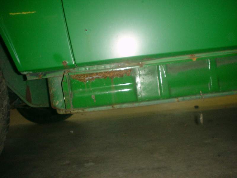

Right side rear

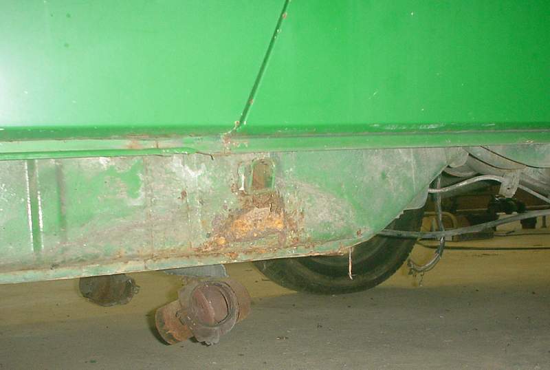

Left side

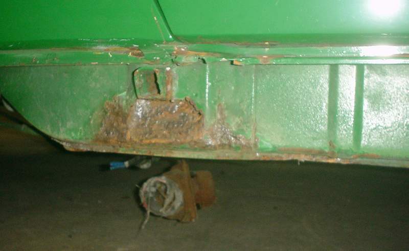

left side jack point

Replacing the longitudinals is a B I G job....I would attempt a clean up, POR 15 it and replace the jack points......it looks like that's all that is bad.
It depends on how bad the inside is.....

2teeners:
I would agree with Z, IF the inside is OK and you don't want to invest your life savings in the car.
