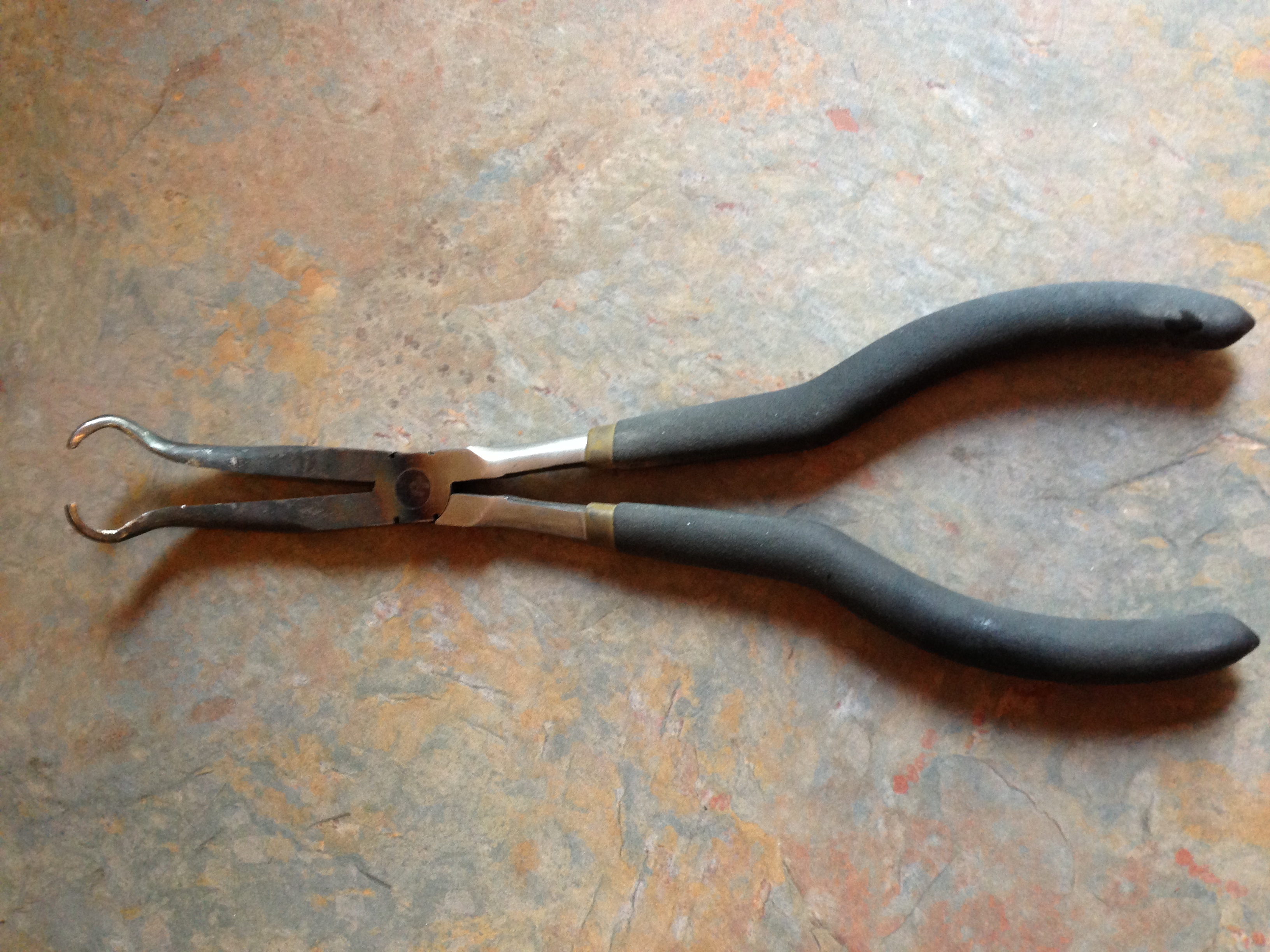

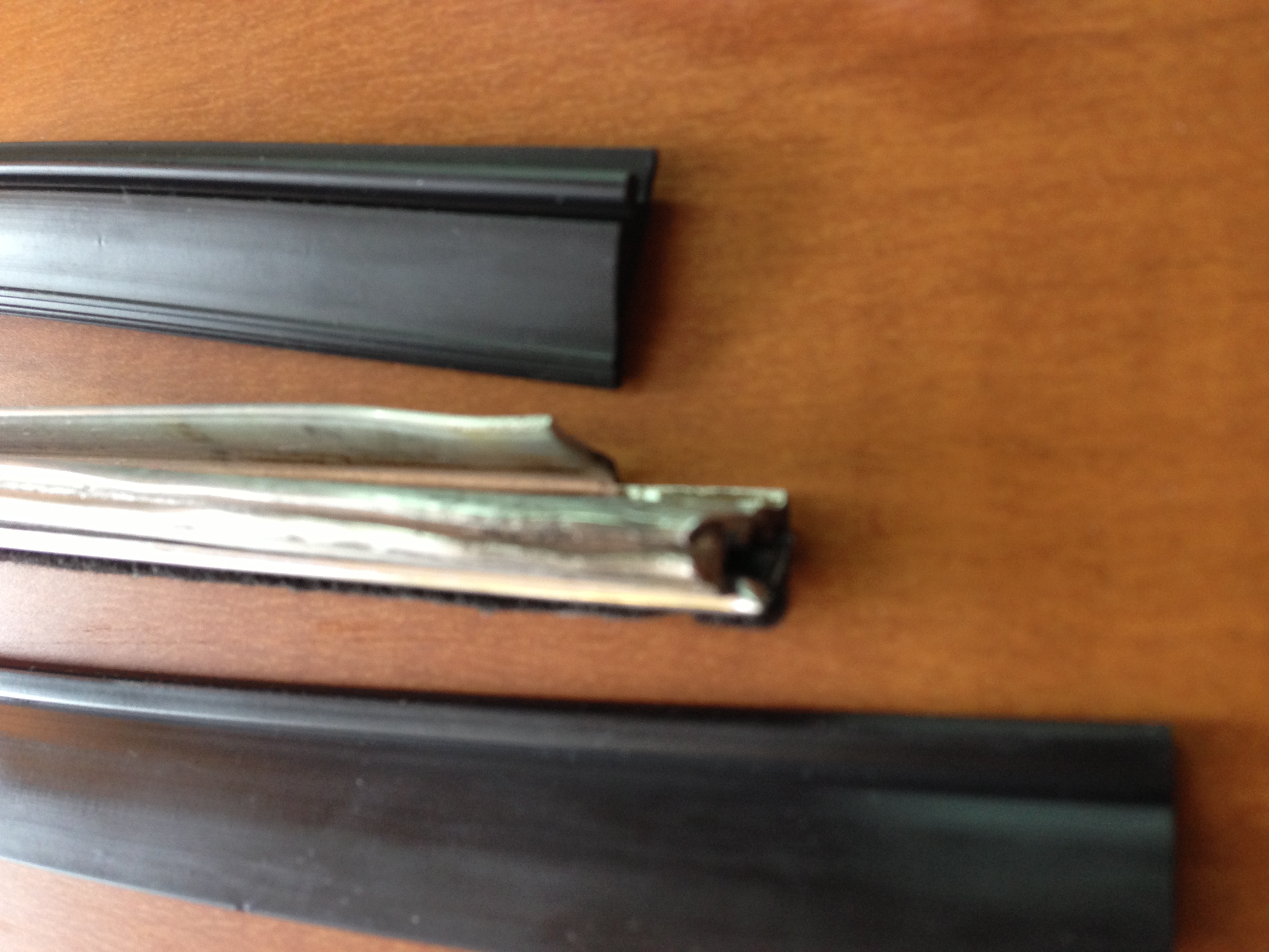

This is one of the jobs I never finished. I installed new rubber squeegies in the doors and when I operate the windows, they pull out. Tried a little glue, but it doesn't hold. Any ideas
Here's how I did it.
First, Mark sent me a new set of them and they look more pronounced if I can use that term.
I worked the metal some more. It was a bit bent up.
Then I slid the rubber in with the help of a little soap.
Lastly, I use a set of pliers that had been modified for pulling plug wires. They were perfect because then crimped the edge of the metal without touching the rubber.

Weird... I think the new soft rubber may be too soft to stay in the extruded aluminum thingy. Perhaps you could remove the aluminum and peen in several places to keep it in.

Sounds like they don't fit. Maybe there were a couple made too thin to engage the channel properly? How many people have actually installed them?

Let me know if you are having issues. I'd be happy to send you a replacement. Justy PM me your email and I can resend another set. The durometer of rubber was the same as sample OEM part. Maybe just a a out of tollerence part. Doesn't happen very often, but possible.

Ok, I will try to squezze the aluminum a bit. My problem is that every time I close the door the end of the rubber comes out of the channel. Looks like a winter project since I have to get the door apart to get to the channel, or is there an easier way?
