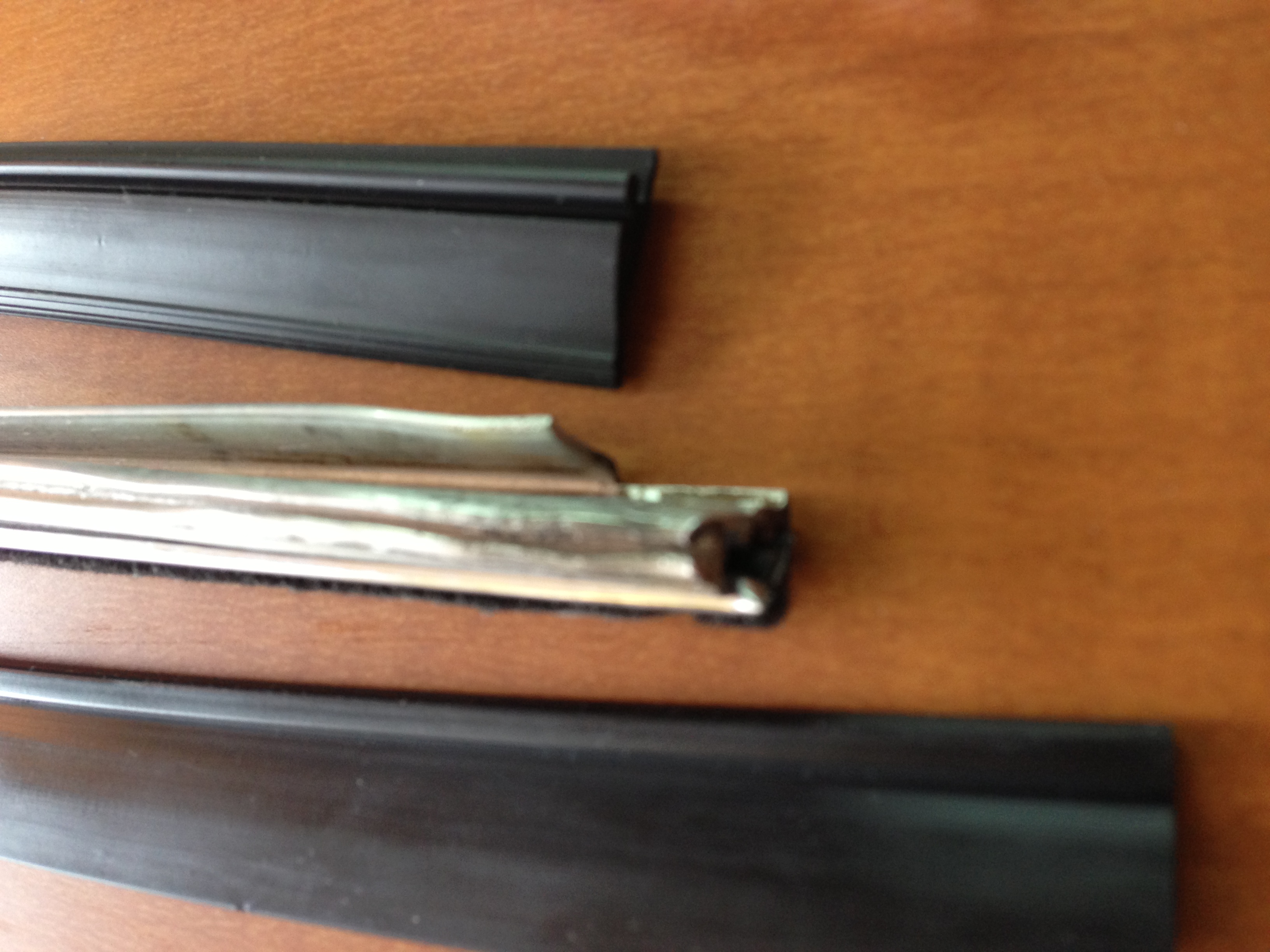

First, Mark sent me a new set of them and they look more pronounced if I can use that term.
I worked the metal some more. It was a bit bent up.
Click to view attachmentThen I slid the rubber in with the help of a little soap.

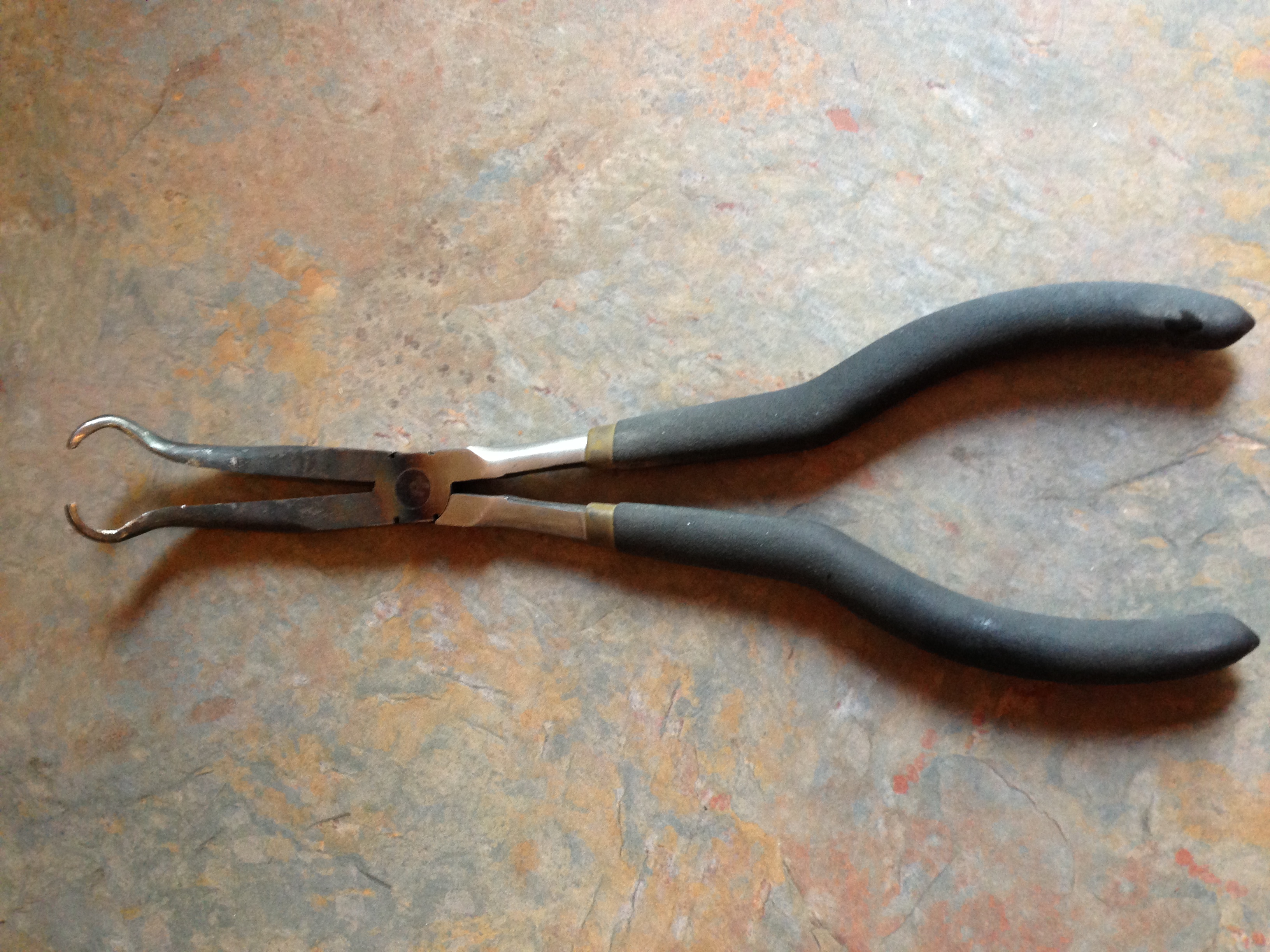

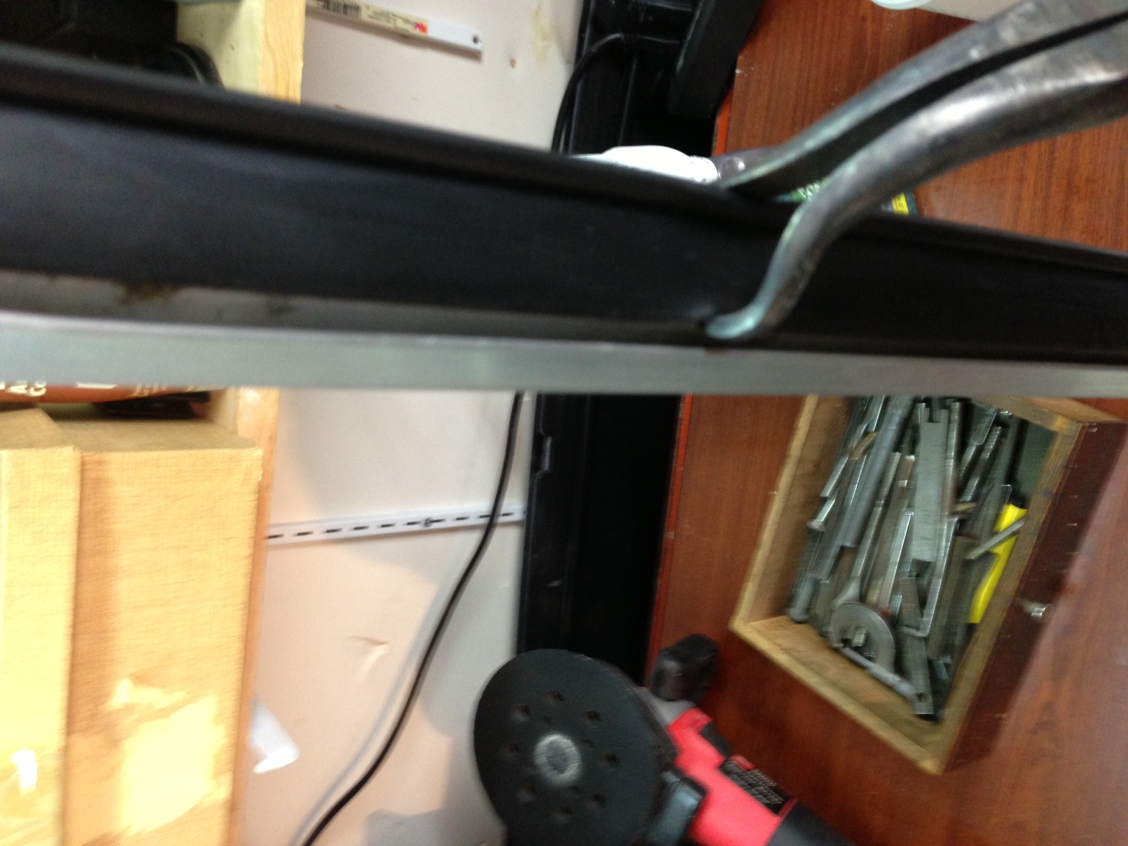

Lastly, I use a set of pliers that had been modified for pulling plug wires. They were perfect because then crimped the edge of the metal without touching the rubber.
