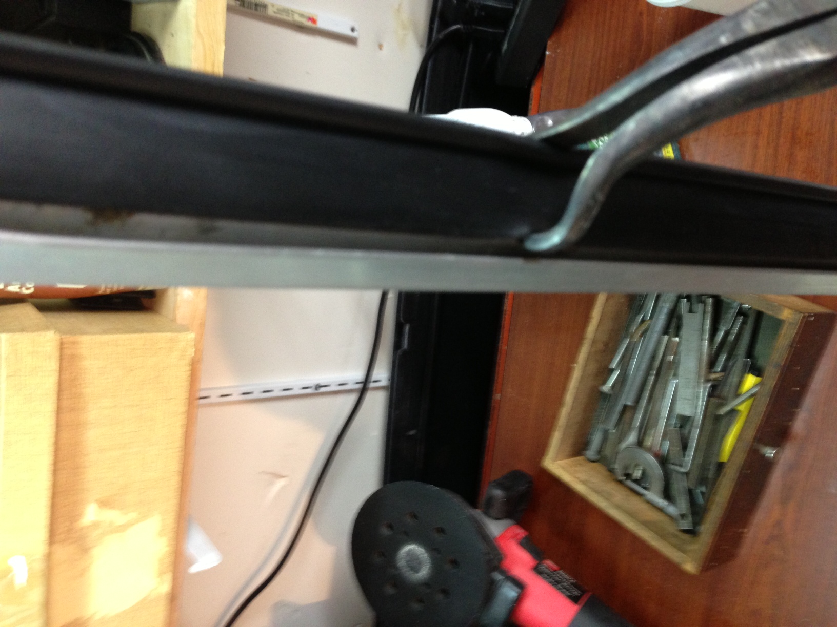

This is one of the jobs I never finished. I installed new rubber squeegies in the doors and when I operate the windows, they pull out. Tried a little glue, but it doesn't hold. Any ideas
Here's how I did it.
First, Mark sent me a new set of them and they look more pronounced if I can use that term.
I worked the metal some more. It was a bit bent up.
Then I slid the rubber in with the help of a little soap.
Lastly, I use a set of pliers that had been modified for pulling plug wires. They were perfect because then crimped the edge of the metal without touching the rubber.

Cupomeat   GREAT! :agree: I have never been able to fi...   Apr 6 2013, 05:44 PM
messix   does the channel that the rubber fit in to need to...   Apr 6 2013, 05:55 PM
r_towle   Mine were preened over on each end   Apr 6 2013, 06:03 PM
kg6dxn   I got new ones from 914 rubber. Mine pull out in t...   Apr 6 2013, 10:54 PM
zonedoubt   Put some talcum powder on them.   Apr 6 2013, 11:50 PM
rhodyguy   clean the windows with a diluted vinegar/ammonia s...   Apr 7 2013, 06:54 AM
balljoint   Should he wash his arm and put glycerin on his shi...   Apr 7 2013, 07:37 AM
76-914   Well, I feel strange. I've done them on both m...   Apr 7 2013, 08:10 AM
balljoint   Well, I feel strange. I've done them on both ...   Apr 7 2013, 09:19 AM
76-914   Well, I feel strange. I've done them on both...   Apr 7 2013, 09:37 AM
Daiberl   I have the same problem with my rubber seal, reall...   Apr 7 2013, 09:26 AM
PanelBilly   I have the same problem with my rubber seal, real...   Apr 7 2013, 02:22 PM
Mikey914   Let me know if you are having issues. I'd be h...   Apr 7 2013, 09:51 AM
Mikey914   Don't glue them, it would be a mess. Thx   Apr 7 2013, 09:51 AM
Daiberl   Don't glue them, it would be a mess. Thx Ok,...   Apr 7 2013, 09:56 AM
76-914   Don't glue them, it would be a mess. Thx Ok...   Apr 7 2013, 10:19 AM
Daiberl   [quote name='Daiberl' post='1846507' date='Apr 7 ...   Apr 7 2013, 10:35 AM
rhodyguy   i guess he could wash his hands but why would he n...   Apr 7 2013, 10:13 AM
rhodyguy   when you guys installed these did you remove the e...   Apr 7 2013, 03:15 PM
MrHyde   I'm having the same issue with one of my squee...   Apr 7 2013, 04:05 PM
rhodyguy   post #7   Apr 7 2013, 05:07 PM
MrHyde   Tryed that already   Apr 7 2013, 05:27 PM
PanelBilly   Here's the pliers   Apr 14 2013, 10:07 AM
