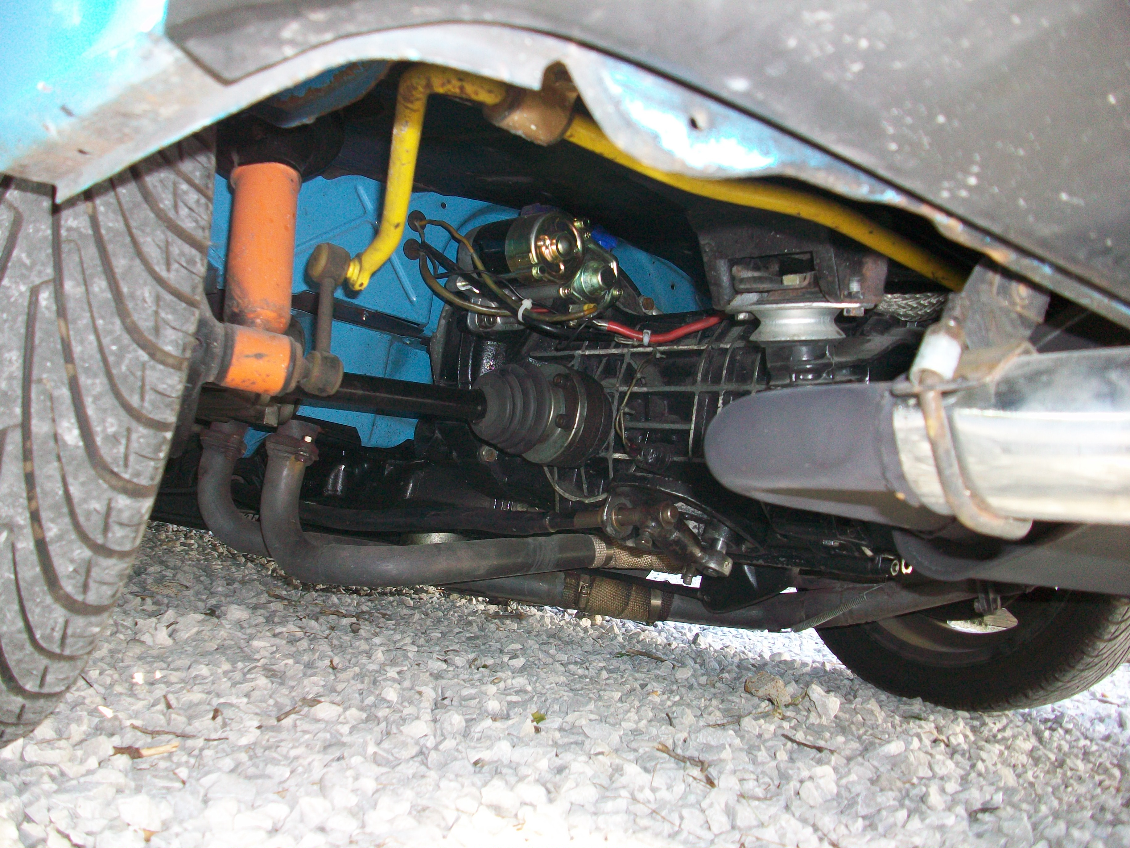

I have a non stock, but very streetable 914 that I am willing to sell. Solid and strong!! Bob

You should see me in a thong and heels! My car is set up for auto/cross, koni shocks, shorted springs, wide tires and wheels, MSD ing sys, etc. I had a 911 guys drive it, he said WOW! Is that kinkda what your looking for? Bob
