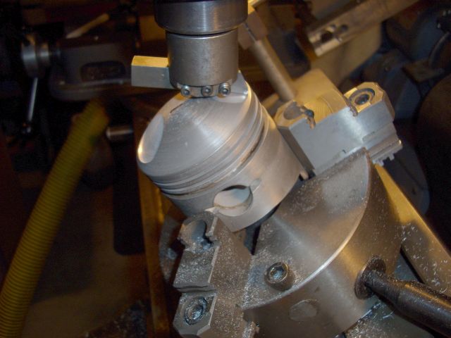

toolguy T pistons with an E cam need and additional .040 c... Apr 12 2013, 09:26 PM
