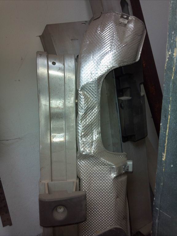

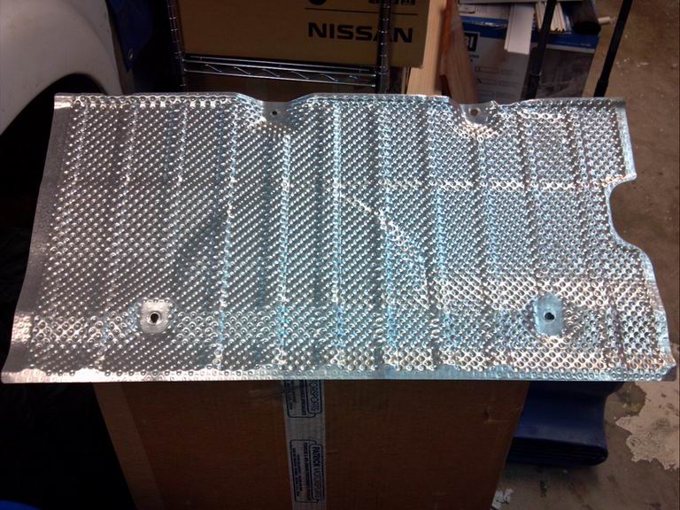

Go find a wrecked late model Nissan Altima, Honda or Mercedes. Above the muffler you will find these two ply aluminum honeycomb heat shields. Same length as the 914 and about 2 inches wider. Only weights 9 oz compared to the factory heat shield boat anchor. Weld or bolt some 1 inch standoffs under the floor and you have a trick shield and lose some weight. Mercedes uses them just behind the qtr panels and they cost about $28.00 -they are formable.
993's and 996's uses the same material attached to the rear bumper reinforcements to keep the bumper cover from melting.

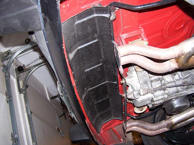

I removed the heat shield to repair the trunk floor then decided to make it removable so I welded bolts to the hangers and bolted it in. I've already removed it a couple of times to repair some rear-end damage and to paint.

QUOTE(Jeff Hail @ Apr 11 2013, 09:29 PM) *
That's a Hell of a fine idea. And the OG shield is heavy.

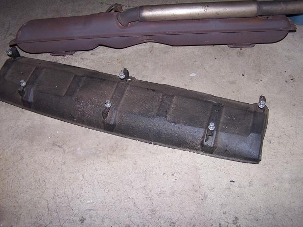

Any idea how much one really weighs?
Krieger
post Apr 12 2013, 11:49 AM
Posts: 4,855
Joined: 24-May 04
From: Santa Rosa CA
Member No.: 2,104
Mine has been gone for years. No problems, but not a daily driver. Paint in trunk is fine. Probably weighs 3 lbs
Jeff Hail
post Apr 12 2013, 11:57 AM
Posts: 1,141
Joined: 3-May 07
From: LA/ CA
Member No.: 7,712
I just tossed a rusty one in the trash. More like 10 pounds.
