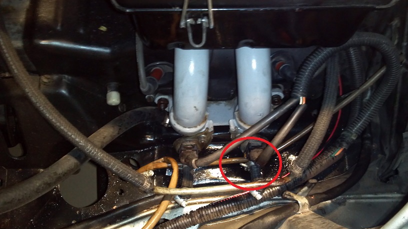

I seem to have a problem with oil pooling on the top of the engine tin, where the red circle is. Just changed the valve cover, and its dry, so I know somehow its not coming from there. I wonder if its coming from the little hose just to the upper left? BUt thats dry too. At a loss here...Attached Image

Do you have an oil bath air filter? When I jack up one side on my car, I sometimes get some overflow from the filter.

Looks like a 2.0, so I would say no on the oil bath.
My guess would be it is related to the head vent hose on the left, I would pull the hose off and inspect everything. Only 2 things that would carry oil vapor topside of the engine tin on a 2.0 would be the head vents or crankcase vent.
JamesM
post Apr 14 2013, 10:28 PM
Posts: 2,094
Joined: 6-April 06
From: Kearns, UT
Member No.: 5,834
also.... where do you have that head vent hose connecting to? It should run tight along side the engine tin to the flashback valve.

I had the same problem, ended up coming from the top of the valve cover, the gasket had sucked in on top, no oil anywhere but on top of the tin (IMG:style_emoticons/default/confused24.gif)
Fixed the valve cover gasket, no more oil.

If the leak started recently after changing the VC gaskets, I'd agree that's where you need to focus.
Crank case pressure is probably pushing the oil out of the top of the gasket.

The leak was happening before I changed the VC gaskets, which were leaking bad, but now the vlave cover is completely dry, so I dont think its that. I tend to think its the head vent hose, but that seems to be dry too. One clue is that it only leak during "spirited" driving, not when the car is idling.

Oil can and will blow out the top of the valve cover , pool on the tin,
and the cover stay dry. I agree on the gasket. Been there.

Ok, so now I am confused as the 1st pic was from a D-jet car and your 2nd pic had carbs?
pressure on a properly setup d-jet car should be venting though the head vent provided it has not been fuch'ed with. I could see on a carbed car how the pressure could blow out the valve cover gasket if it was improperly installed and the normal vents have been jacked around to where they are not evacuated properly.
Makes it somewhat harder to diagnose when you describe a problem and then show a picture of a completely different car.
Also, if the carbed car is yours, it looks like you a have the head vents and the PCV venting to the same source. If you still have the PCV in place which it looks like you do you may want to remove that as it was intended to be connected to manifold vacuum.

Ah, should have read that 2nd post closer. So if no carbs then which injection system are you running? Also, if you are running one of the factory injection systems then why the separate breather box? Given that the head vent configuration has been messed with, that is defiantly where I would start. Maybe route it back to stock.

I'm still saying valve cover, since that's where mine was coming from with no oil anywhere else, plus my motor is out of a 75... No head vents, so that wasn't even a consideration in my case.

Winner! For the record, the head vent hose was very loose. I tightened and have driven like a maniac thru the Kentucky backroads and no more oil leak. (IMG:style_emoticons/default/beerchug.gif)
Odd that the hose was relatively dry...
ALso, not my engine in the above thread, pulled it from Google Images..
