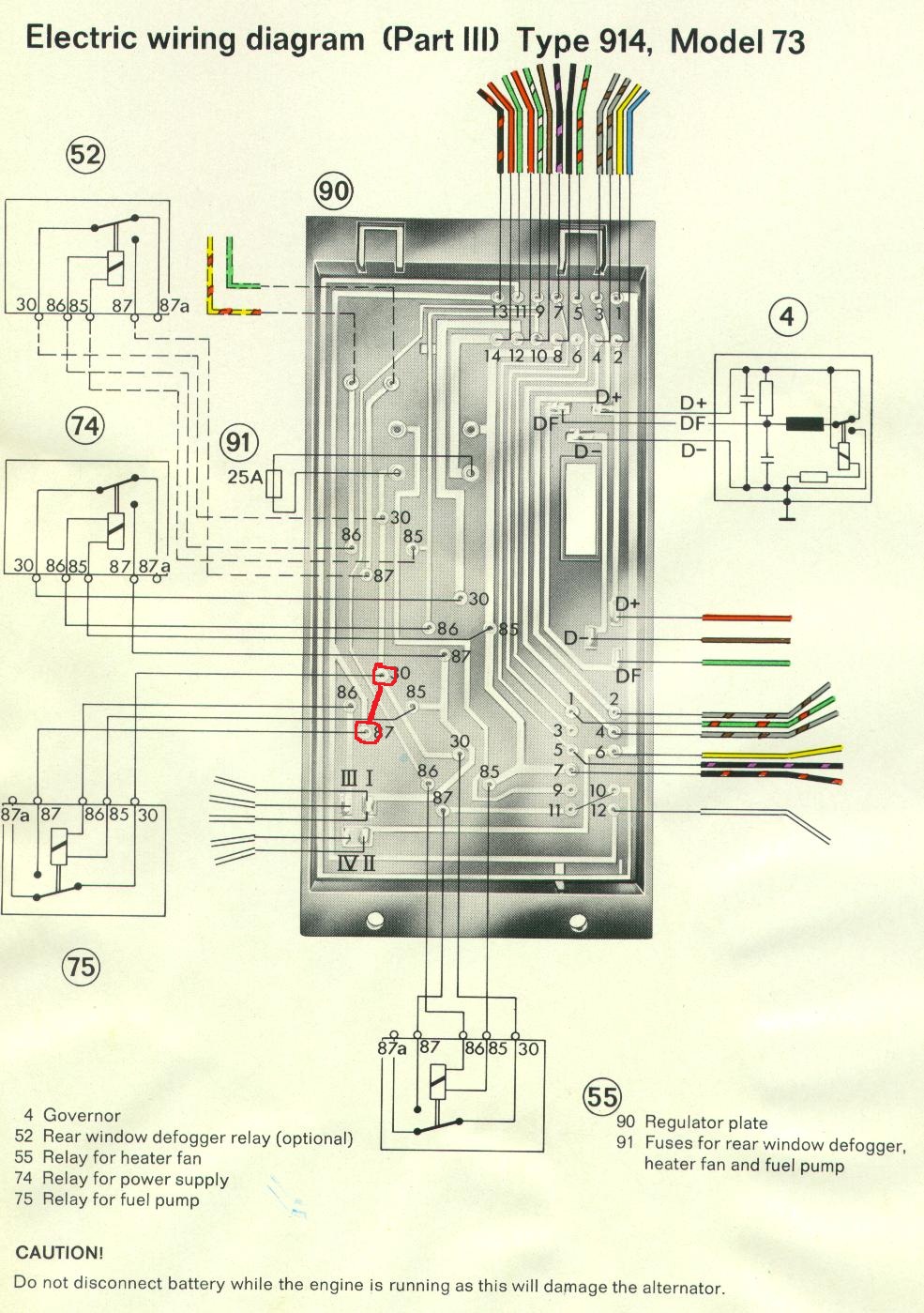

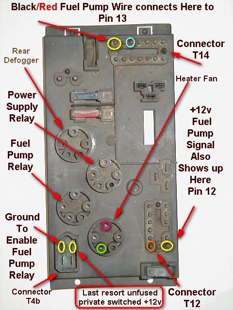

Another thing you can try if your wiring of the pump is "factory" (I see that you moved the pump so it depends on how you wired it ie did you wire it from the factory plug/position?) is to "jump" pins 30 and 87 of the terminals on the relay board for the fuel pump relay, that is, remove the fuel pump relay and connect pin receptacle 30 to pin receptacle 87 by using a short wire with bare ends or something similar to connect pin 30 to 87.
This will essentially be a bypass instead of the relay. Pin 30 is +12V from the battery traced from pin 14 of the 14 pin plug through the 25 A red fuse to pin 30. The relay would connect that 12V from 30 to pin 87 which would provide current to pin 13 of the 14 pin plug which provides +12V to the fuel pump. I learned about this recently when my car wouldn't start for a track session. I ended up jumping the wire at pin 13 to a terminal of the 25 A fuse and was good to go the rest of the weekend....
