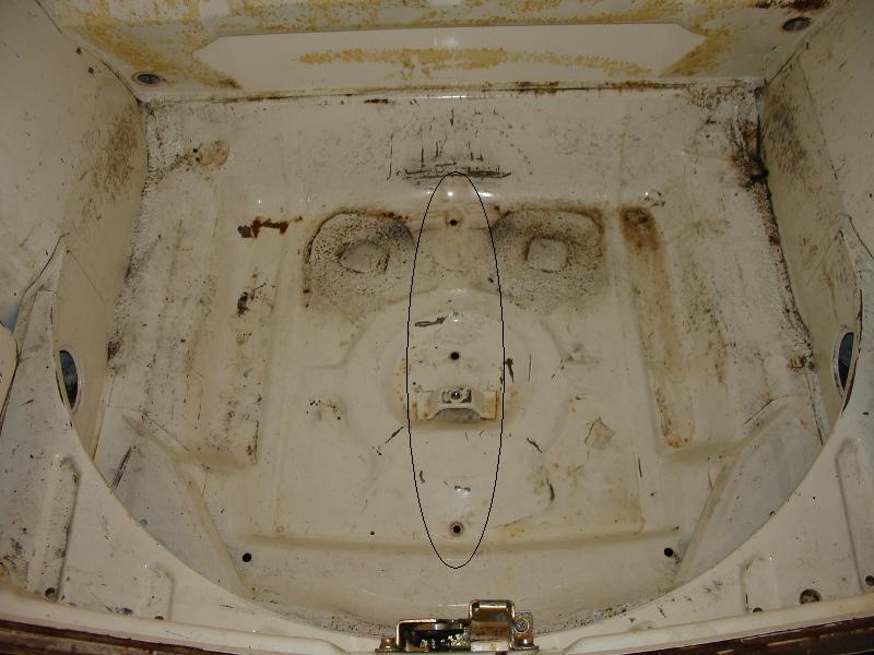

I find it a new piece of education here. I am pretty knowledgeable with the early cars. To learn that there is a third weep channel in the 74's is interesting, though because it is forward and in a non-drainage position I doubt that it is a weep channel. Probably another closed grommet.
As you can see in the pic of my '72, there are 2 weep holes (sorry for the filth - haven't been in there for a few years). Looks like you have a third, forward of the center tube.
Regardless, the drain tubes that fit into the weep holes are important. I'm not certain which part the factory used but Mark is correct in that the 911 headlight drain tube is a direct fit. And unnoticeable.
All the others that you mentioned are simple grommets. Why they are there is a mystery to me.

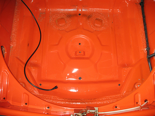

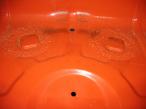

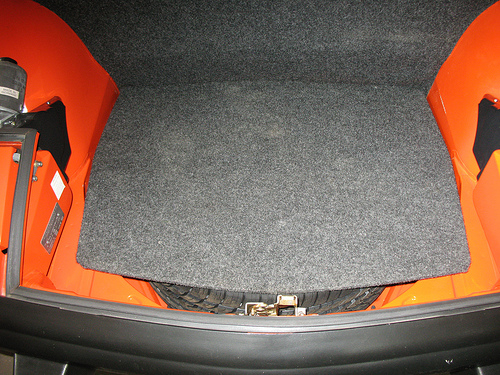

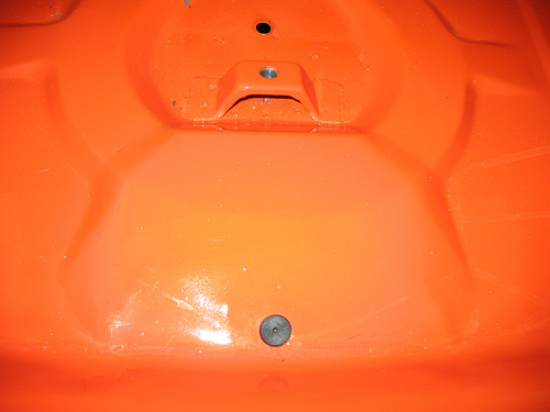

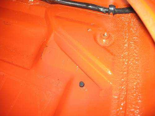

My 74, haven't gotten underneath it yet.
(IMG:http://www.914world.com/bbs2/uploads_offsite/farm9.staticflickr.com-7438-1366594035.1.jpg)
(IMG:http://www.914world.com/bbs2/uploads_offsite/farm9.staticflickr.com-7438-1366594036.2.jpg)
(IMG:http://www.914world.com/bbs2/uploads_offsite/farm9.staticflickr.com-7438-1366594036.3.jpg)
(IMG:http://www.914world.com/bbs2/uploads_offsite/farm9.staticflickr.com-7438-1366594036.4.jpg)
(IMG:http://www.914world.com/bbs2/uploads_offsite/farm9.staticflickr.com-7438-1366594037.5.jpg)
(IMG:http://www.914world.com/bbs2/uploads_offsite/farm9.staticflickr.com-7438-1366594037.6.jpg)
Paul

Thank you Paul! Your pictures are greatly appreciated.
Greg

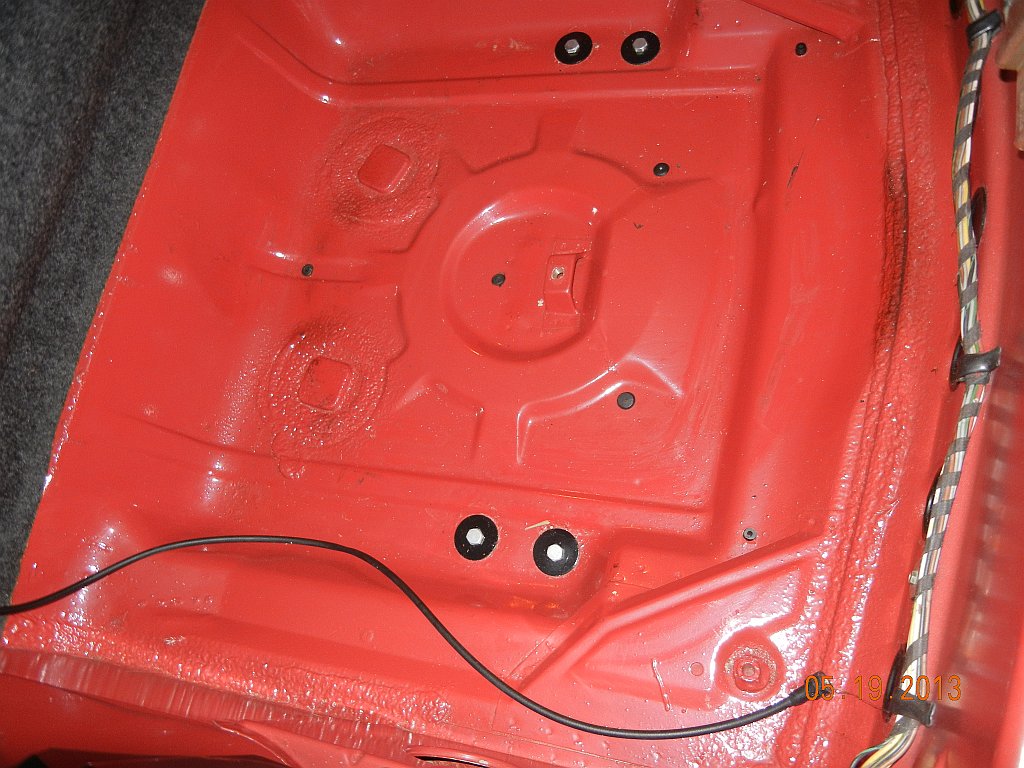

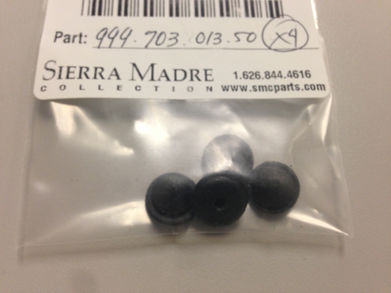

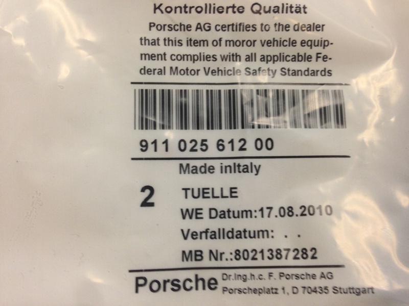

I wanted to follow up on this thread. I was able to find the part number for the front weep hole plugs. It is 999.703.013.50. These are still available. The weep hole drain tubes are part number 911.025.612.00. These too are still available. See pictures attached.
Thank you all who helped find these parts.
Greg
