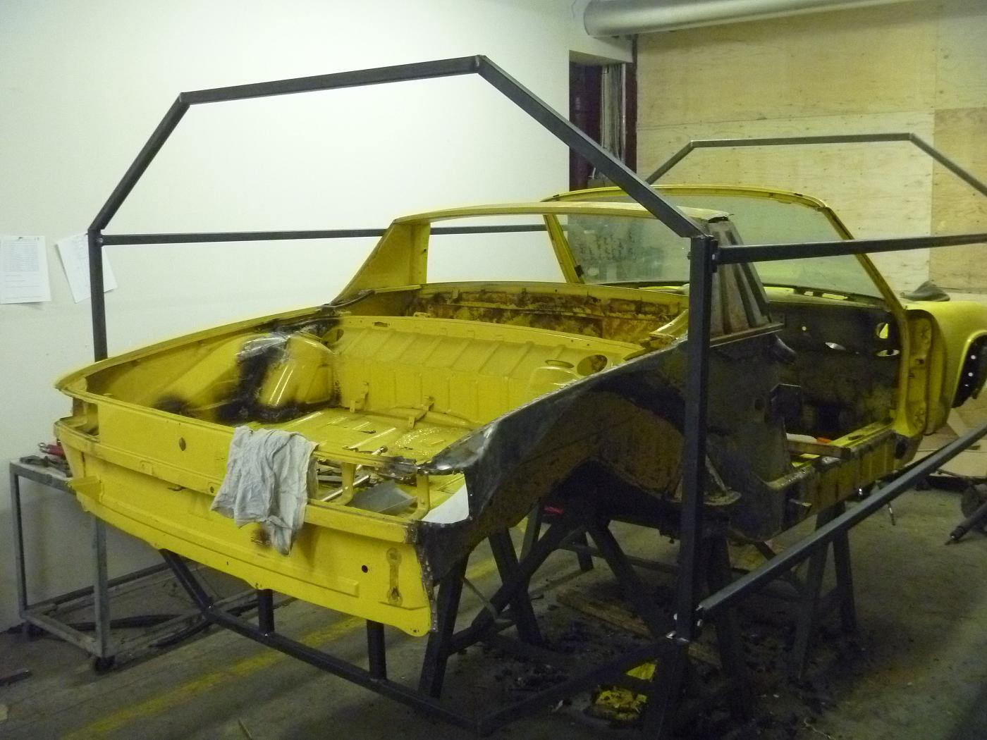

I'm starting this thread for people who need reference or a guide to install some of the parts that we produce. We will be making how to videos also that will be posted on our youtube channel.

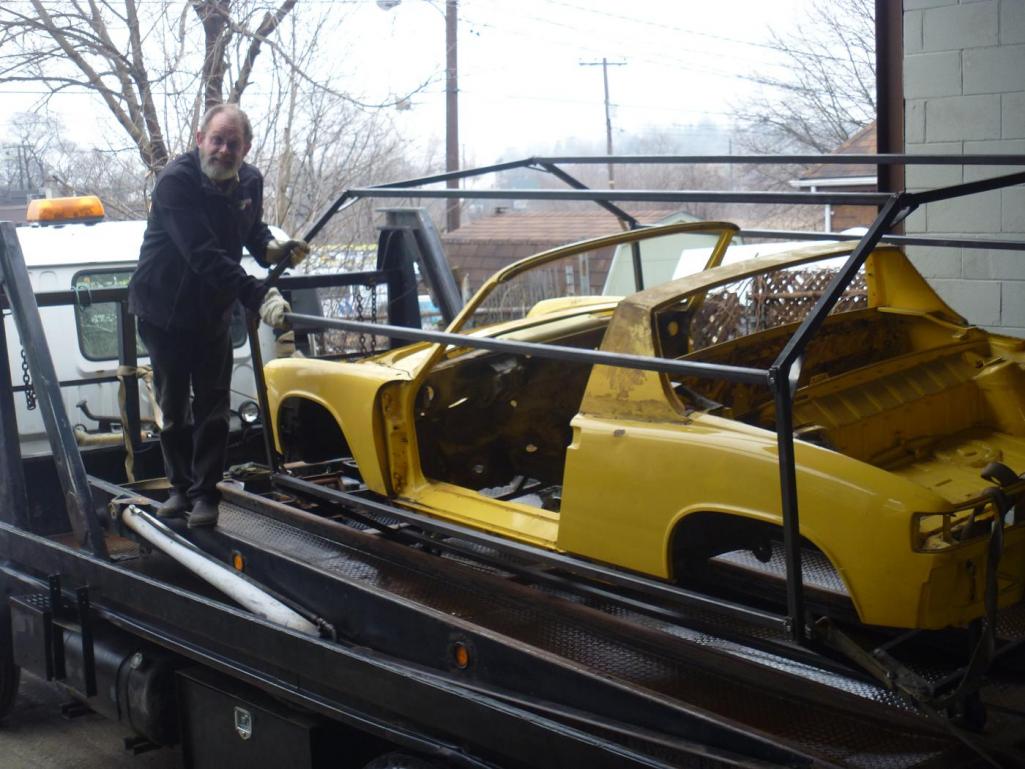

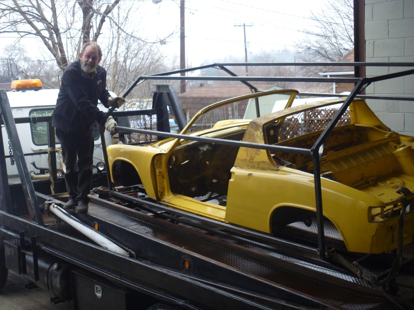

We bought this car off a member here, Enhoover.
When we received the car we stripped it and built a rotisserie (plans for these are available).

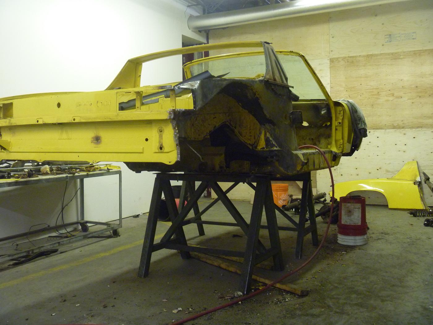

We removed the right rear quarter panel to better illustrate some of the installations that will be done.
Here is the car right after we got the rear quarter removed.
the rotisserie we built
off to the blaster

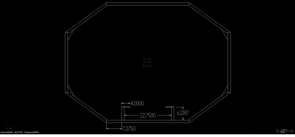

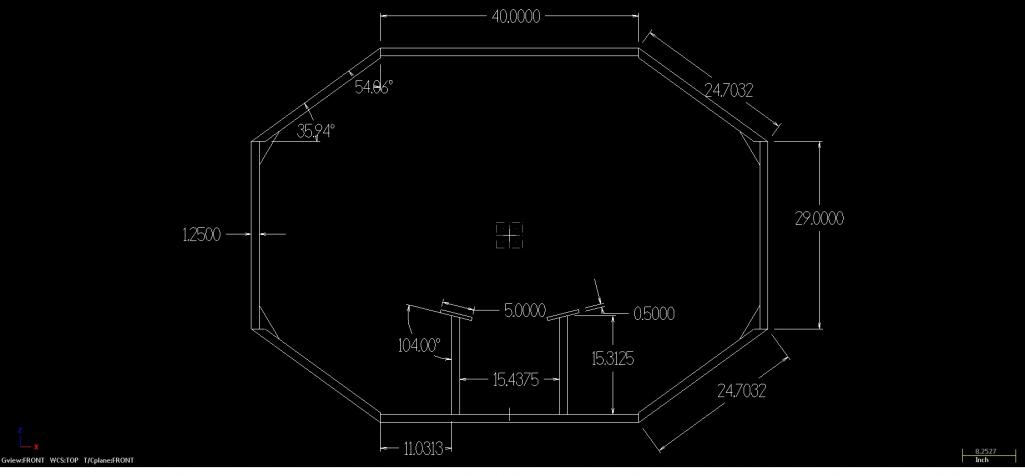

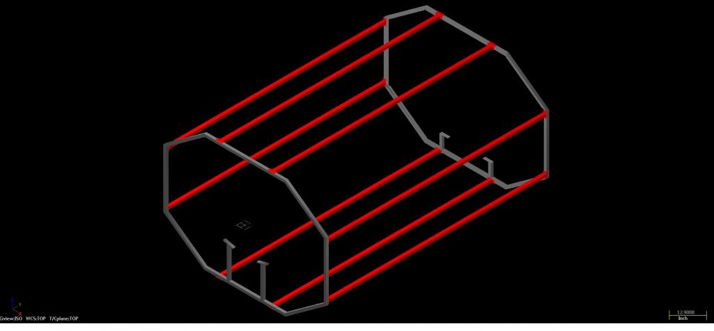

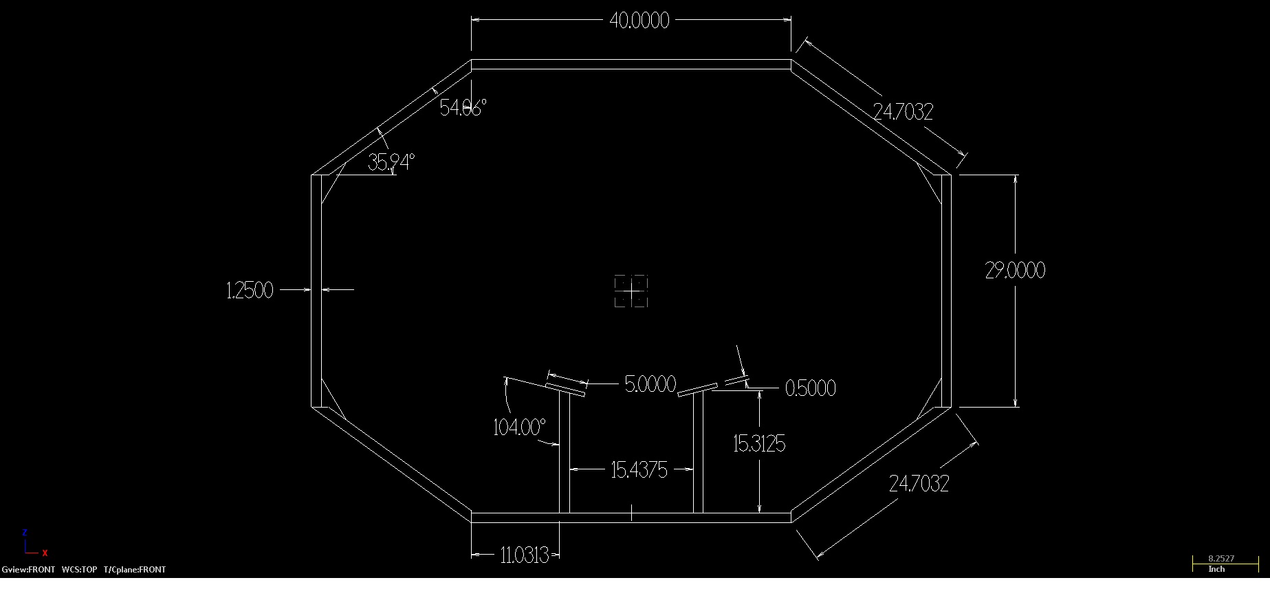

peteyd   Here are the drawings for the rotisserie we made. ...   May 14 2013, 11:24 AM

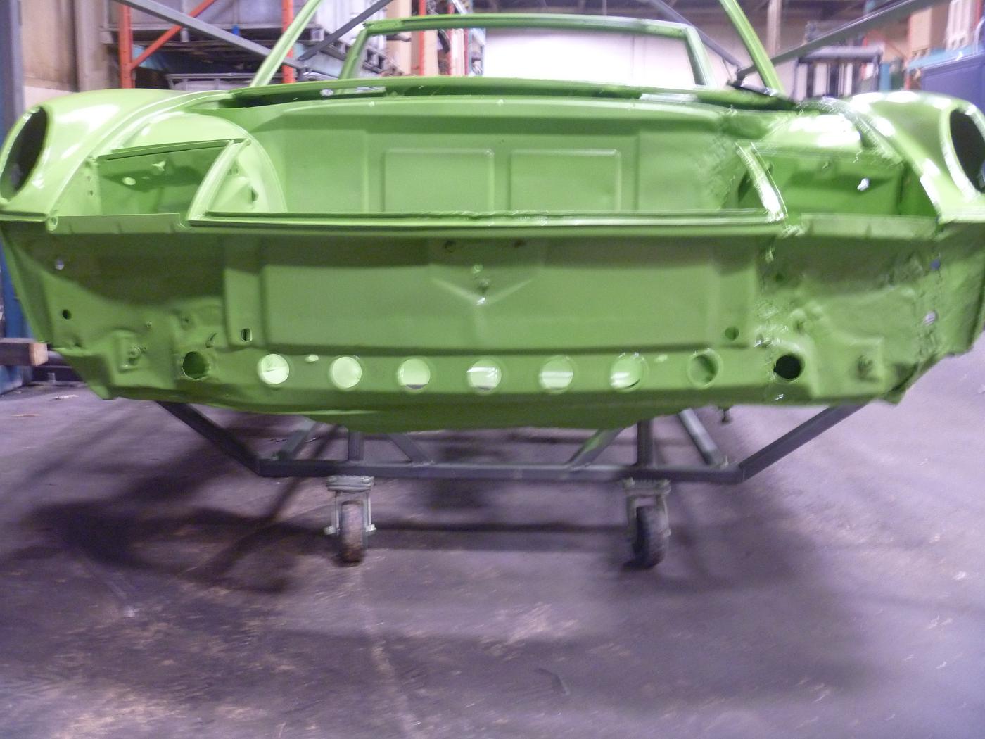

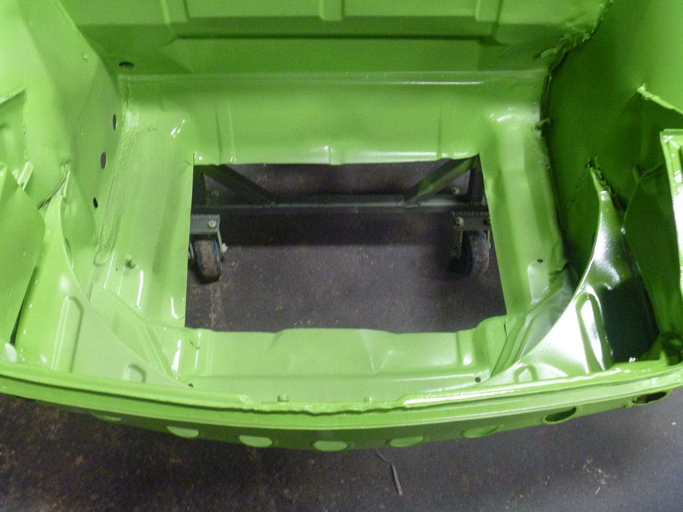

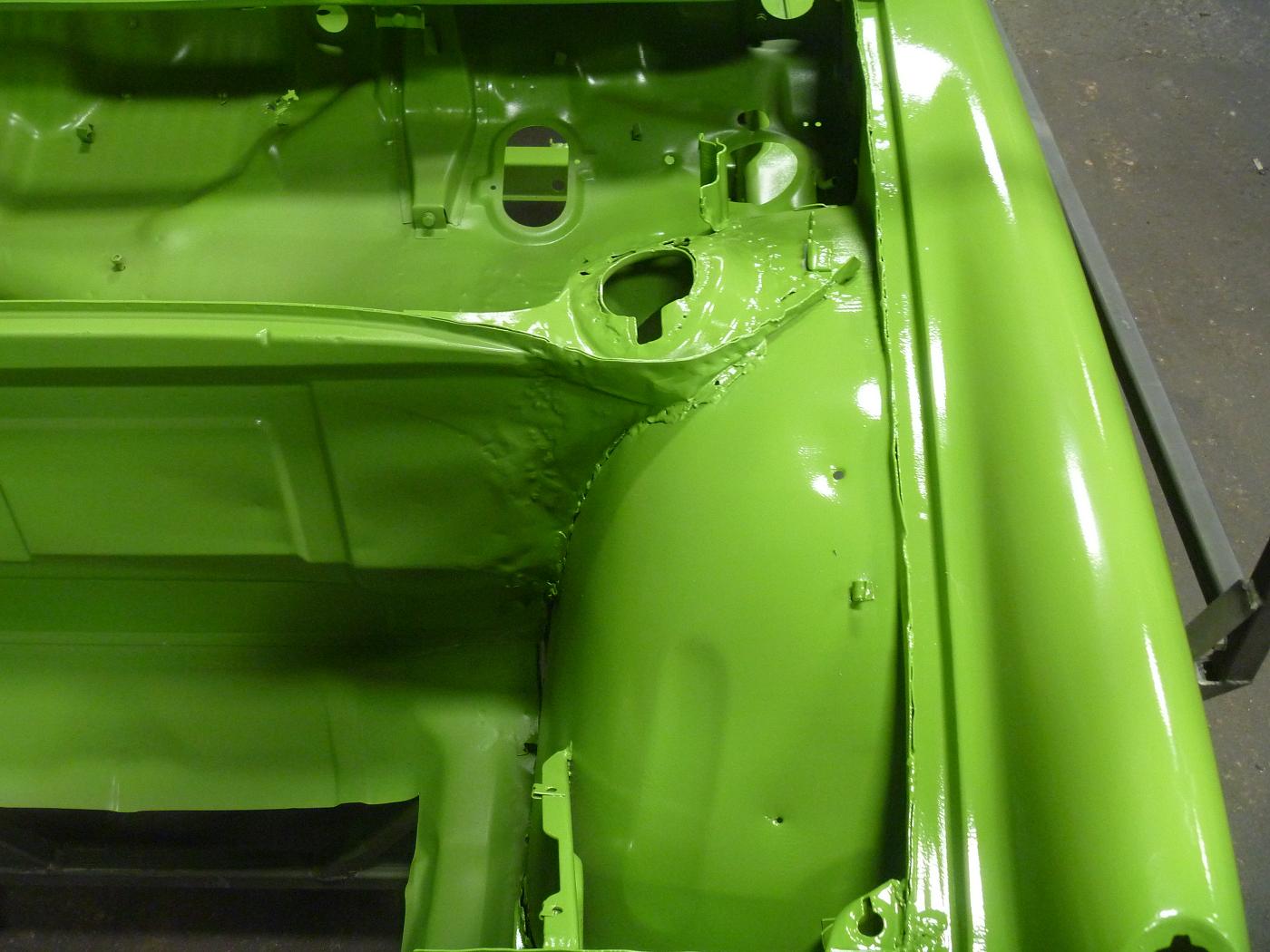

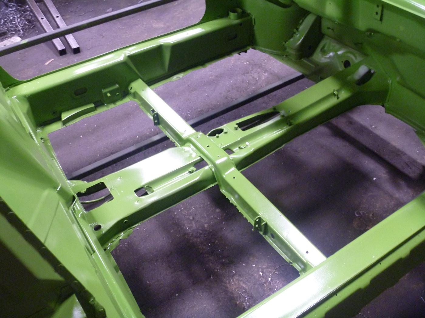

peteyd   We just completed replacing the front and rear flo...   Aug 12 2013, 01:27 PM
peteyd   Here is our latest installation video... enjoy 3...   Aug 13 2013, 08:24 AM
