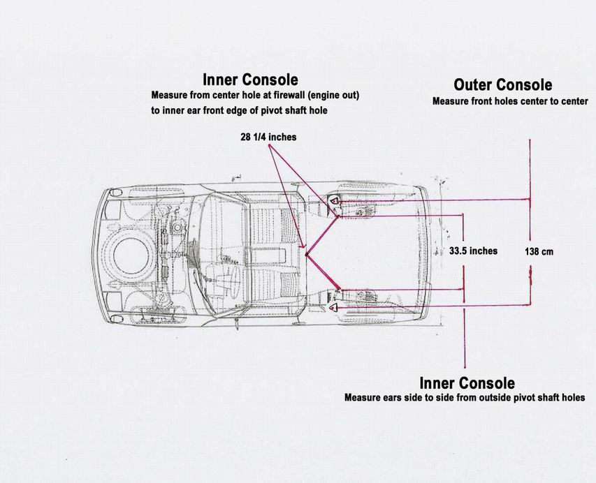

peteyd   Here are the drawings for the rotisserie we made. ...   May 14 2013, 11:24 AM
Ninehundredfourteen   Here are the drawings for the rotisserie we made....   Oct 21 2021, 09:22 AM

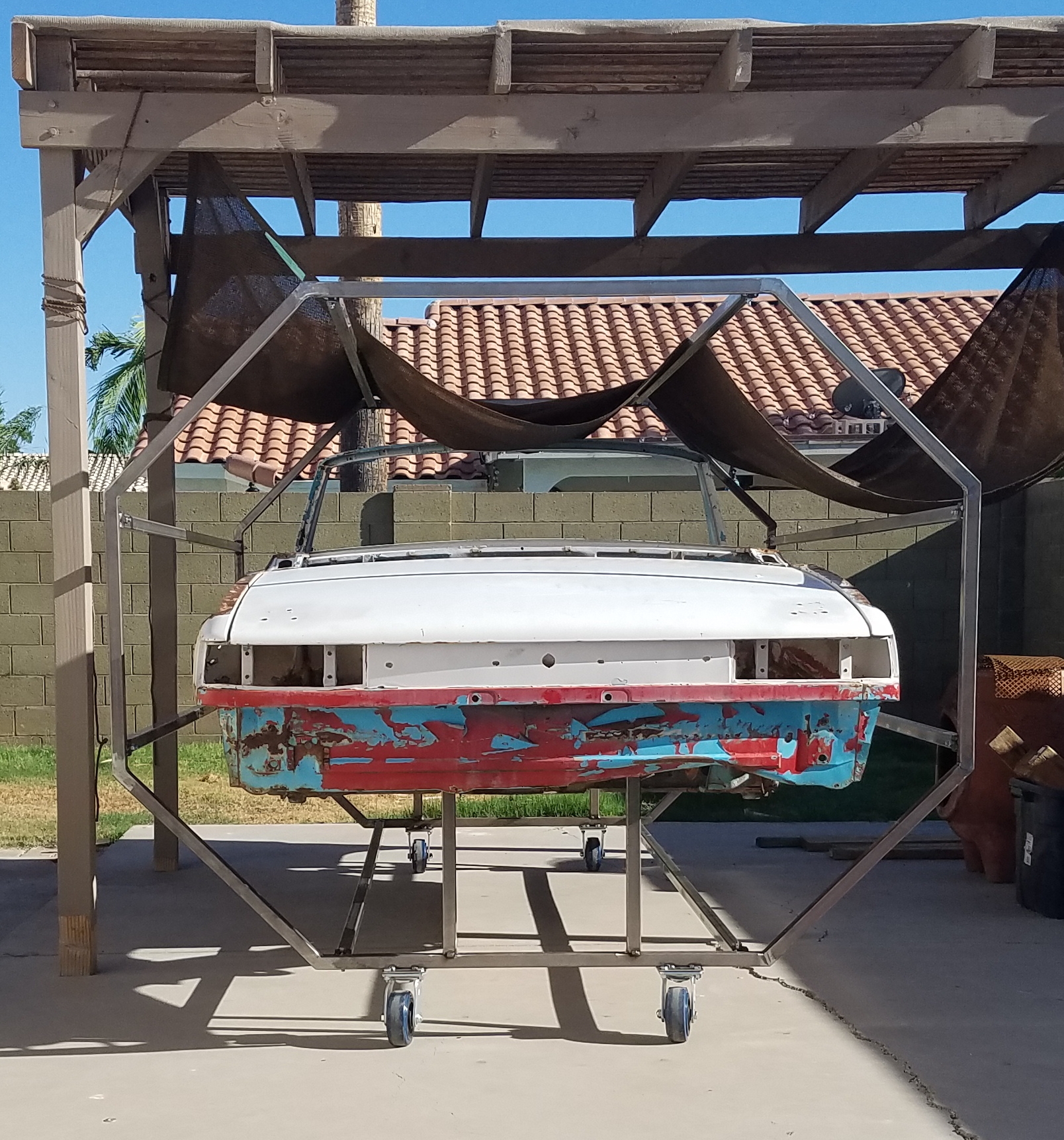

snflupigus   Over 110degrees outside in the pic below :angry: ...   Jun 25 2018, 12:43 AM
peteyd   Over 110degrees outside in the pic below :angry: ...   Jun 26 2018, 09:40 AM
