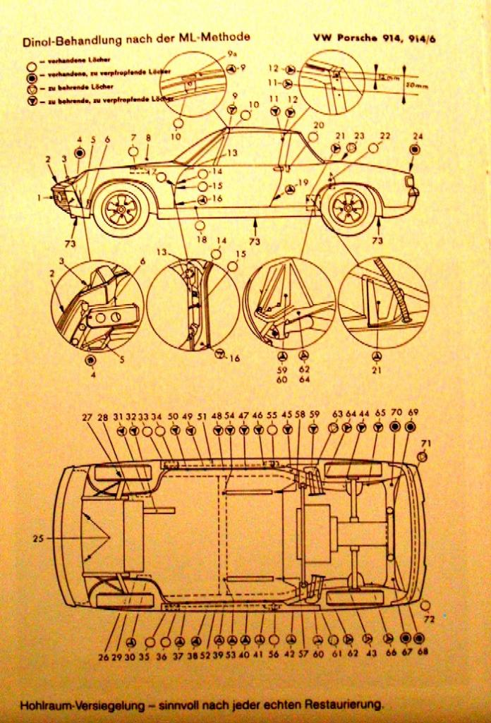

I can't remember where I found this diagram but I think it is a factory thing.
I am having trouble with some of the translation.
"Dinol-Behandung nach der ML-Methods" = "Dinol treatment following the ML Methods" -What are "ML Methods" though?
"vorhandene locher" = "existing holes"
"zu behrande locher" - google translate gives "to guarding other holes"? Not sure about that...
"zu vorptropfende locher" Not getting anything for this..
At the bottom, "hohlraum-versiegelung - sinnvoll nach jeder echtenrestaurierung" translates to "cavity-sealing - useful for any real restoration"
Anyone know what the others are?

QUOTE(nathansnathan @ May 6 2013, 03:46 PM) *
"vorhandene Löcher" = existing holes
"zu bohrende Löcher" - holes that need to be drilled
"zu verpfropfende Löcher" - holes that need to be plugged
"Hohlraum-Versiegelung - sinnvoll nach jeder echten Restaurierung" = cavity-sealing - useful after any real restoration
PS: No idea what the ML method is ...

JeffBowlsby
post May 7 2013, 09:09 AM
Posts: 9,264
Joined: 7-January 03
From: San Ramon CA
Member No.: 104
Thats from the DGVWP Buch. (IMG:style_emoticons/default/wink.gif)
