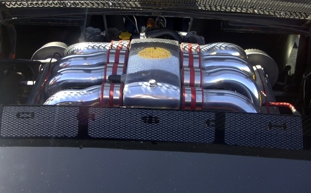

tomeric914
post May 13 2013, 02:32 PM
One Lap of America in a 914!
Posts: 1,324
Joined: 25-May 08
From: Syracuse, NY
Member No.: 9,101
I want to see a flat 12 in a (stretched) 914. This is a pic of an original 12, but the bird board link is about someone who put two 3.0 liter engines together.
